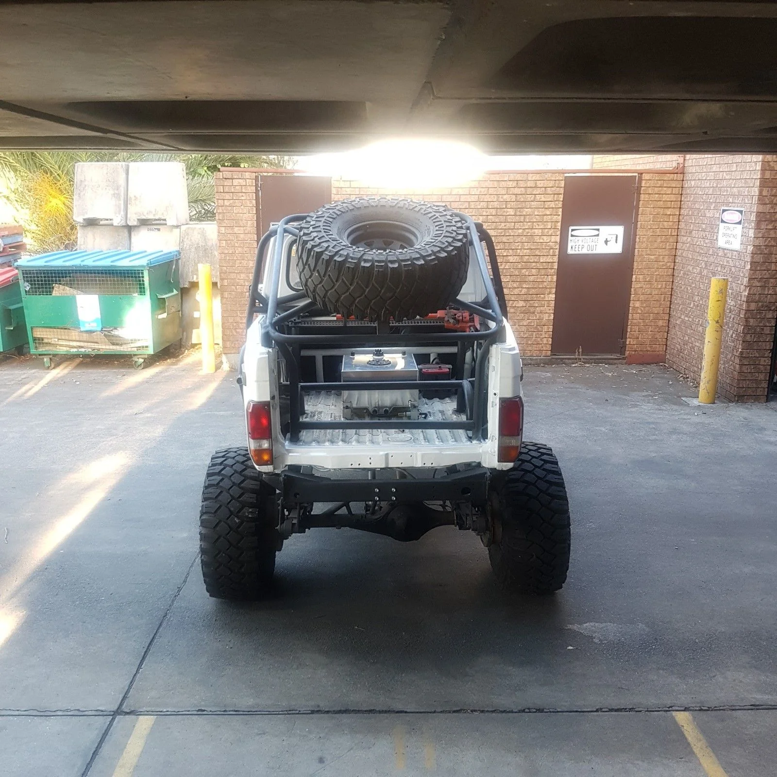

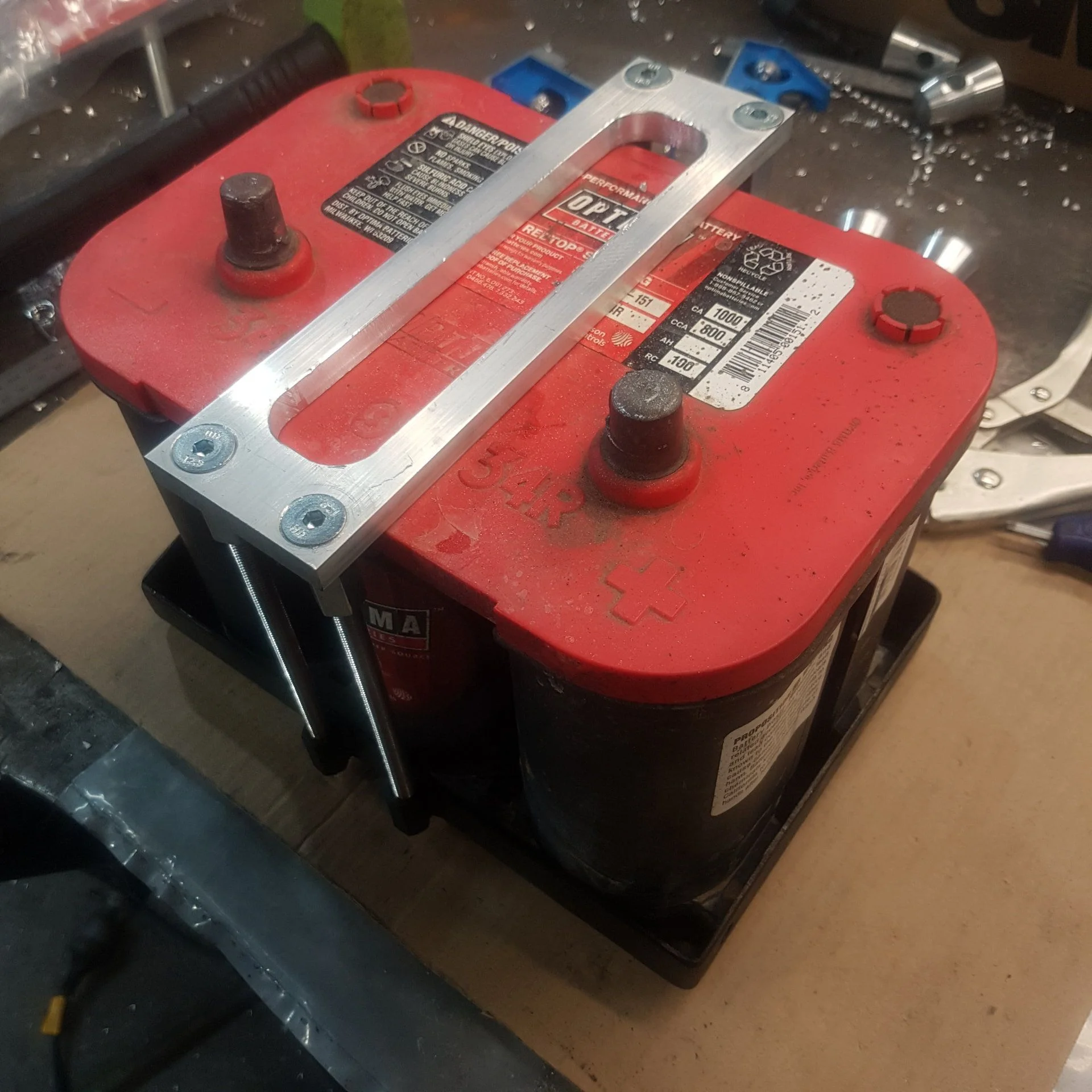

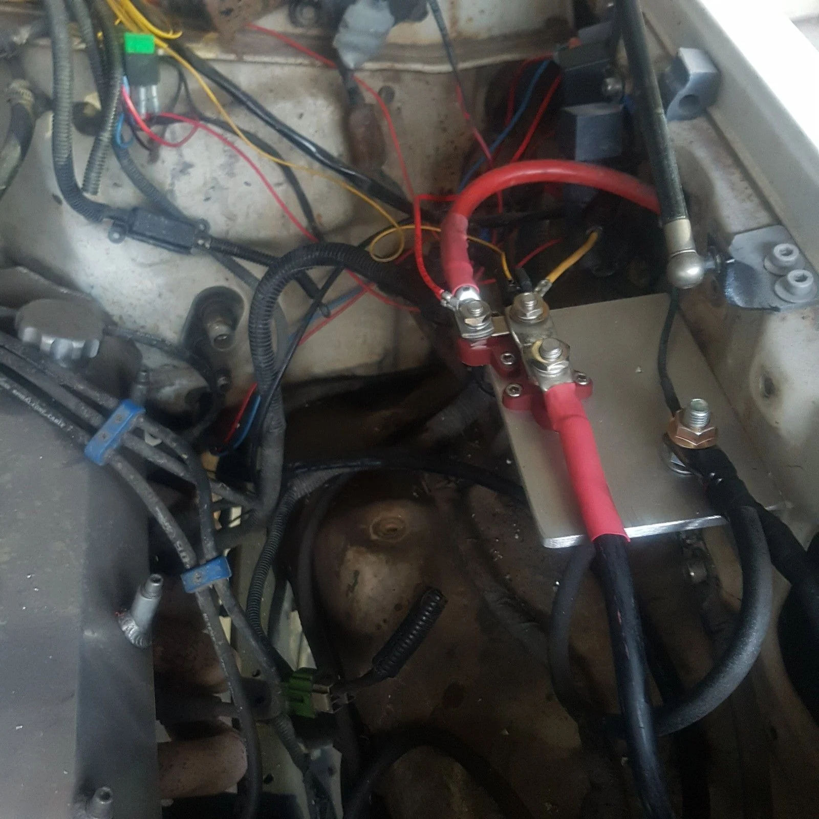

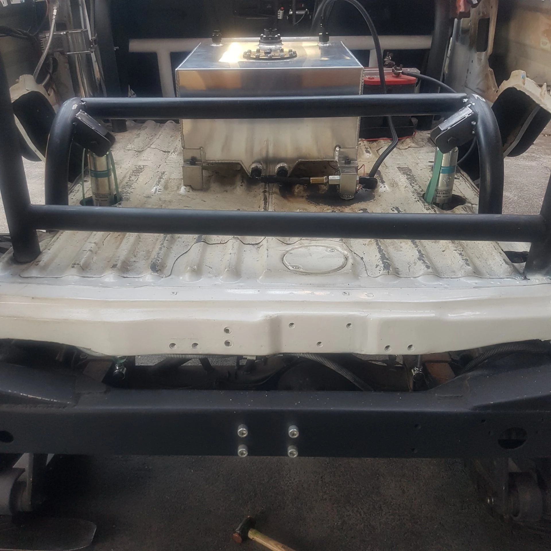

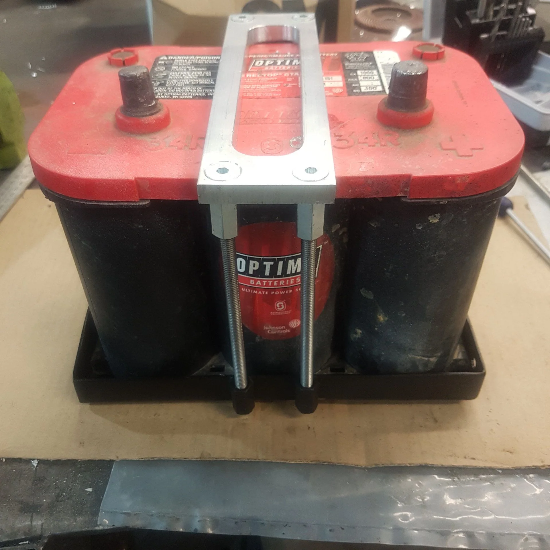

Moving the battery to the rear. Knocked up a mount for the optima.

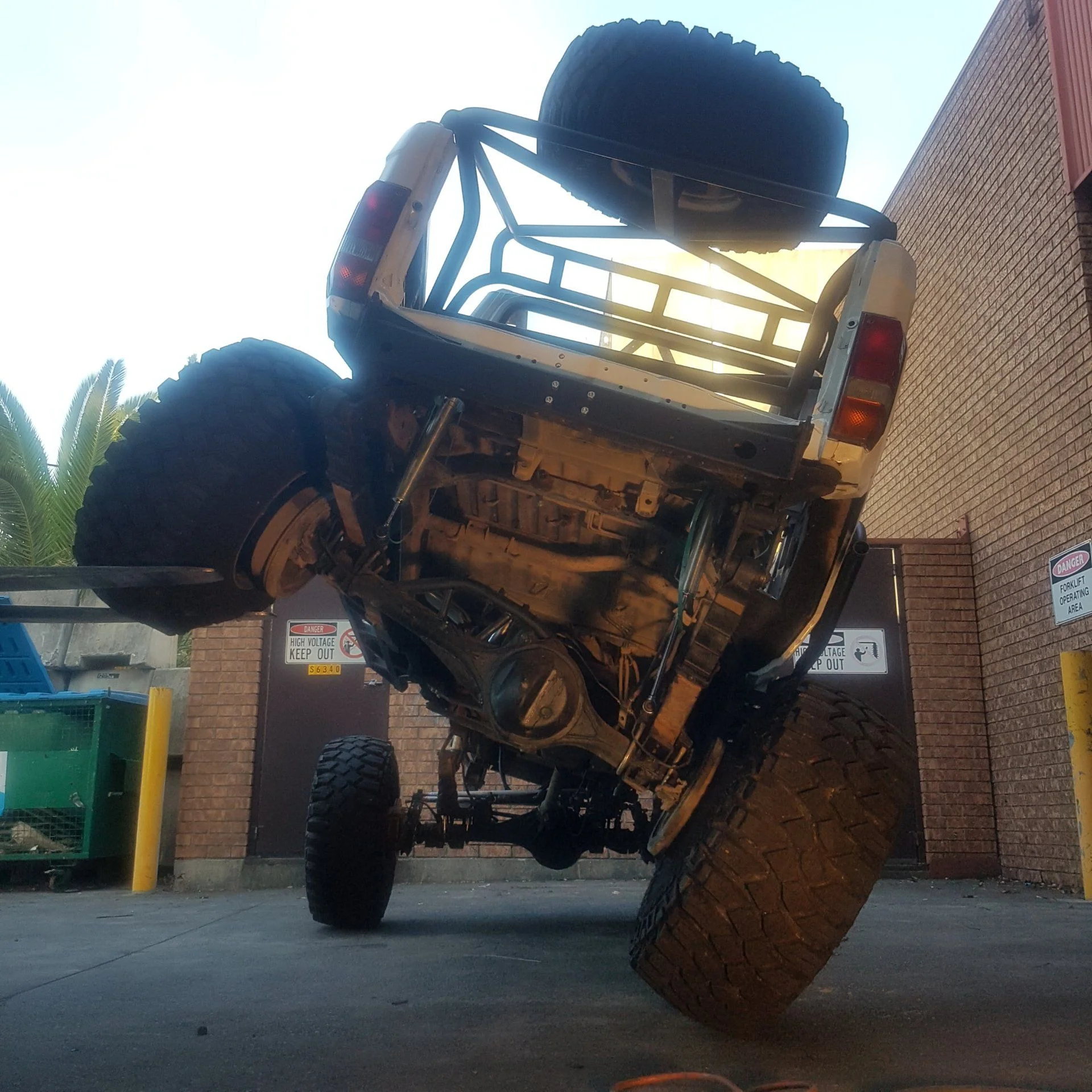

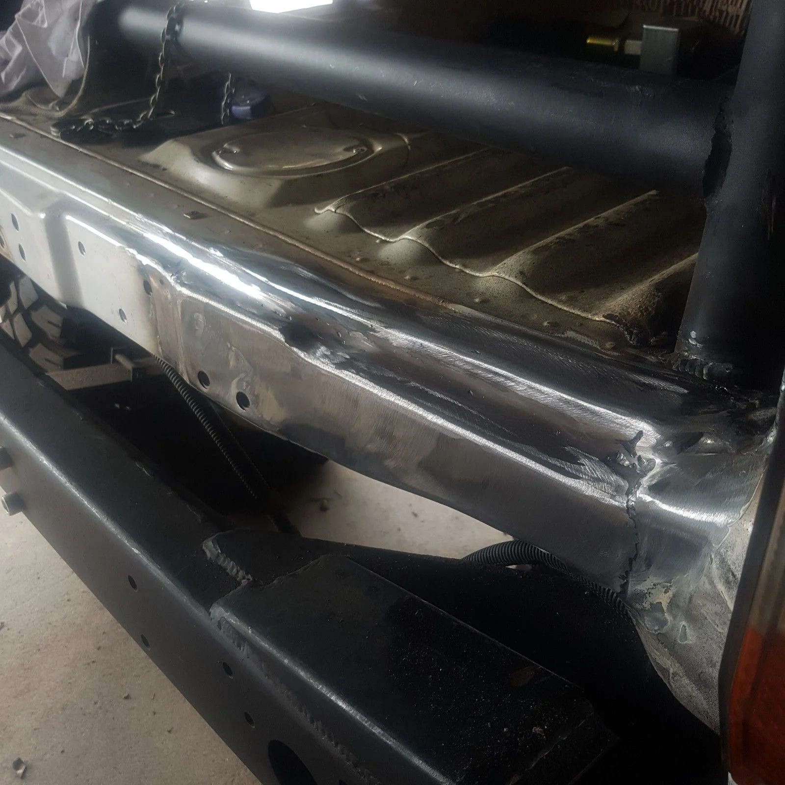

Love it man, awesome work!! Don't see very many dovetailed 70s.
Dam those videos make me want to go beat up my truck.

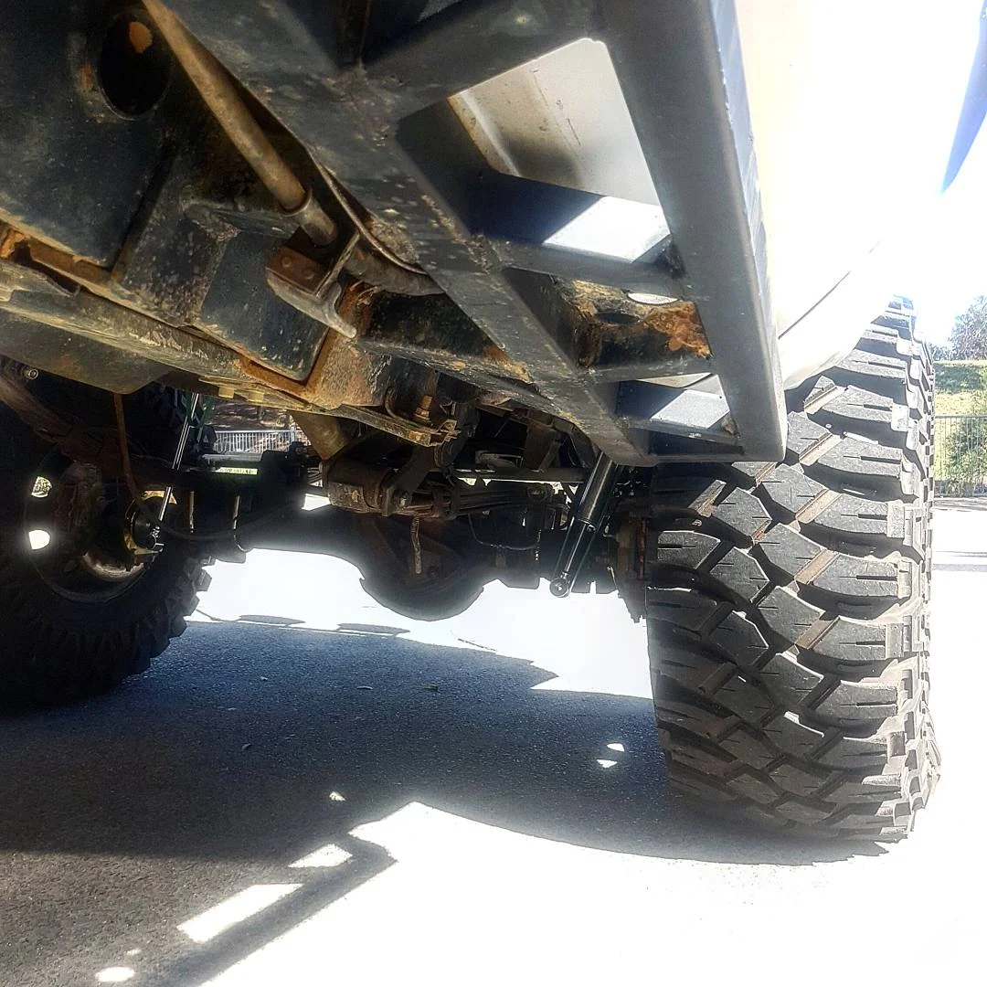

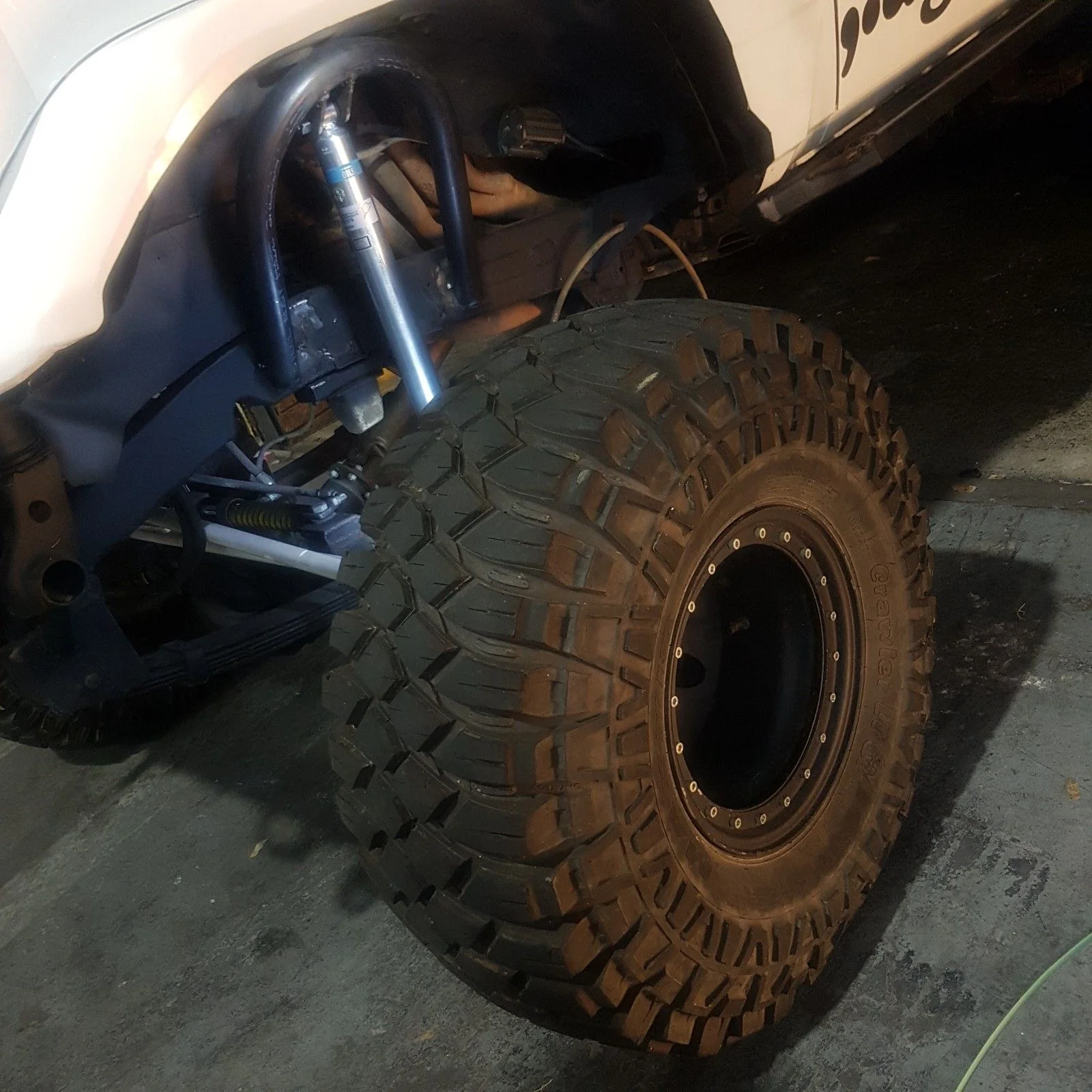

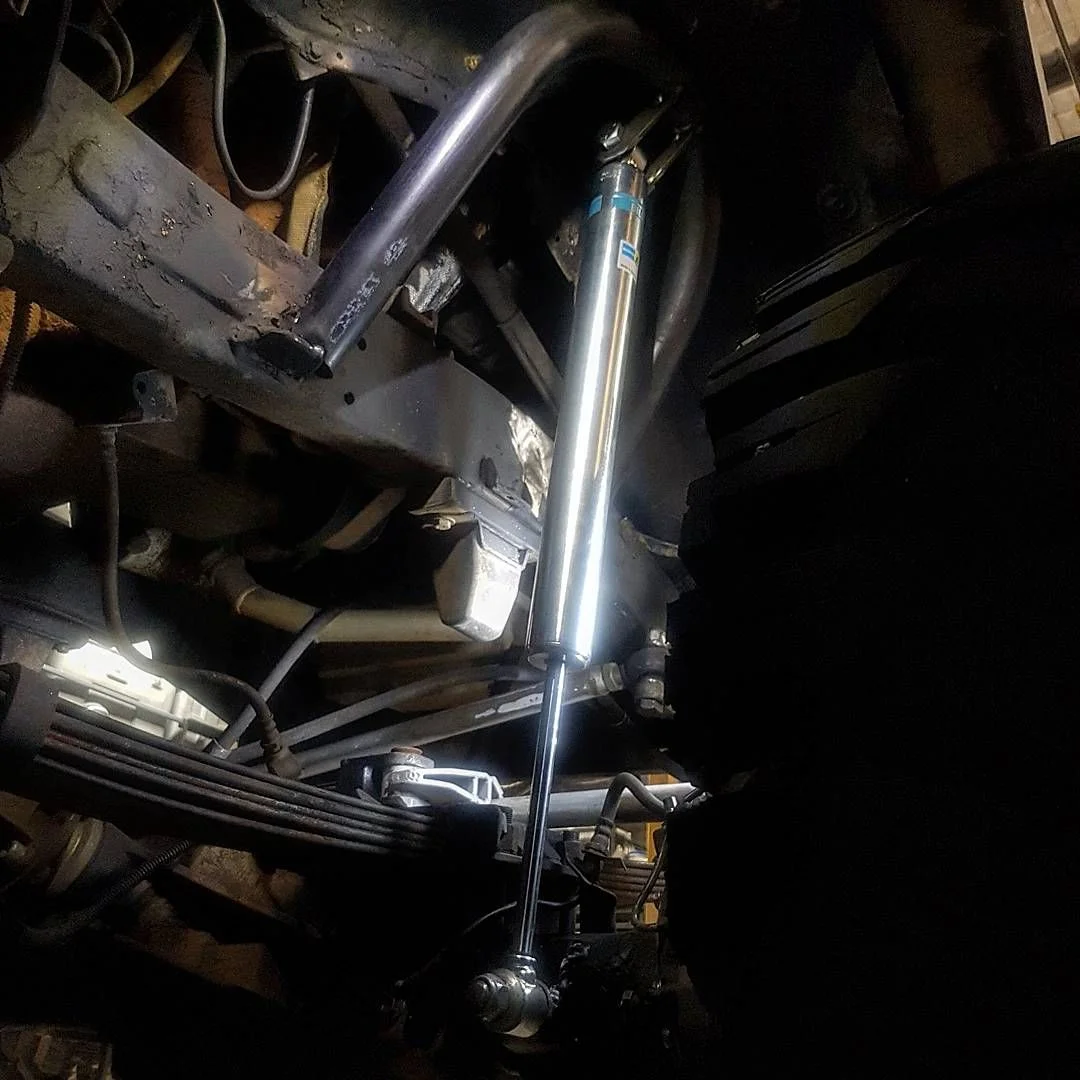

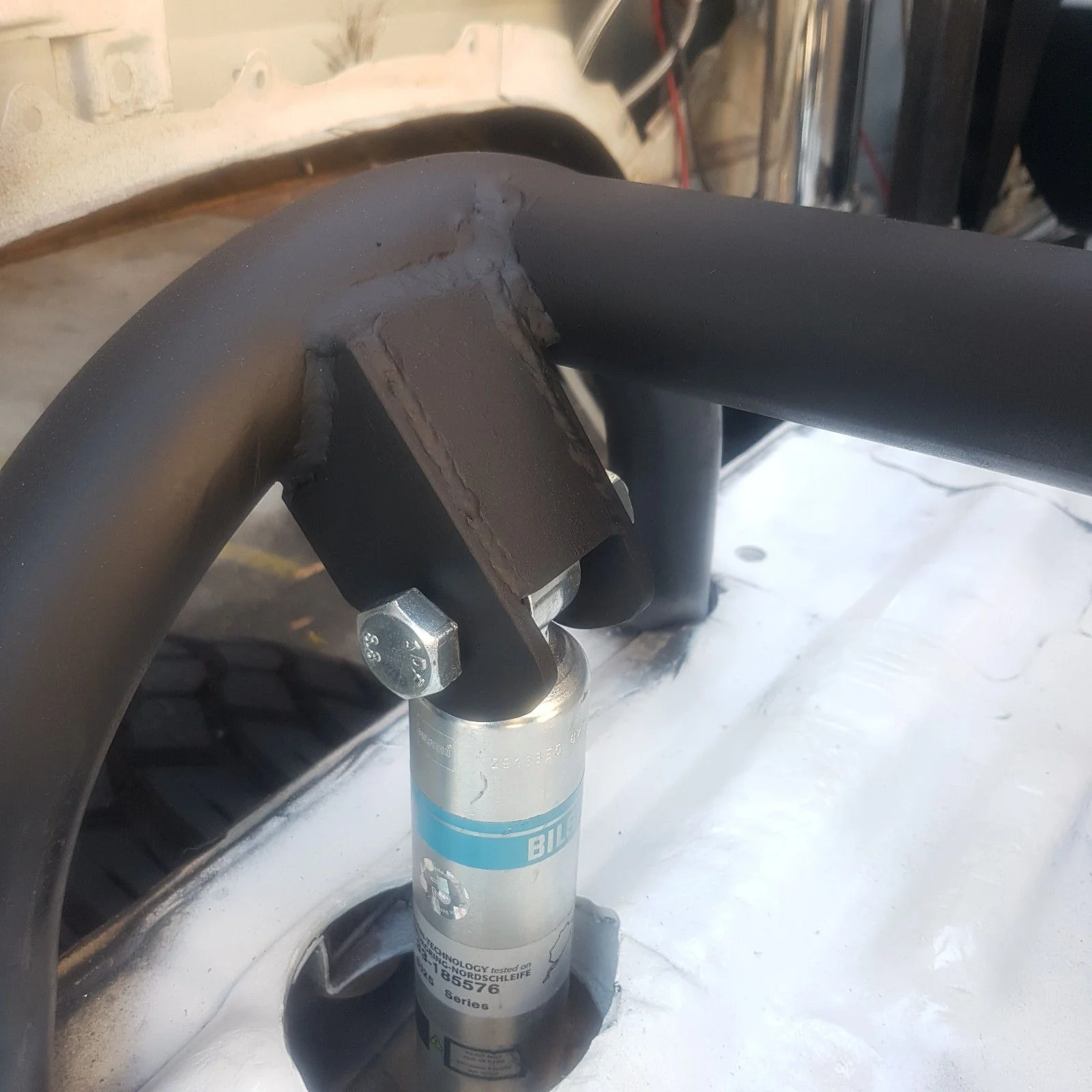

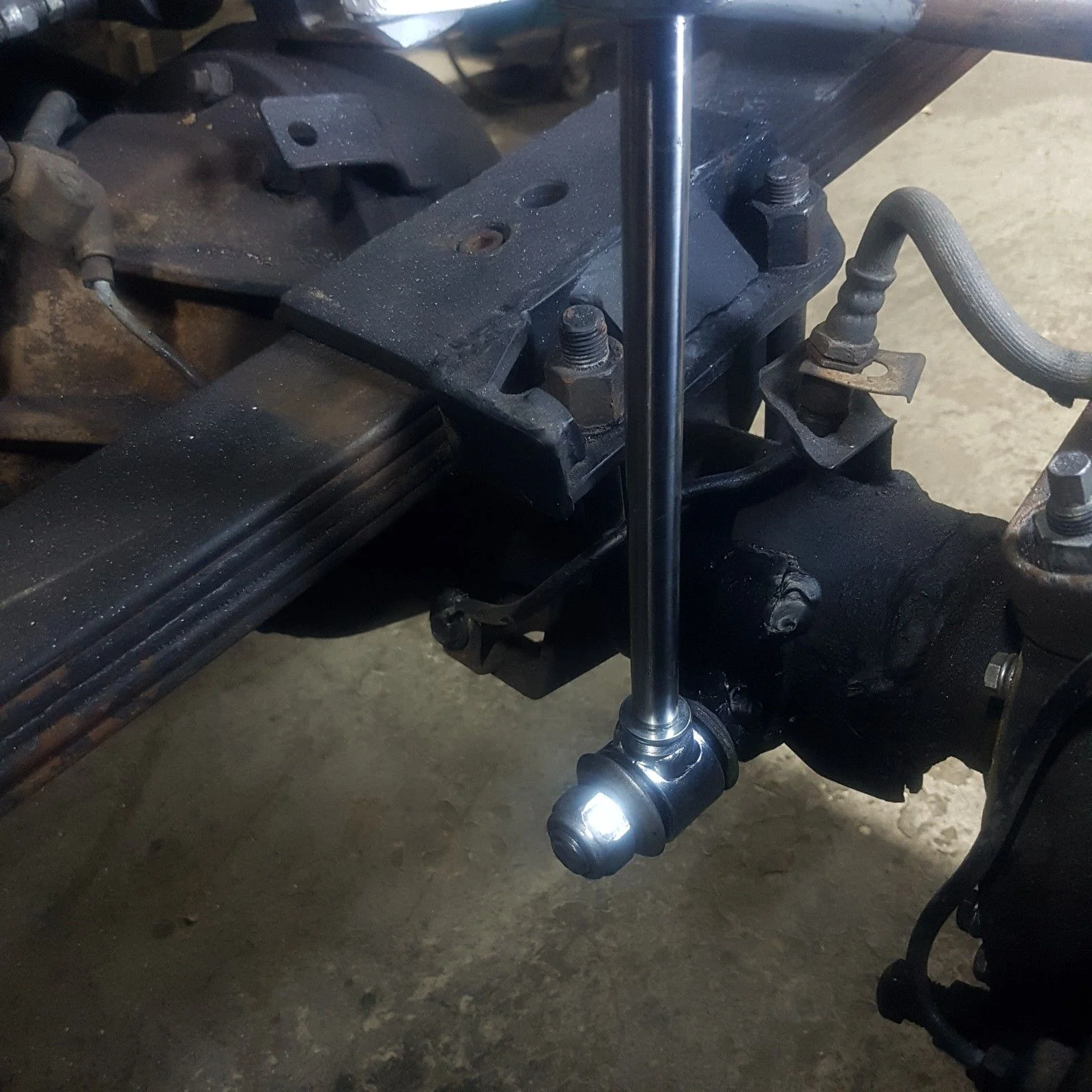

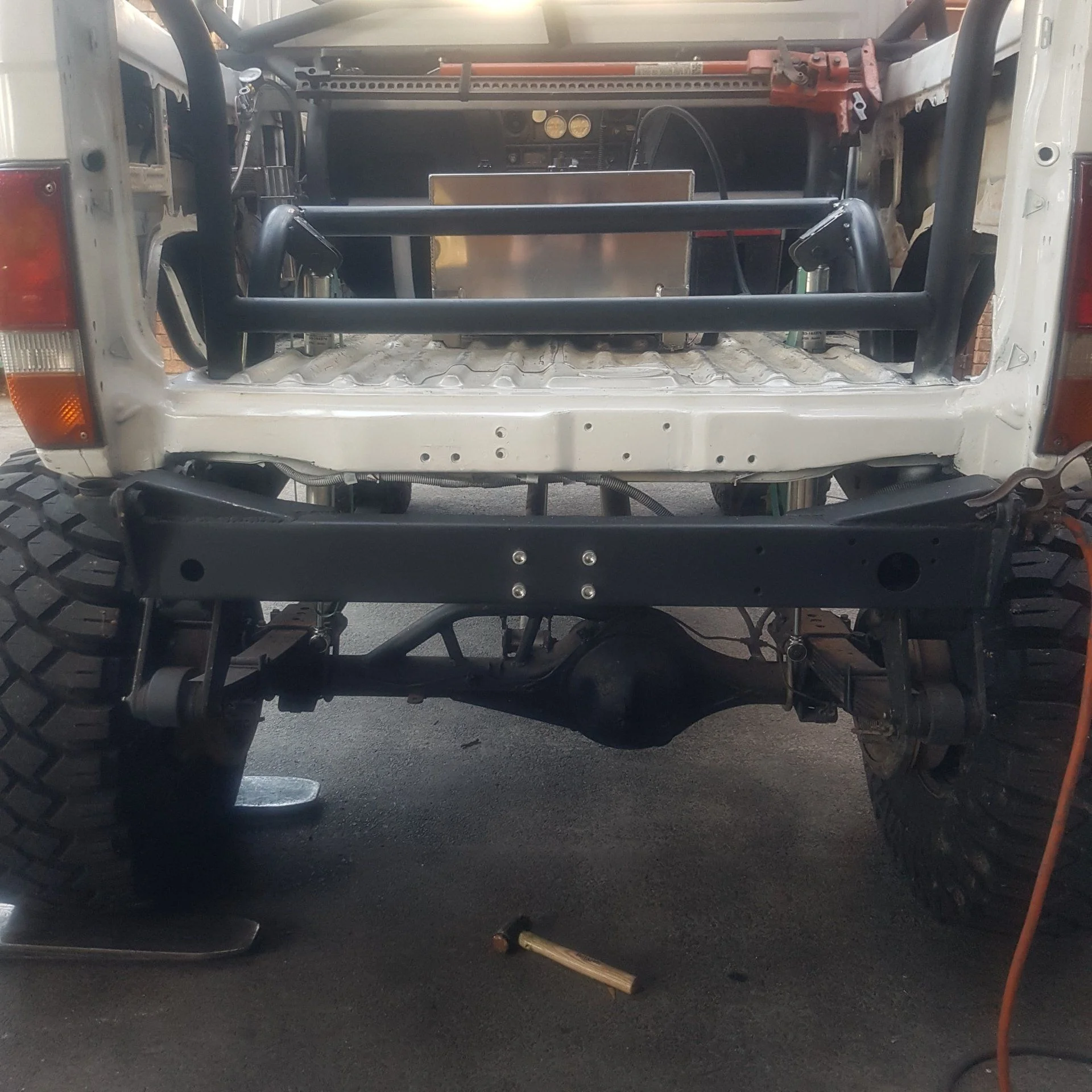

14 inch bilsteins moved inboard of the frame,

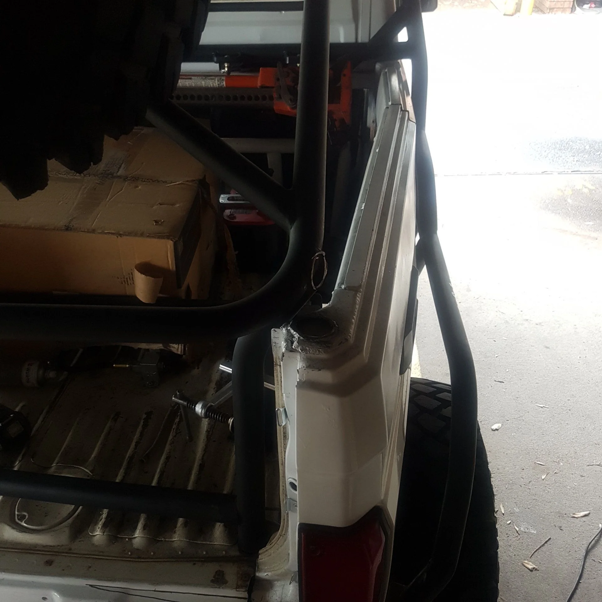

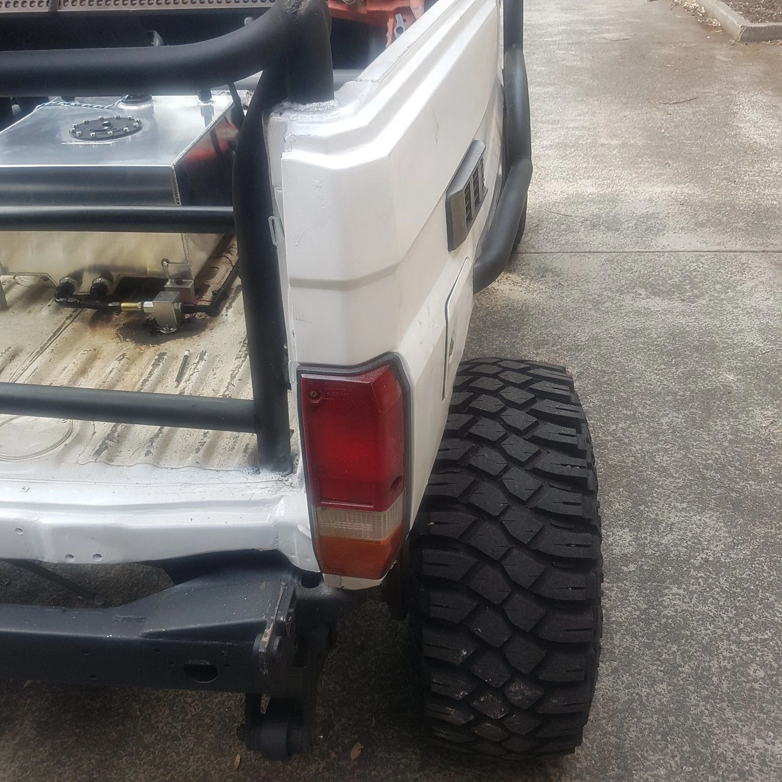

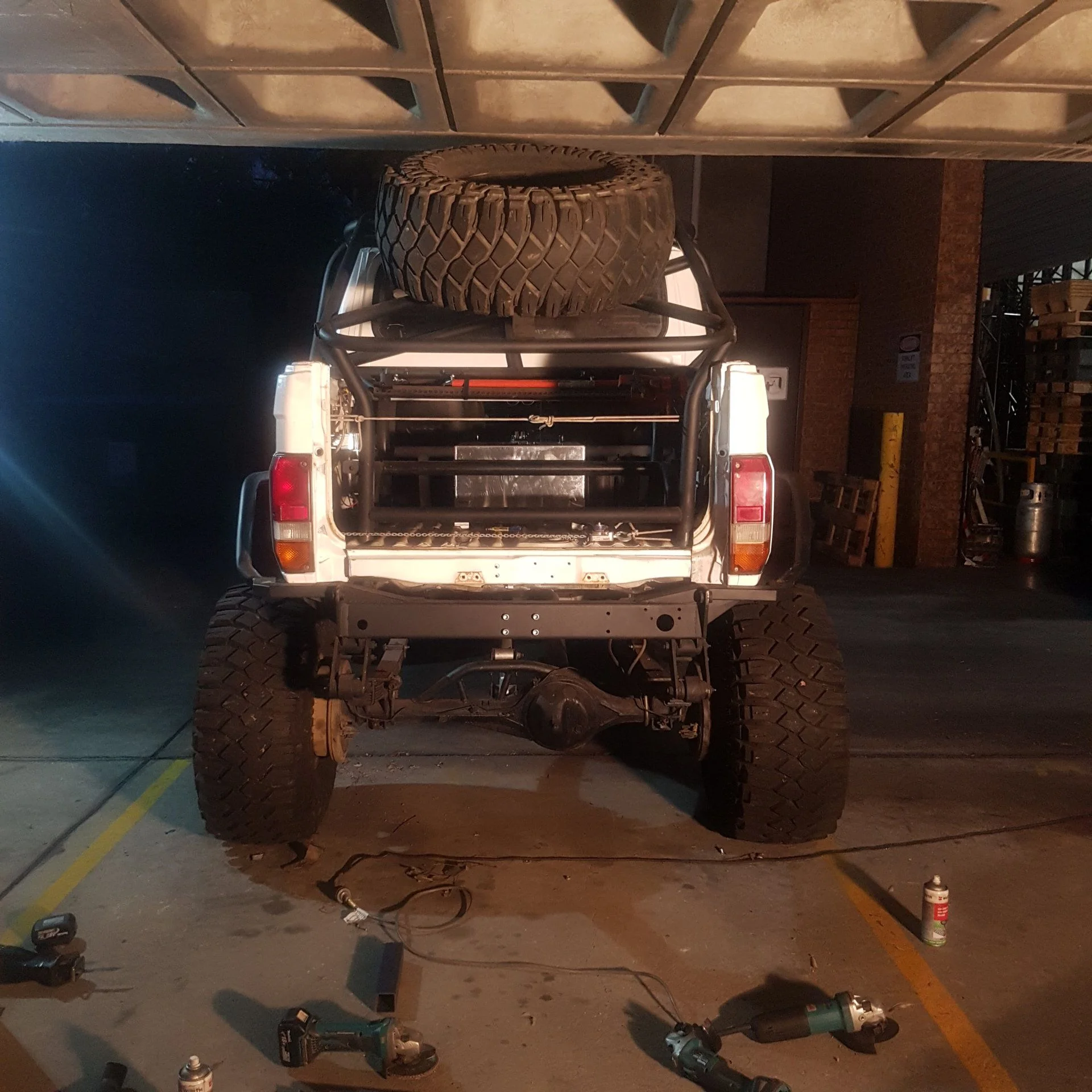

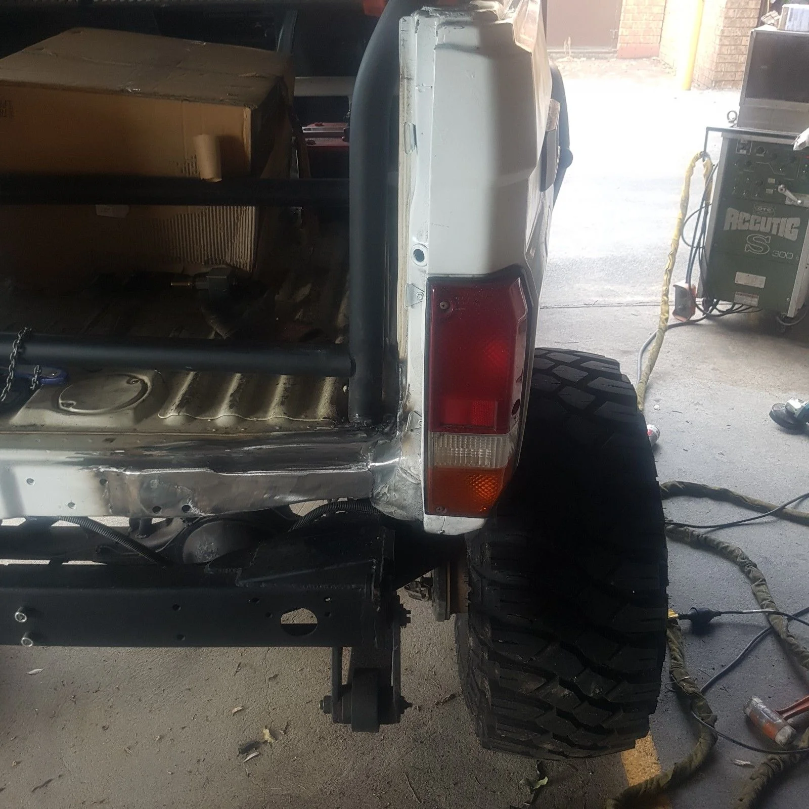

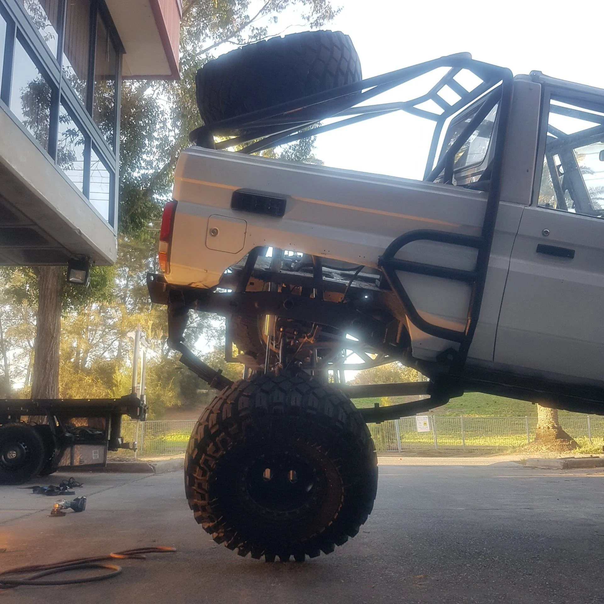

Rear quarter tubes added, mount onto the rear hoop frame,
That's a ton of suspension flex. Love it.

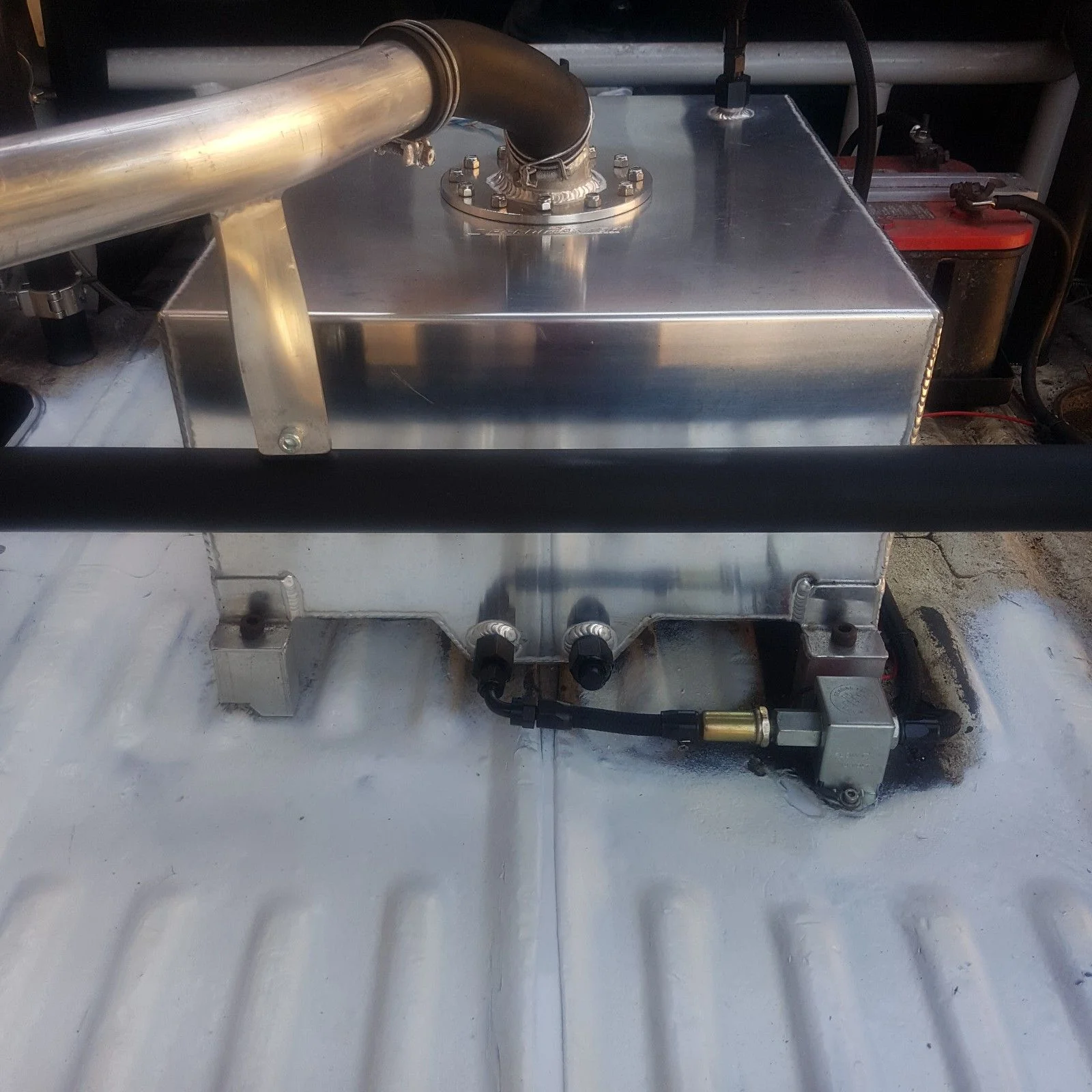

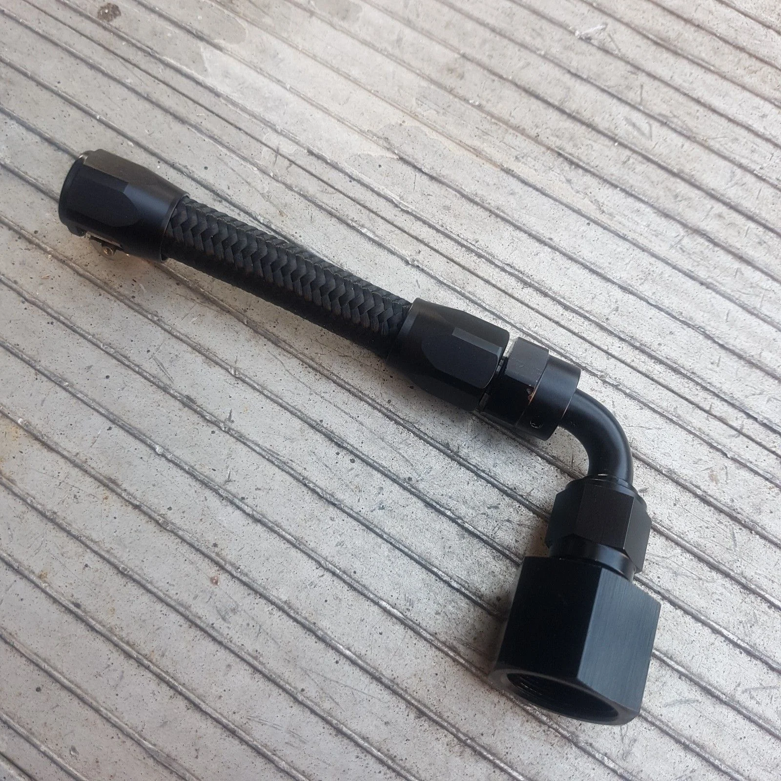

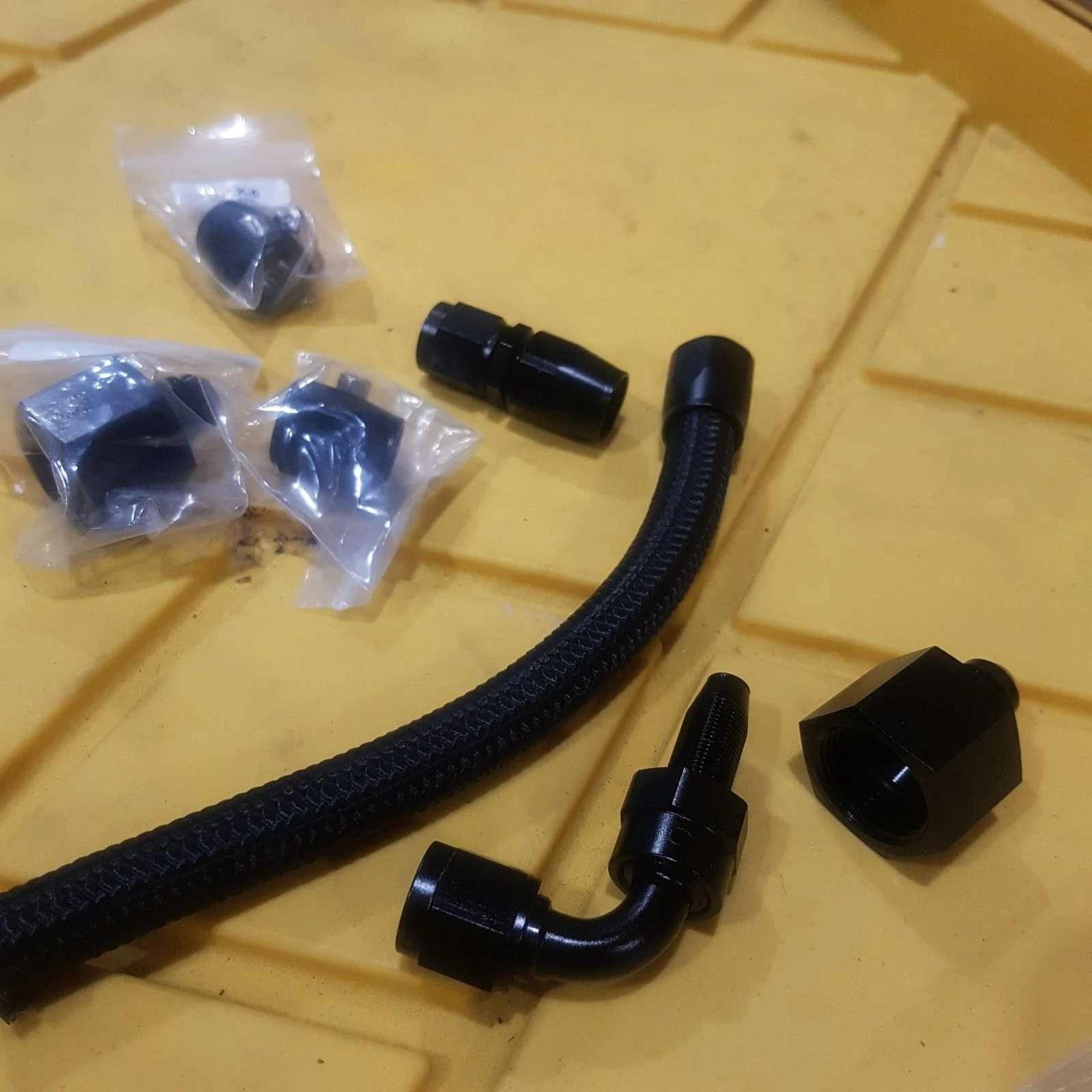

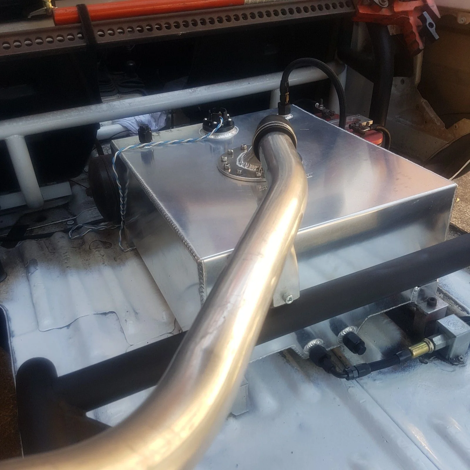

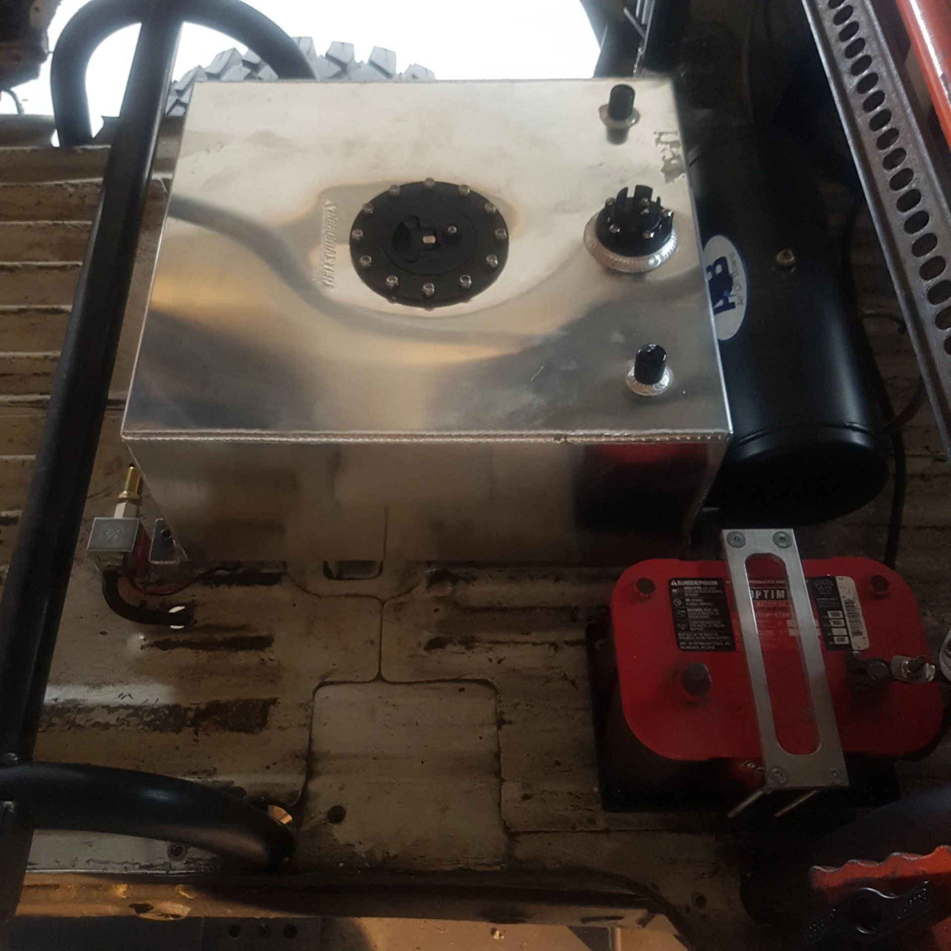

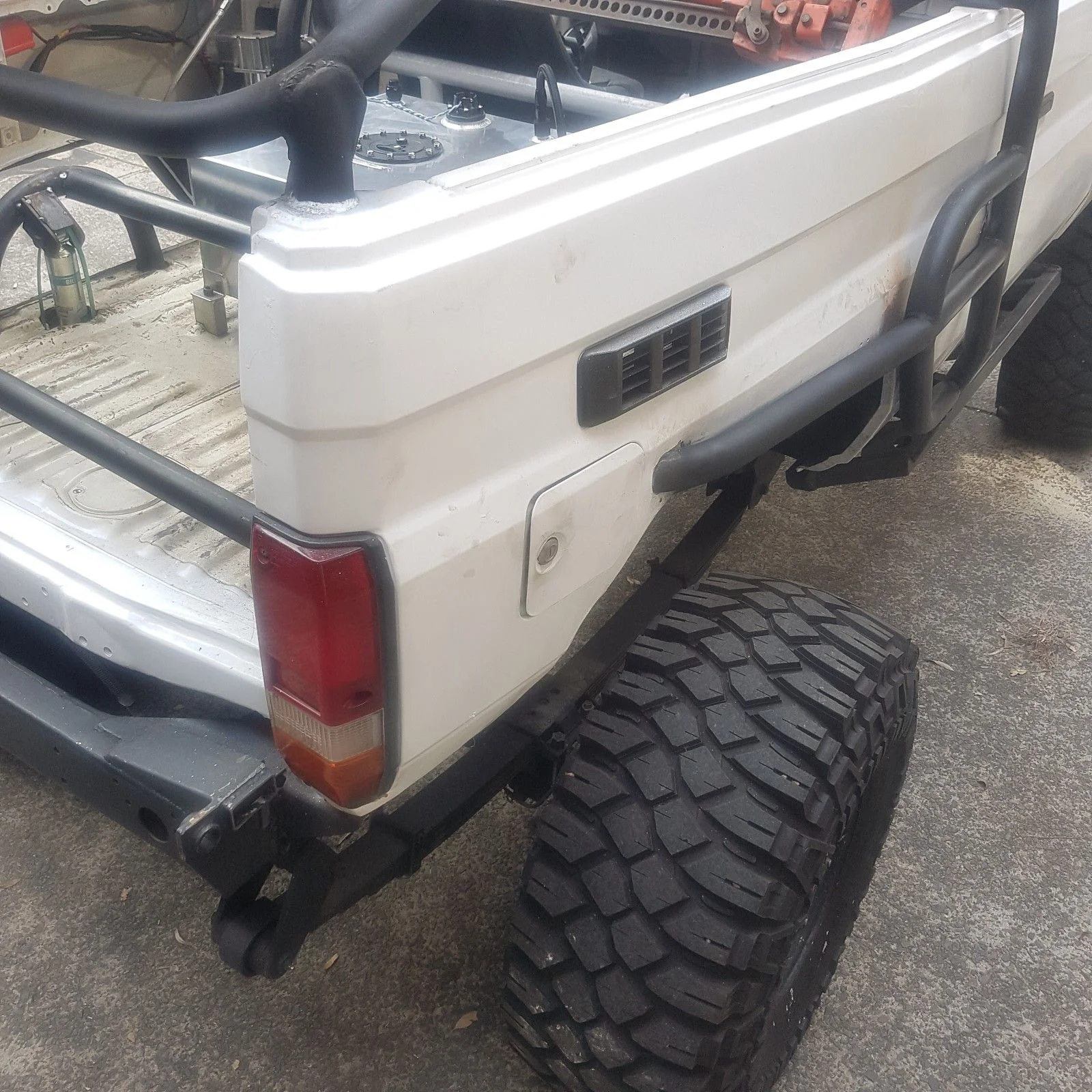

Fuel filler sorted, was pretty difficult filling to the middle of the bed,
70mm to 50mm reducer angled fill,
Billet fill cap,
