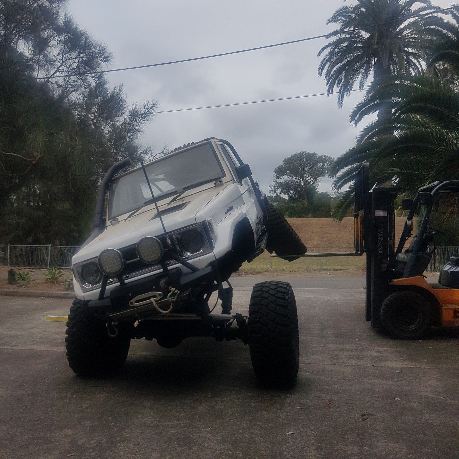

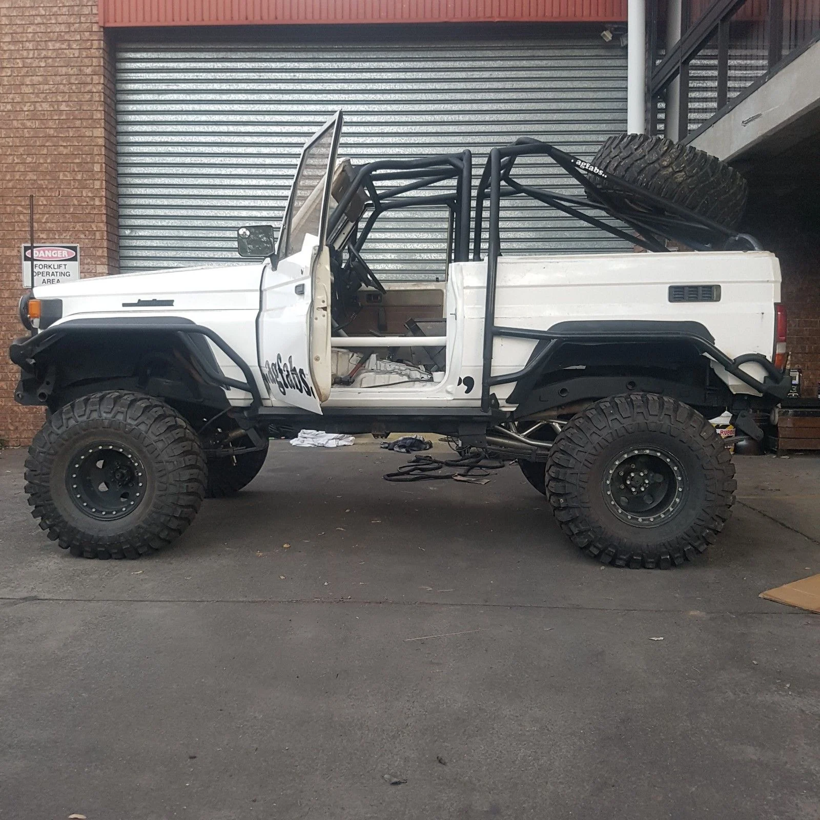

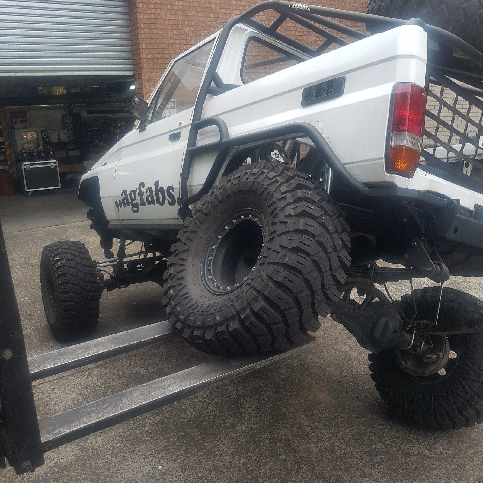

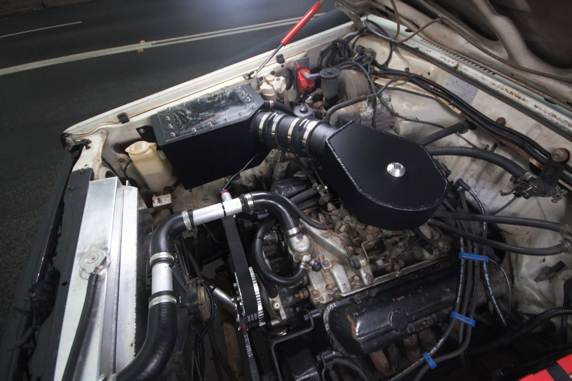

Started life with me with the GM 308 5l motor swap and 4 inch lift,

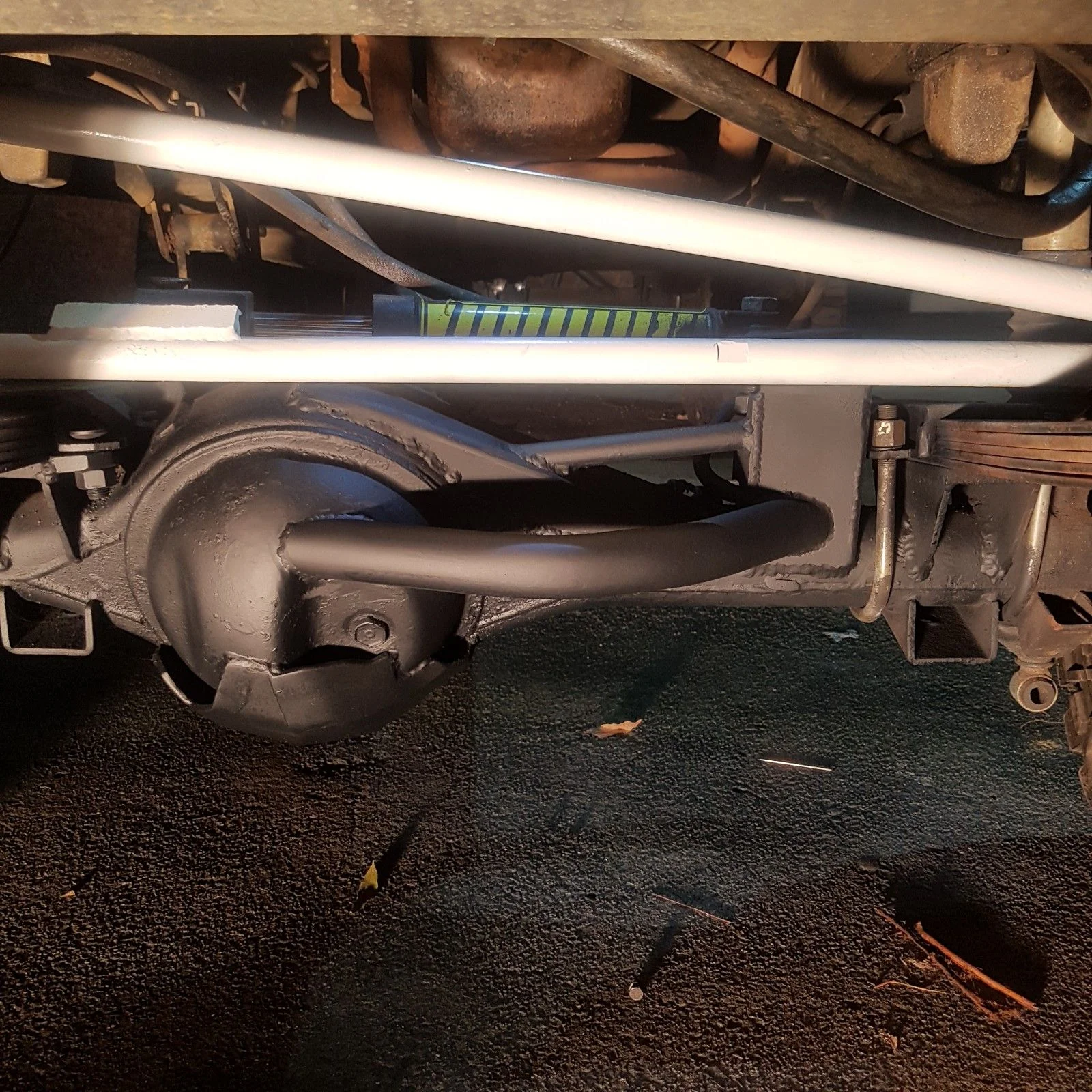

Nice. What leaf springs are you running?

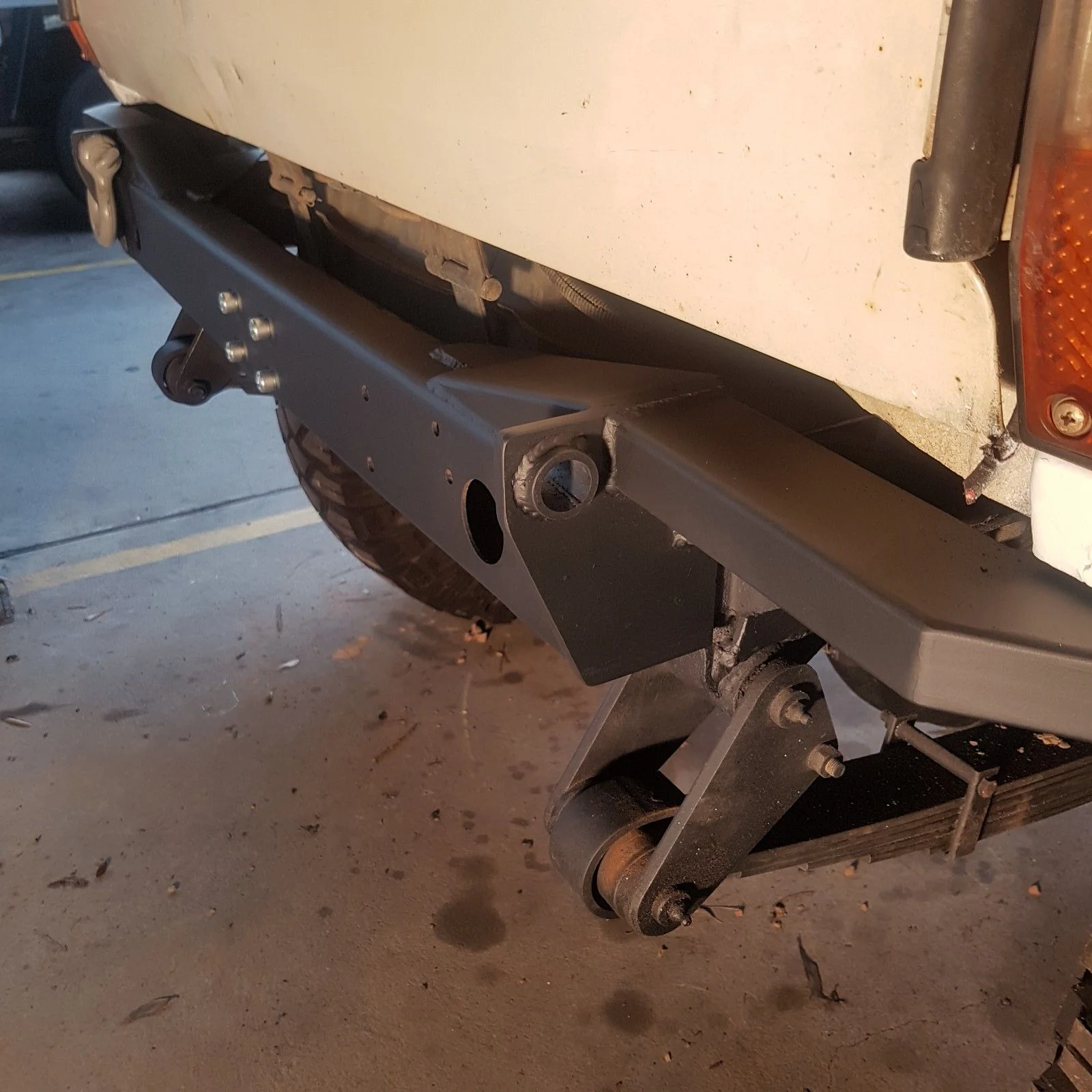

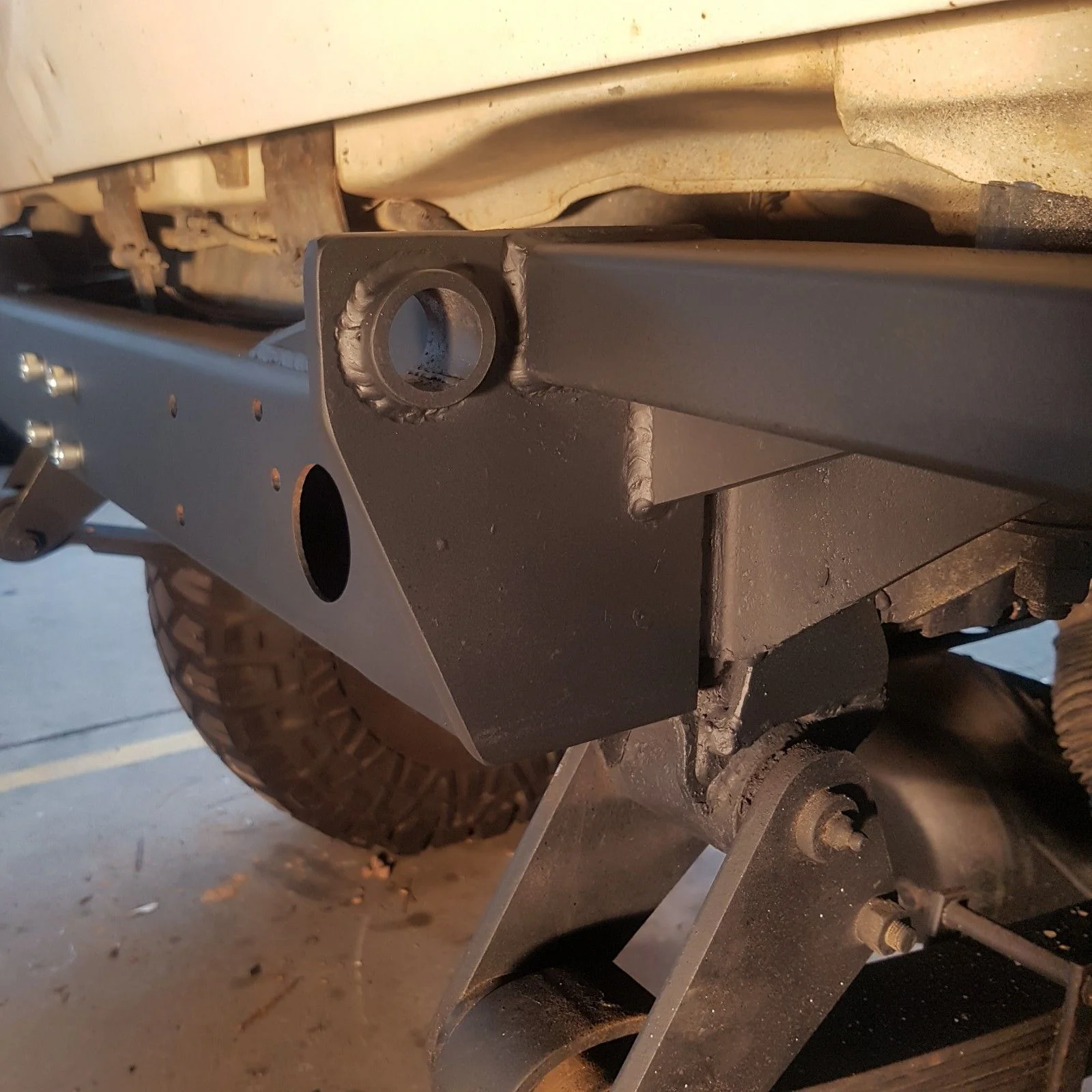

Bastard packs all round. The rears are 78 main and armour with a few 4 inch lift leaves. Relocated hangers front and rear. Front is RUF 4 inch springs main and armour and a few 4 inch front to fill the pack. Shackle reverse up front using basically factory positions.

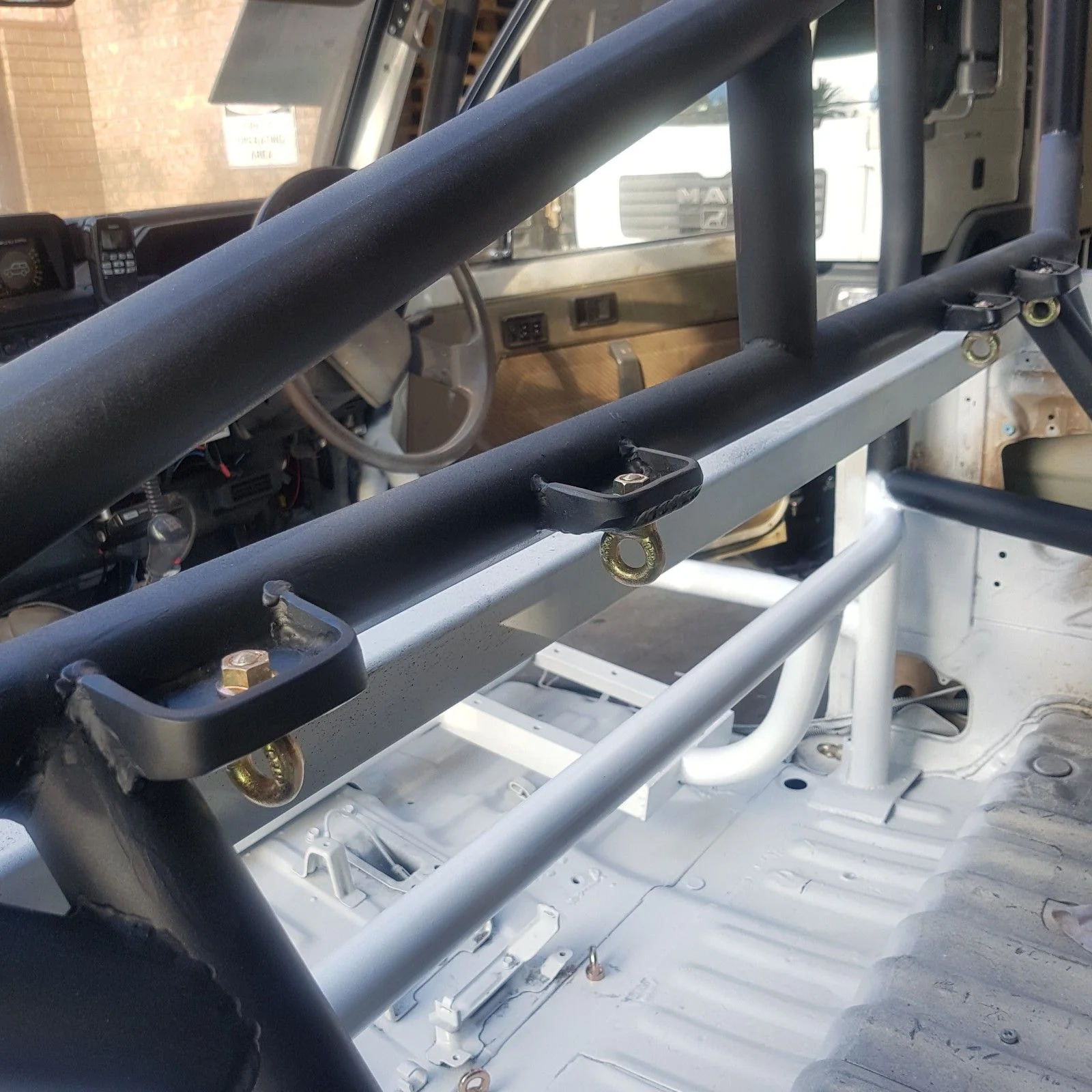

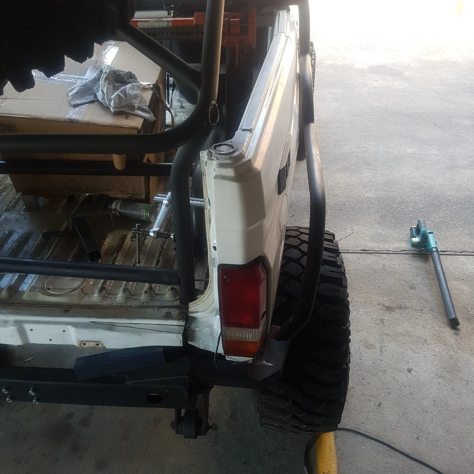

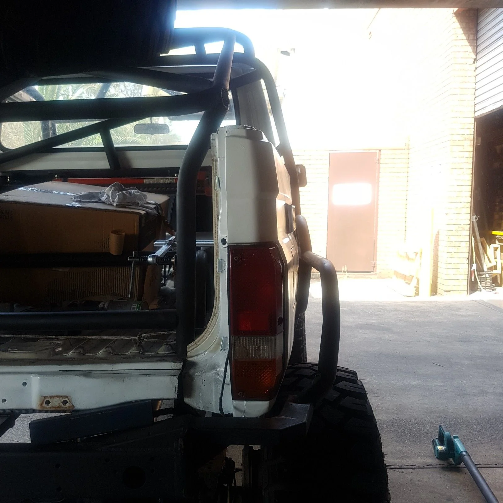

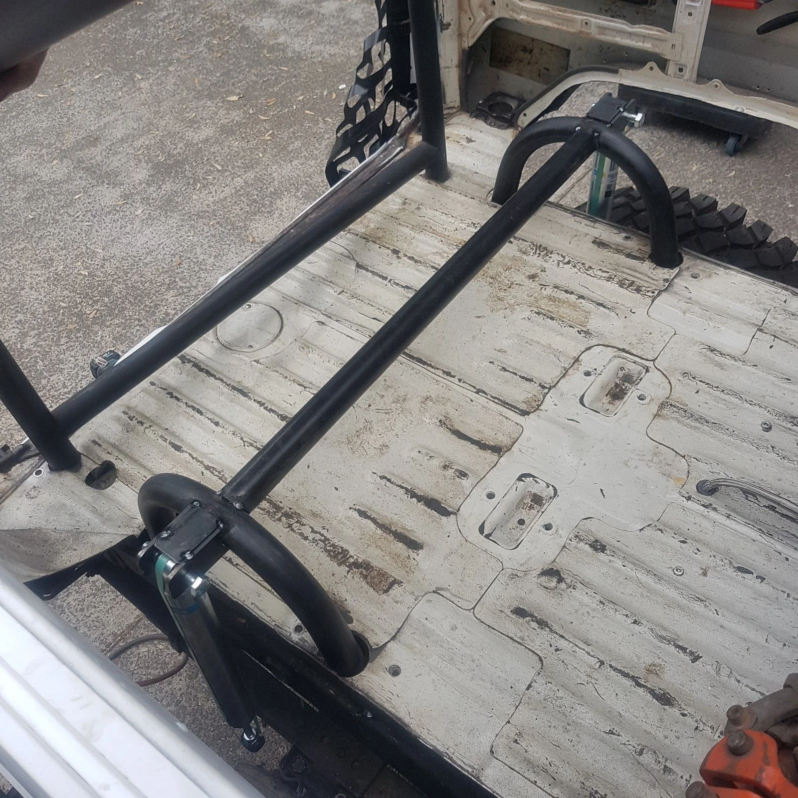

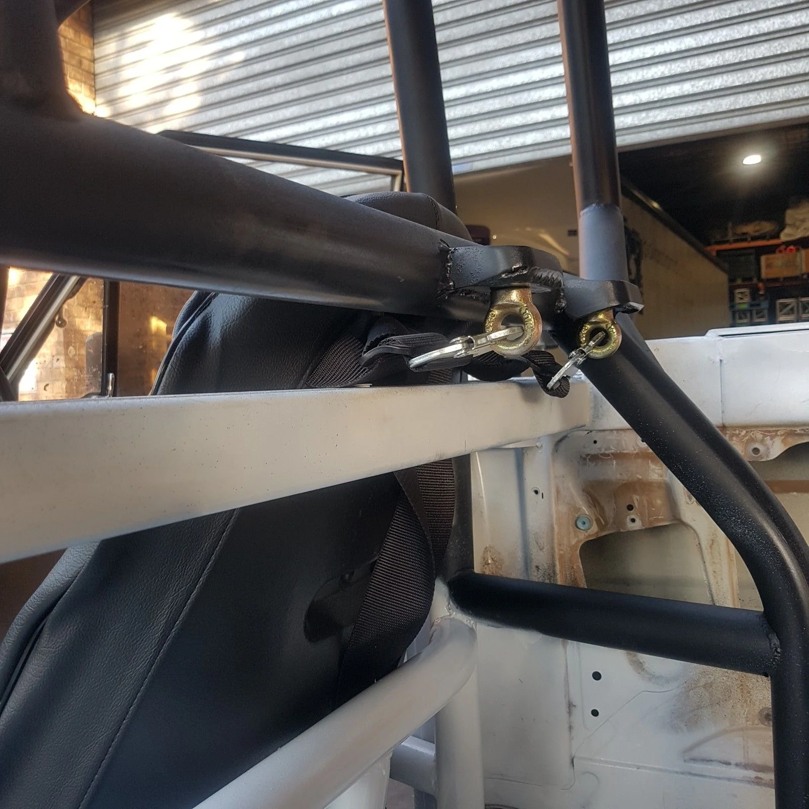

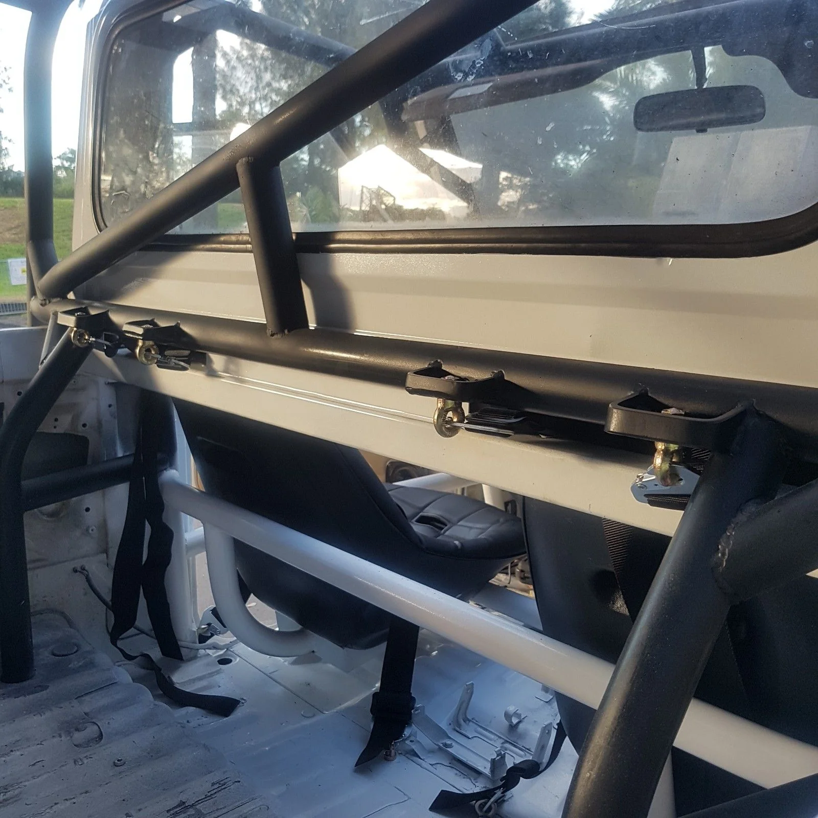

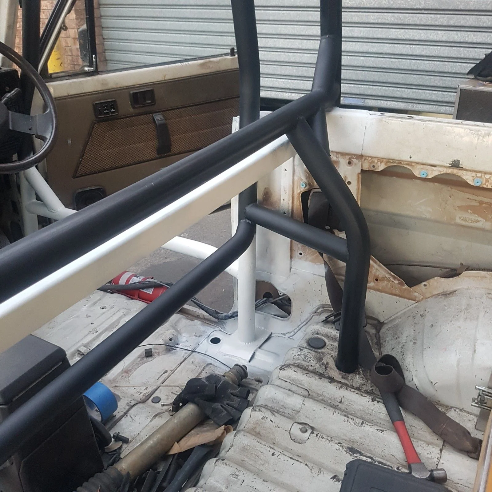

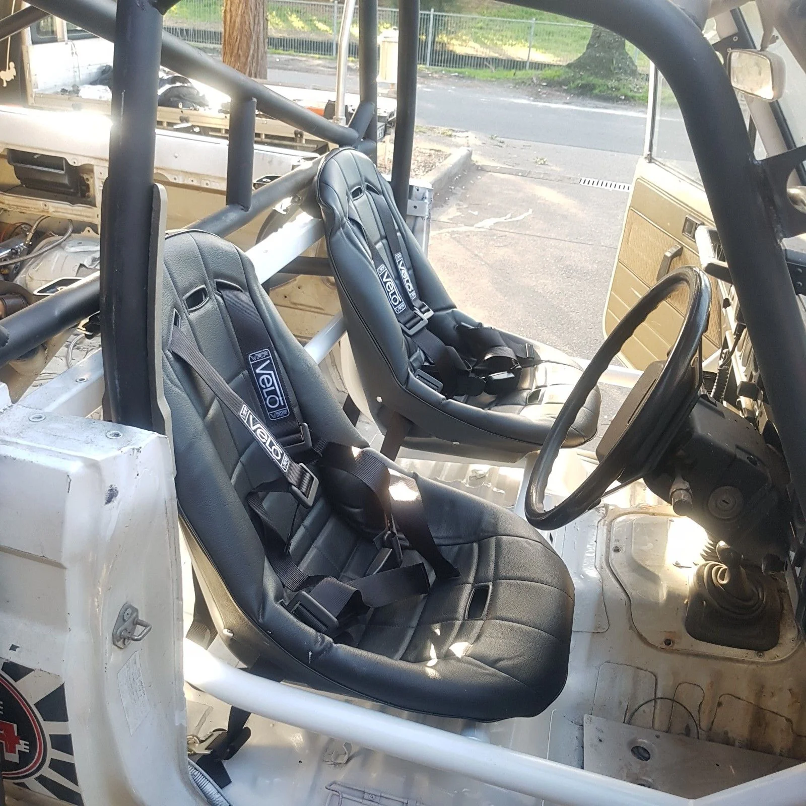

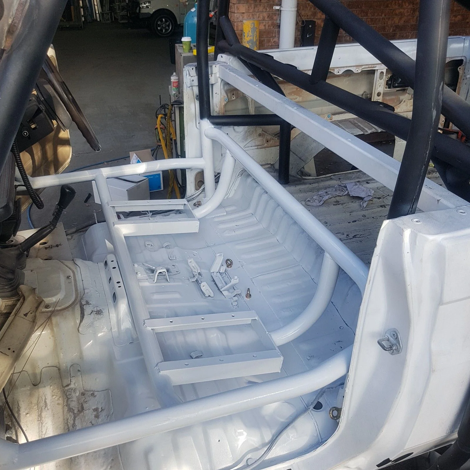

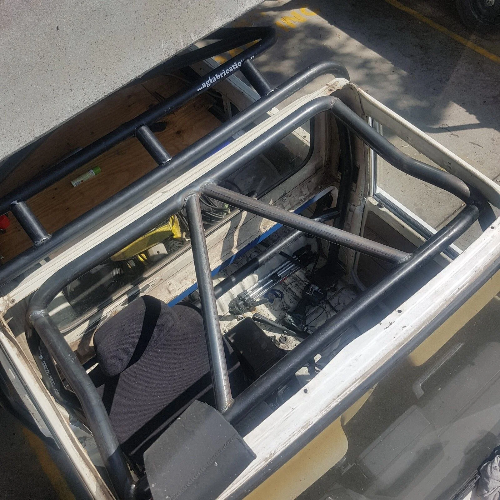

Full floating seat mounts will make hosing out the cab a breeze, harness attachments,

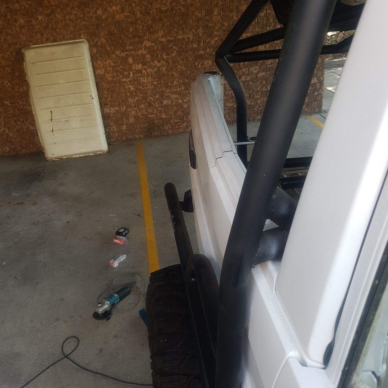

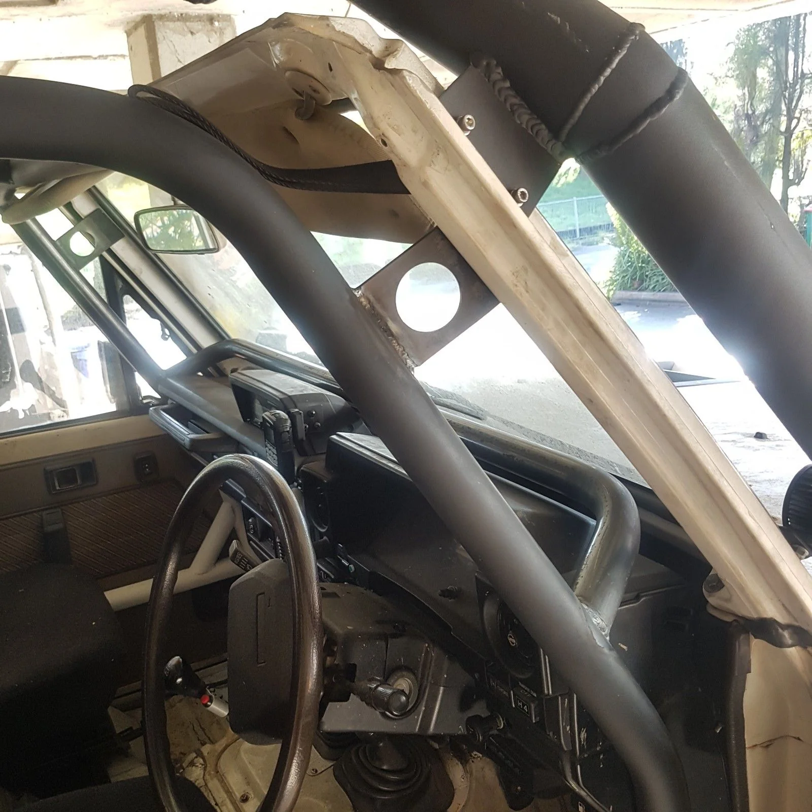

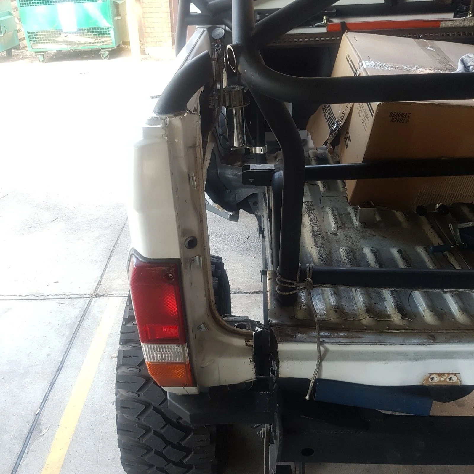

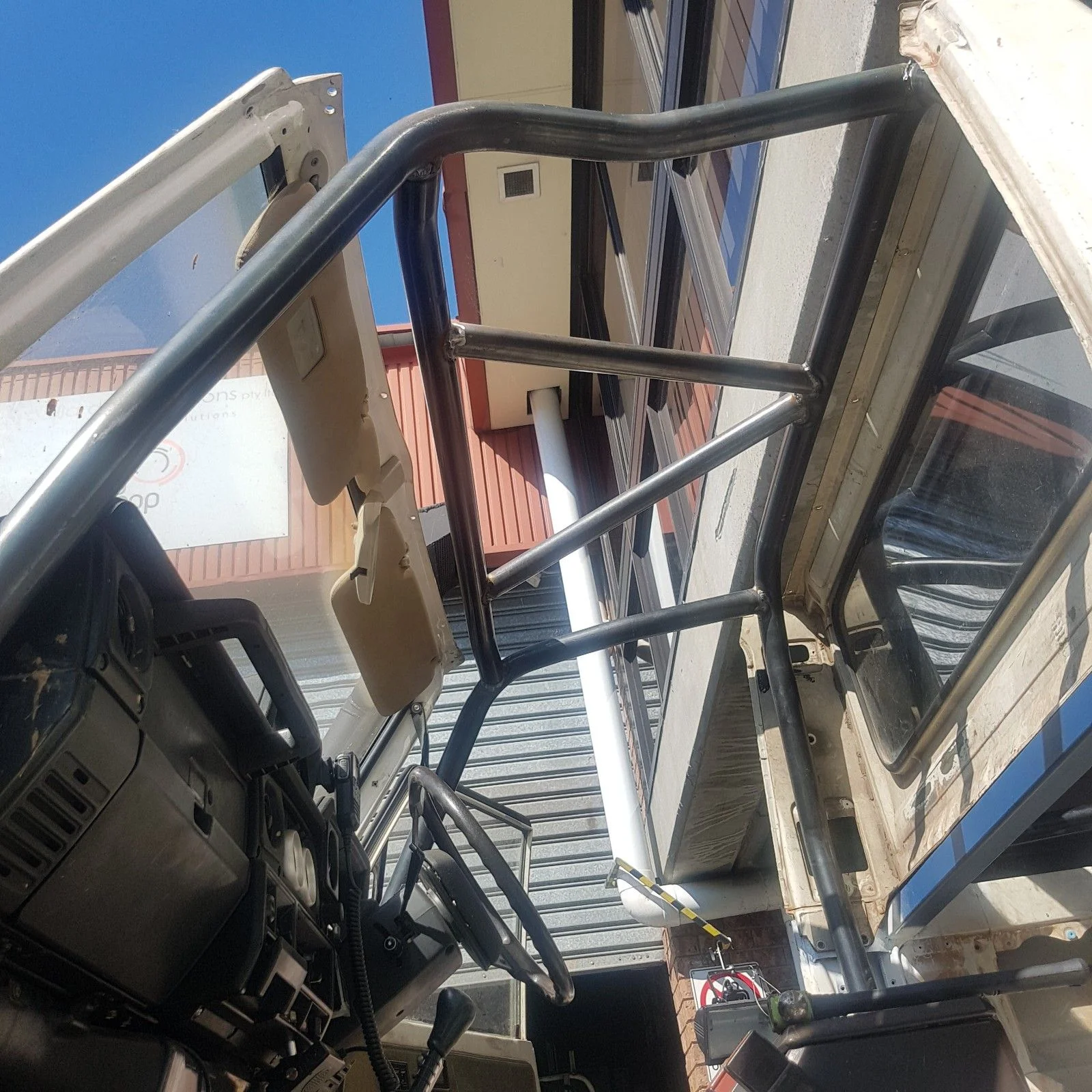

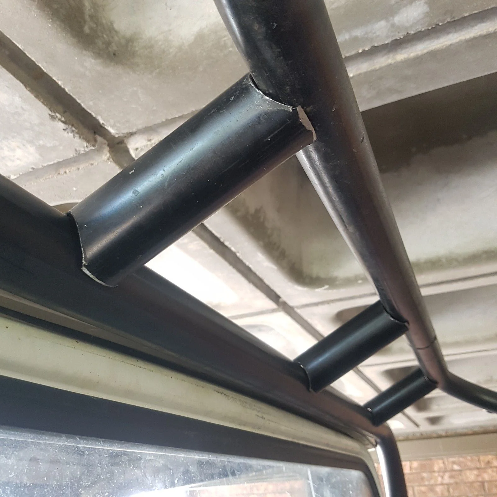

You can see the cutout to mate the FJ75 roof to the 73 body work, and cross bar to hold the rear screen,

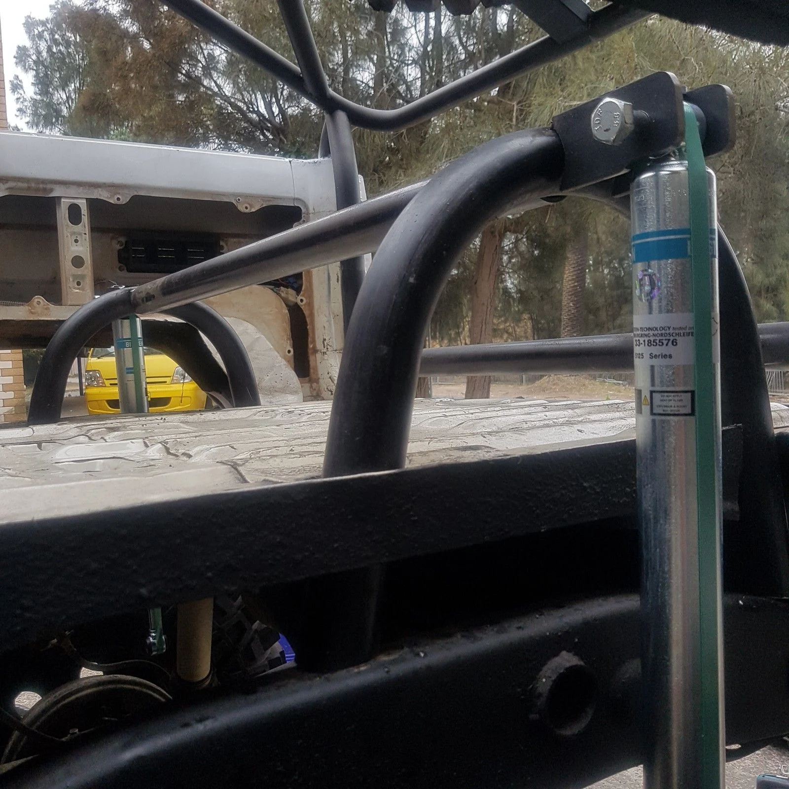

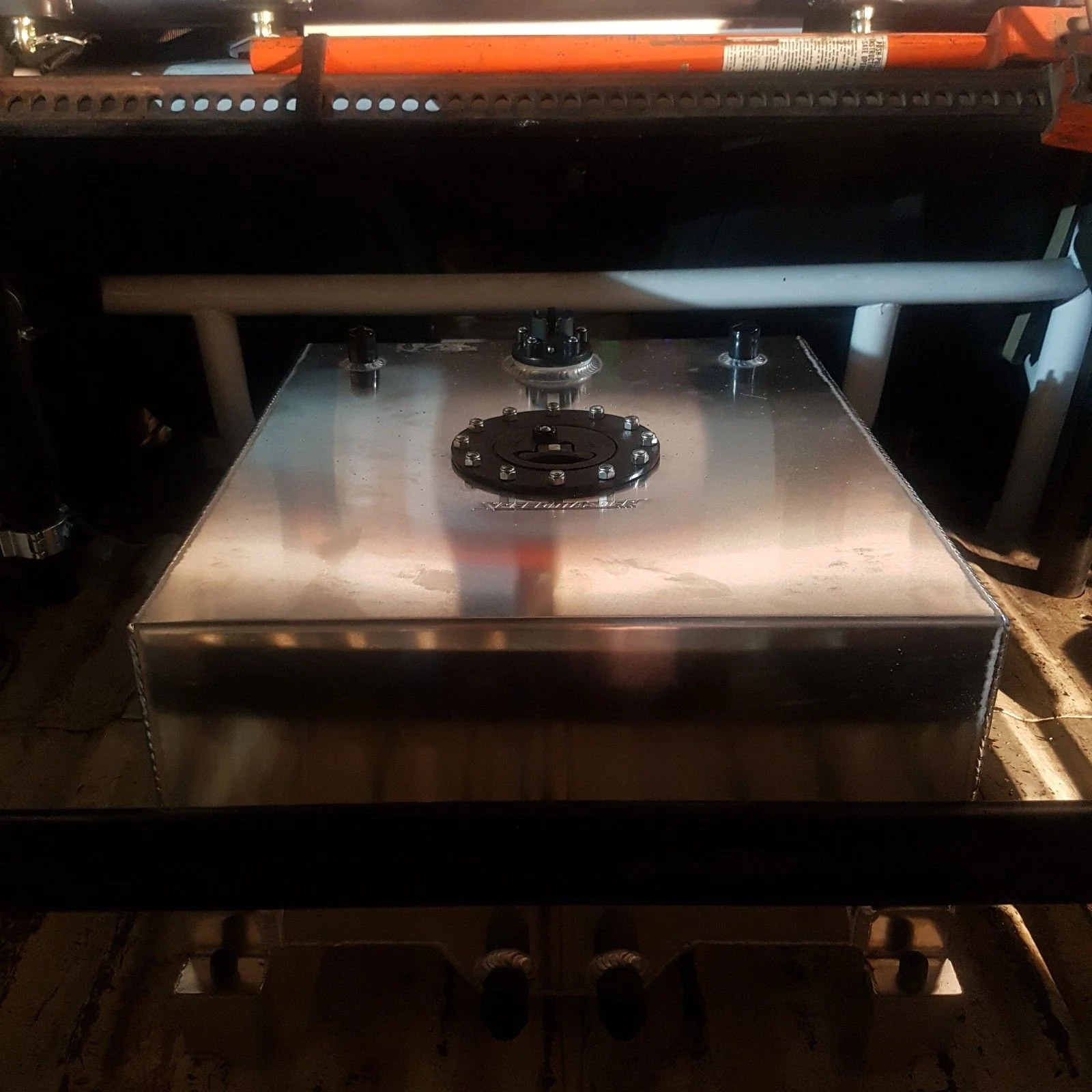

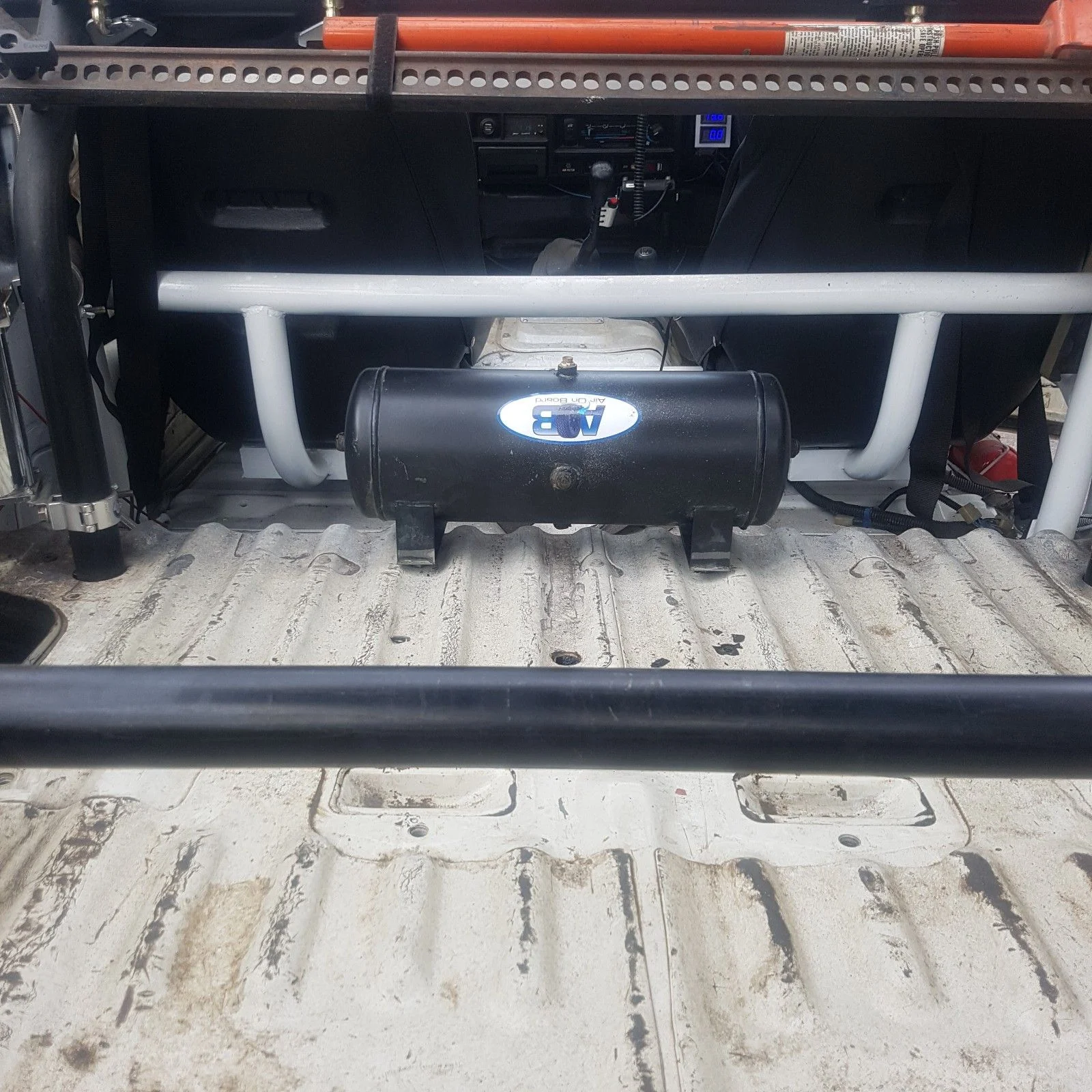

Moved the air tank onto the top o f the tray,

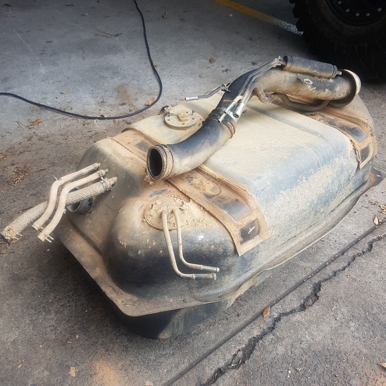

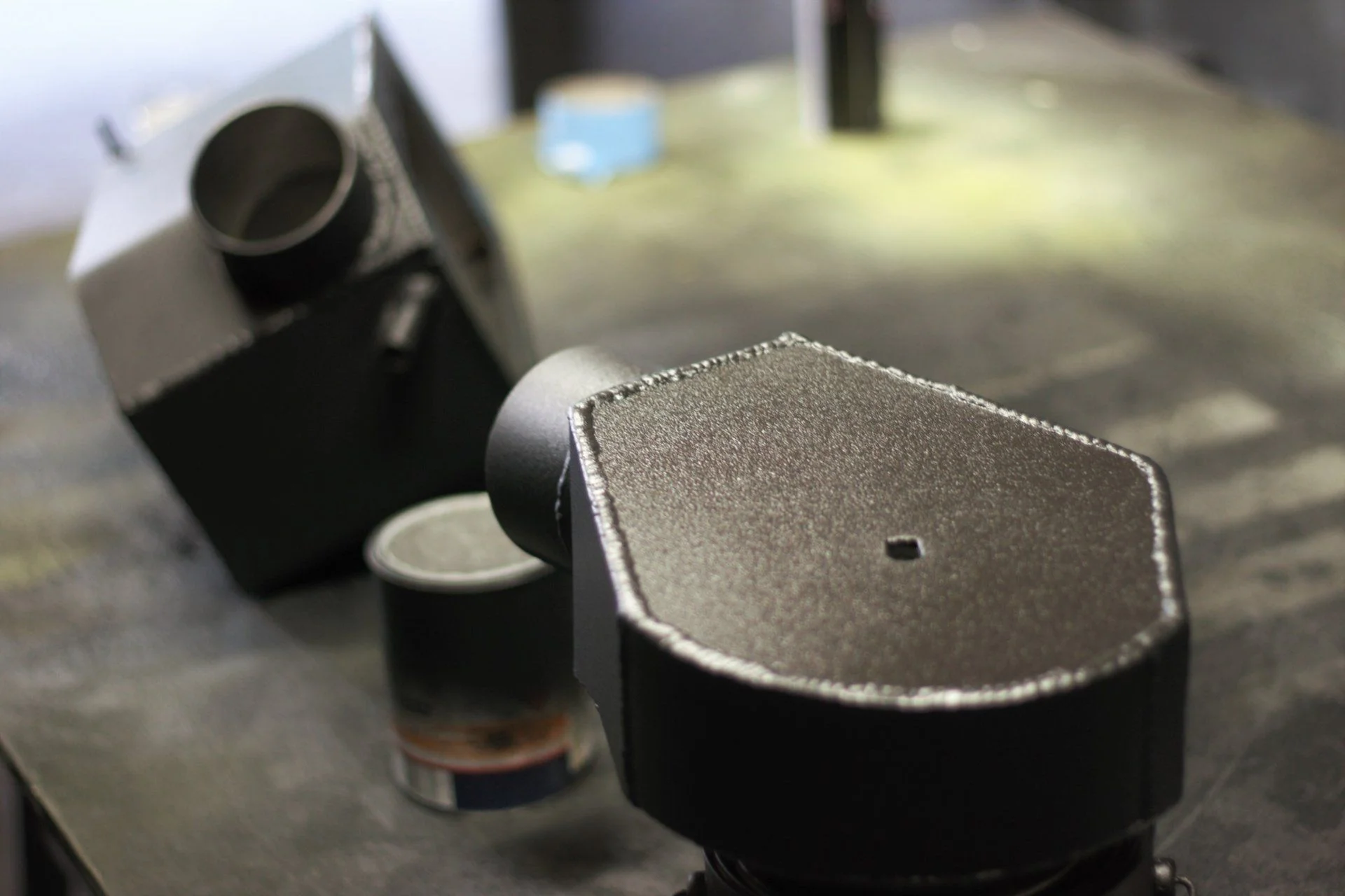

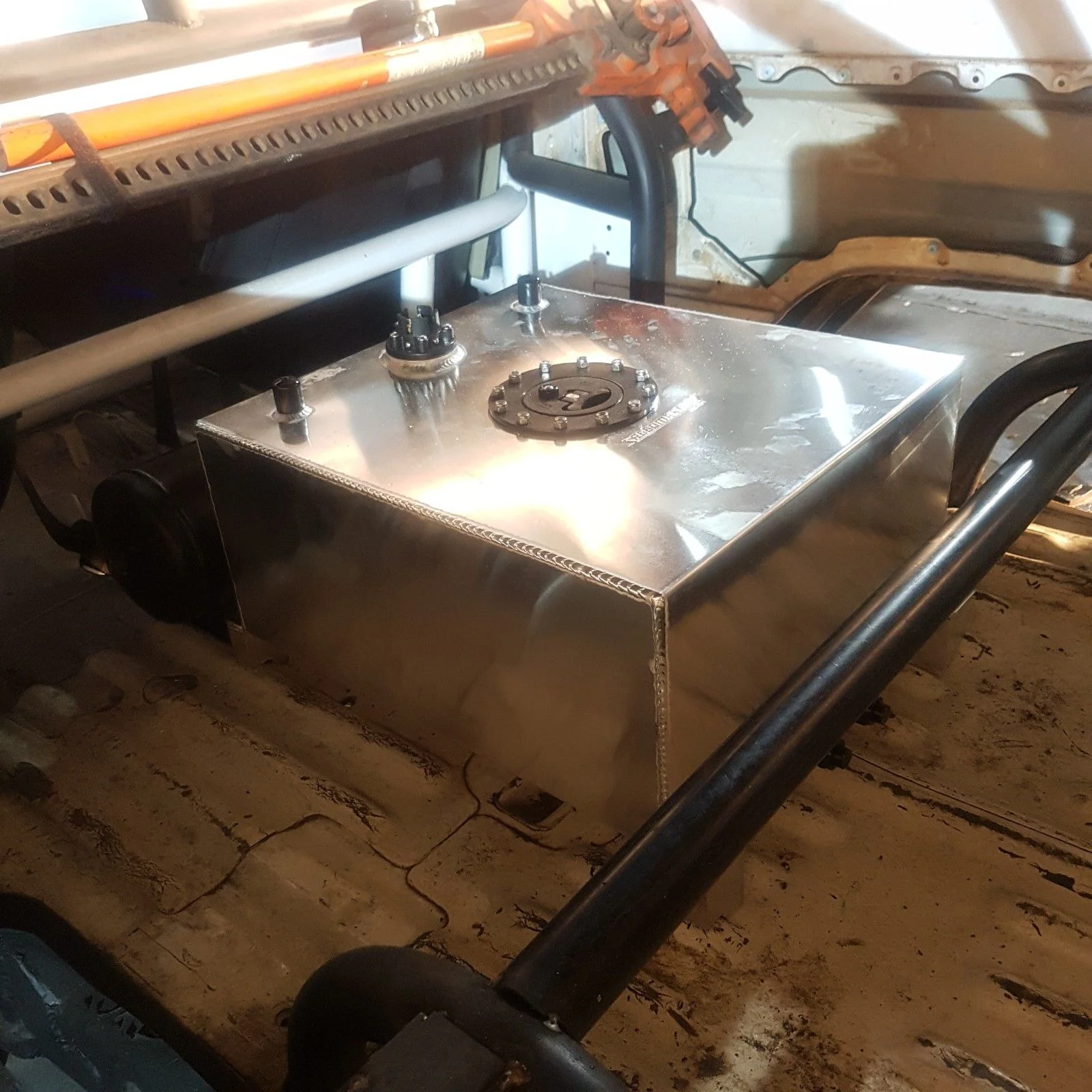

Out with the Factory 90L tank,
Mounted up a 60L fuel cell,
