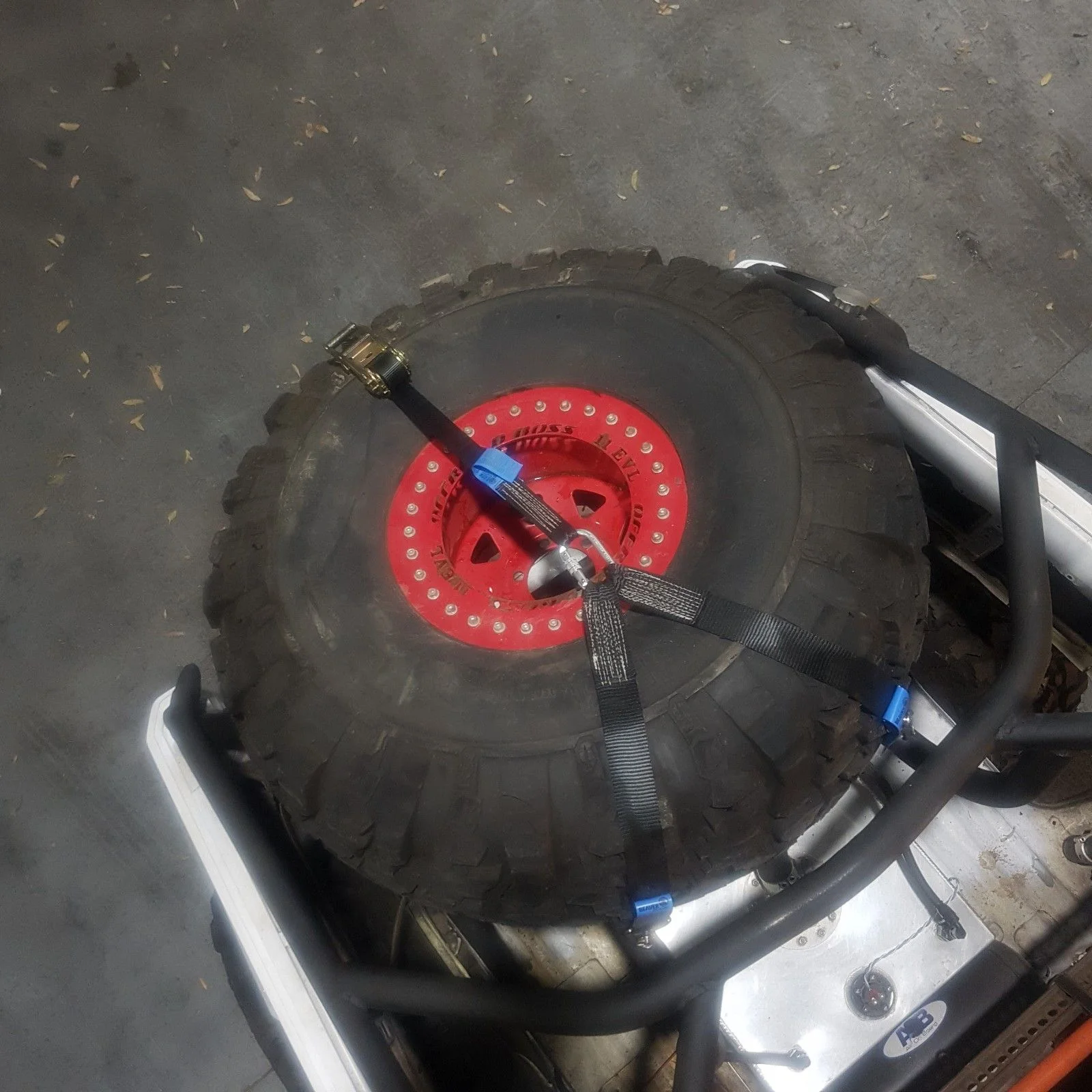

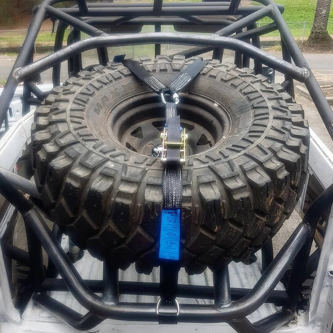

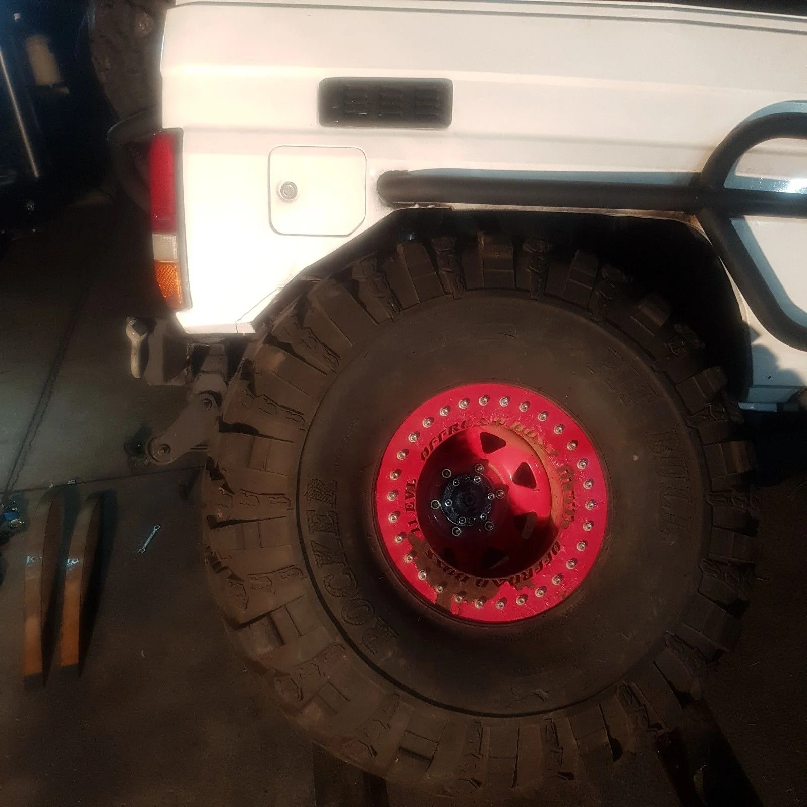

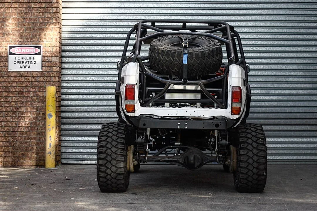

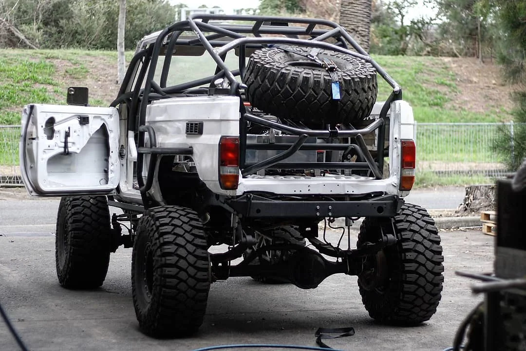

Rebuilt the spare wheel carrier, Sunk it some and set it rear ward a bit, with room for 42's,

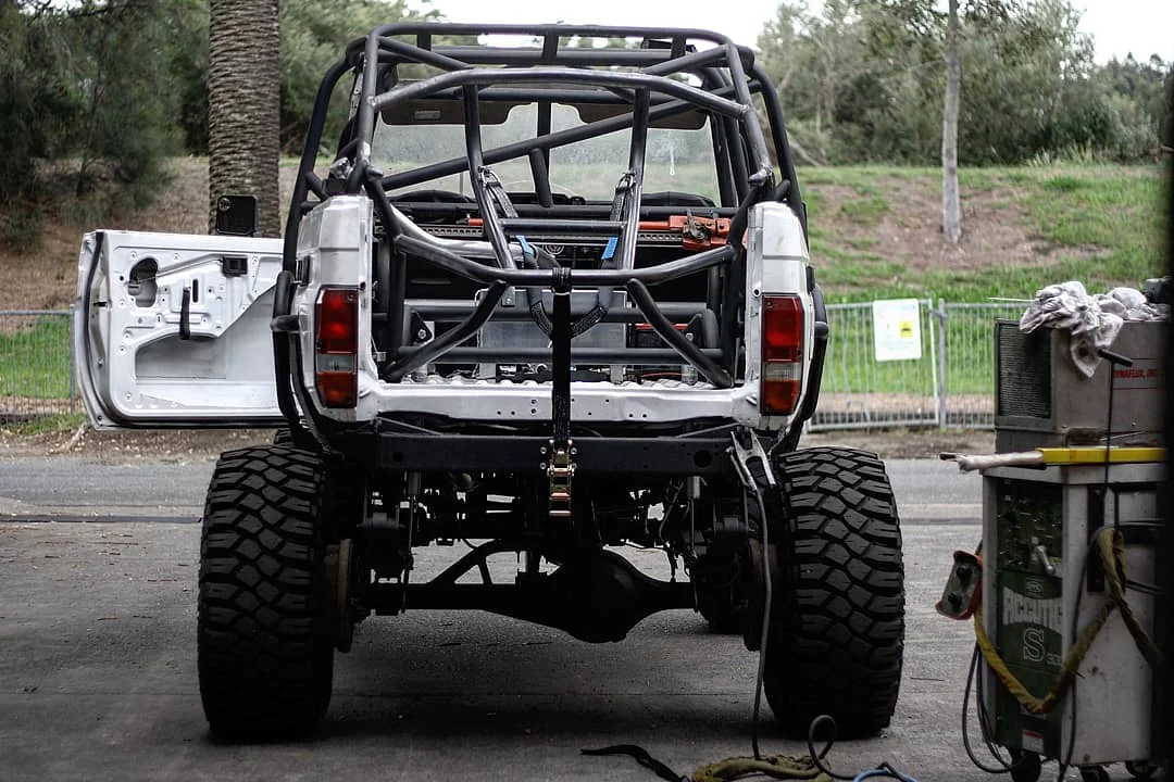

Y strap,

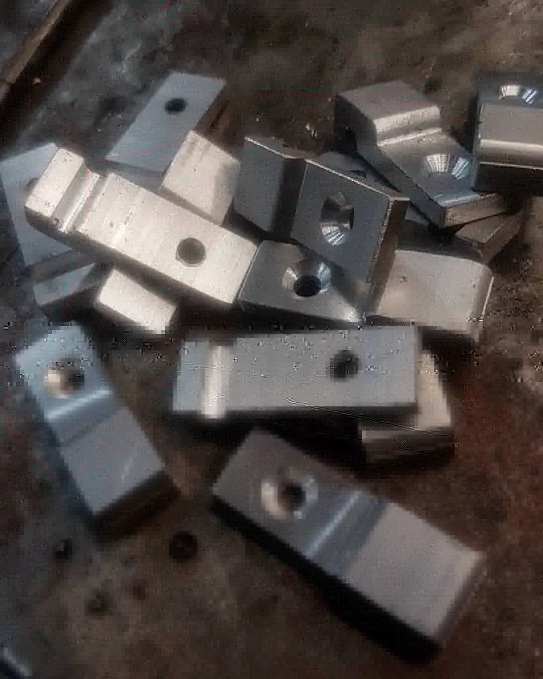

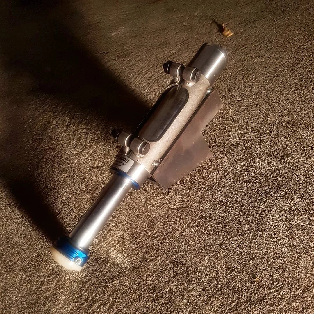

Have a question on that hand brake. Does it lock on, like an ebrake, or is that for drifting only?
It does lock. See the slotted area there's a drop down pole that wedges on the slots. Pretty cute design actually. They do say thou that hydro brakes aren' ment to be used as a stand alone park brake as if there's pressure loss the brake let's go. But for stop start use it' perfect
What model is that unit? I am needing that exact thing!

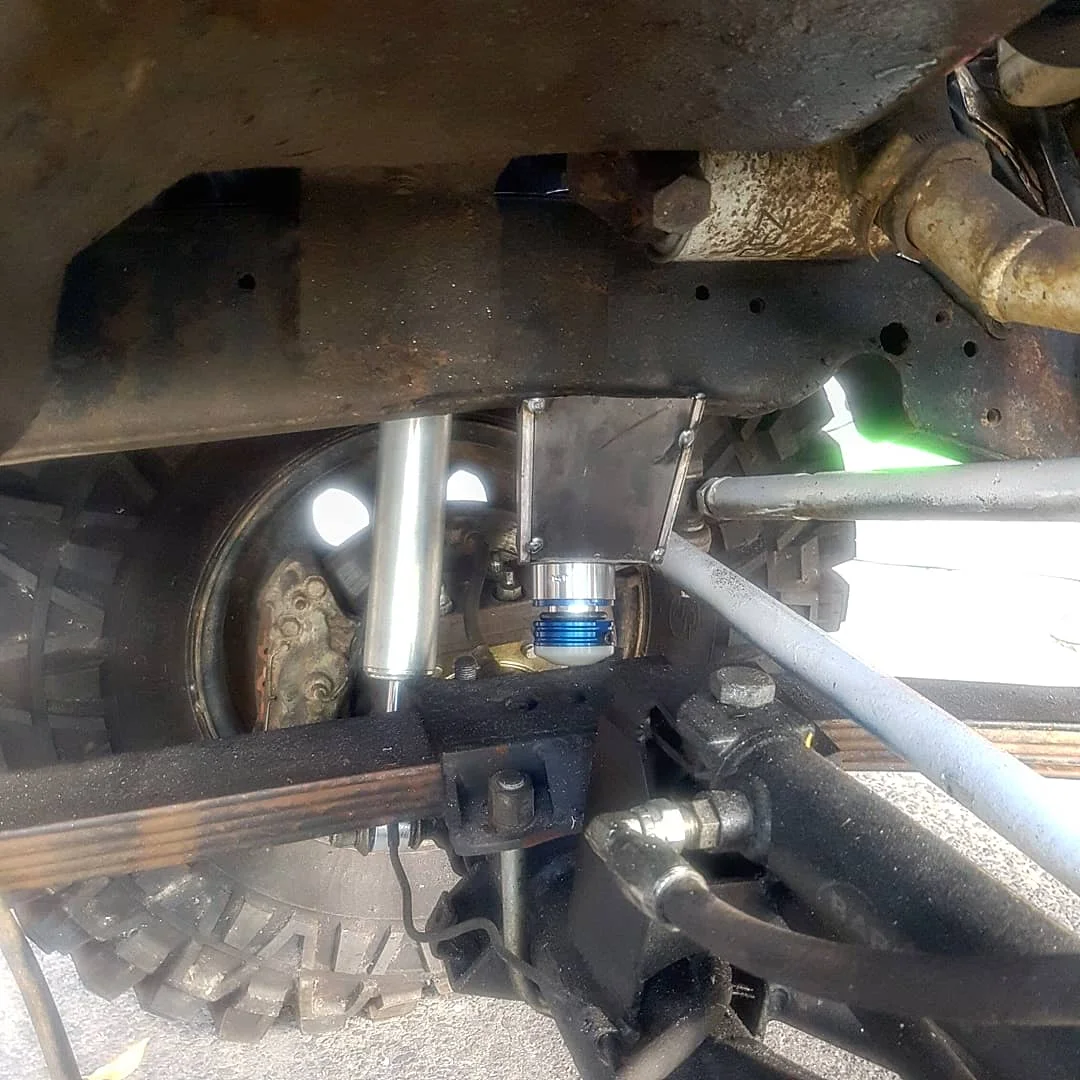

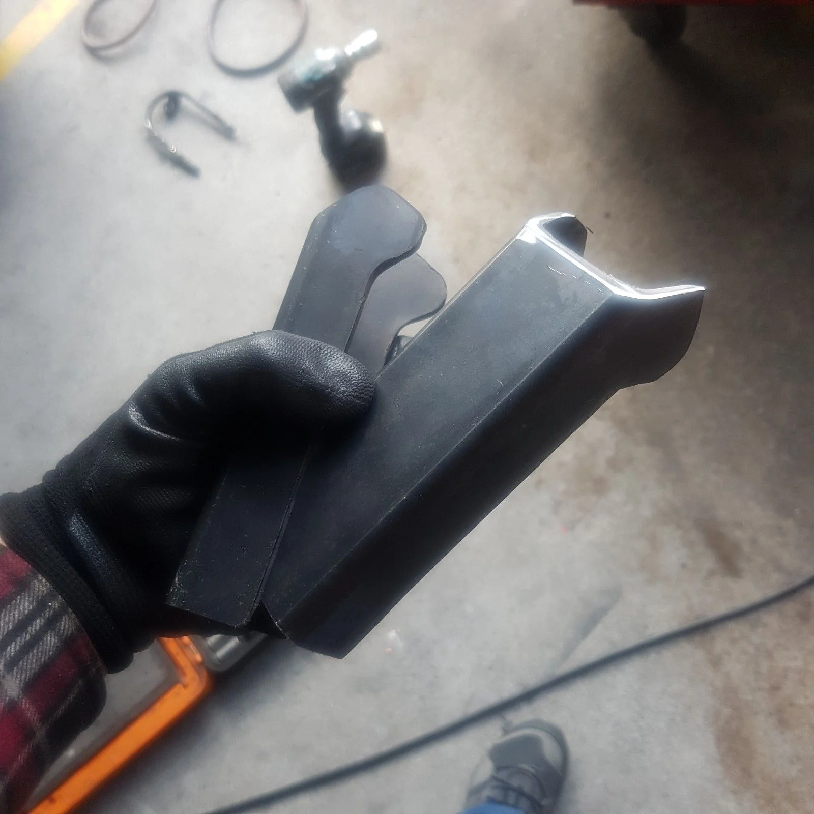

Next up Bump stops, 2x4 Profender hydro bumps,
There mounting cans and very nicely done, stout materials,
Full compression, ended up moving it up 25mm higher to get a little more tuck,

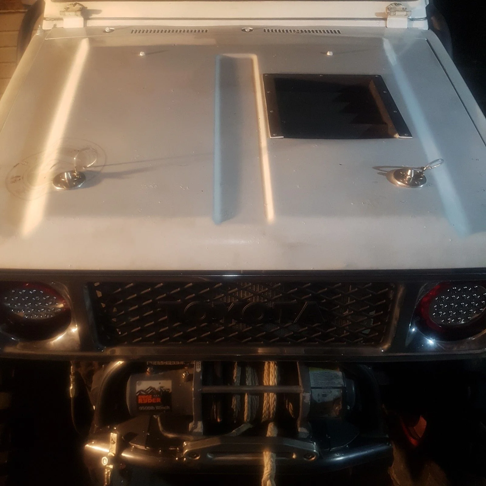

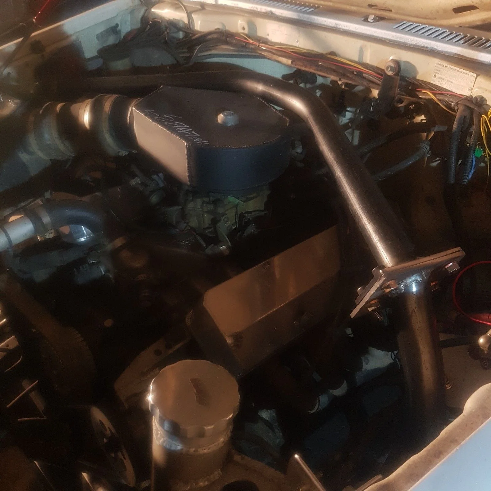

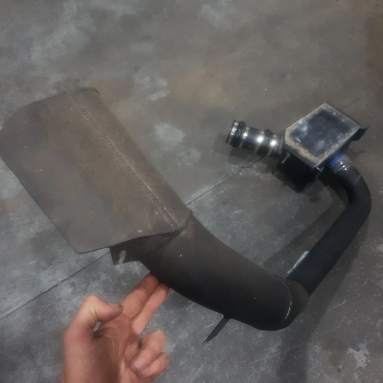

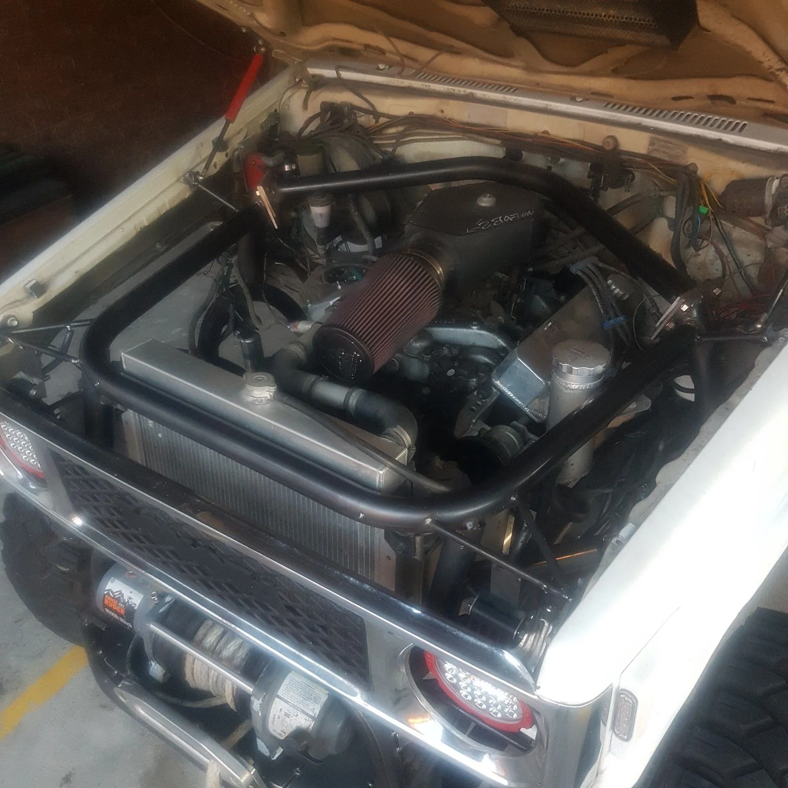

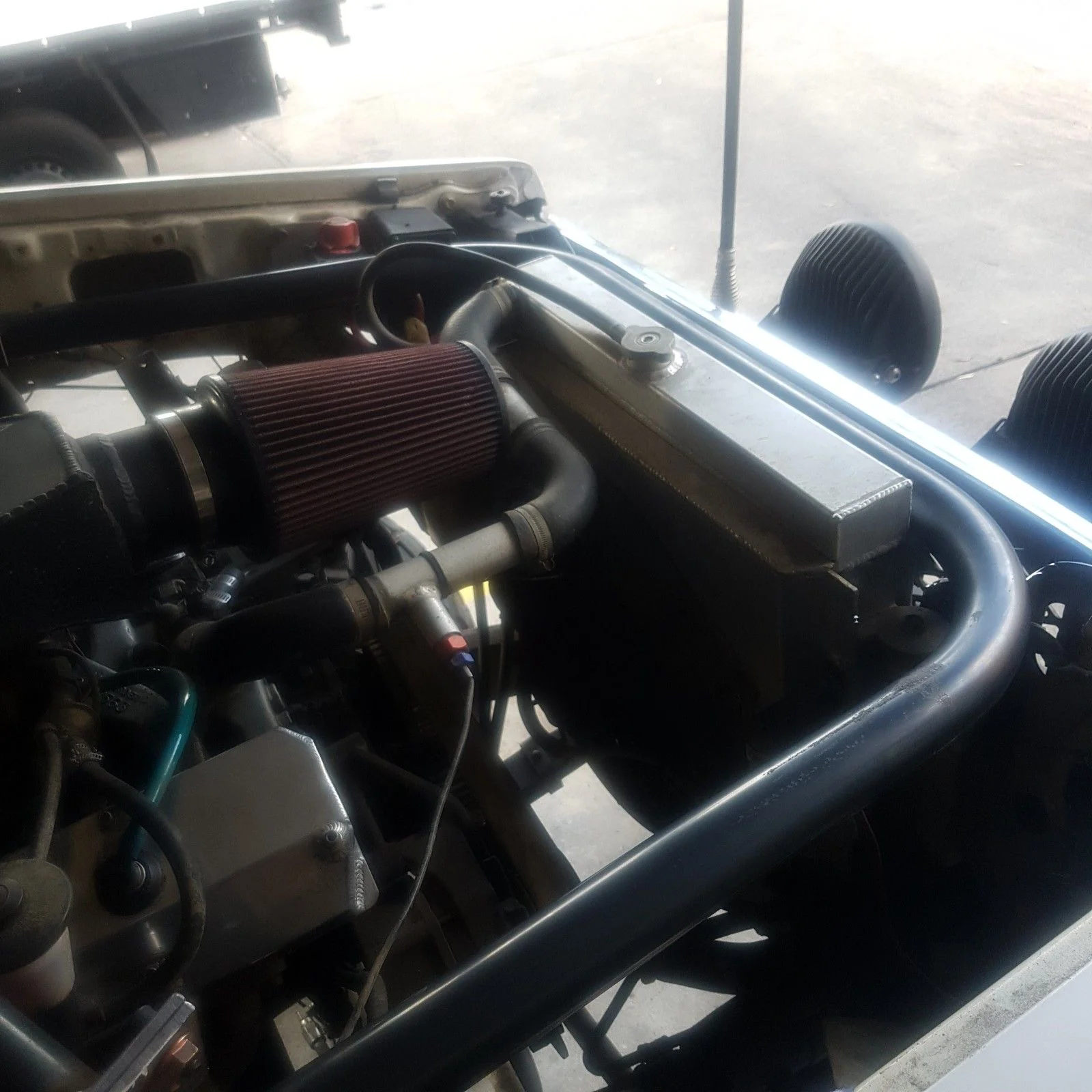

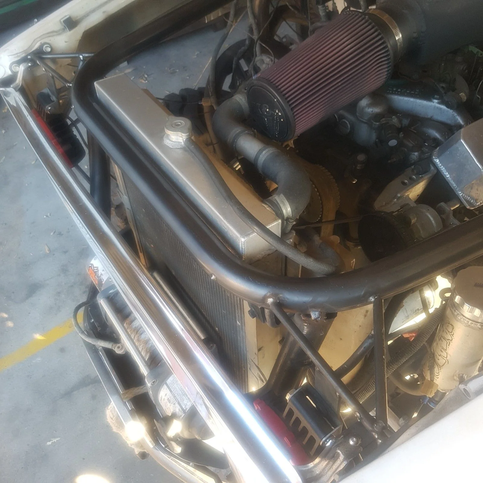

Snorkel and airbox out,

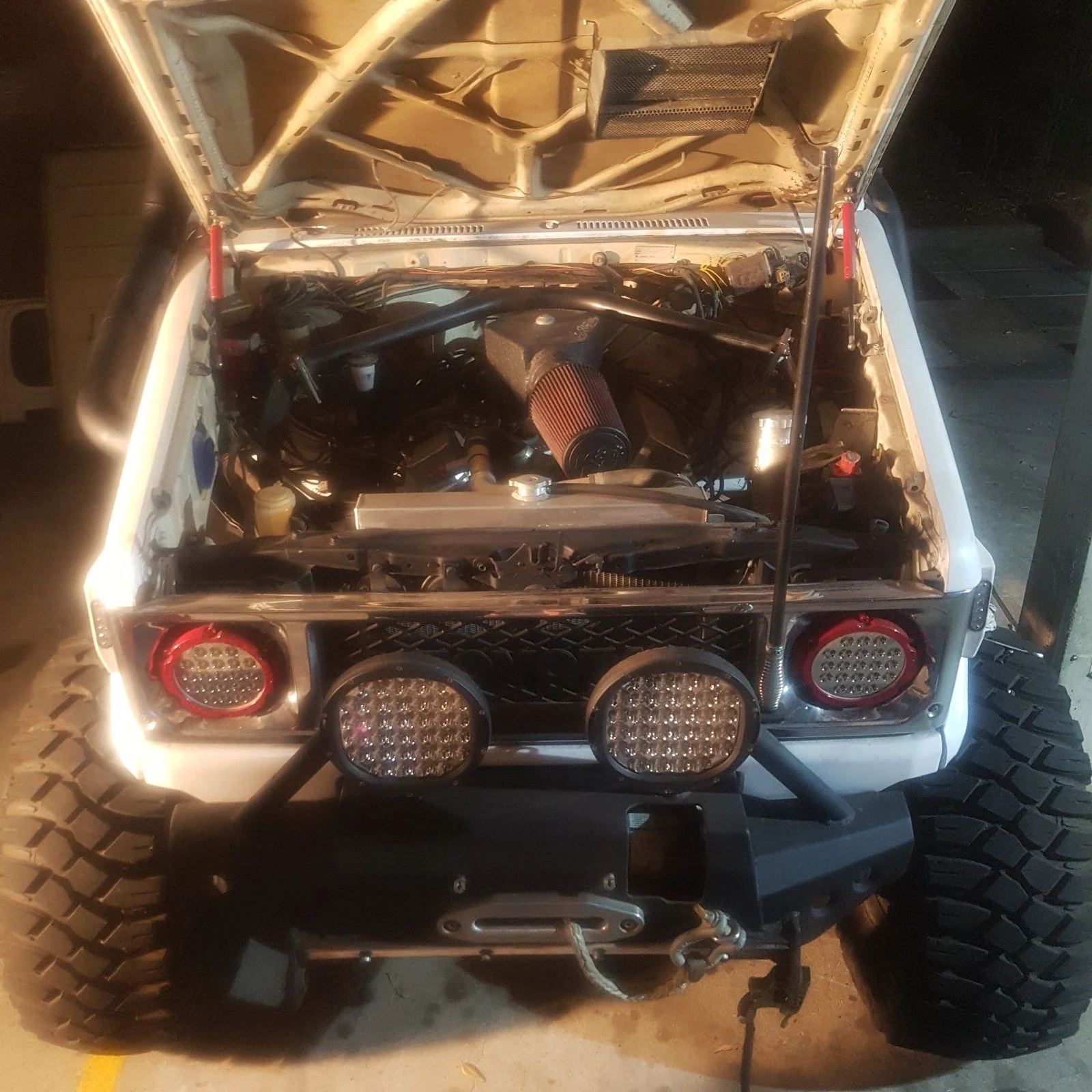

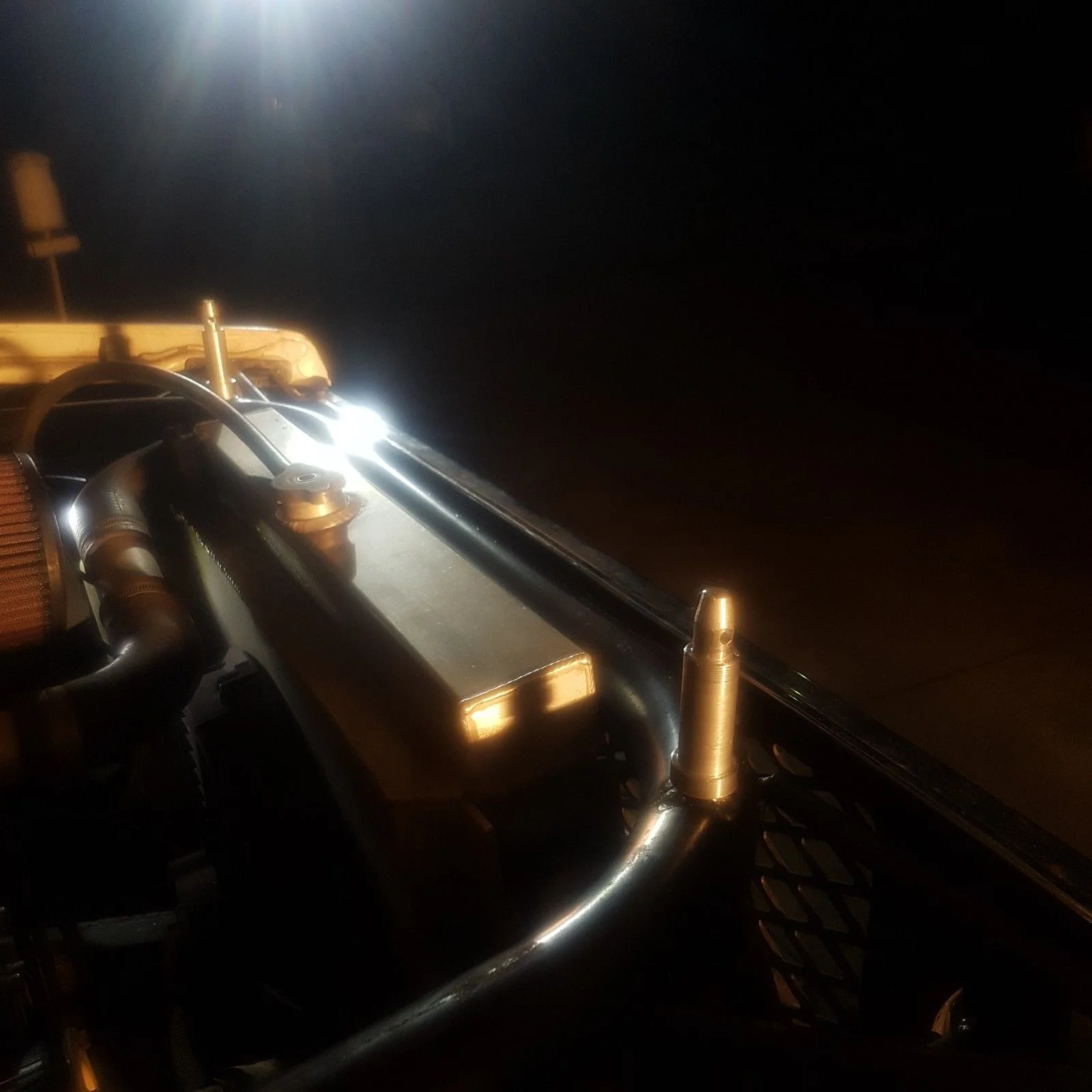

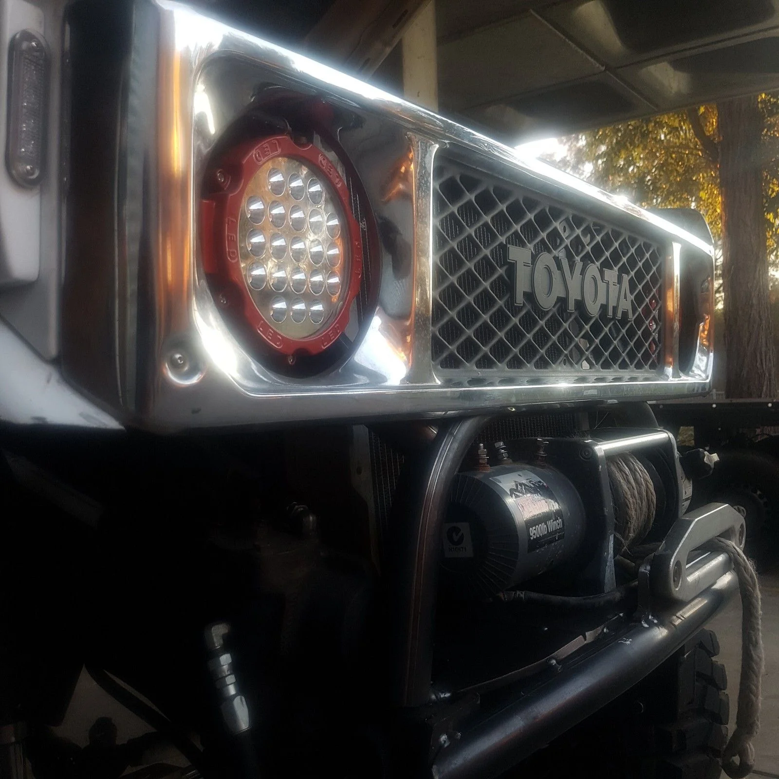

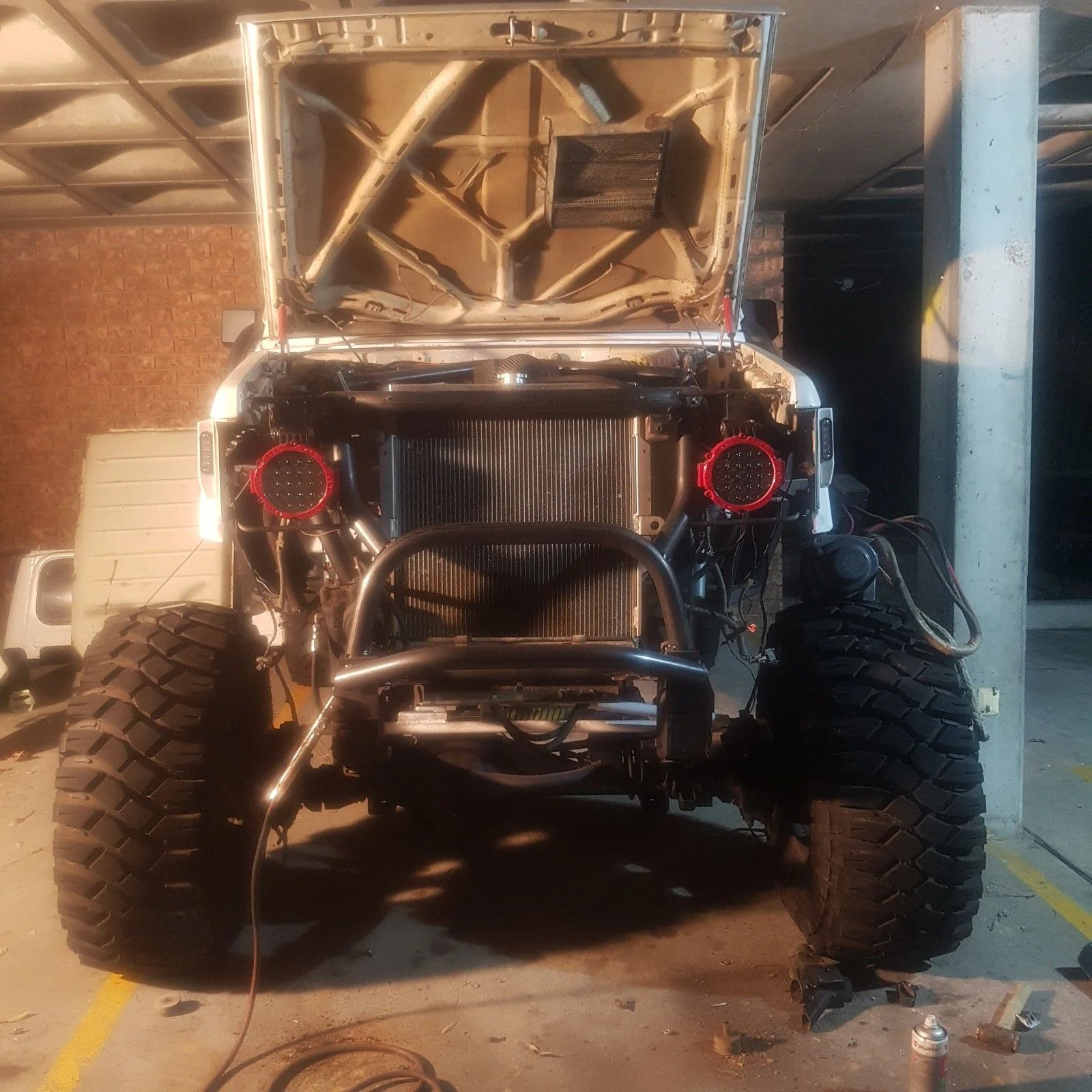

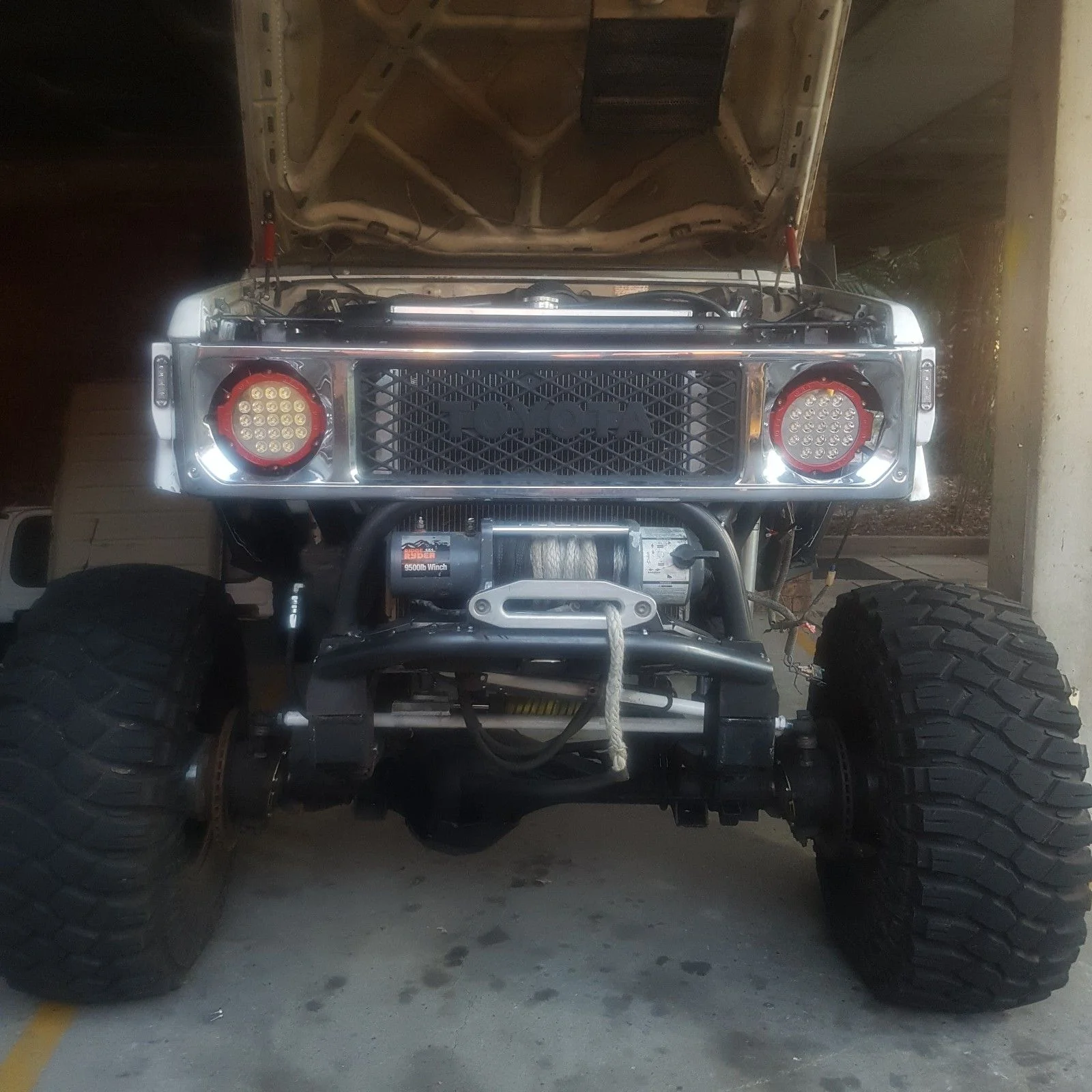

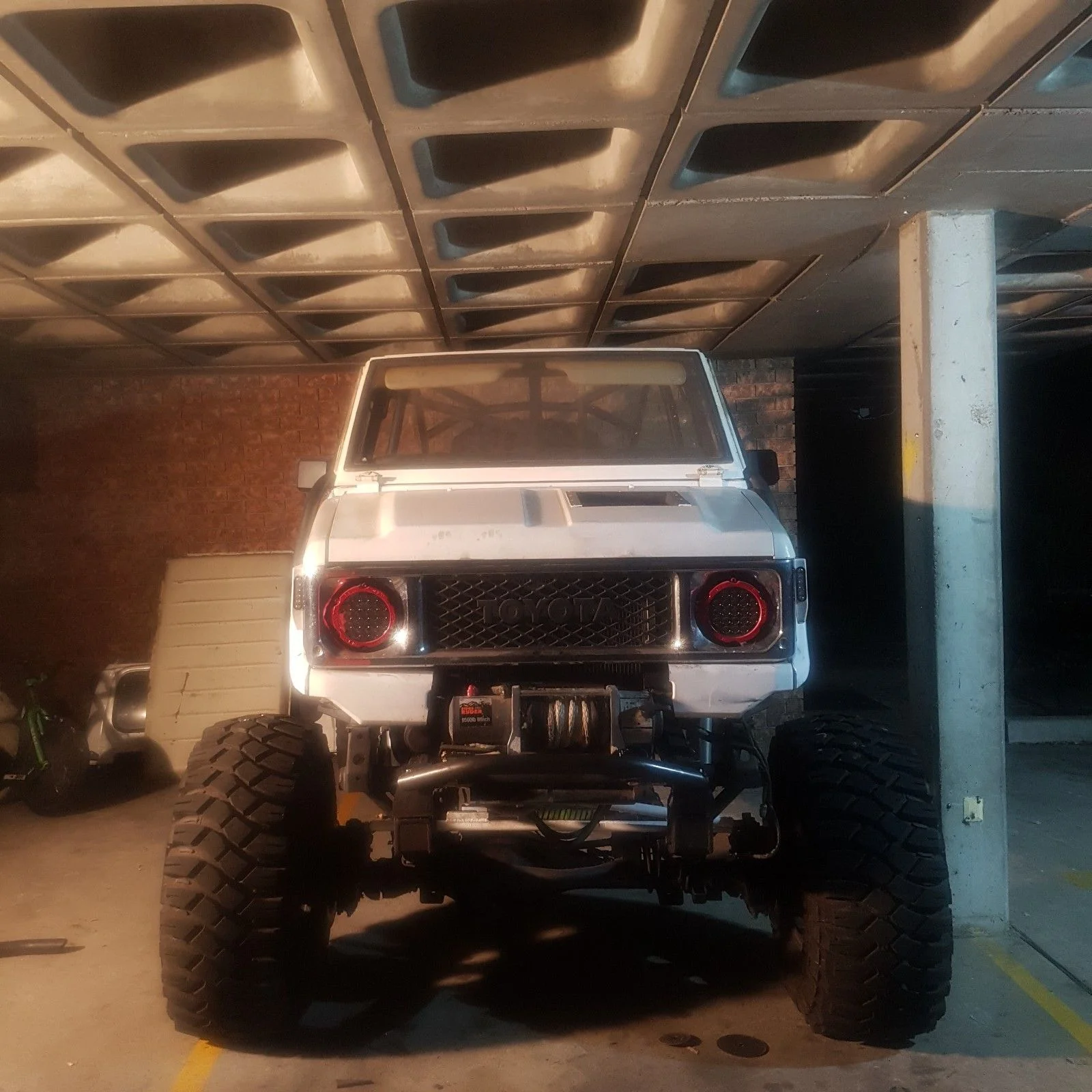

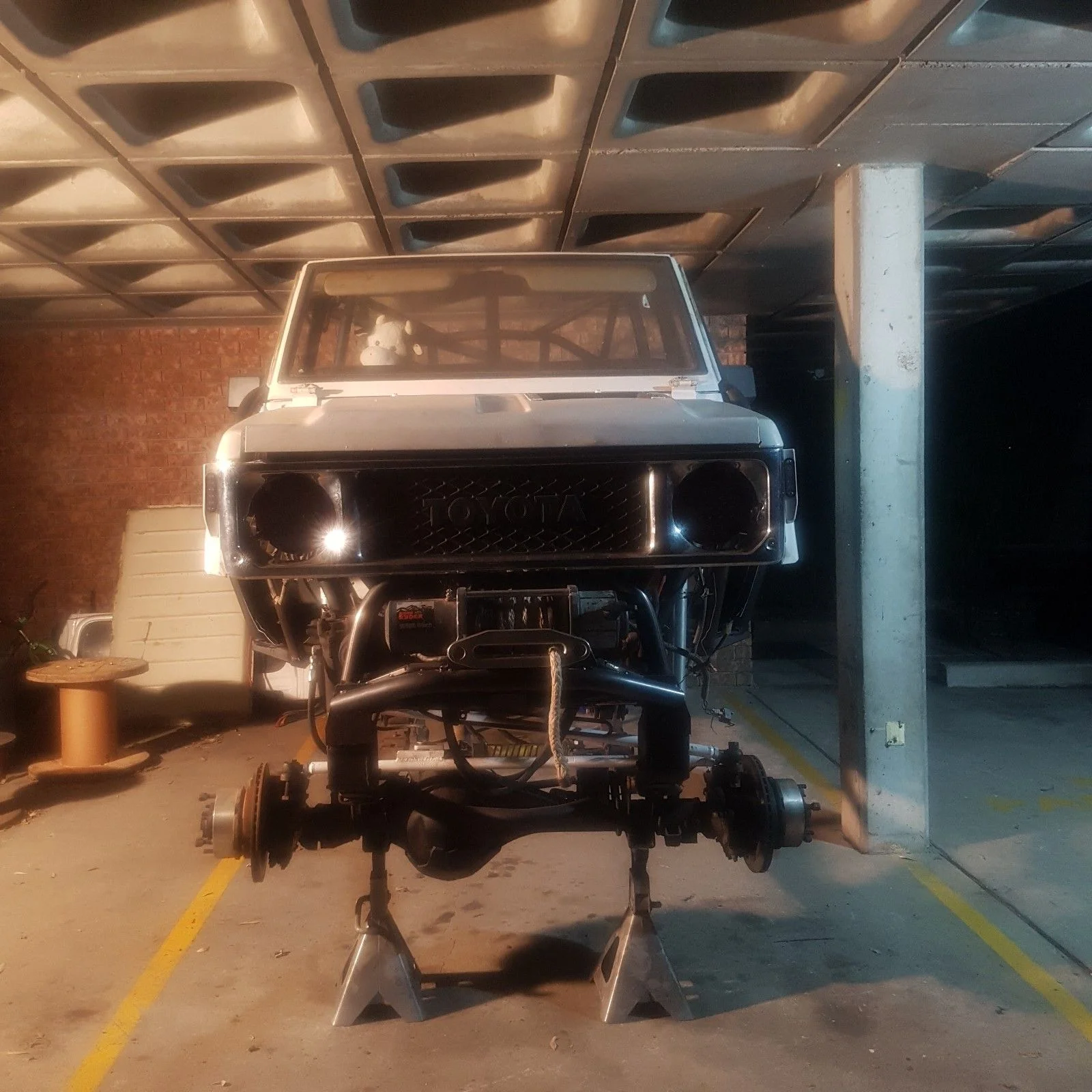

Headlights sung,radiator hung,guards hung, winch mount front bar work started,
The gropper,
Hydro steering fluid reservoir mounted,

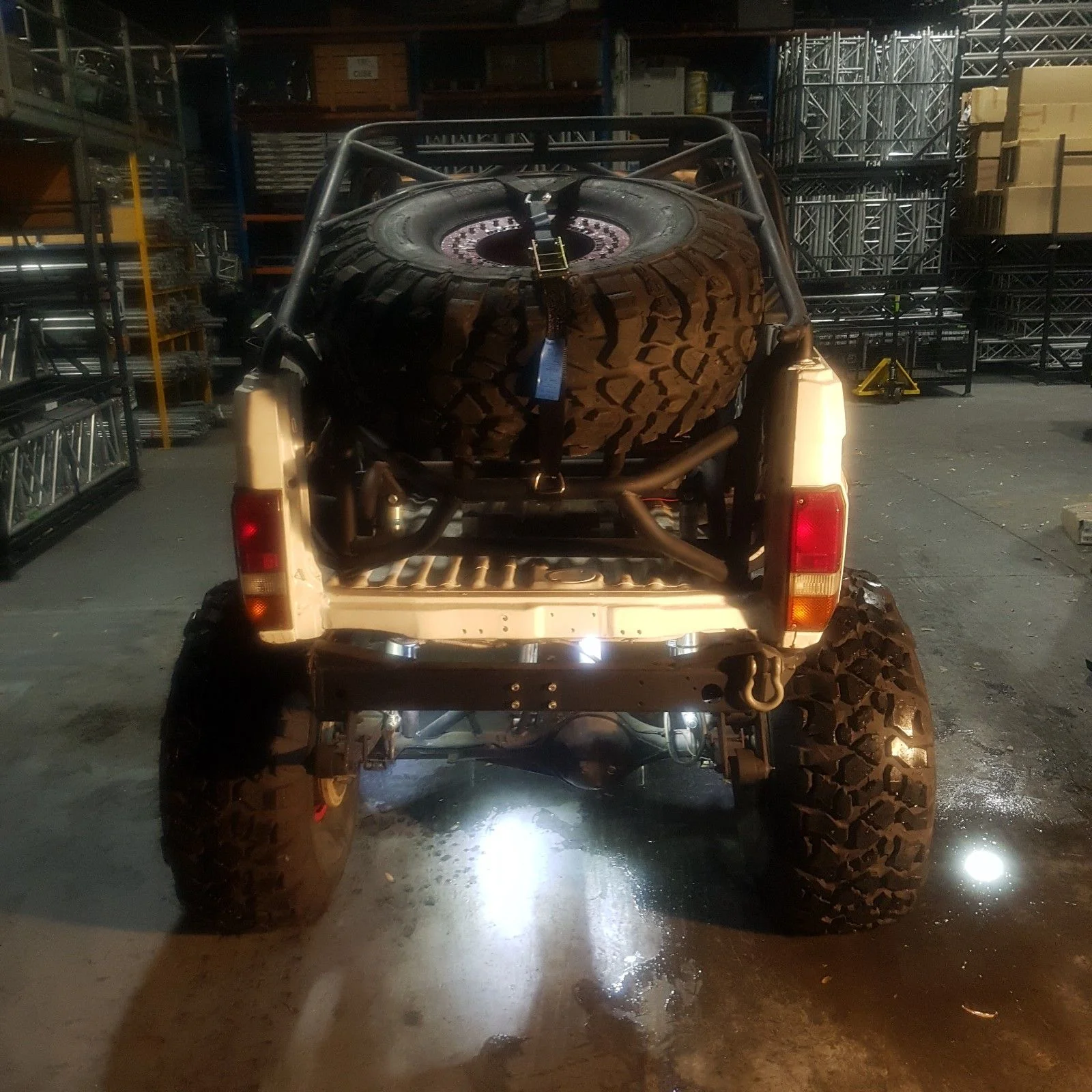

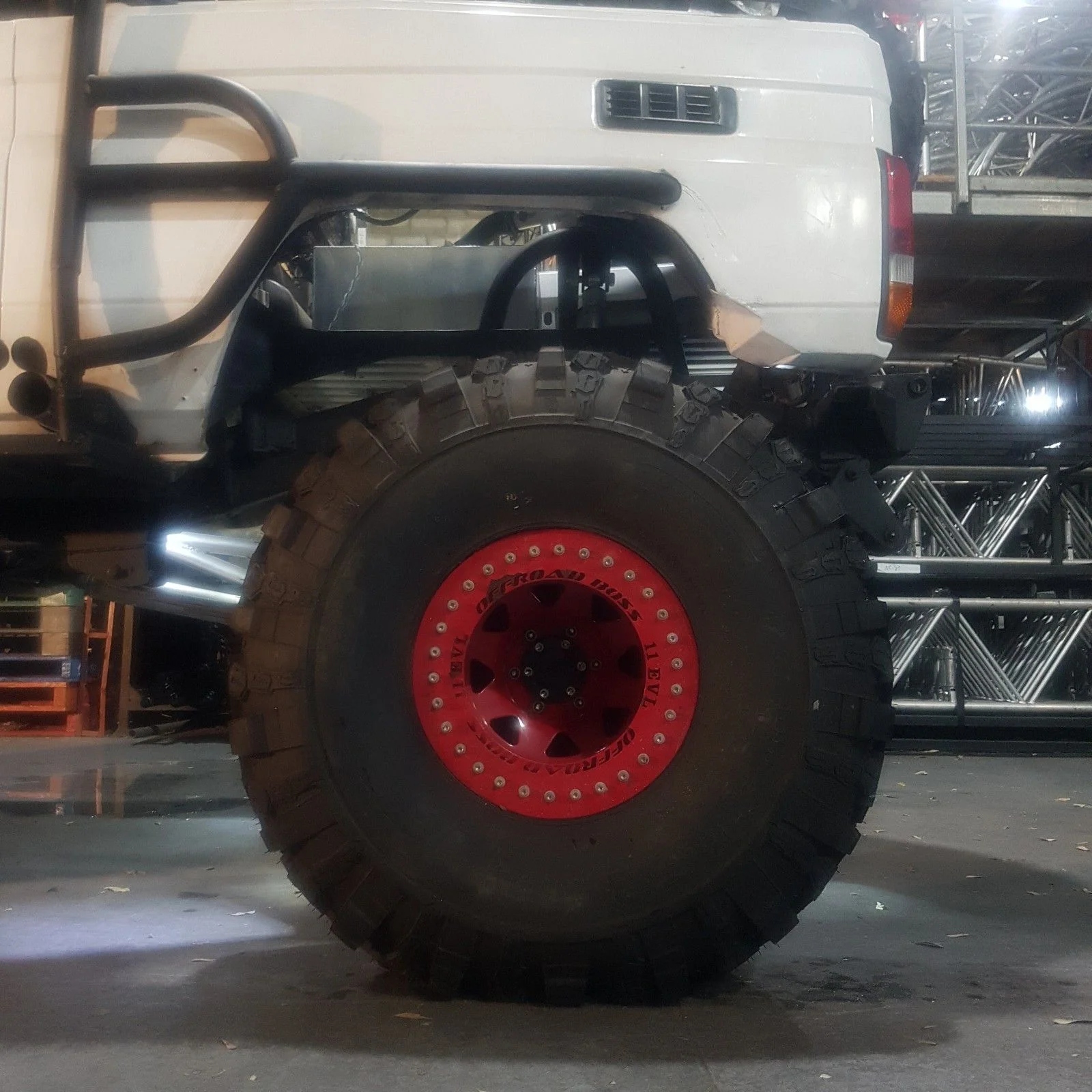

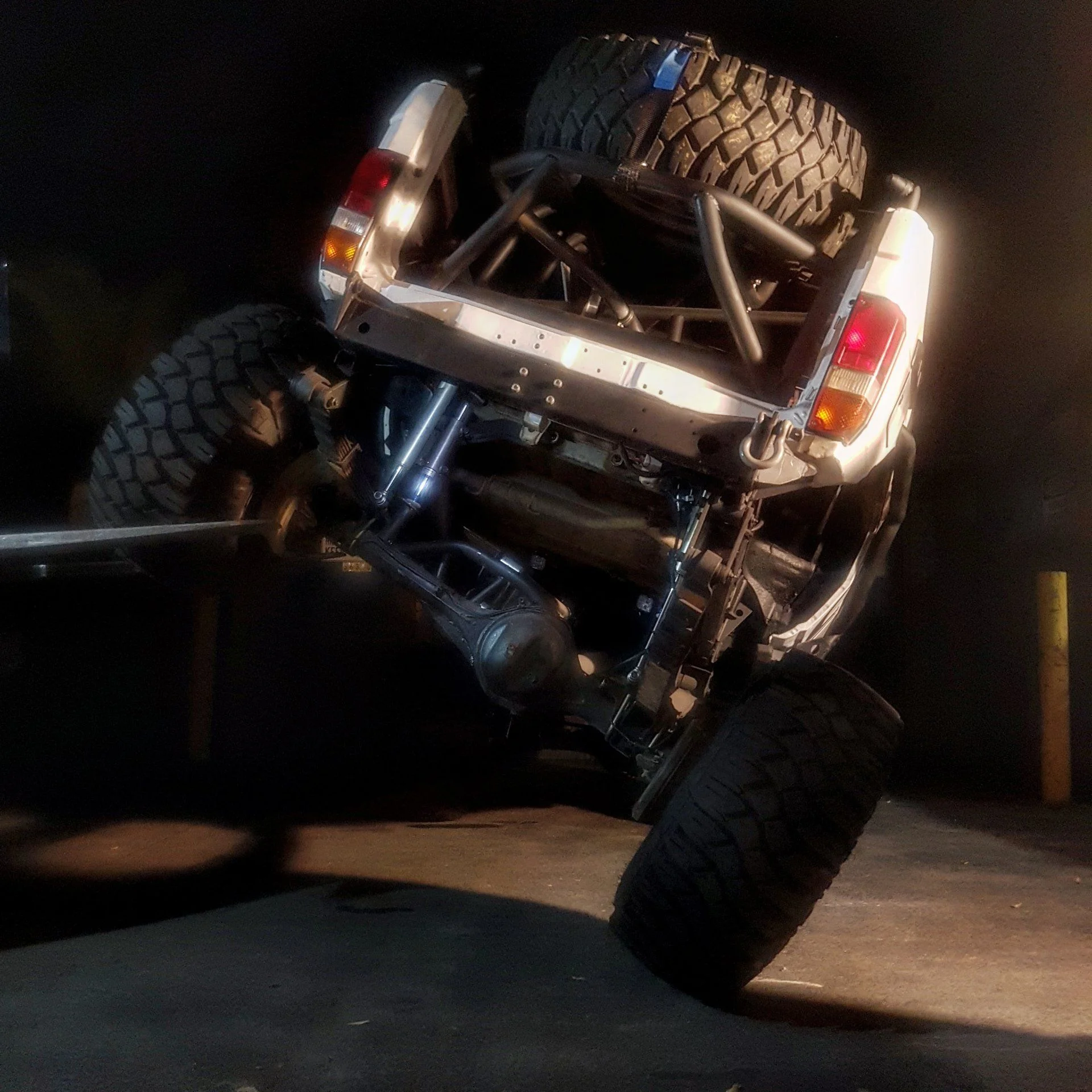

rear end tune, lost two more leafs out of the rear pack, they where way to stiff with all the weight gone from the rear end,

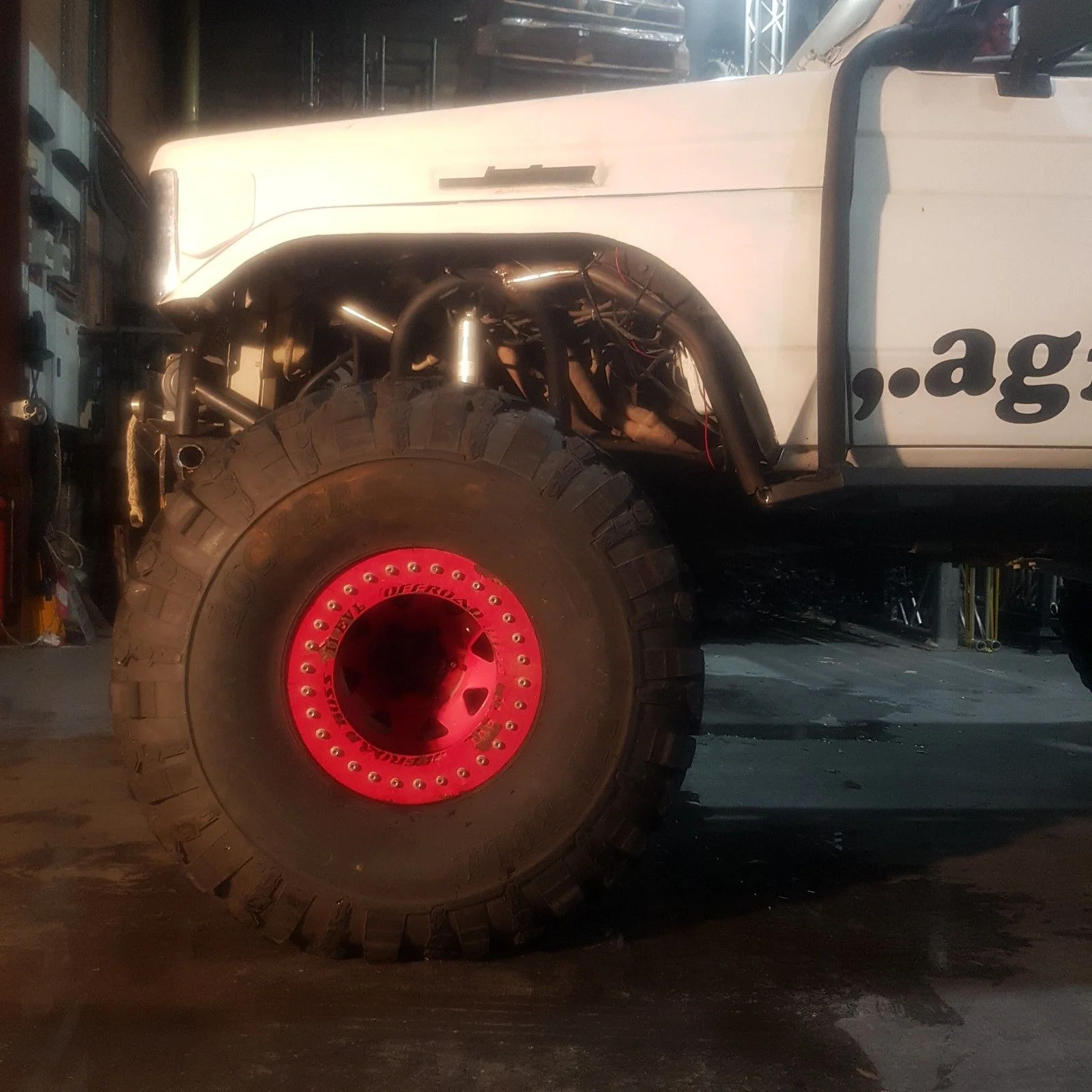

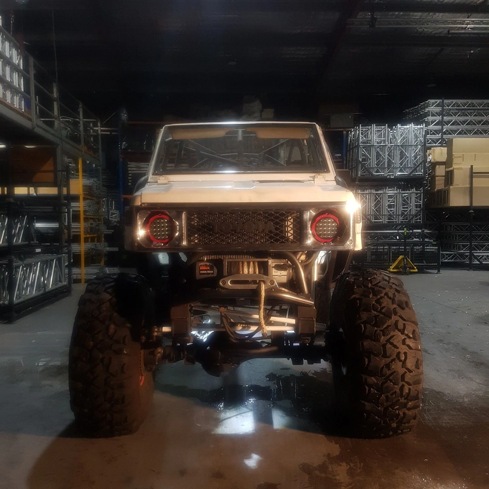

Rear stuff, had a bit more in the tank but have some front end clearancing to sort,

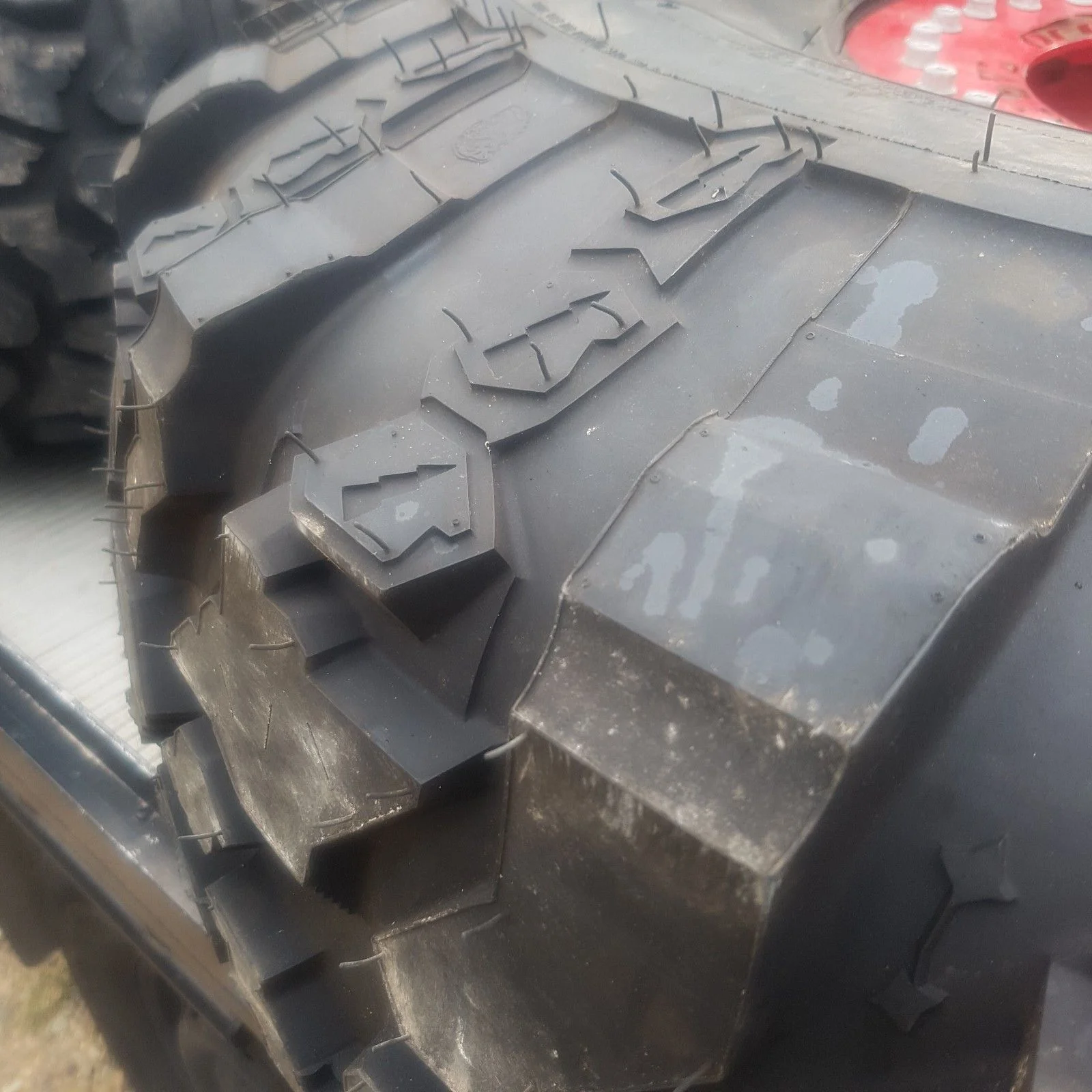

Them bastards are BIG,

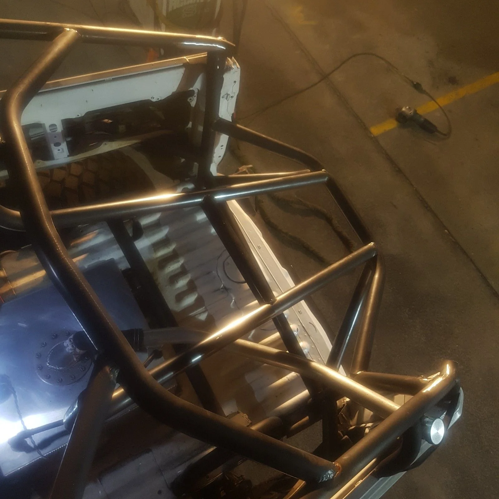

Top boxed ball gussets
