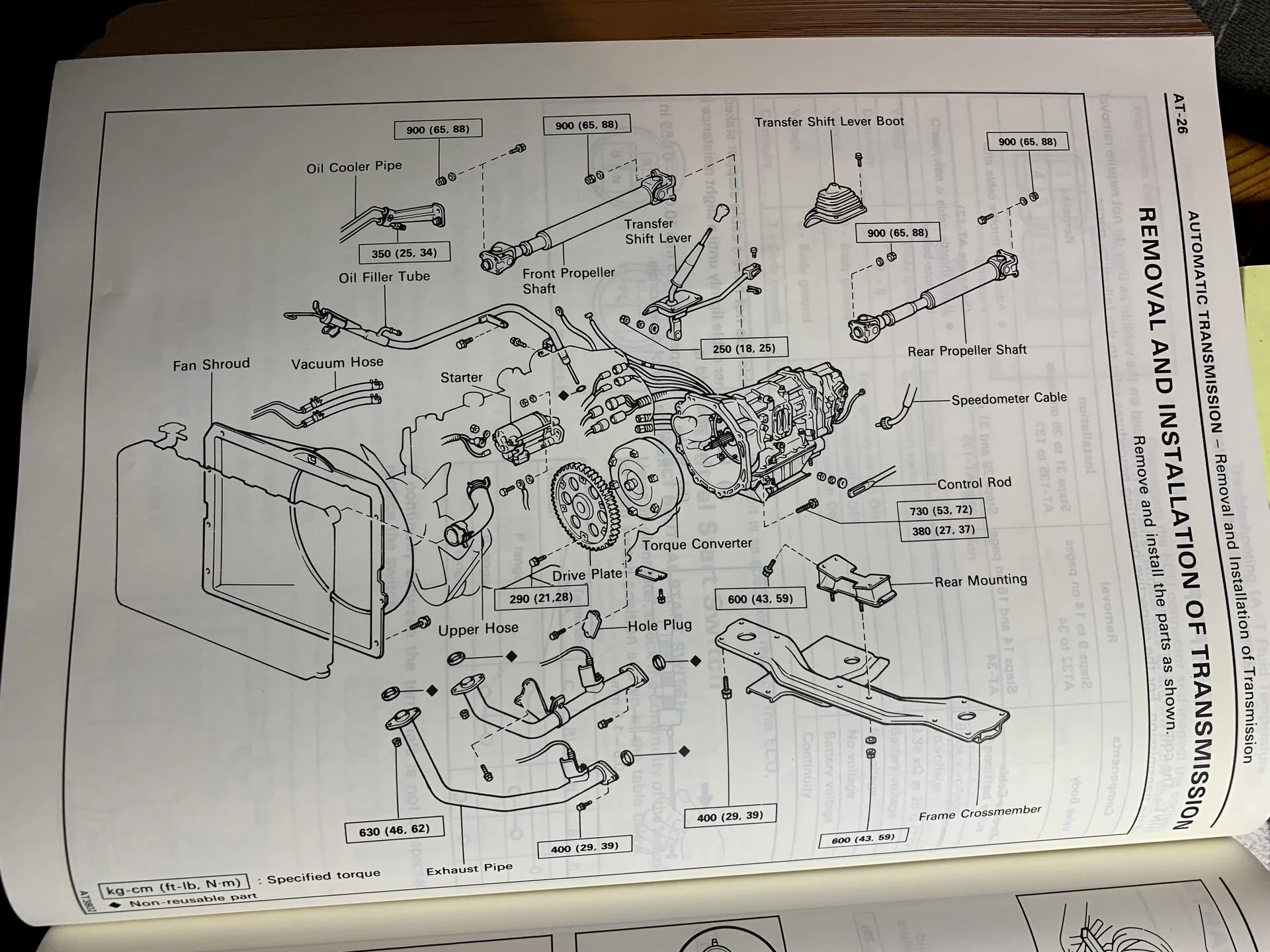

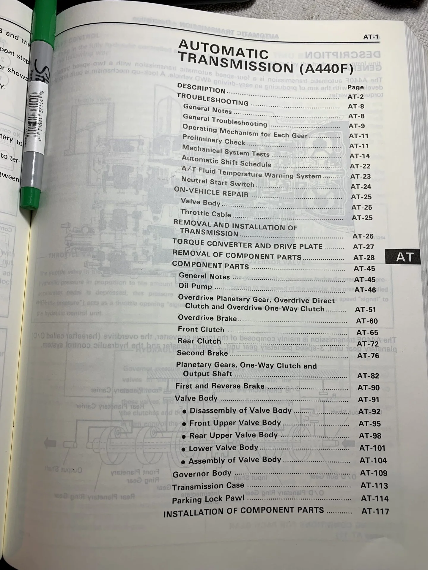

i do have all the Paper Print Media FSM's , if you need step by step screen shots of each page from drain the gear oil and atm pan to filling the ATM back up to the COLD level / filling the T-case , PM me i will get them to you
then your set up for success and things will happen before dark .....
matt.
I will be dammed if the USA / Canada does not have the comprehensive removal step by steps neither does the A440F specialized details FSM either ?
I had to go to a 3rd FSM the HEAVY DUTY chassis body FSM , this actually covers it in the format I describe above ?
That’s a LAME toyota material distribution oversight big time !!
This is the extent of there vague information on this topic ..
