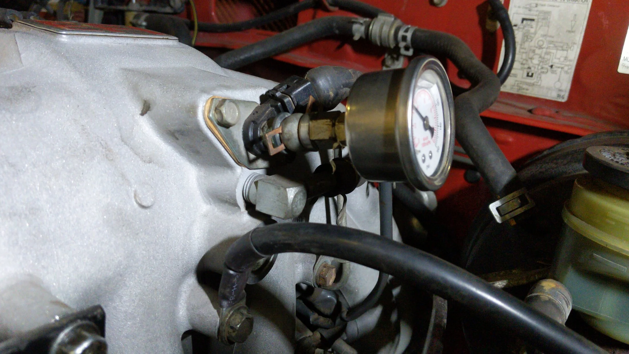

Easiest place to put a fuel pressure gauge is at the cold start injector with this 4Runner banjo bolt from Fuel Pressure Bolt Kit 22RE Fuel rail - https://www.lceperformance.com/Fuel-Pressure-Bolt-Kit-22RE-Fuel-rail-p/1093076.htm
Looks like that could be used on either the injector or (if you wanted to keep it somewhat tucked back for a remote connection to an in-cab gauge) on the fuel rail itself.

Great info and thank you for the link and picture. Is there a recommended generic fuel pressure gauge that would mount to that banjo bolt?
How does that compare to the fuel pressure test kits you can rent or buy for around $50 at harbor freight? I assume you’ll still need the specific banjo bolt anyway?

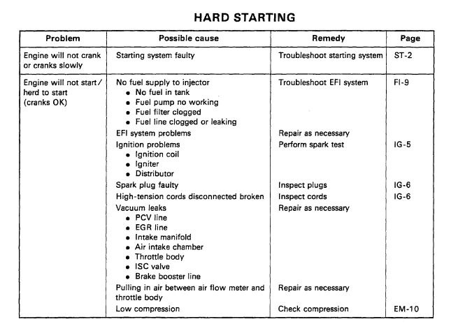

What would cause the “extended cranking” time before starting if I don’t let the fuel pump prime for about 8-10 seconds. When I do that, it fires up in about 2 seconds.
From the Factory Service Manual diagnostic chart:
These are all very general, but each worth investigating. It wouldn't hurt to start with a full tune-up (valve adjustment, timing, plugs, wires, cap and rotor, etc.) and a really thorough hunt for vacuum leaks. A lot of the EFI and ignition components are easily diagnosed with a multimeter, assuming you have a copy of the FSM to guide you.
