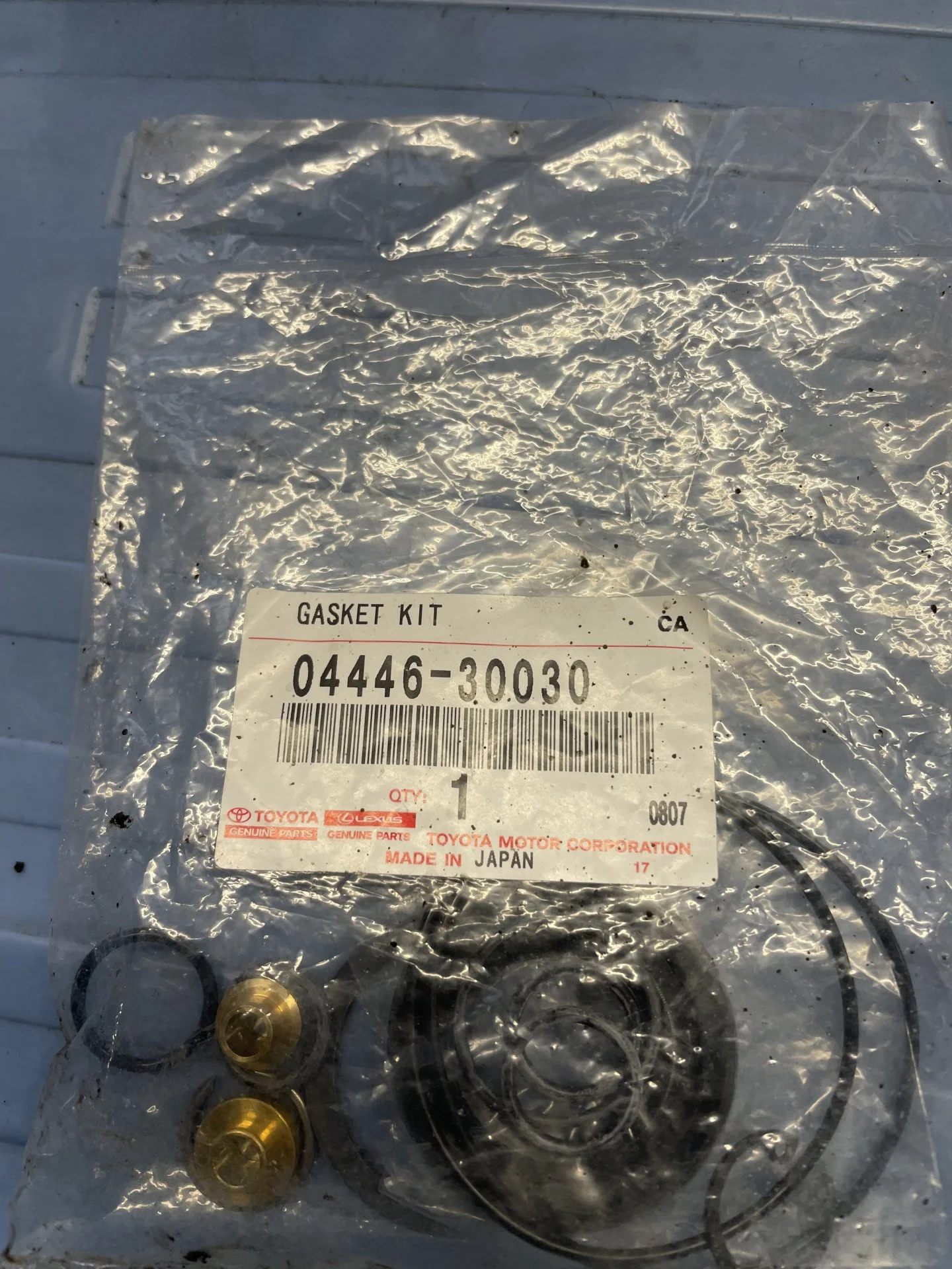

Does anyone know if the bushings for the 62 PS pump is the same as the 60 PS pump bushing?
They are completely different pumps. The FJ62 one doesn't have any bushings.
