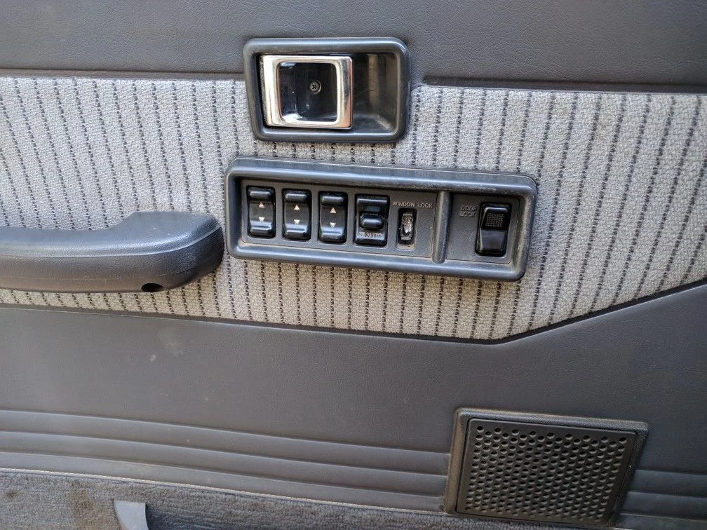

Simple question... How do I get it off without destroying it? I looked everywhere for similar questions asked. Couldn't find any, so guess I'm an idiot. I'm afraid of just pulling it out even though I assume it's snapped on to the door.

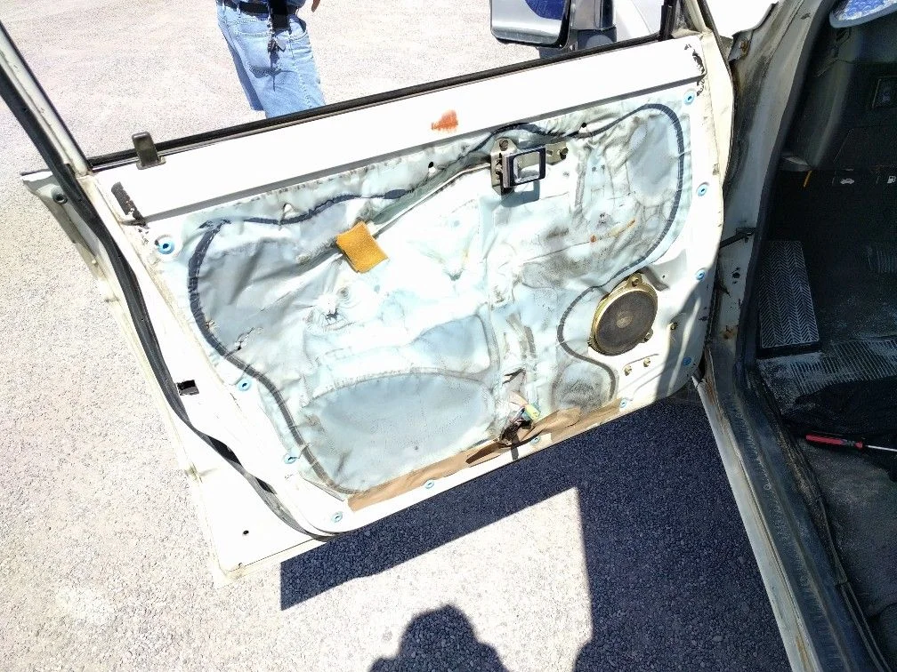

Take the door panel off. Remove the screw that hold the grey housing for the door handle and slide it over the handle. Remove 2 crews that hold the arm rest in place and the GENTLY start popping the the door panel off. It helps if you have an upholstery tool for this but you can you your fingers and a large flat head screw driver. You will then lift the door panel up and over the door lock plunger. Once you do that, rich behind and unplug the electrical connections. At that point, removing the master switch will be easy. I would not try to do it without removing the panel, you will destroy it.

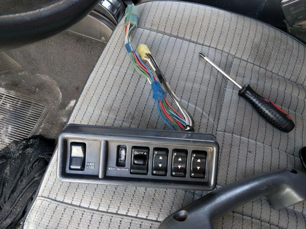

Hey guys, thanks for the replies! I took the door apart like you very thoroughly described. Thanks @fnpierce and @3_puppies and @86aggie. It was quite easy to access it once the plastic around the handle and the arm bar was off.

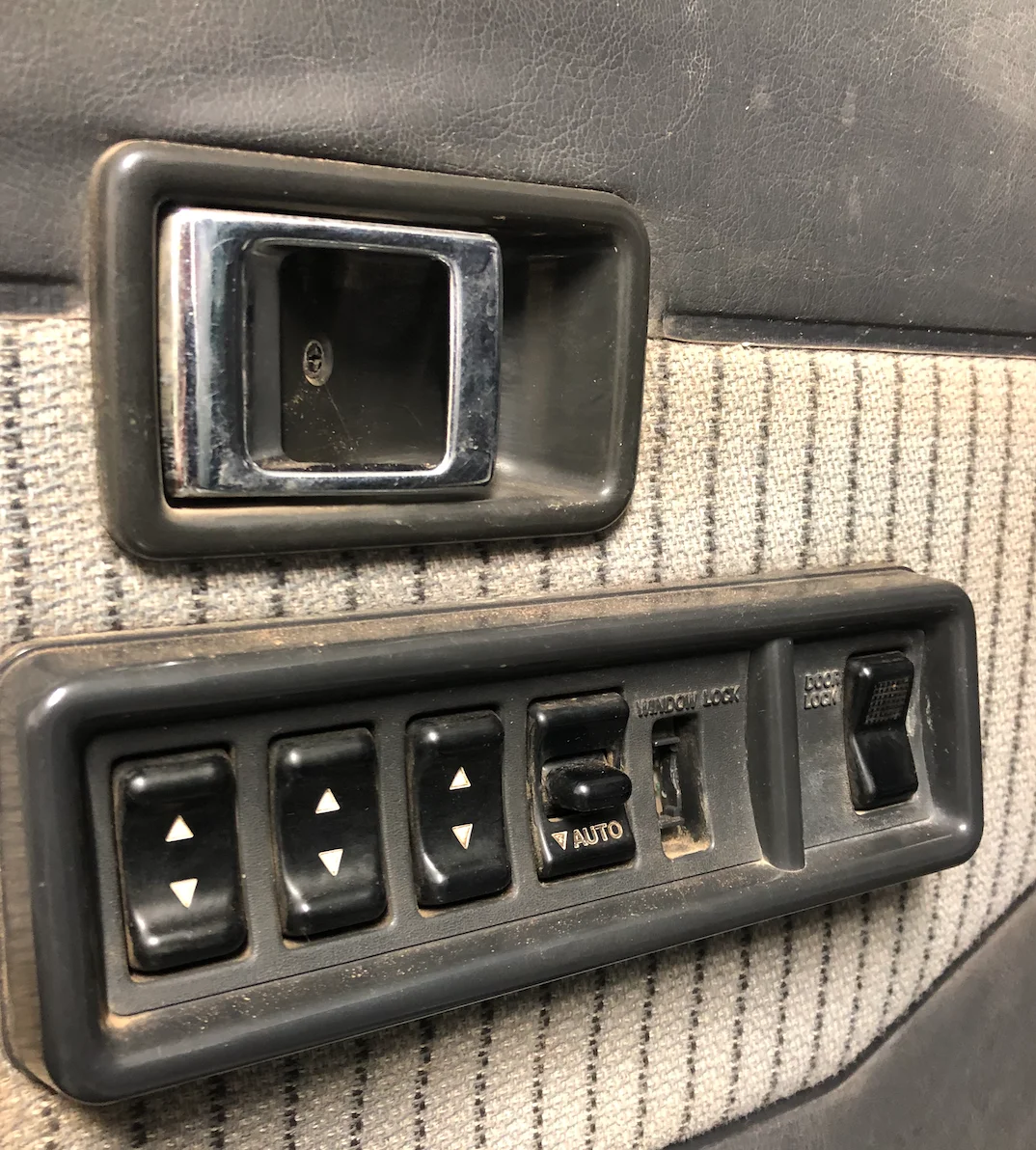

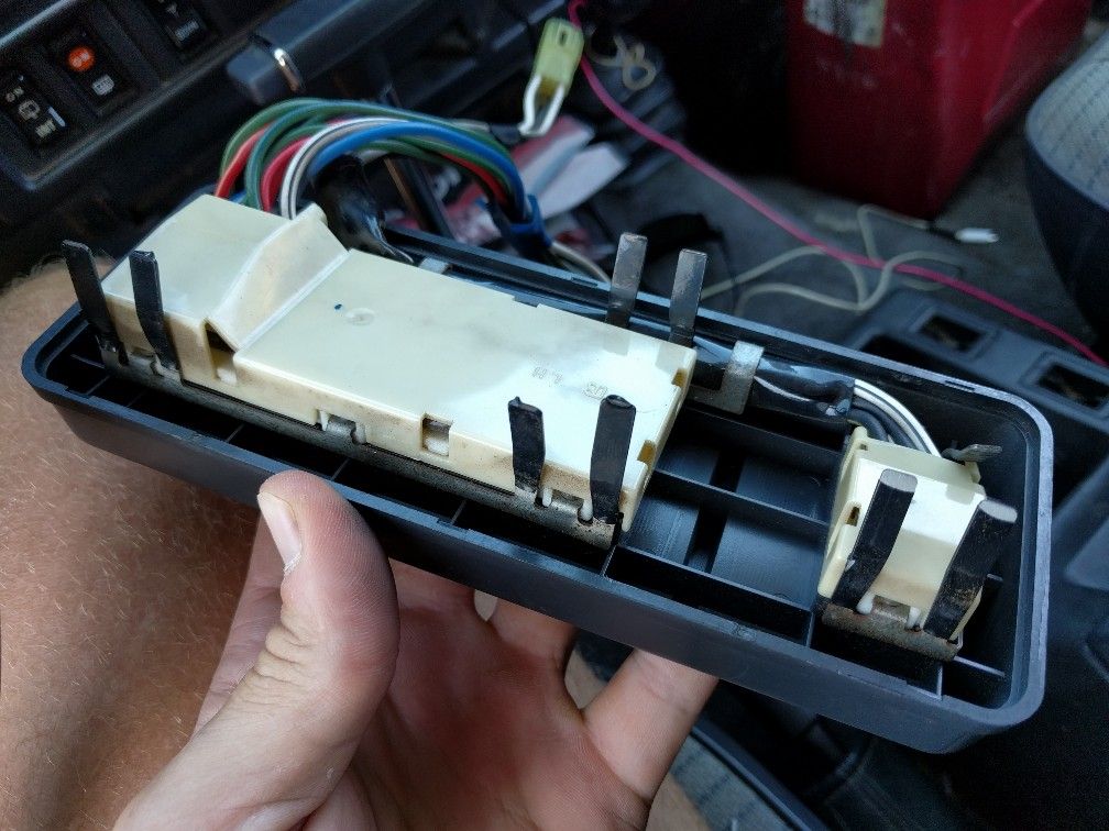

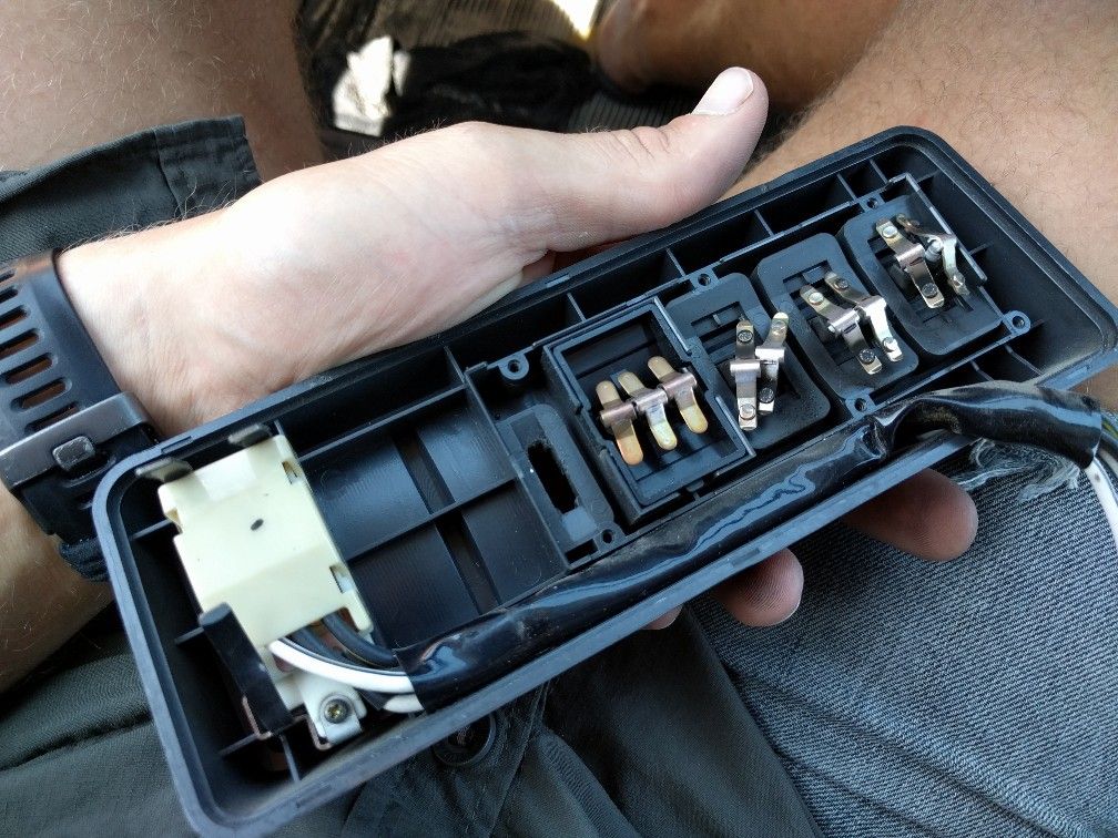

So the problem is, that my "window lock" button is broken. The guy that I bought the car from gave me a new button that I could install. But as I took the door apart, I discovered that the tiny metal flipper that is on the backside of the button is gone too. I probably won't have any luck finding a such one, so guess I'll make it myself. Does anyone have a picture of it?
@MadMeak no unfortunately not. I soldered it so it's always un-locked. Didn't need the function that much anyway. To finish it off I glued the button on. Not a great fix, but it worked and looked good.

CRTX - did you ever get this fixed? I have same problem. I’ve read about soldering the 2 contact points together and the it’s ‘fixed’ in the unlocked position allowing you to use all windows but not allowing you to lock them, which is fine with me. Did you end up soldering them? Or replacing the switch?

Hey I know this is old thread revived. I’m dealing with this right now and I want to solder the 2 ends as you did. In your pics what exactly did you solder? Ty!

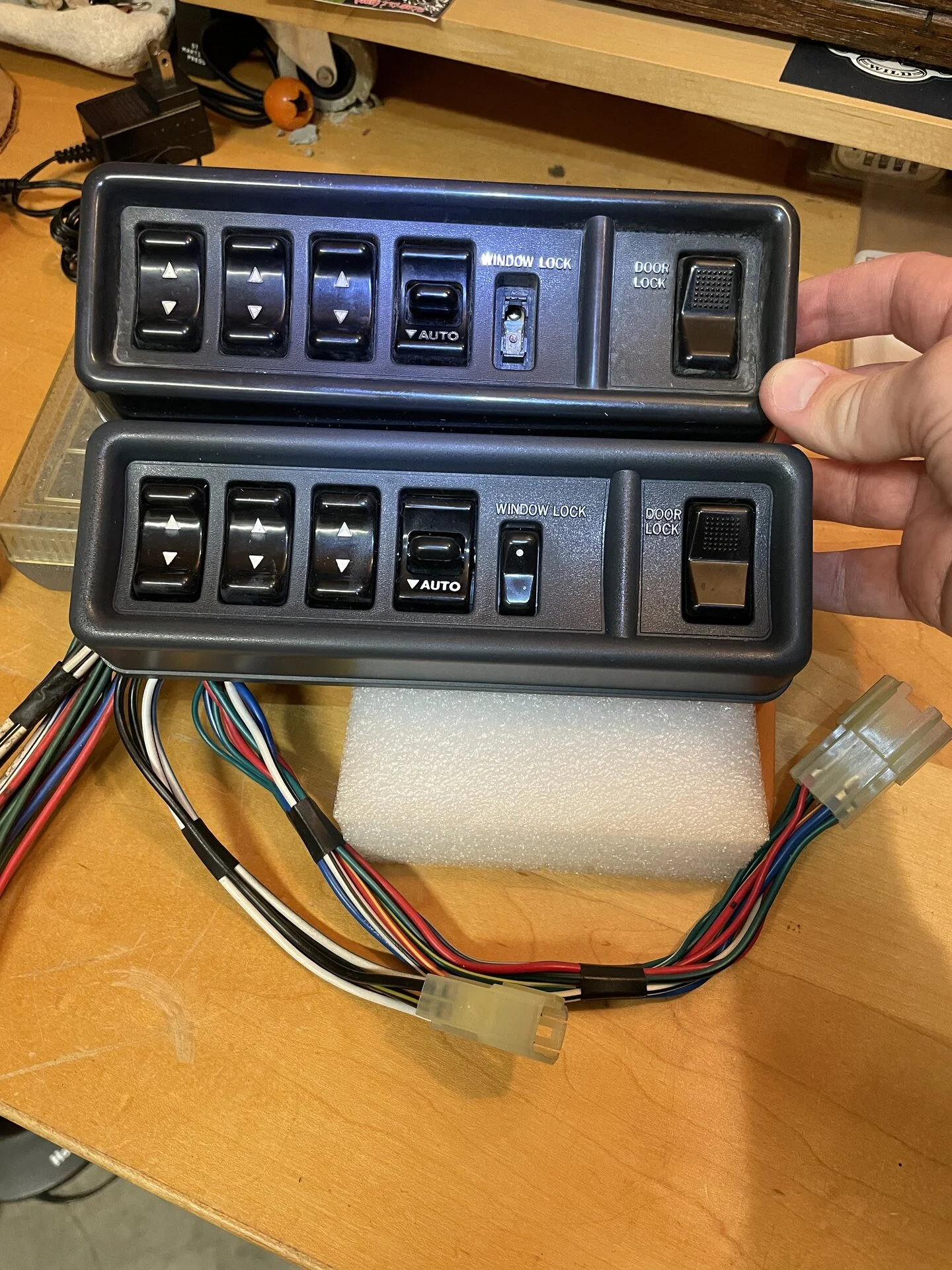

Yes. My fix was replacing the full switch assembly. It's currently in color brown. I will SEM paint the trim grey to match the other interior pieces.
I also bought the switchdoctor one in brown and then SEM painted it, and then used Testor silver hobby paint to get the raised letters in silver. Not perfect on the lettering but a fairly fun / easy project and nice to have new fully functioning switch panel. Bottom one is the new panel obviously - a slight bit of overspray got past the tape job on one of the switches making it look a little used
