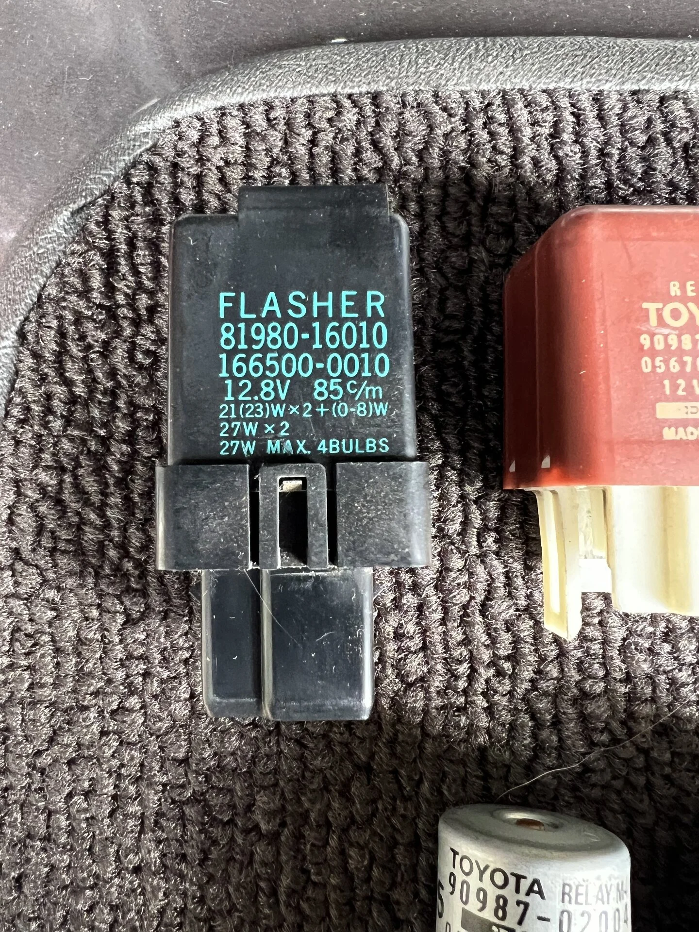

Symptoms:
  • Blinker’s intermittently work correctly
  • Occasionally, when turn on, instead of blinking, the turn signal stays on.
  • Same with the hazard lights… when they work, they work properly, when they don’t, they either just stay lit or don’t turn on at all.
Assuming that I just need to replace the flasher relay, it seems fine, but it’s probably old. New ones are $60… any ideas of other cars that share the same part? Other suggestions?
Is there an easy way to bench test them?
I have seen green ones on ebay for about 20 bucks. Not sure of the quality.
Ordered an OEM used one… along with LED blinkers so I’ll be doing the mod and giving that a try later this week!

Very happy with some modification and I believe it's up under the dash if I remember correctly, between the steering wheel and the kick panel...

FYI cutting that resistor out causes one of the transistors inside the flasher to see quite a bit more current. I suspect the longevity of the flasher would go down. How quickly that happens I couldn’t say. Depends on a lot of other factors like heat, corrosion in the rest of the wiring, etc.

Yes it was purchased on ebay... the part number is 81980-22070
