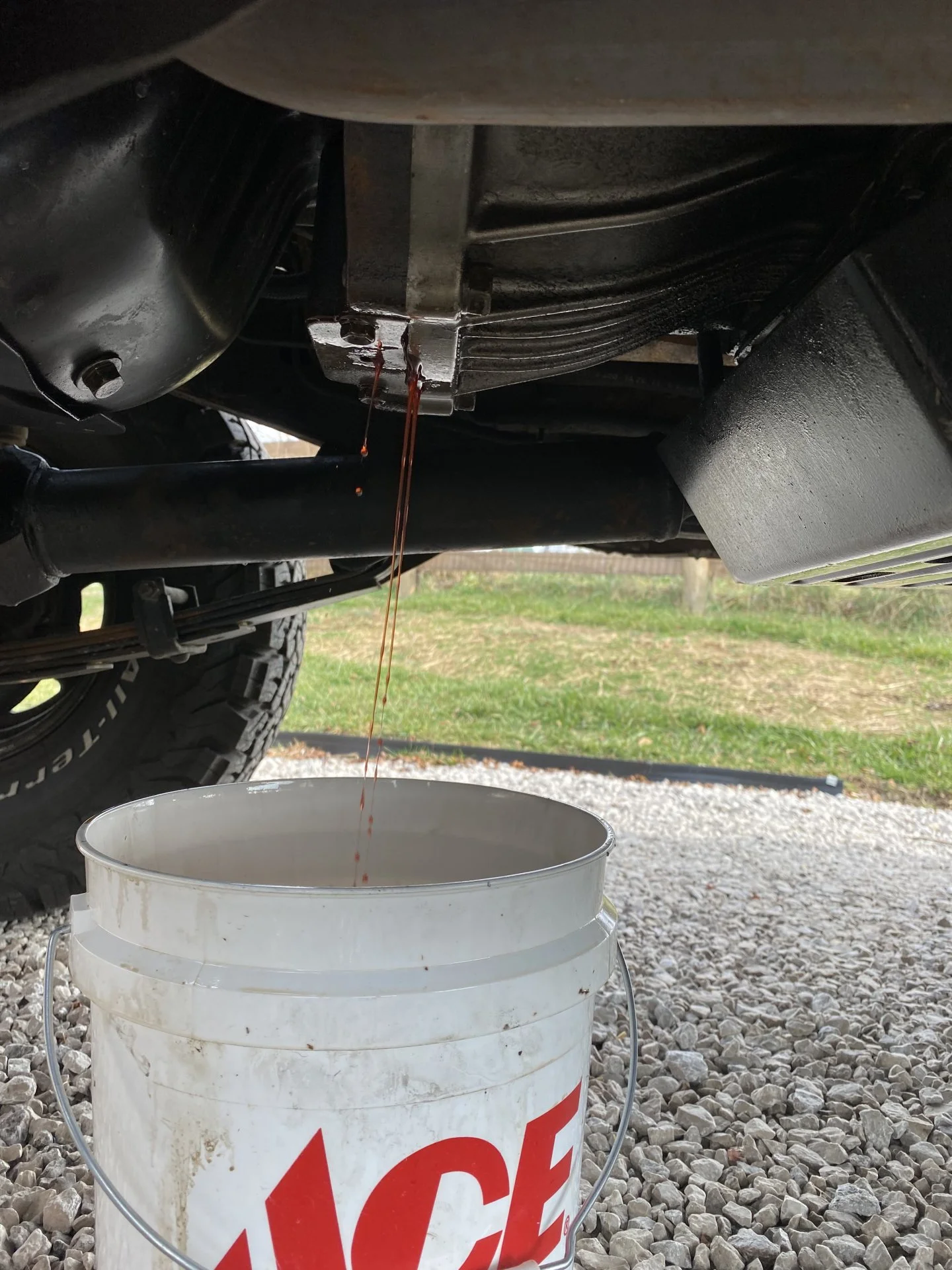

Last Wednesday, I took a 400 mile round trip (cruising at 65-70 mph). Near the end of my trip when I came to a stoplight, I could smell burned ATF.
This is a remanufactured transmission (bought before I found this site) that I had installed 6 years ago (after the original failed completely at 157k).
So, on Saturday, I did a passive flush. Carefully measured the amount of fluid that I drained (drive/drain/fill x3 and added lubegard black). Put exactly the amount back in that I took out.
Yesterday, the trans wouldn’t engage first gear… or any gear. I let it warm up and it worked just fine. But got worried.
Started it up today (after checking atf fluid level, which was good). Wouldn’t shift into gear. Got out of the truck, crawled underneath and found this:
Shut it down and ran for a bucket and snapped that pic. Is this a total gasket/seal failure?
Any advice? Am I screwed here?

Sounds like the pump seal let go, and the burning smell was ATF likely hitting the exhaust. Transmission likely stopped working because you ran out of fluid. That seal is a pretty cheap part, but the transmission does need to come off.
I’m ordering the seal tomorrow and will drop the trans. The interesting thing is that before I did the passive flush, the atf was filled to the proper mark when hot. But when I checked the dipstick it smelled totally burned. After the passive flush it ran like a top then failed the next day (and today the seal started spewing). Absolutely bummed by this. Followed the FSM to a T. And passive flush advice here. Probably exposed a flaw in the reman. unit. :( I’ll post up when I’m know more.
I am guessing the tranny ran low on fluid and that is why the burned smell? Maybe they installed the seal poorly? Before you drop a few thousand on a swap, I would replace that front seal and see how it does with fresh fluid and a new seal. The A440F is very sensitive to low transmission fluid.

Thank you. Yes, that’s the first thing on my list. Fingers crossed!
