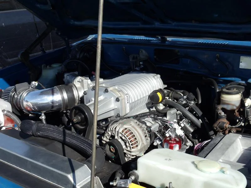

bout time i finish this thread. the cruiser is pretty much done. runs and drives great after some additional tweaking. it had been sitting for 3 years so a few small gremlins crept up but nothing that could'nt be fixed without too much trouble.

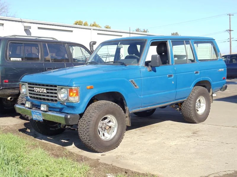

end result, this thing hauls ass! and then some.......and it sounds really cool above 1/4 throttle. you can definetly tell there's something going on under the hood. but when just cruising along, it looks like a total grocery getter and does'nt sound obnoctious. SLEEPER! :steer:
a few more pics of the finished project. yes, the hood closes and everything clears. barely. :cool:
georg @ valley hybrids
Holy s*** that's awesome. How much power do you think that puts out?
according to magnussen, 450hp at the crank. i'm running it on super unleaded and it feels solid. have'nt burried my foot in the carpet yet, need to let the trans go thru it's paces and everything else needs to settle in as well. lots and lots of new components and systems so i have to check and re-check things constantly. so far, so good.
I bet that truck sounds really nice under a load pushing north of 4K... My 5.7 vortec is alittle loud...single magnaflow muffler dual in / dual out... , but when you have to get on the gas at times its all worth it. A supercharger would be nice to say the least. How's cooling?
Nice clean setup and layout on the truck and parts. I imagine that the truck will be a "sleeper" for the rice rockets and local hot rod types....very cool.
yup, it sounds great under load. my 80 has a vortec 5.7 in it. mellow when you're cruising but sounds great when you put your foot into it. had it at SNT and ran it in 2wd most of the time with it between half throttle and fully pinned. good times! dual in, single out magnaflow stainless. same setup on this 609 but with 3" single out. my 80 is 2.5"
