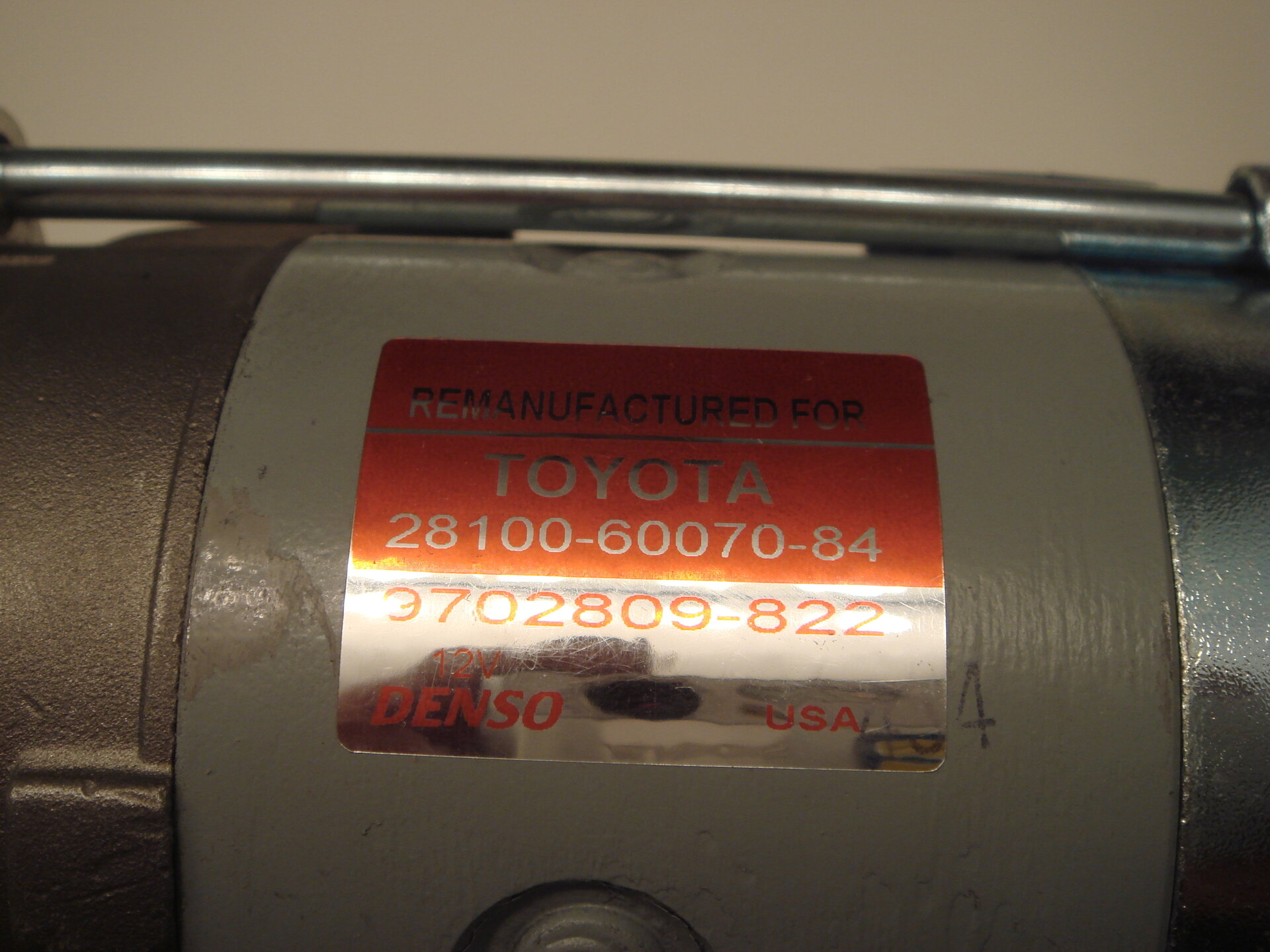

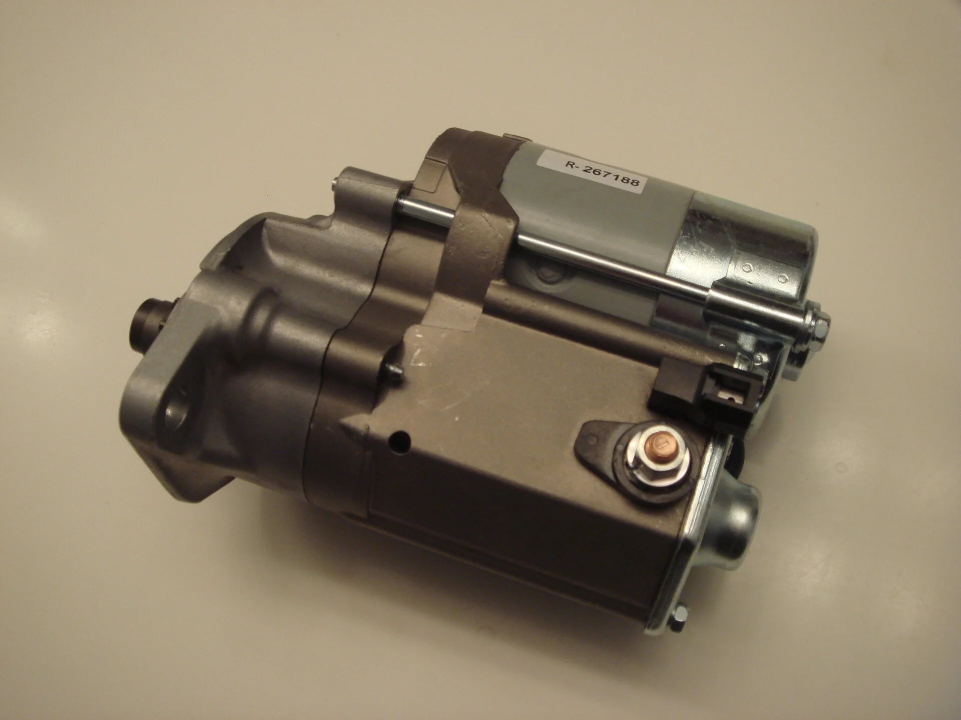

I installed this on my ‘86. It’s perfect. Toyota remanufacured.
Looks like I’m putting in a starter soon. What does the gear reduction do? Where would I get one?
It just changes torque via gears and turns the motor over better.
