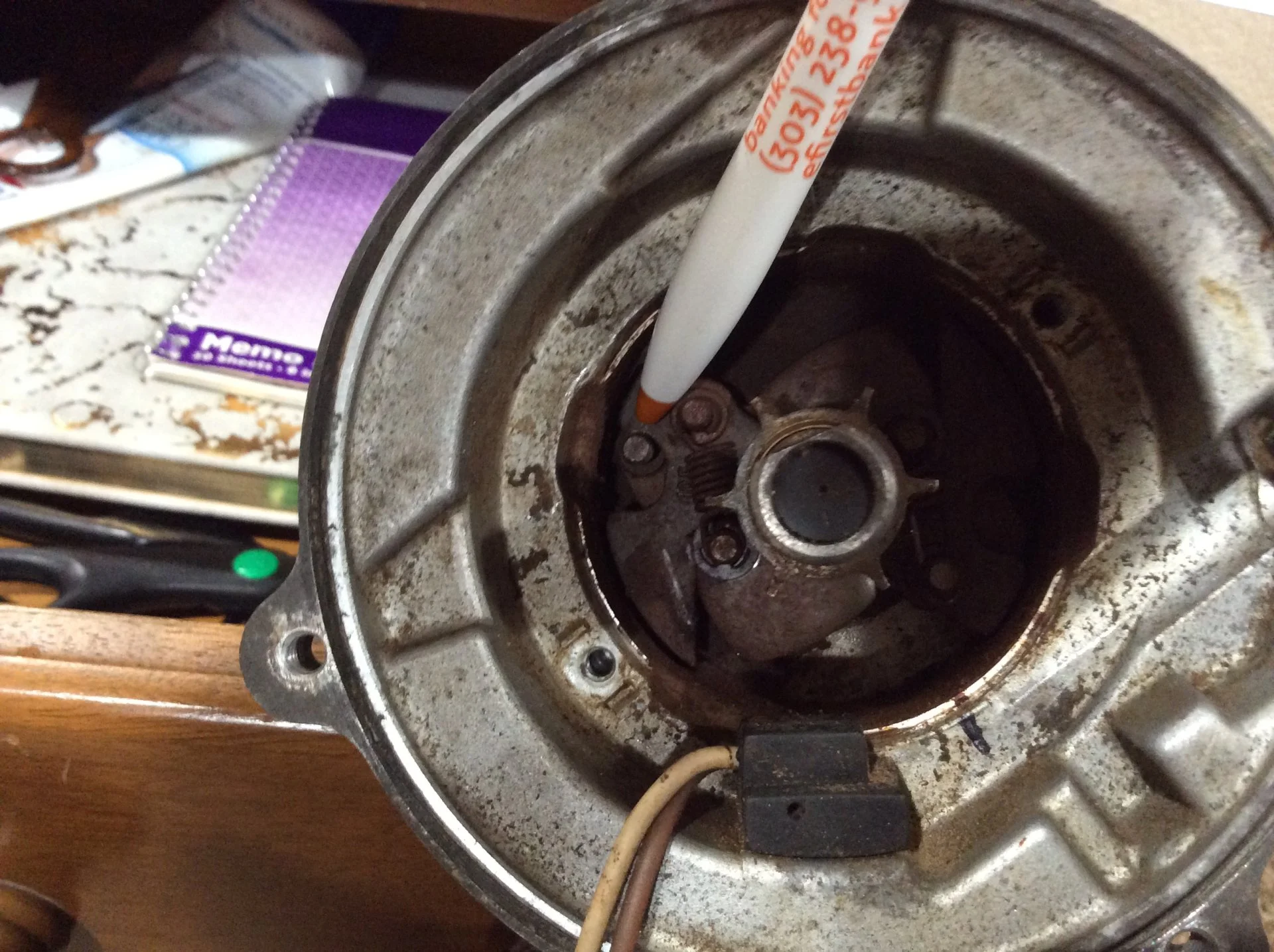

Read through the thread LandoNick started, loss of power,torque,deadspot,hesitation whatever you want to call It! I’ll bet your problem is too much advance-too soon. Caused by a missing centrifugal advance weight limiting stop. Assuming you’re still running the oem big cap distributor. Check it out.

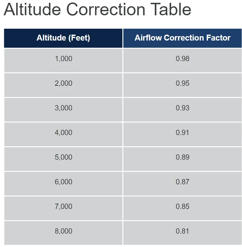

I’ve always read idle vacuum drops 1inHg for every 1000’ above sea level. I’m at 5000’ and that rule holds true when I go up to 7000, 8000, 10000’, etc. What calculation are you doing? I’d be interested in knowing.
The correction factors are in this table. I happen to be a HVAC engineer and pilot that regularly uses these altitude adjustment factors. I use 0.82 as the factor for my altitude. These can also be use for compression checks at altitude and correcting the value to sea level.
In the aviation world, sea level has a standard air pressure of 29.92". At 7000' ASL the air pressure is around 25.4" hg. It is roughly an inch per 1000' (rule of thumb).

FJC-Man, I do have the large OEM distributor. How can I slow it down. I have the VTV in the primary distributor vacuum port line. I also have the high altitude distributor port hooked up to manifold pressure to advance the HAC 6 degrees.
Are there stops in the distributor that may be missing?
Would connecting the primary advance port vacuum to the HAC distributor port help? I would think less advance would occur, but not nessiarily slow the advance. Thoughts?
I hope this helps.
This is great. Your knowledge definitely sounds more accurate than “stuff I’ve read on the internet”. So let’s say my idle vac reading at sea level is 21 … at 7000’ I multiply by 0.85 which means I should be at 17.85inHg, correct?
Or - in reverse - if my idle vacuum at 5000’ is 16.5inHg, I divide by 0.89 to find that my theoretical idle vac at sea level would be 18.5inHg. Yes?
The curve isn’t linear, but for truck purposes it seems to shake out to a loss of roughly 0.4inHg for every 1000’ of elevation. In an airplane at 30,000’+ the logarithmic nature of the curve would need to be factored in of course.
Do you have a table that goes to 12k’ or 13k’?
So I was trying to steer you to reading through “LandoNick’s” thread about this topic. Anyway, this is a picture of the stop pin with the travel limiting bushing missing.
