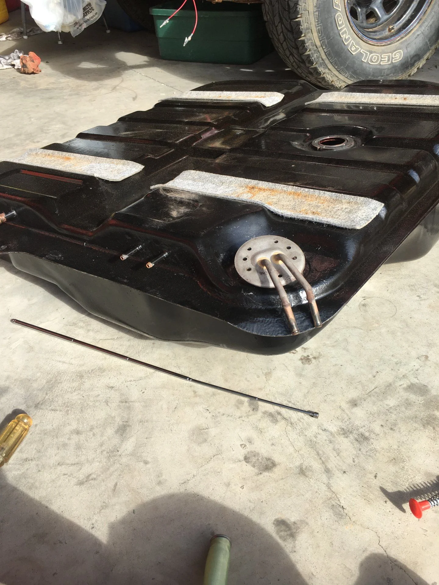

Removed the cap underneath the cargo area carpet, just a fuel sending unit. How do I get to the pickup... please don't say drop the tank.
set pressure to about 5 psi and slowly turn it up but don't go more than 10 and do NOT blow into it with the cap ON...
Want to check the screen/filter
there isn't one on the end of the tube, it is just an open tube. filter is on the frame rail by the distributor.
If it is plugged, you can run a stiff wire down it to make sure it's clear.
there isn't one on the end of the tube, it is just an open tube. filter is on the frame rail by the distributor..

I just pulled and re installed my tank, not a lot of fun but not real bad. Folks above are correct, there isn't a screen it's just a supply and return tube running into the tank, it's at the top p/s of the tank.

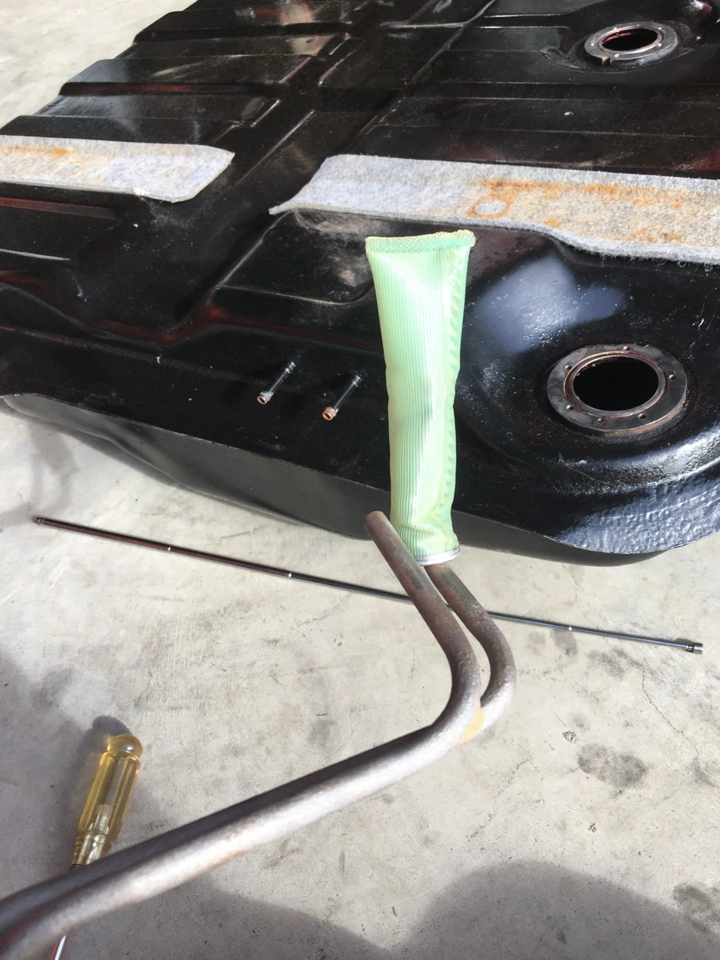

Just got mine back from the shop after being resealed. Guy said there wasn’t a sock on it so he put one on. Fairly certain after reading this and other threads that there was never a sock on the fuel pick up lines. Am i wrong on this?
i just bought one and it did have a sock on it. i have a 60 series tank in my 62 for my diesel conversion. i was having troubles with fueling at 1/4 tank or less and decided to swap the pickup. both had screens on them but i think the one in the tank was bent and not picking up the bottom fuel in the tank. new one fixed my problem but yes both had socks. i think the early 60s maybe didn’t have them but don’t know the year
Just looking in the parts diagrams, it seems that just about every Toyota in the world made in the 1980s had a " filter, suction tube" #77023-22040. Except North American FJ60s.
The Canadian diesel 60 and 70 series had them.
This part should fit onto your FJ60 as long the suction tube has a right angle bend on the end
