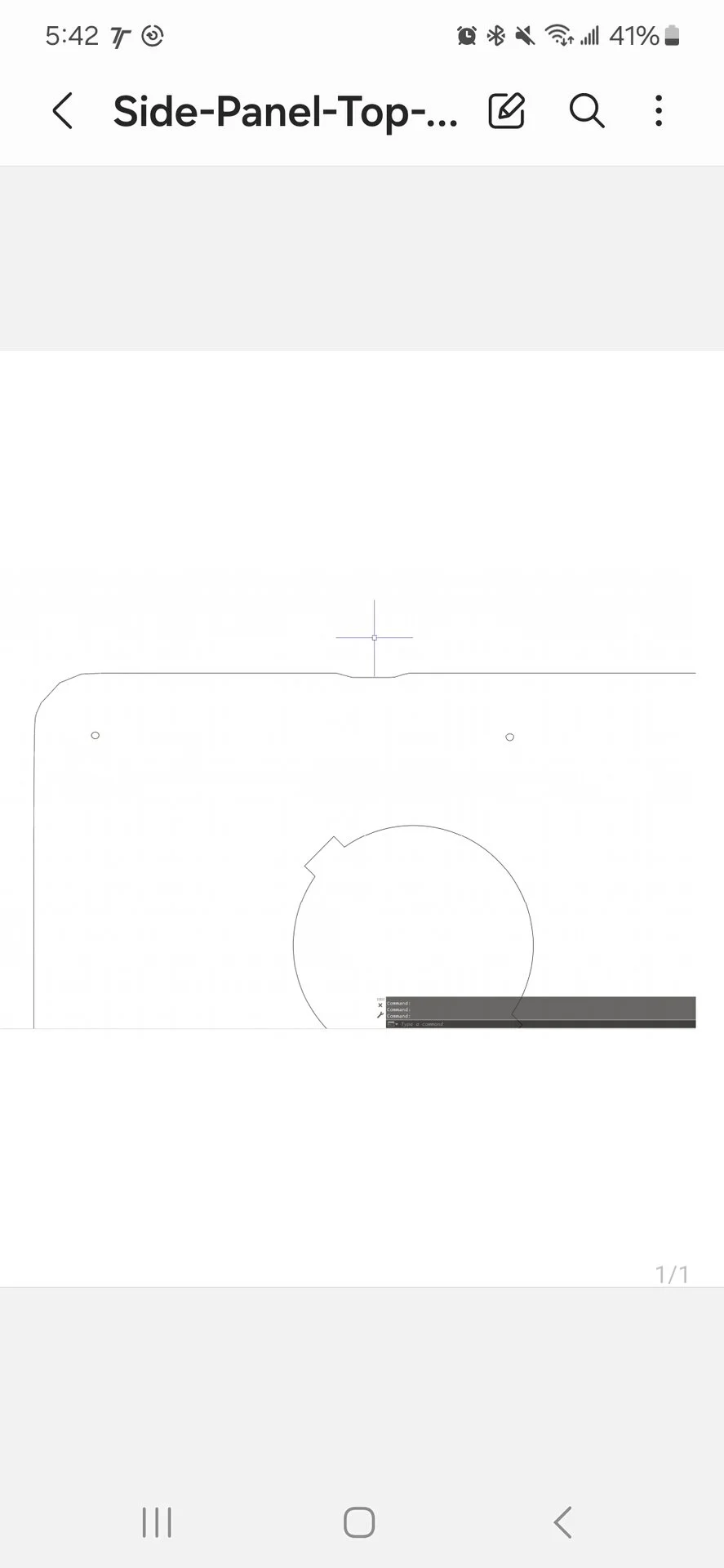

Appreciate the files! Why is there this bump at the top?

That little bump exists on my original panels. I copied them exactly, and that bump is there. It looks deliberate, but I'm not sure of the function. I also have a set of panels from another truck and same thing, the bump is there. If you don't want it, it should be easy to delete, or I can modify the file and send you a new one.

The small indentation above the washer fluid cover is likely only in the fiberboard backing, with the upholstery sewn on in a straight line above it. I have never seen an 81-90 cargo panel where the upholstery isn't a straight line right there. I would guess it's a fixturing thing, where the indentation aids in the manufacturing somehow but wasn't intended to be a part of the finished part - hence having the vinyl go across in a straight line.

This is interesting. Kudos to folks doing DIY projects and so forth, but these panels are a much more complicated piece than they seem at first. Out of total transparency I make & sell ABS cargo & tailgate panels. I've spent a lot of time on the design work and finding quality fasteners, so when I sell them the buyer pops them in in about 15 minutes with no drilling or tools required. I've run into seven variations of the panel outline and the hole locations change almost year to year. Some are slight moves and some are a little bit more than slight. It would be very difficult to make a one-size-fits-all panel that applies across the 60 Series range. This is a nice gesture to offer up a file, but it may end up being a lot of work on the back end. But hey, all the stuff I make started as my own DIY projects so I completely understand. There's something satisfying about seeing the fruits of your labor, whether or not you end up saving money.
