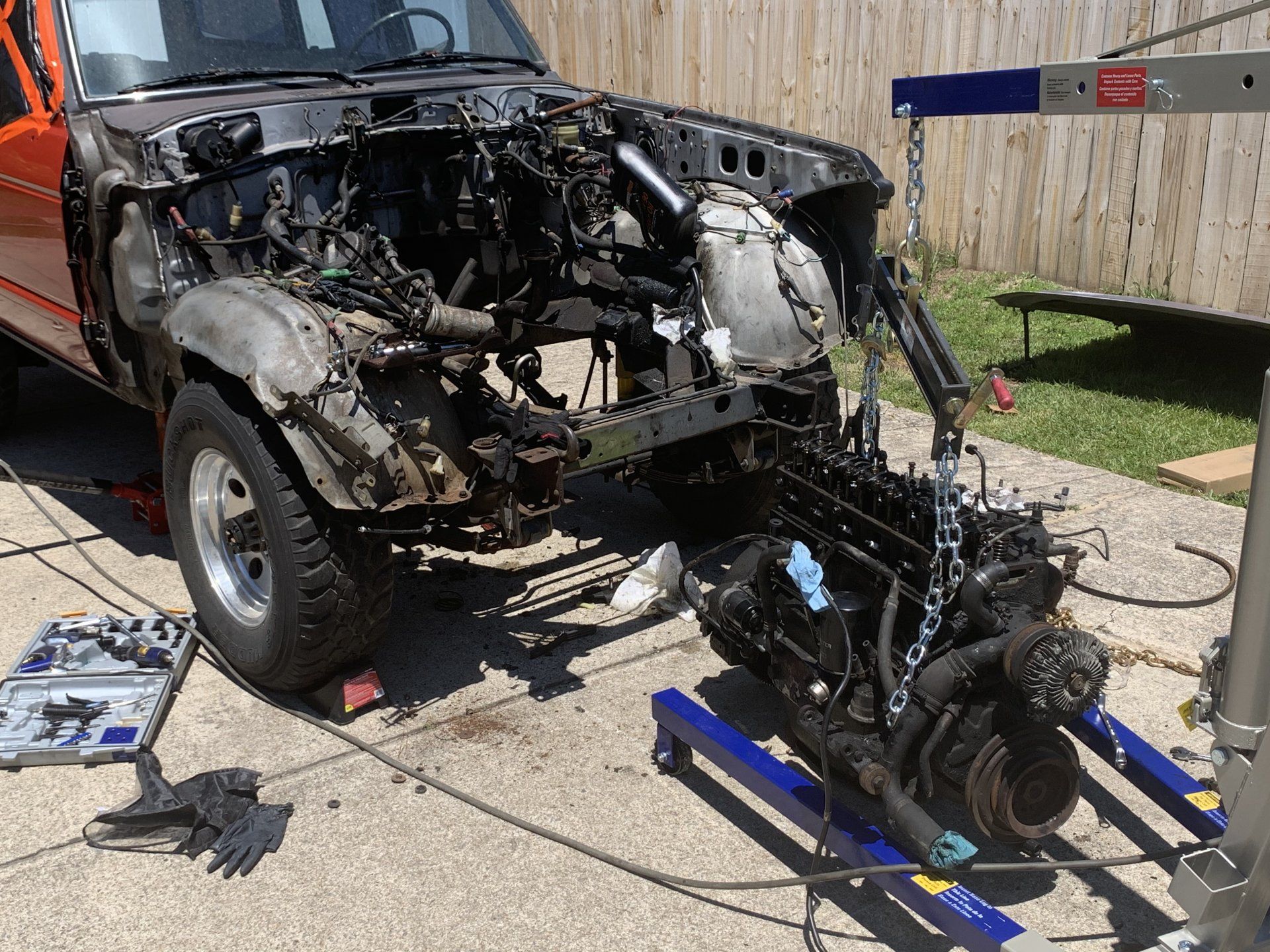

First thing was to pull the engine. I found a buyer from VA that was looking for something to swap into his late 60's LC. This was my first time ever pulling an engine, but turned out to be pretty easy. Between prepping for the pull the evening prior and the actual pull the next morning, it took me about 3 1/2 hours.

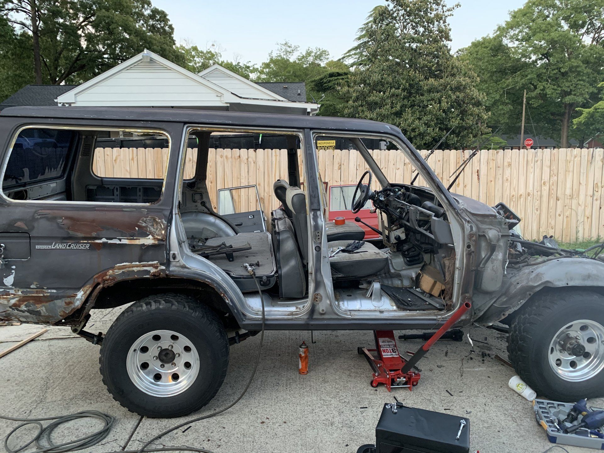

While I waited for the buyer to show up, I started stripping the body down. I pulled the doors, all the glass (except on the tailgate), and removed what little bit was left of the interior. This was by the early afternoon on day 1.
Besides the known damage on the body panels, I was looking for hidden rust issues. It actually turned out to be a lot better than I was prepared for.

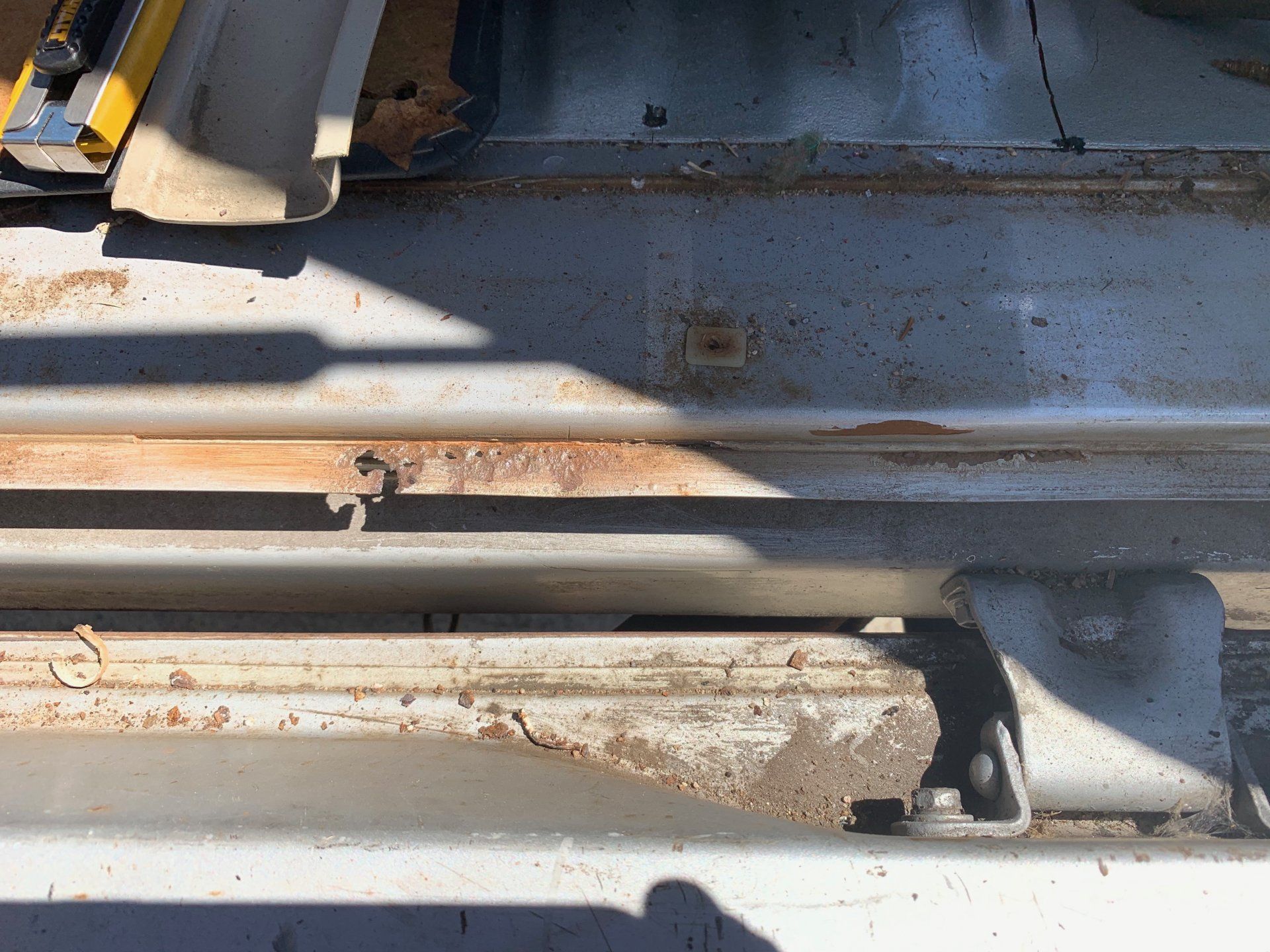

Some more rust was found.
DS rain gutter...
Bed at tailgate...
In addition to the spots pictured, there's a small spot in the floor behind the DS rear wheel well and a large hole at the PS mounting bracket for the rear seat-back. All in all not too bad. I already have parts to splice in from a donor panel for most of it and a trashed door I can get good sheetmetal from. The only concerning part would be at the seat-back mount, but my original plan for the interior doesn't include the stock rear seat. If my plan works, that hole becomes a simple flat panel patch.

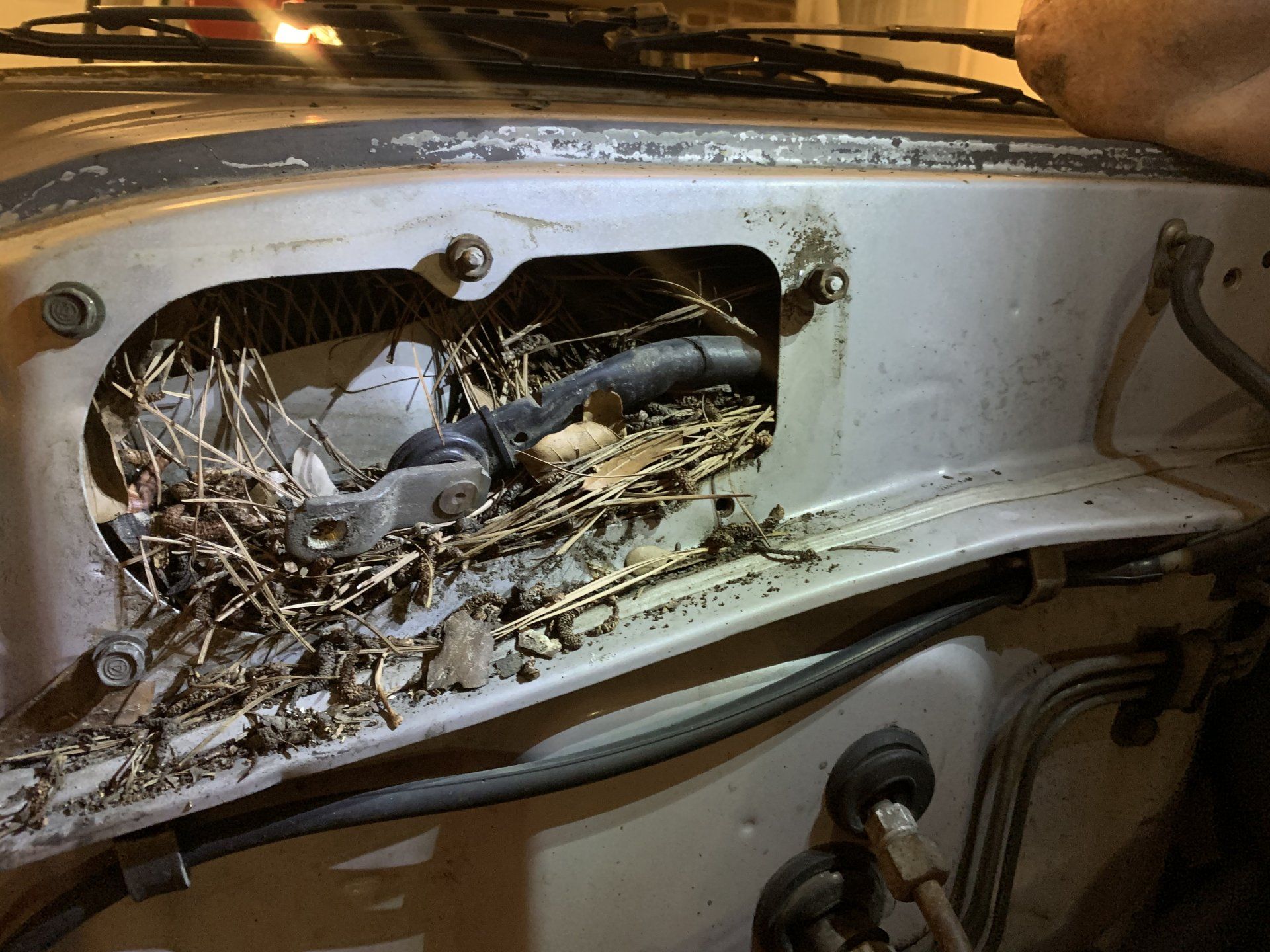

This past weekend I started digging deeper pulling everything apart and cleaning it out. This thing was FULL of pine straw and apparently home to a few hundred wasps at one point.
I pulled about a grocery bag's worth of crap out from the space behind the wiper motor.

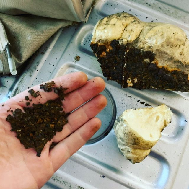

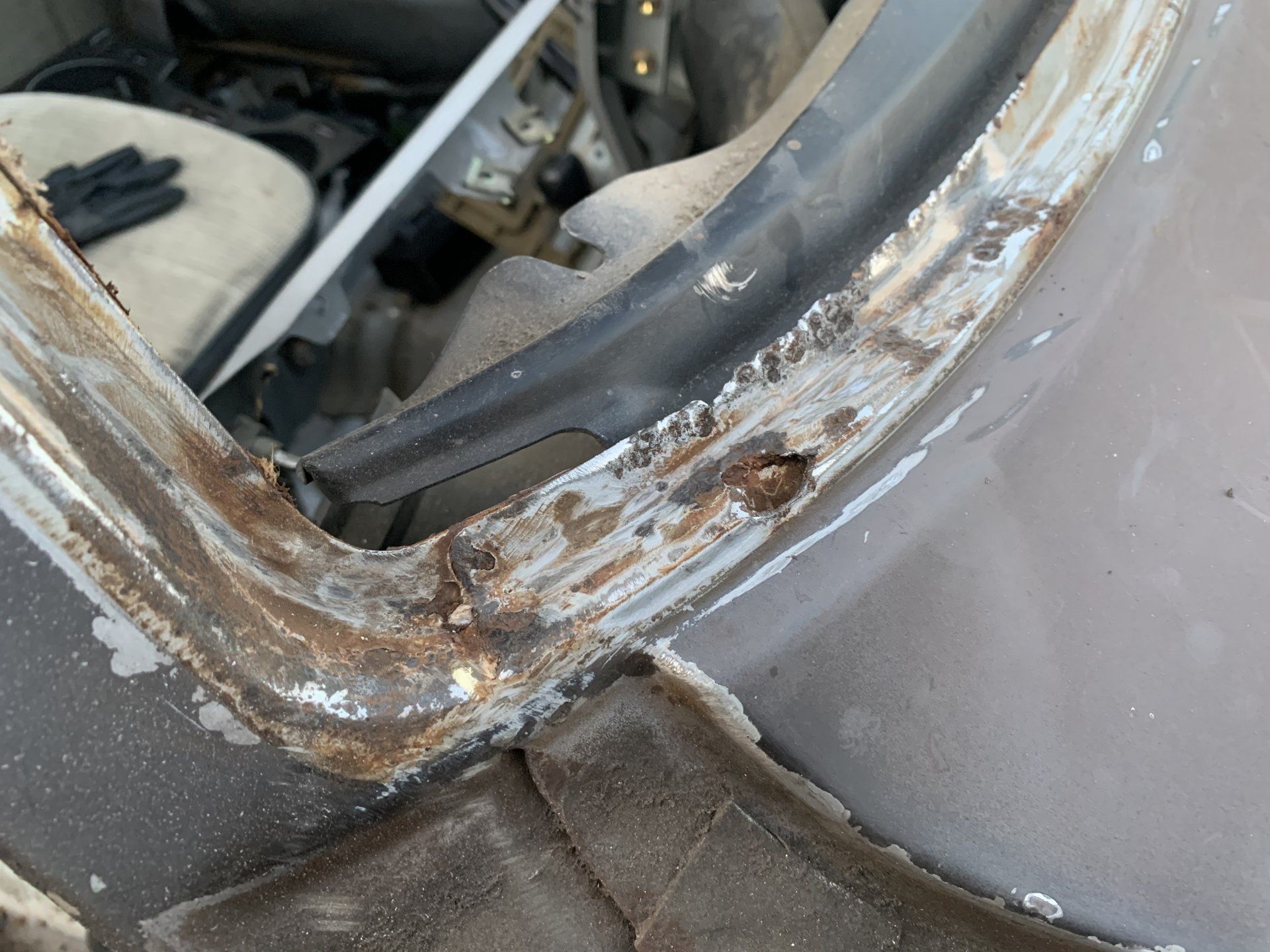

Looks like somebody’s foam fix didn’t stop the rust. What the hell, let’s just replace all the quarter panels.

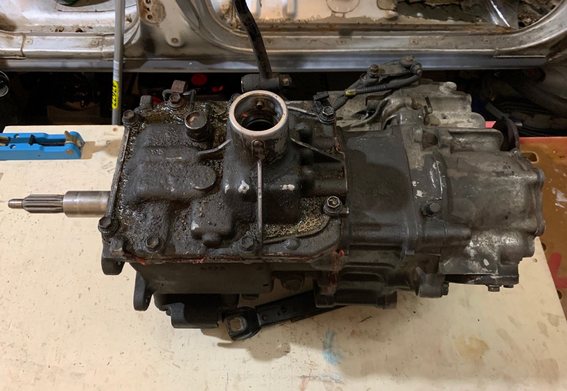

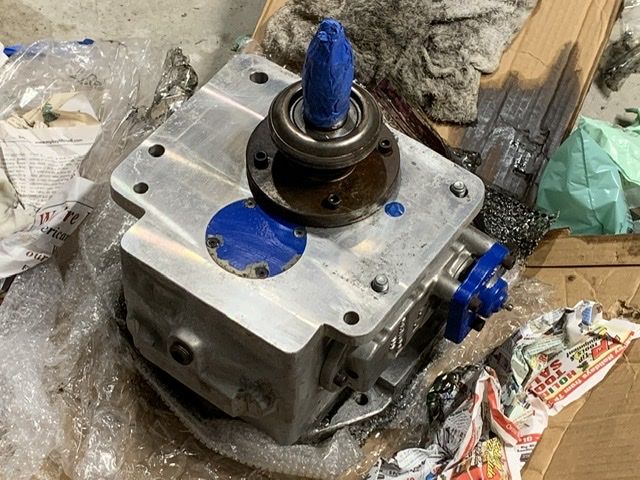

Got the transmission and transfer case out of the truck a few days ago. It was pretty nasty with about a 1/4 inch layer of grease, oil, and dirt. I spent about an hour or two just scrubbing it down and cleaning it up. It's starting to look pretty decent.
I popped the top plate off to take a look inside and see what kind of condition it was in. It looked pretty good...or at least it was all there.
1st gear had a significant number of teeth that had been chewed up some on the front edges. Because of a lack of specialty tools, I'm dropping the transmission off at a shop for the refresh. We'll see what they say.
