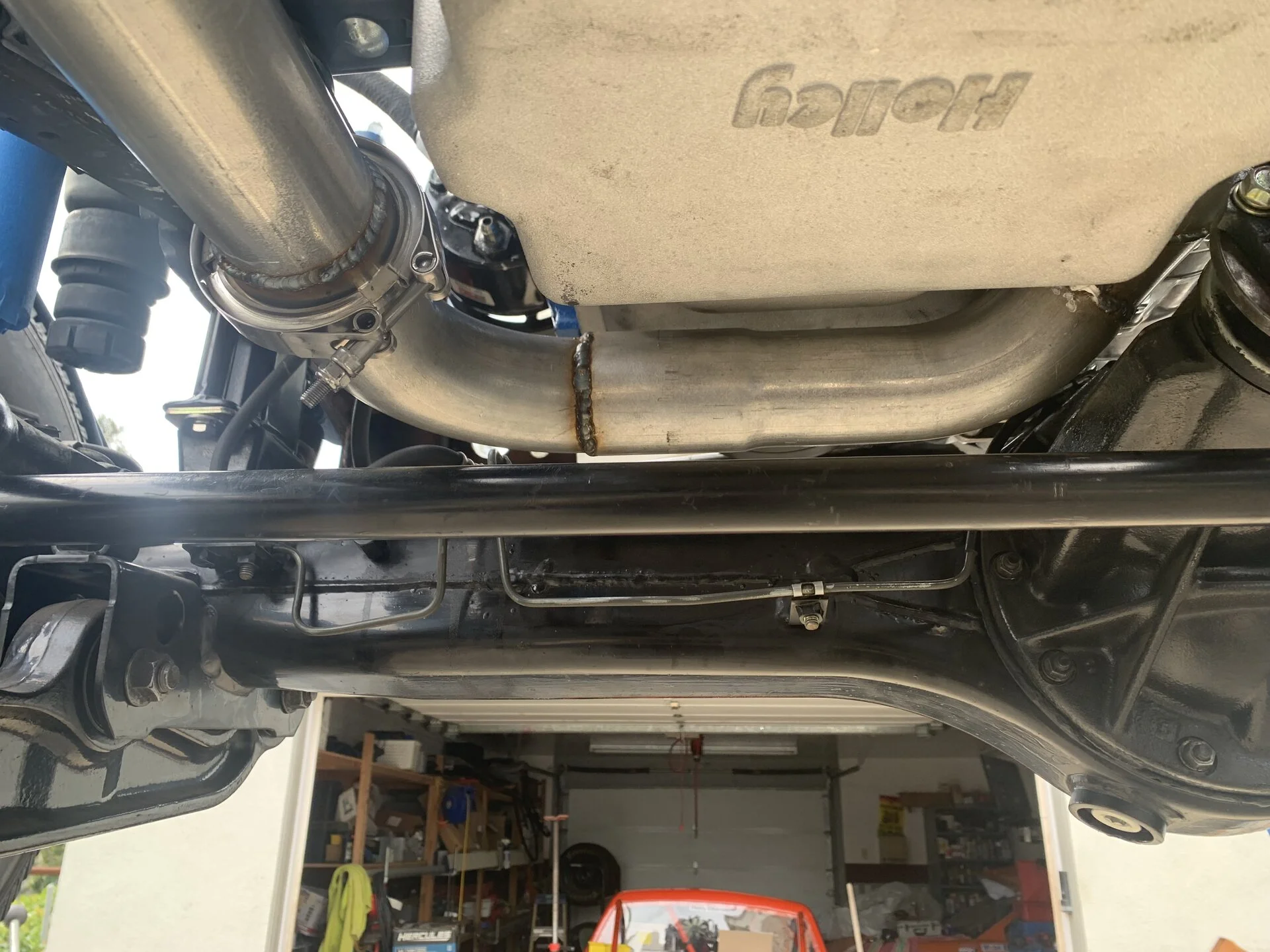

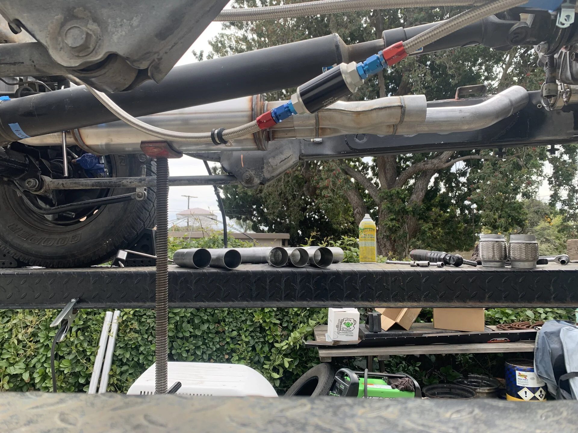

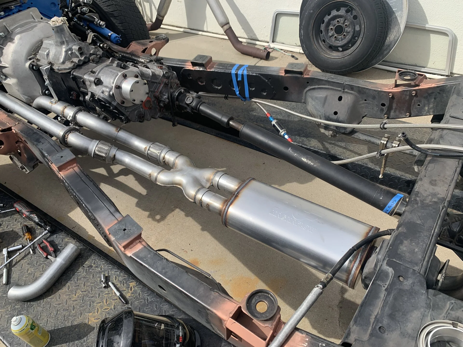

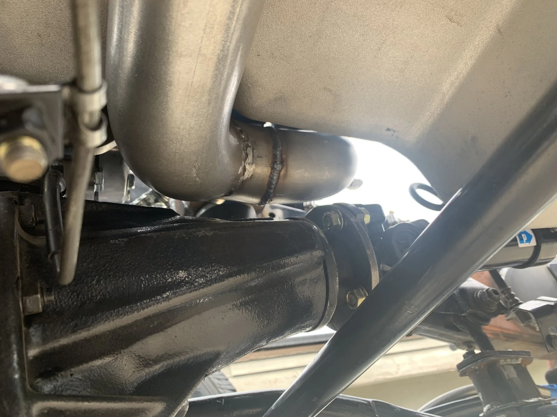

Anyone with a v8 swap able to share pics of their exhaust routing?
Cheers,
-Joe
I did duel all the way back. I suspect that you aren't looking for that as most collect into one.
I will take some photos tonight. I don't really have any dedicated to the exhaust. The one thing that I think helped me is that I have a custom crossmember that attaches under the frame and gives me room for exhaust. I thing the folx using the split cases and stock Toyota transmissions might not have the room I had.
