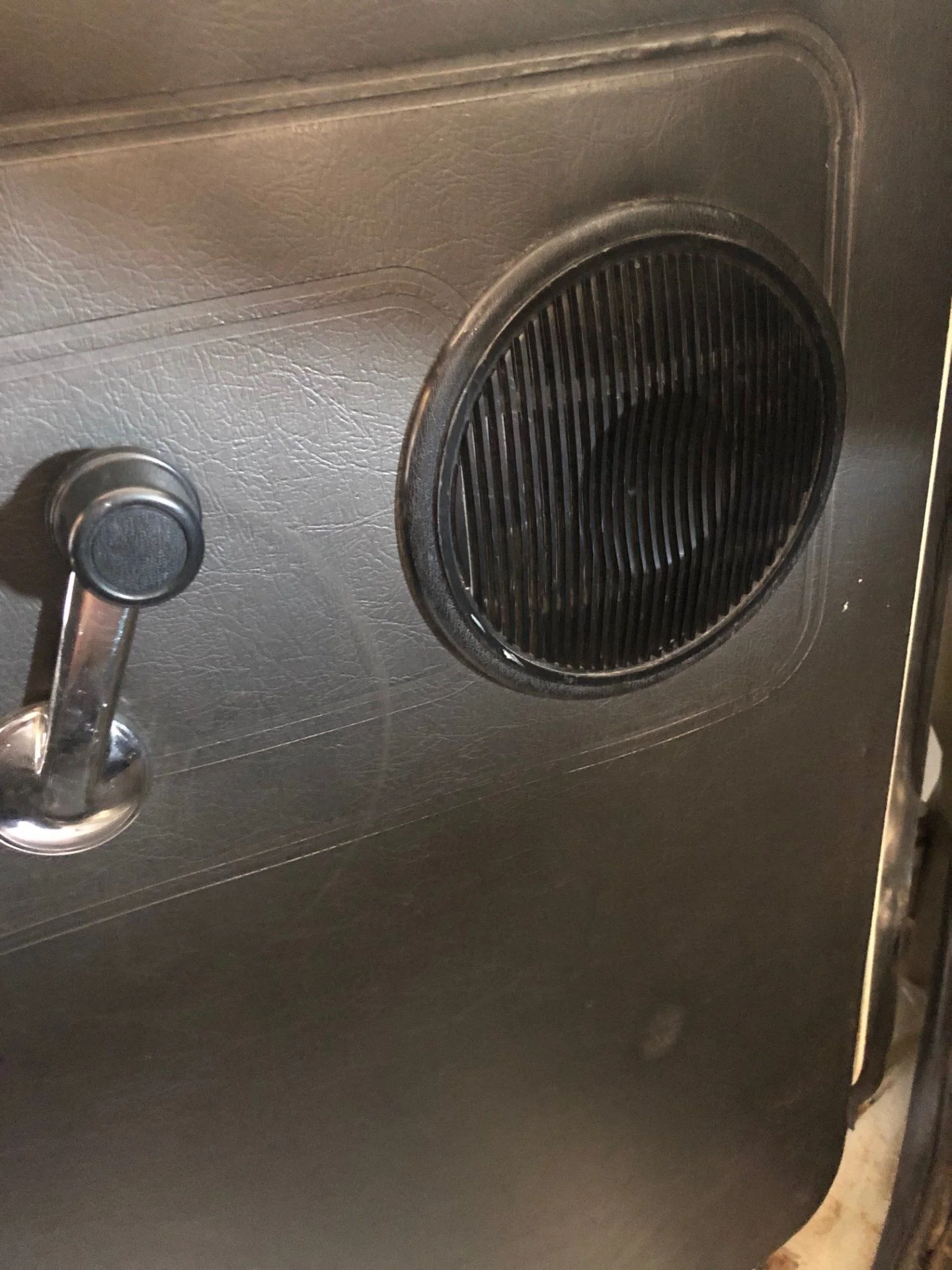

...or an opportunity. Attached shows 3 1/2 Kicker speakers mounted into the trimmed out ash tray cutout. Fit perfectly into the metal brace that supported the ash trays, which allows solid speaker to metal mounting. Speaker covers are recycled OEM ones that originally covered the factory's single rear speaker in the cargo panel.

Nice tip Jim!👍
Probably wouldn't work for later model doors without vent windows. Believe the main door glass that goes all the way forward might interfere.

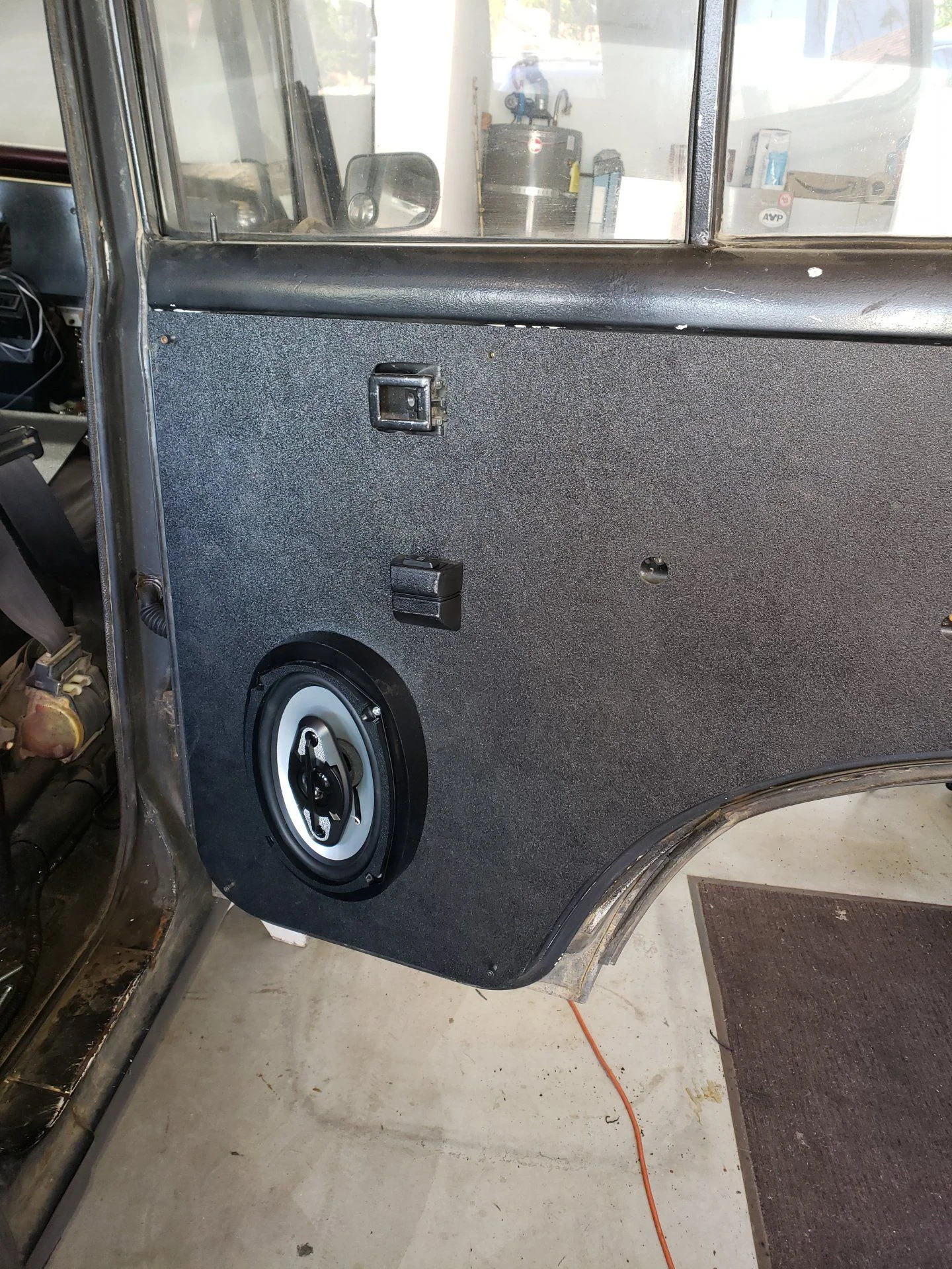

I don't want to take money from a supporting vender. I appreciate that we have people that make anything for the Pig. That being said, I got this sheet of ABS for $35 and was able to make all 6 panels.
I'm thinking any speaker that fits in the ashtray opening won't be deep enough to interfere with the windows- I just pulled my 79 panels.
Looks like you may be right. Been awhile since I had mine off.
