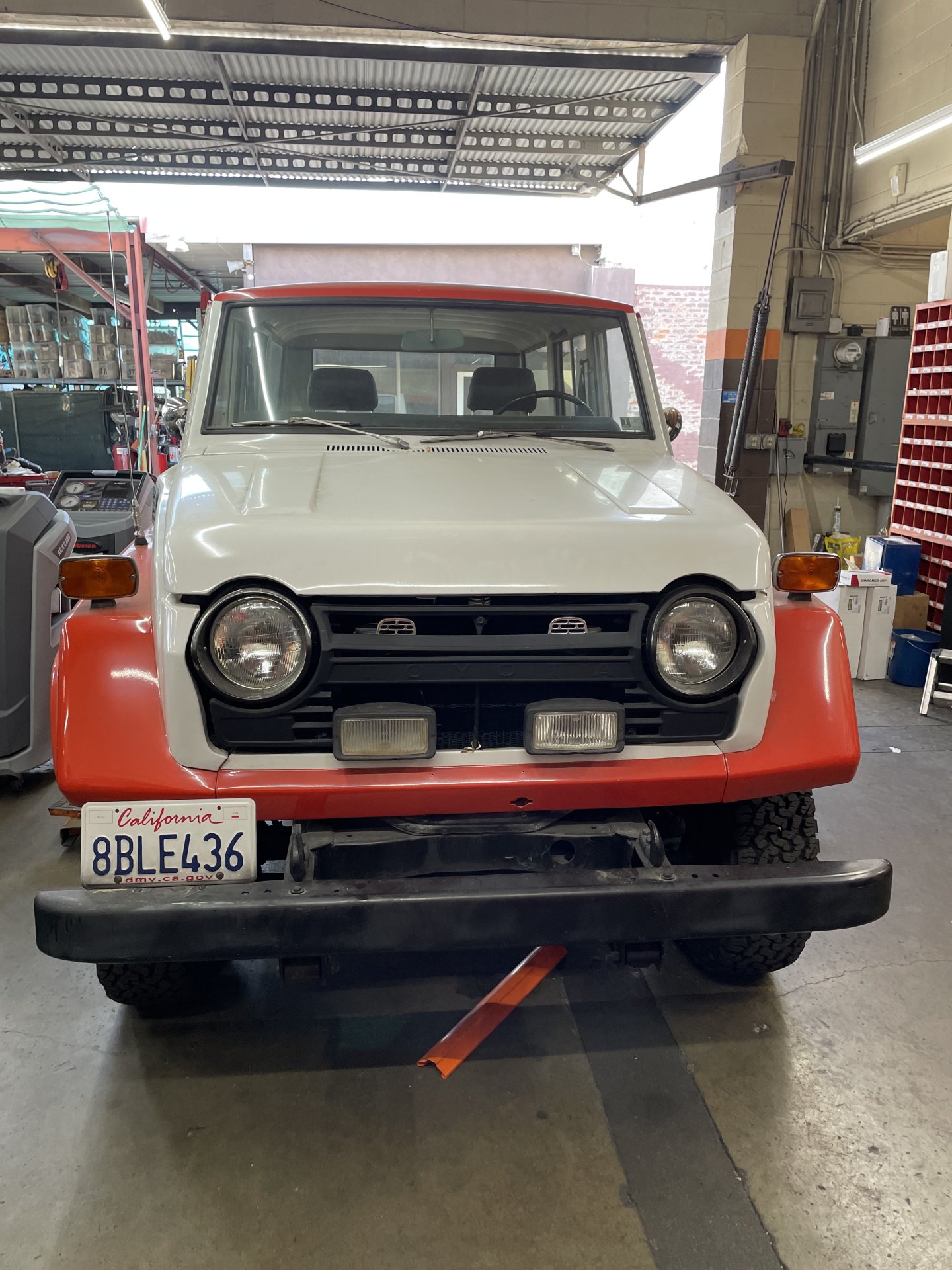

Hey everyone,
I have recently taken over the restoration of my family's FJ55... Though I love Land Cruisers and have driven them my whole life, my knowledge is very limited. I'm told the engine has issues, primarily crank shaft but other problems as well. It was suggested that I go ahead and purchase a rebuilt original FJ55 engine and have my mechanic install it... does this sound like a reasonable idea? And if so, where does one purchase such a thing, and ensure it is high quality? Any help would be *much* appreciated.
Best,
Wendy
There are engine conditions that can be addressed without the necessity for a total replacement. You mentioned the crank and other issues, what exact issues are there? How many miles on the engine? The vehicle looks in pretty good condition so what do you think caused the engine issues?

Pics of the engine please...

We'd like to see more photos, please.
