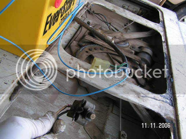

I did make a tactical error in this deconstruction. I pulled the main wiring loom before removing the tailgate, and with the window down. This is wrong :doh: Check out my solution. Basically, I hooked up a battery, wired it to ground. Ran the two blue wires from the rear main loom, to the hot side of the battery, and reattatched the tailgate safety switch. With the tailgate open, I pushed the safety switch (in my left hand) and the window rolled up (out?)
Before you go poking around the general fuel tank area with a torch, I would suggest a healthy application of dry ice (aka CO2) to the interior or the tank to inert it. Otherwise, this thread may end prematurely...and no one wants that. Also, roll the window about half way back down and remove the retaining clips from the base of the window channel...then you can easily remove the glass. But seriously stay away from the tank with a torch or any device that could spark (ie sawsall) unless you really know how to properly inert the tank...death is permanent and irreversible.

Excellent Idea! Its a great bit of safety, and it is cheap. I bought a pound of it at the grocery store for $1.13. Well worth it. In addition, (because of my intense fear of death), the tank had been drained, all fuel lines blown out with compressed air, all vents removed and blown out. You might be amazed at how much gasoline remains in those fuel lines even after you drain the tank. Another bit of safety that is well worth the effort.

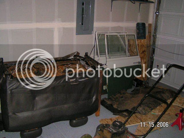

Did a little work chipping out the old rubber undermatting. Put up some pics of The Good (clean solid metal), The Bad (6cm crack through front bench mount), and The Ugly(Rust, damnable, cursed Rust)
