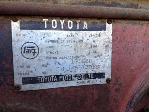

I went out and took a look at the ID plate on the firewall.
Does this tell us anything noteworthy:
Looks like FJ40Jim's truck is a late 1962 while D'Animal's truck is a '63. Clue being the "2" in front of the frame number in one and the "3" in the other frame number. But I certainly don't claim to be knowledgeable in early Cruiser lore...

Dan's 63 and my 62 look a lot alike to me: centered rear axle, external spare tire rack, no WS hinge plates, early door latches, etc.
The frame numbers are only 1004 apart.
Engine numbers are 1021 apart.
Dan's truck has the original 1963 dissy, but a dealer replacement 1975-ish 1bbl carb.
It means I can add it to the list when I get on a real computer.
The 63s had a steel plate instead of a windshield hinge. The 62s had the corner of the w/s frame and the cowl welded together.
