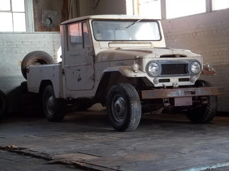

Build FJ45SWB recovered from a barn

Truck is sitting on correct wheels now, thanks again to Zebrabee.
Nice find Its good to see folks hitting the jackpot. I'm patiently waiting for mine. My bro just scored on a sweet 23 window VW bus he's been searching for yrs.
WOW! Clean the windshield and its perfect as it sits....
Wow nice find Jim!
That thing is sweet

What did you pay for it?
For the non-rolling truck with stuck brakes, almost no steering, no engine, no tranny, no brake hydraulics, no clutch hydraulics...?
I paid too much, if I stop to think about it. :hhmm:
Best not to think too much in these situations. :cheers:
