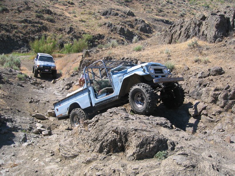

Owyhee Jackass was working on one. Don't know if he got it finalized???
Yeah. Looked like this:
Discussion here: https://forum.ih8mud.com/showthread.php?t=94375&highlight=roll+cage
some of the pix are gone. :frown:
Jim, You talking SWB fixed top or removable?
If it's fixed i've been thinking about 2 possible options.. One is a hoop behind the driver, take the roof cap off and drop it in.. You could also incorporate the seatbelts into the hoop.
If removable top build a small cage like Gary Cobberlys or others.
Other options is build a hoop on the back bed similar to Mudracks that's higher than the roofline.
Good idea. I've seen many race car cages built that way: chop off the roof, build cage, weld roof back on.
Already planning to install front split bench from ~02 Buick lesabre w/ integrated lap & sholder belts.
I'm angling more toward that, but it's hard to make it work/look right w/ the SWB bed. Easy to build a stout headache bar for the LWB bed, that looks stockish, but is much stronger material.

Back to the cage, are you just wanting a rear hoop or are you wanting a complete cage? I still have the stock tank and my cage clears the filler pipe, I just had to rotate the filler 90 degrees so as to miss the vent/anti-gurgle tube.
One thing I'd do different is make the lower section of the cage seperate from the upper and have a bolted coupling somewhere above the tub/cab flange. with the way my cage flares out at the base (in order to maximize legroom) there is no way to lift it in and out in one piece, I had to build it in the cab and can't remove it without cutting it apart.
