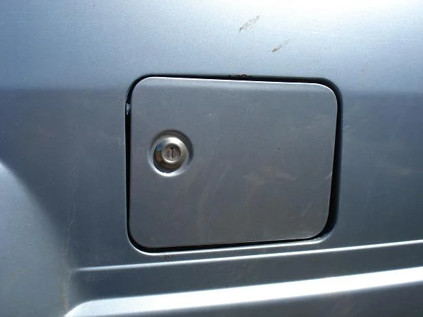

This is a 1st gen 4Runner filler 84-89.
The 90-95 did not have a lock in them and the doors were plastic, I don't know about the later ones.
Mines a little bent.... You can open it with the key (If I had one...) or from inside with the pull knob.
