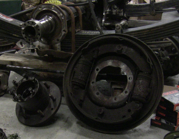

I have a set of axles that I believe came from a firetruck or something (they were painted red--and not just by a rattle can--and I don't know who would do that except a fire department), and they had the heavy brake drums. Here's the rear all finished:
The brake shoes are roughly a third again as wide as the standard 40 series brakes, and CDan can get them (also the wheel cylinders, etc...)
What's really interesting is that the front axle was matching--and had what I beleive is a later model housing. It has a different gusset (probably not the right term) between the U bolts than the other axles I've got (79+). Not real sure what the deal is, but I definitely have the hub nut seal FF rear
Dan
Dan,
Not sure if it helps you or not but that's the way they sold the 45's in the late 70's in Canada. The larger finned 4 wheel drum brakes/parts are available from the dealership for an arm and leg (here anyways).
If anyone is curious they also have different backing plates so it isn't possible to just throw them on the front (or back) of an early 40 for increased brake lining area.

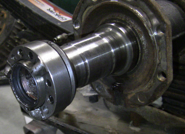

Fwiw we ran into an anomaly of sorts today. RufusTheDufus has a 7/80 HJ but has two wheel cylinders (=early), 8 backing plate bolts (=early) but the it uses the later 8/80 & up model 90310-35001 inner axle seal as opposed to the seal in the nut. I had never seen that combination before but then again most of the full-floats I see are later 40/60 imports or 80 Series stuff.
I measured the diameter of the machined face that the axle seal rides on. It's 35mm.
Here's a couple photos of the setup in my axle. The truck is a 7/80 Australian market HJ45. I assume it's the original axle but have no way to verify it.
You can see the seal inside of the spindle in the second photo.
Is the thick collar and lock ring a better way to identify early/late axle seals? I guess the seal inside the spindle is an easy indicator too.
So the later style full floating axles are smaller in diameter?
I'm not sure on the axle seal surface OD, I'm not by any of those seals right now (if you look closely at the ones we sent you it should have the ID shown in mm), but yes the later FF's had a 35mm seal surface unless they were OE replacements in which case some came with 36mm, for that reason we stock both style but have only sold maybe 4 of the 36mm in 5 years that I can remember.
