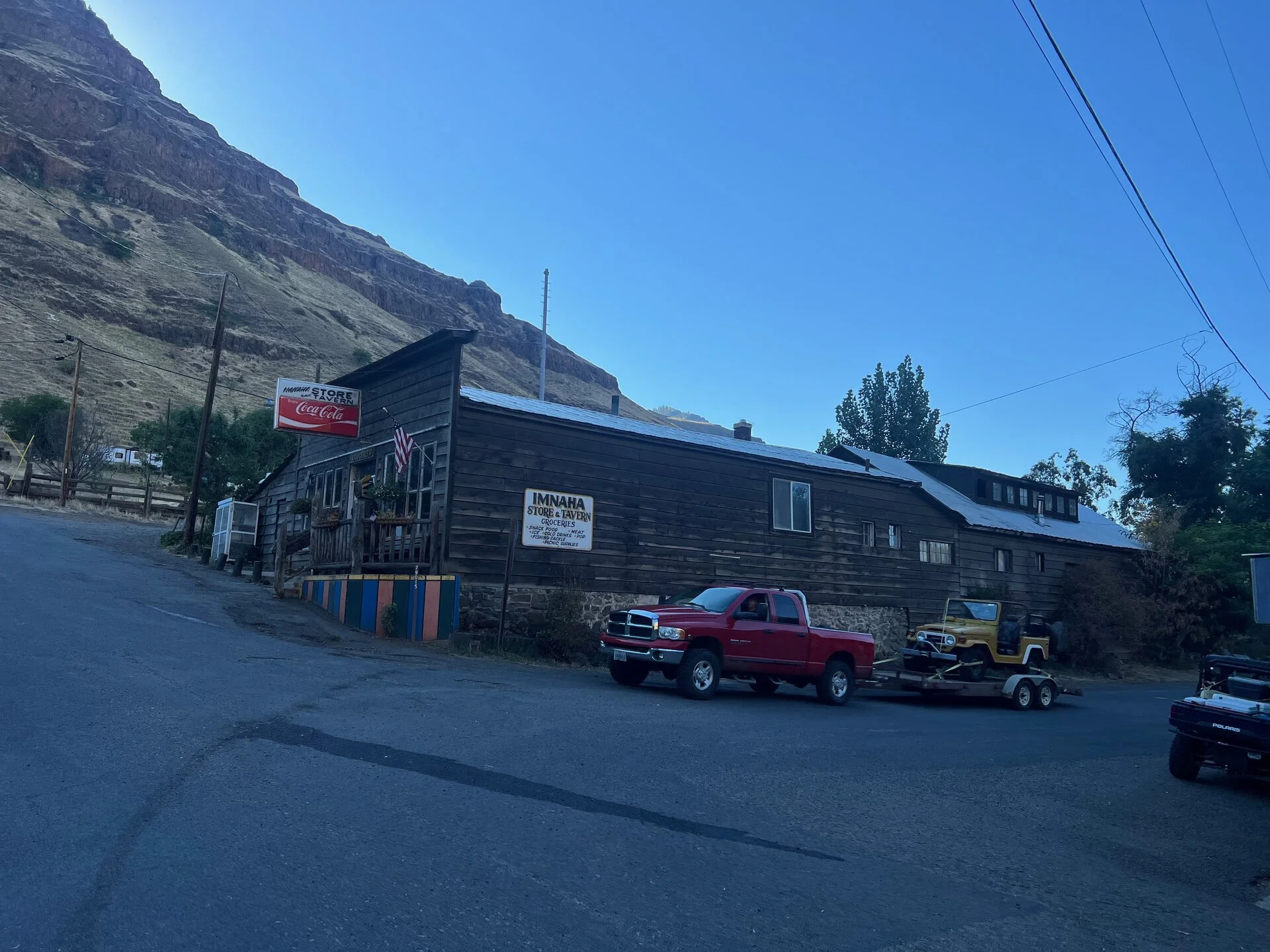

Last Friday we trailered my cruiser out to NE Oregon to get married. Cruised around Joseph/ Enterprise just fine the night before. Day of, ladies took my red truck (to keep their hair nice) and the dudes rode in the 40. About 20 miles out of town a knock started in the cruiser. We pulled over, checked fluids (all good) and decided we'd forge on to Imnaha (tiny town in the middle of nowhere). Knocked louder until we made it into Imnaha, make a loud kapap sound and lost all it's coolant as we coasted into a parking spot along the bar. She did her job and got us there, and the incredible bar owner loaned us his truck and we made it up to the prairie for the ceremony.

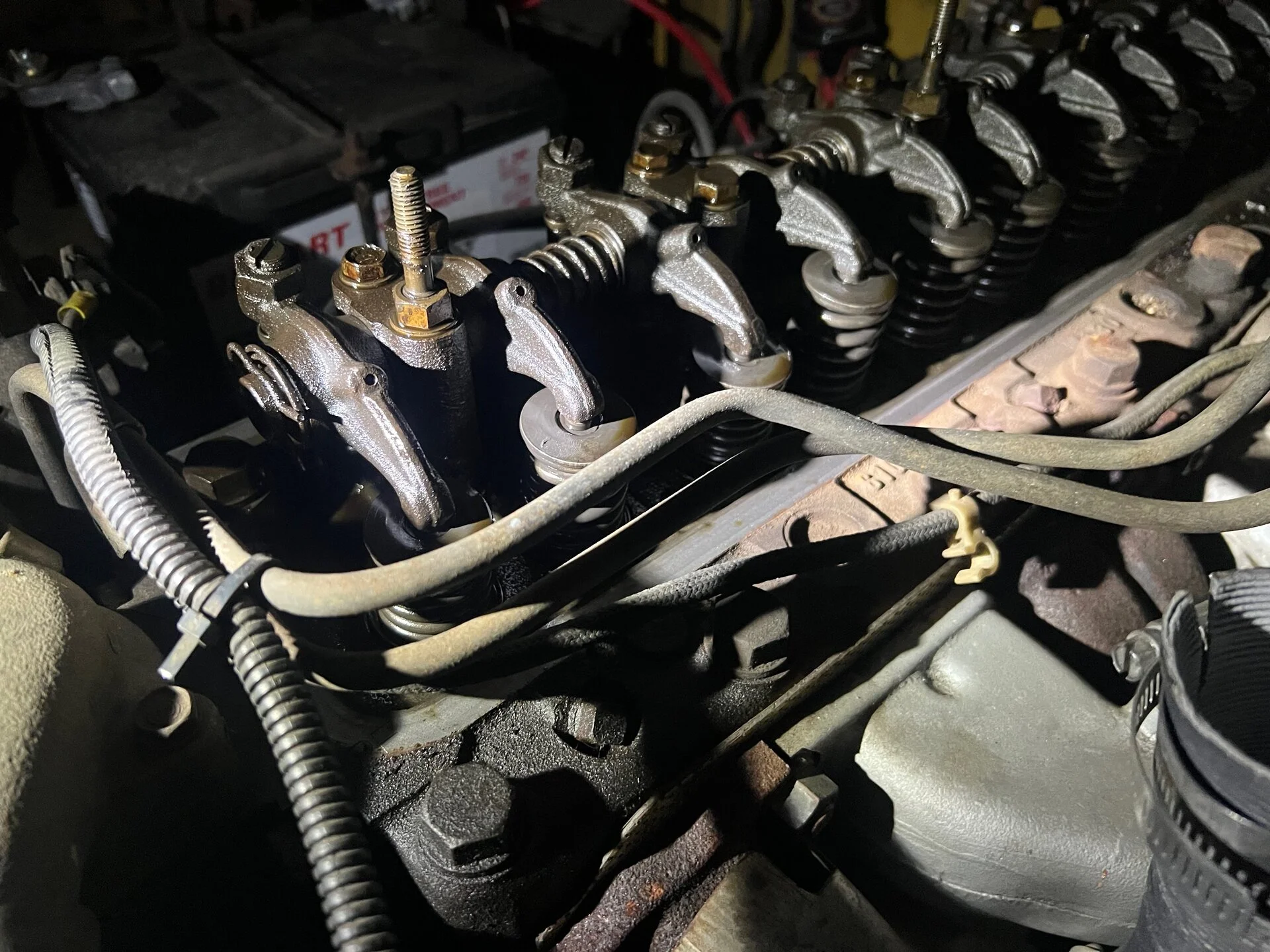

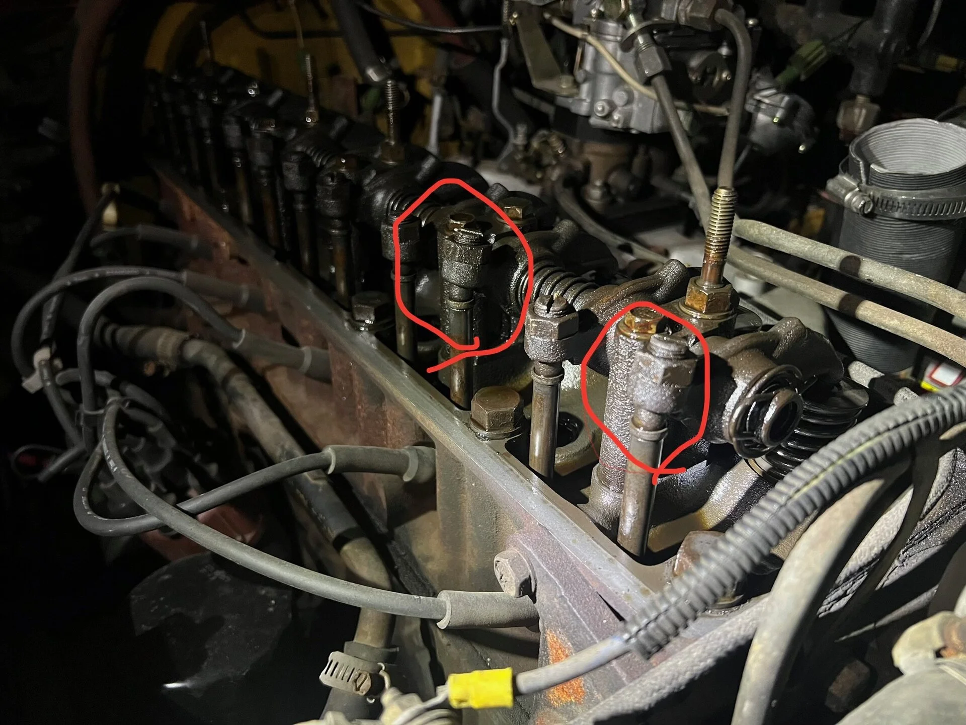

Tony at LCNW told me to pull the valve cover and I discovered some bent parts. Haven't heard back from Tony, but any guesses on what I'm looking at and what direction I need to go for repair/ rebuild/ replace?
I got my 40 when I was 15 years old and have kept it mostly stock, looking forward to your advice.
Your push rods don't look bent to me in the picture. How did all the coolant exit the cooling system? Was it overheating before this event? Is the water pump locked up, or does it spin? I would start with draining the oil and see what you find. And congratulations on getting married! :beer:

I agree nothing looked bend on the rockers just those pulling the valve open.
Thank you for the replies! And sorry for the novice response to the rockers looking bent, the more you know(that they have knuckles that can bend!)

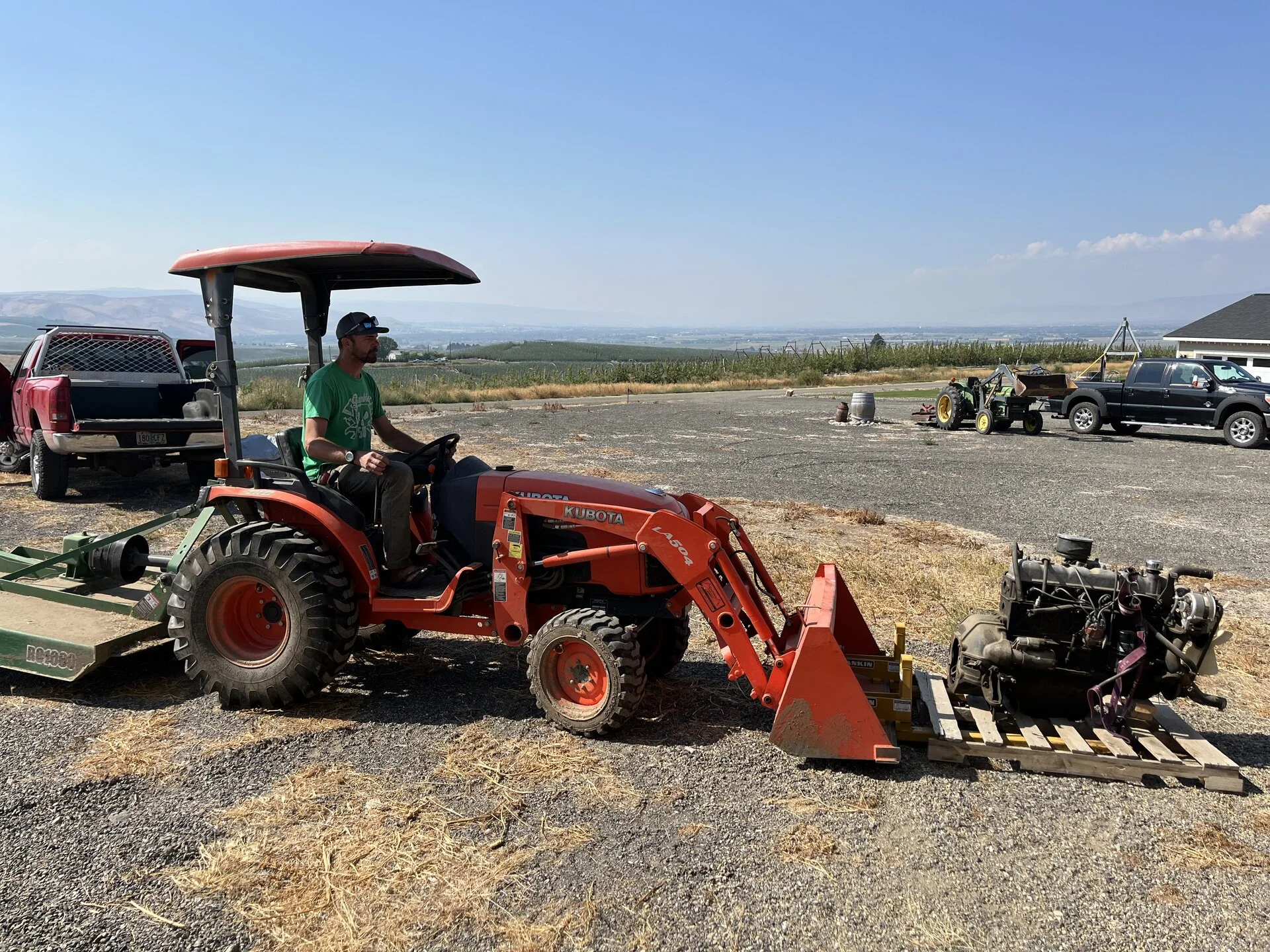

Thank you guys, acquired new (to me) motor and will clear out the garage for my winter project. The previous owner wasn’t even home but had enough trust in a fellow cruiser owner and my wedding story that he instructed me into his garage to use his tractor and get it loaded. Paid the neighbor and off we went!
The numbers on the side of my current motor don’t exactly match the vin and I know the rig had a major restoration in 1992 (so maybe new motor?). Either way I’ll keep it for rebuilding or find a mud member that wants a project.
