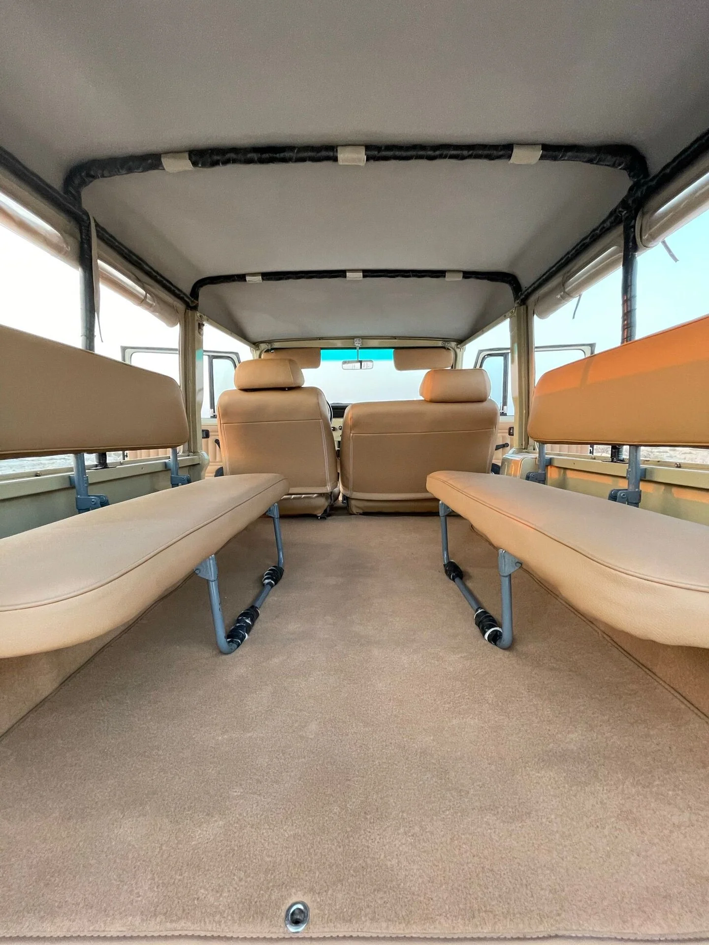

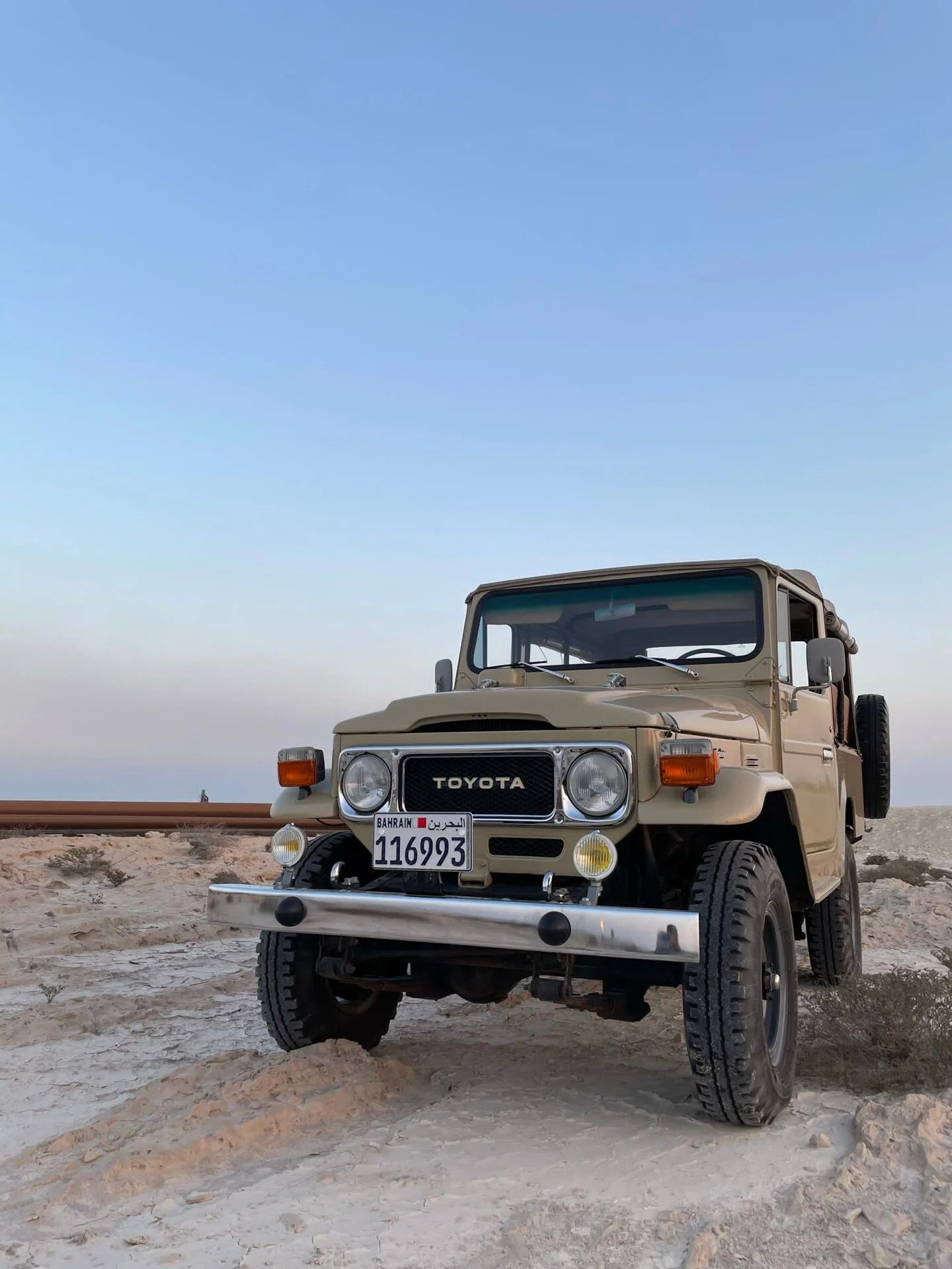

Sadly had to leave my FJ-40 in the states while I'm deployed but completely in the throws of FJ addiction.
Found a FJ43 that is pretty much good to go; few little things to do with paint and spark plugs. It looks like most of the pieces between FJ40s and FJ43s are similar/the same. Seems like there is very limited info out about FJ43s but was curious if anyone had experience/knowledge of particular issues/differences noted between the two that would be useful to know before getting to work on the FJ43.
Any info would be appreciated!
Hard to see a downside to that Cruiser. 😊
FJ43 is the same as a 40, just a little longer. Same 2F, without any emissions equipment. Still uses points instead of electronic like USA received starting around ‘78. The minor differences will be addition or lack of power steering, ac, heater/defrost. Yours doesn’t appear to have heat or ac for the later bezel year so it’s a pretty minimal truck. H41/h42 4spd and splitcase are likely. With all the fancy work done I’d be curious what else has been done underneath or under the hood. The electrics and hoses all seem to be sprayed with the body color so that’s not usually an ideal situation for quality control on a ‘restoration’.
Otherwise - it’s a pretty truck! Definitely post engine pictures if you can.
Obviously either a 81 or 82. Will have most of the lastest improvements. Doesn't have the insert dash. Also doesn't have a H55F five but those seem few and far between in that region of the world. Of all the cruisers could import from other markets a LHD mid wheel base is right at the top of the list. If you have and of bringing it back later couldn't go wrong with a good mid wheel base. These generally are in better condition than those from South of the border.

x5 nice truck, looks like he had a lock on the hood at some point (three holes under front lip)
most likely put the padding on the bars to reduce the flapping/slapping of the canvas... nice carpeting... he must have liked a quite truck :)
OEM chrome front bumper and bezel is a plus

Rear springs are mid wheel base only. Front share the same as the FJ40. Should have the hand brake on the rear axle. Could be a semi floating or full floating rear axle. Both desirable here in the US as they are a direct bolt on to the 40 series.
Did you buy this or just considering buying? Really a neat looking 40 series as others have mentioned, the interior looks very "refined". The under hood shot backs up the comments that @mattressking had about the quality of "restoration". Don't over pay for this truck because the exterior and interior are so nice and shiny. Have you looked into costs to get it back into the state?
