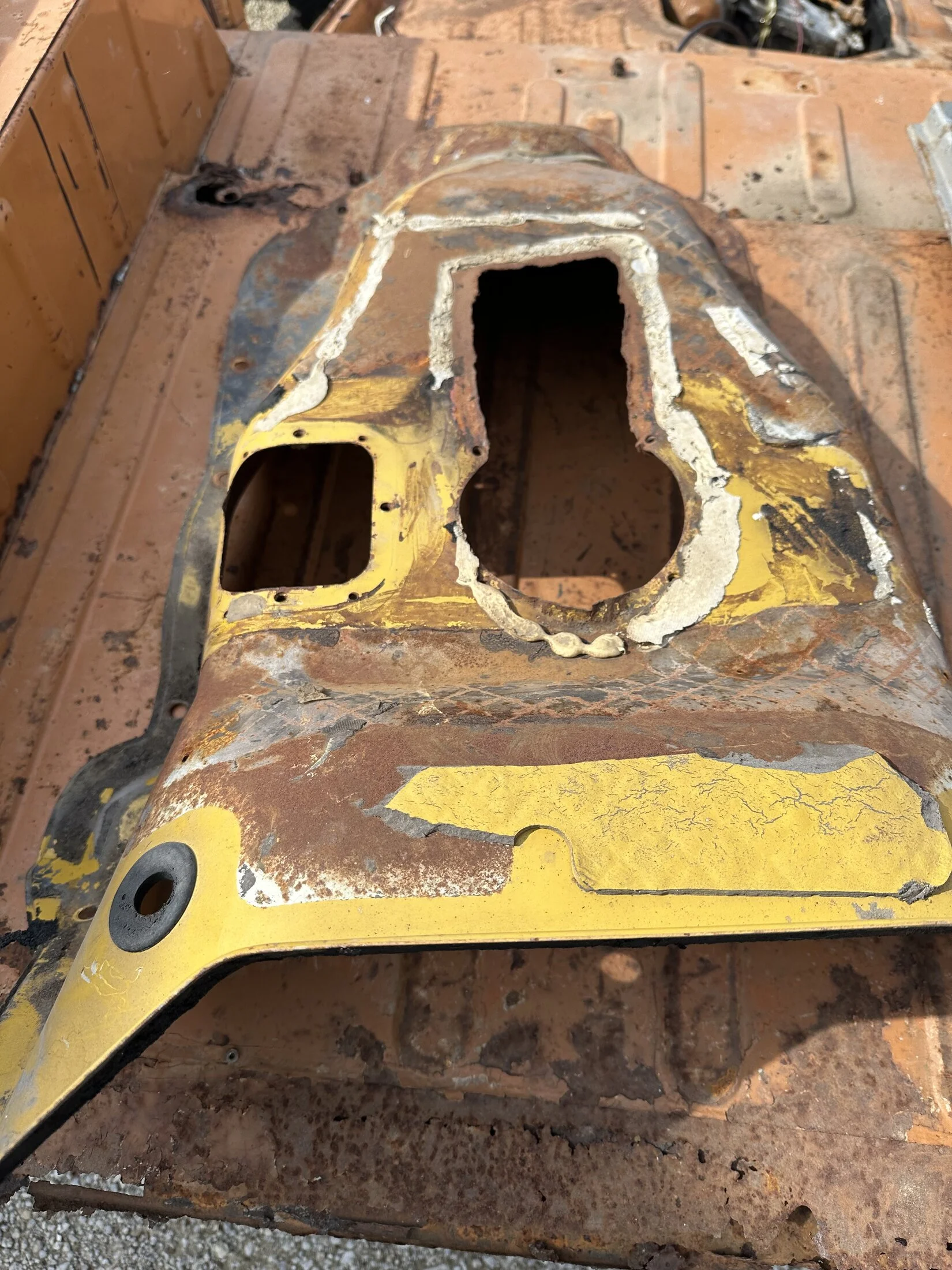

I assume from your description it doesn’t look like this, but thought I’d throw this out there…

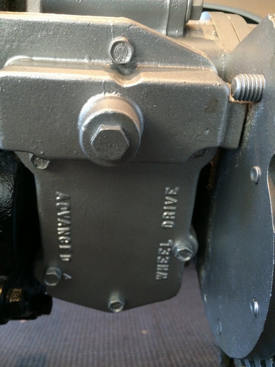

Only mentioned you Mark was of this post of yours in the Todd overdrive thread that JohnnyC linked above.
One of the crazier OD T-cases to cross my path over the years. I have seen the remnants of two of those.
Interesting thing is that the housings had markings on them that said 'Advance', tho I'm virtually certain it was NOT AA.
I'm not sure if I still have the box of parts from the one I pulled off a customer's trans for a stock t-case install, or if I tossed them.
IIRC, the principle was very similar to the Stroudski.
:meh:

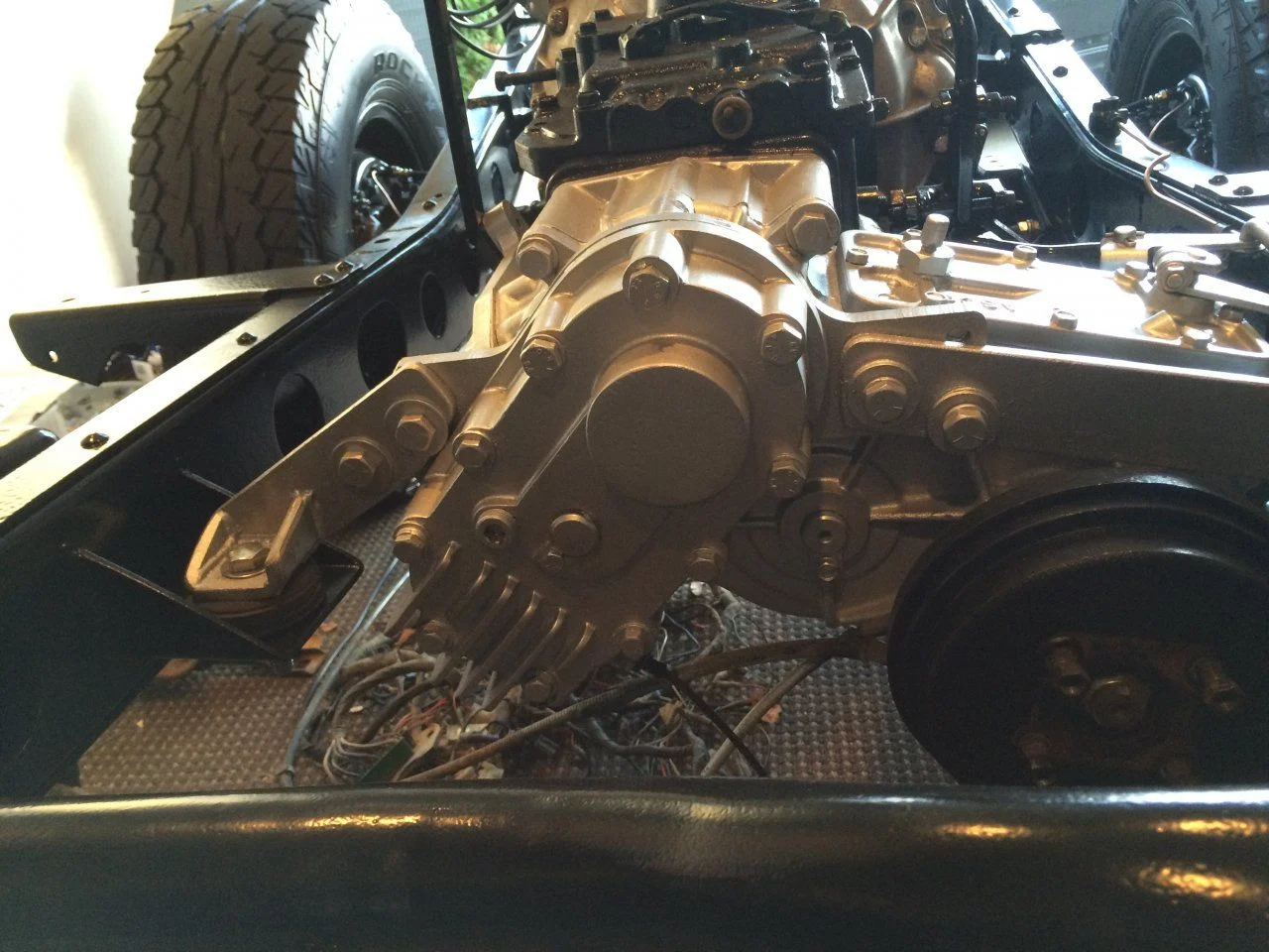

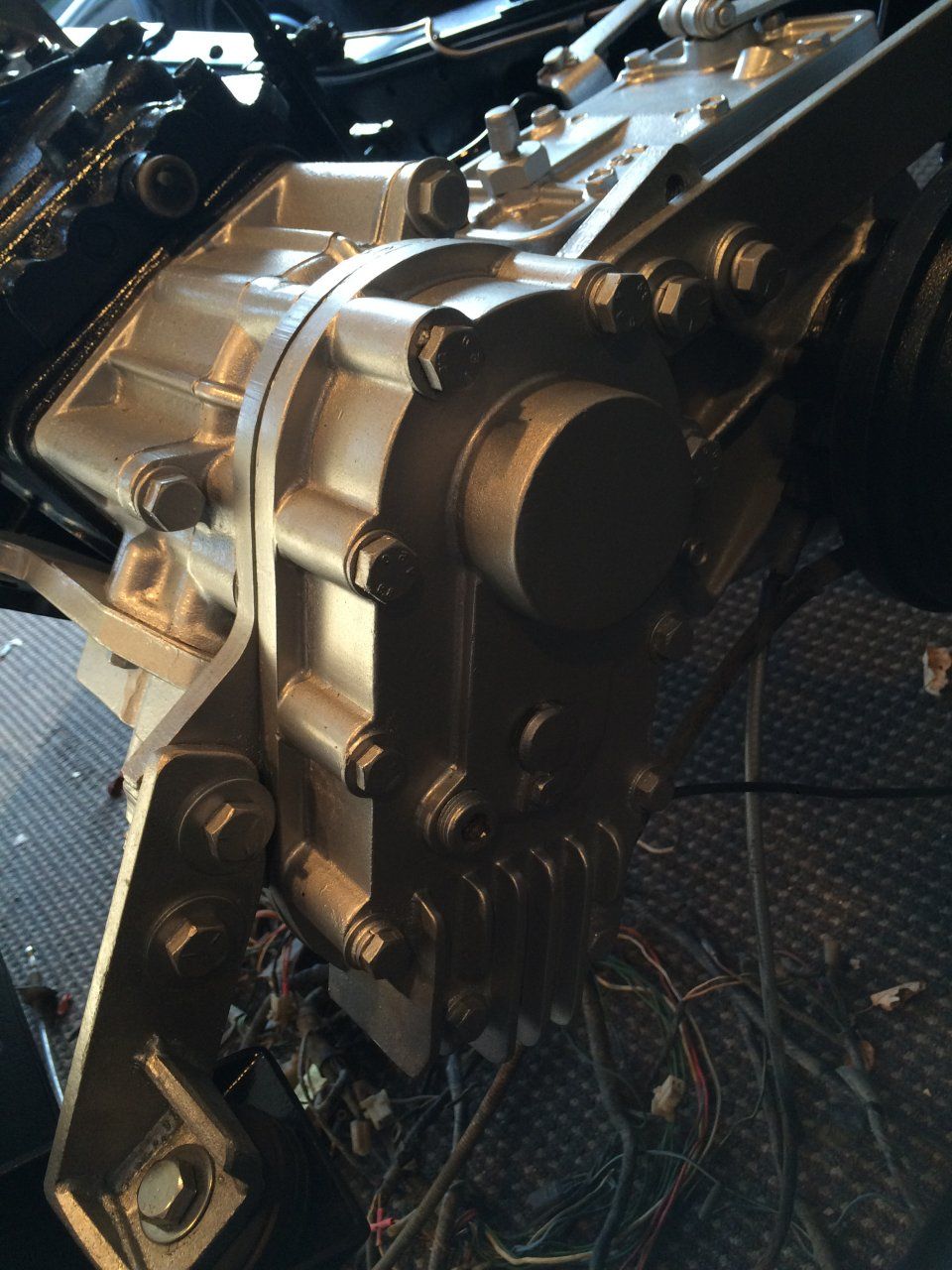

Looking at these pictures @JohnnyC posted a link above a PTO will not mount to a transfer case with a Todd OD mounted to it.
