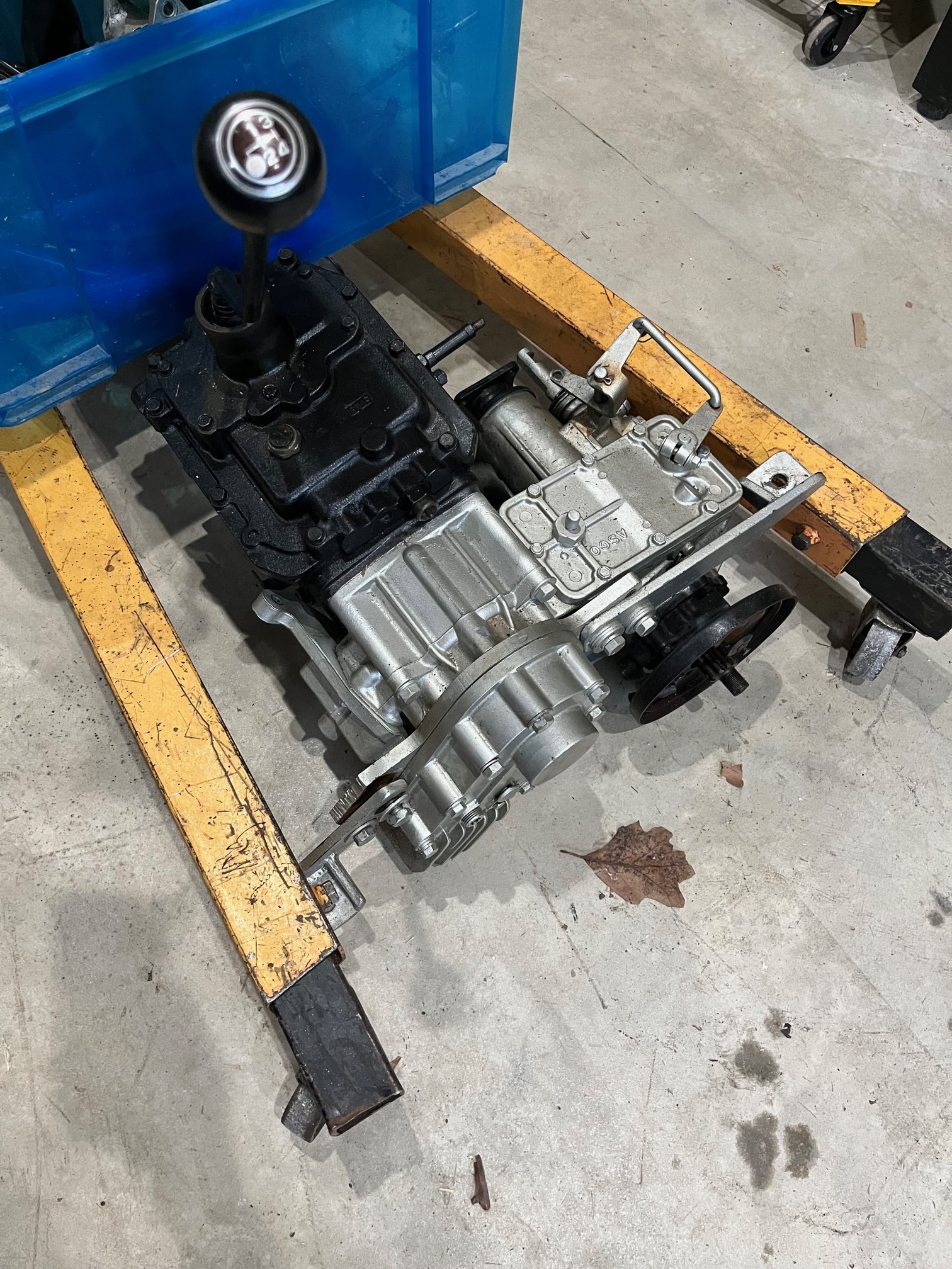

Looking at these pictures @JohnnyC posted a link above a PTO will not mount to a transfer case with a Todd OD mounted to it.

Interesting. Attached are some pics of the transmission + transfer case + Todd Overdrive Unit. I "hope" it will allow me to use the PTO unit for the PTO winch. If not, then I'll have to make a choice between overdrive or PTO.
Anyone out there have an opinion? "IF" you had to choose between having overdrive, or having a PTO drive, which would you pick?

Might be wrong but think the Todd OD is controlled electricity. The fins used for cooling and wires on the lower back would suggest how it's operated.
@FloridaLife do you have a picture of the transfer case and OD your buying? I have a set of Torsen axle differentials. These in an early 40 series with a semi floating rear axle. These use a C clip in the diff to hold the inner axles in place. I almost torn the diff apart to pull out the inner axles. Luckily I didn't. These have a number of worm gears. They can only be assembled one way. One gear wrong and the diff will destroy itself. The Fairey is not as complicated but need to know how to do it. I would suggest if you can't find install instructions would film the dismantling. Because it's bolted to the back and PTO opening. Not seeing any easy way to just unbolt and remove it.

So what the area for with the cooling fins and wires. Just internal switch used to for light when OD is on would not need cooling fins.

Yes, here are a couple of pics:
Okay looks like the transfer case could be a 1/74-4/75 based on the high low shift linkage. Picture of the gears from the top would be the best way to time. The idler gear in that range would have two different widths on the gears. That does not require doing anything with the OD. I see the lever. Wasn't expecting anything so heavy. Fairey OD only used a rod. My it's location it would interfere with a PTO if it was possible to mount one.

Looking at the diagram looks like this works basically the same as the Fairey OD. About where needle bearing #6 is where a PTO gear would have to be. Gear #5 is the transfer case input gear and right behind is the PTO. Neither of these gears are stock Toyota gears. This are special gears for the OD. Everything between the transmission tailshaft to the transfer case idler gear is special OD parts.

My impression of the Todd OD is the housing is much stouter than the Fairey OD. It's design allows it to extend less out the back. This may allow it to be shoehorned in a pre 9/72 with a four speed and straight six without modifying the torque tube. But because of the design it does not allow the use of a PTO. Both share needle and cage bearings. I see this as a weakest link in the design versus the housing. Of all the Fairey ODs that have been posted on Mud over the years the problem has always been internal not a housing failure.
Believe all the pictures of the Todd OD looked to be the same one. Would appear to be a 1/74-4/75 transfer case. This is a transition case case used on the early four speed. This will use a twenty-nine teeth input gear same as the three speed case. This allowes a three speed case to used with a four speed. Three speed case has lower gearing in low range. It also has narrower gears which tend to be noiser. The 4/75+ four speed case has wider gears which are generally quieter. But the input gear is wider and has thirty-one teeth.
