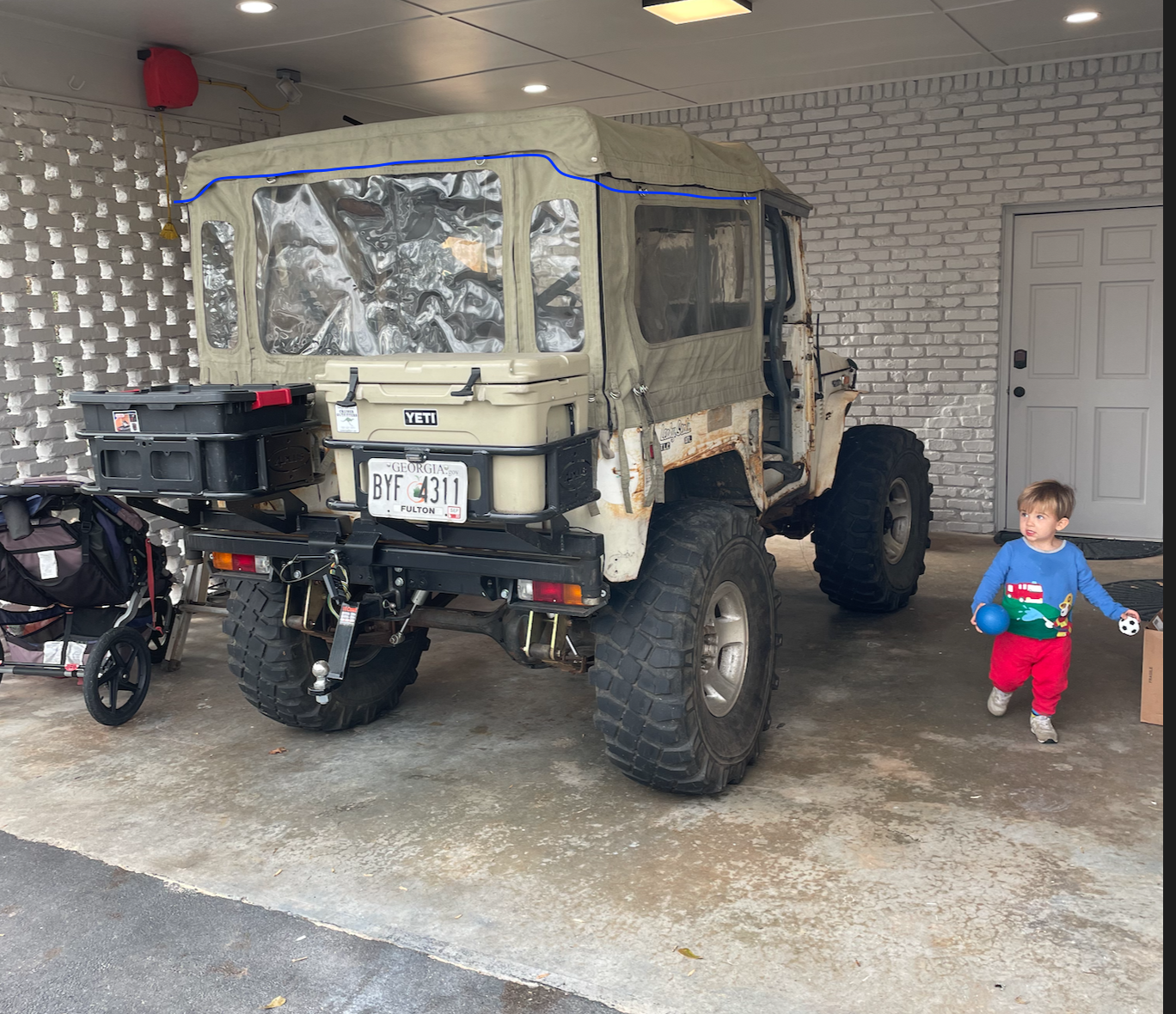

This top might be home made (this was right after I got it, has since smoothed out) but it has one feature I haven't seen elsewhere-
The top zips apart all the way around at the blue line which converts it to a "factory frame bikini top" which I love. Much better coverage than a standard bikini top on the roll cage.

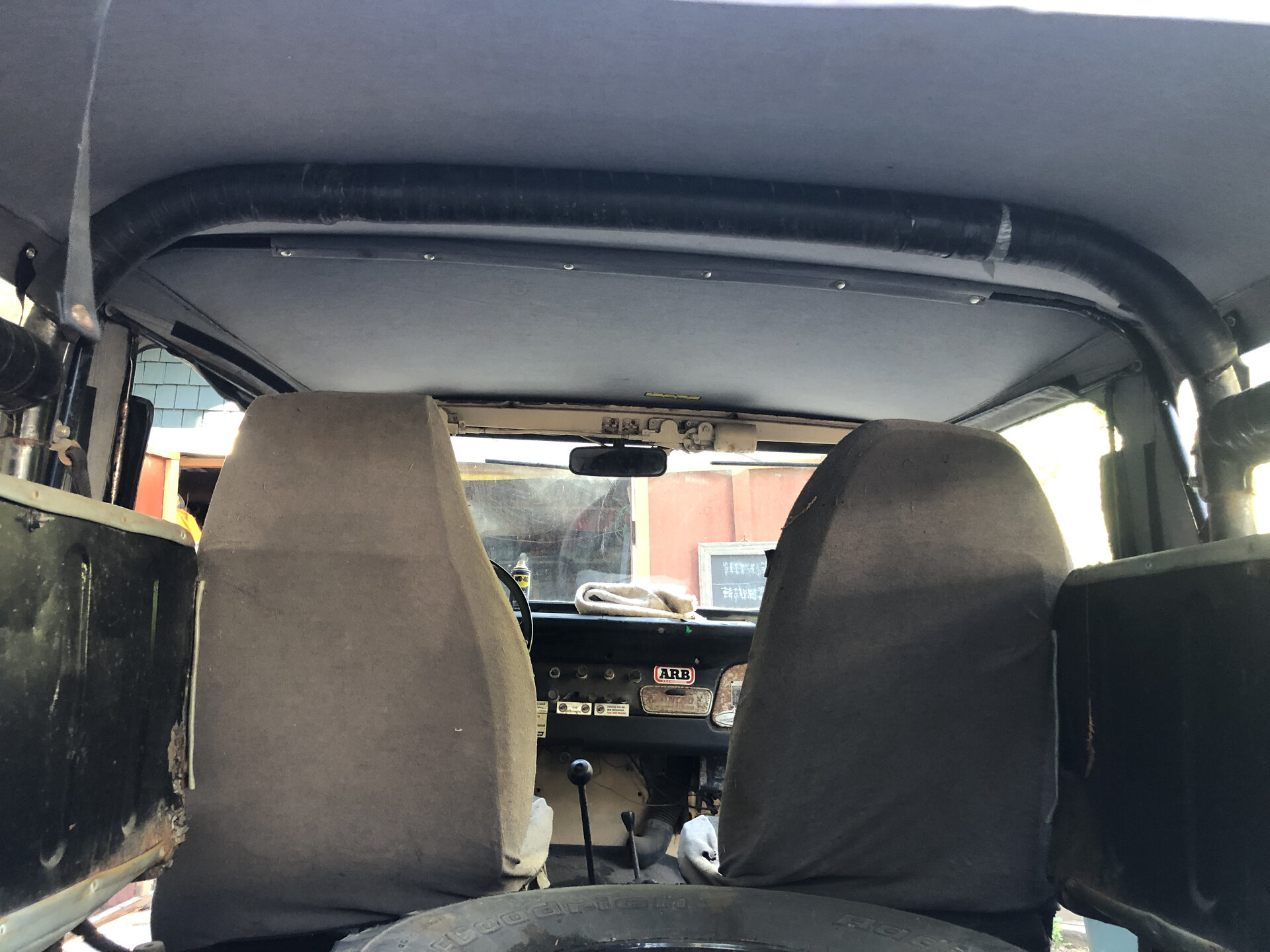

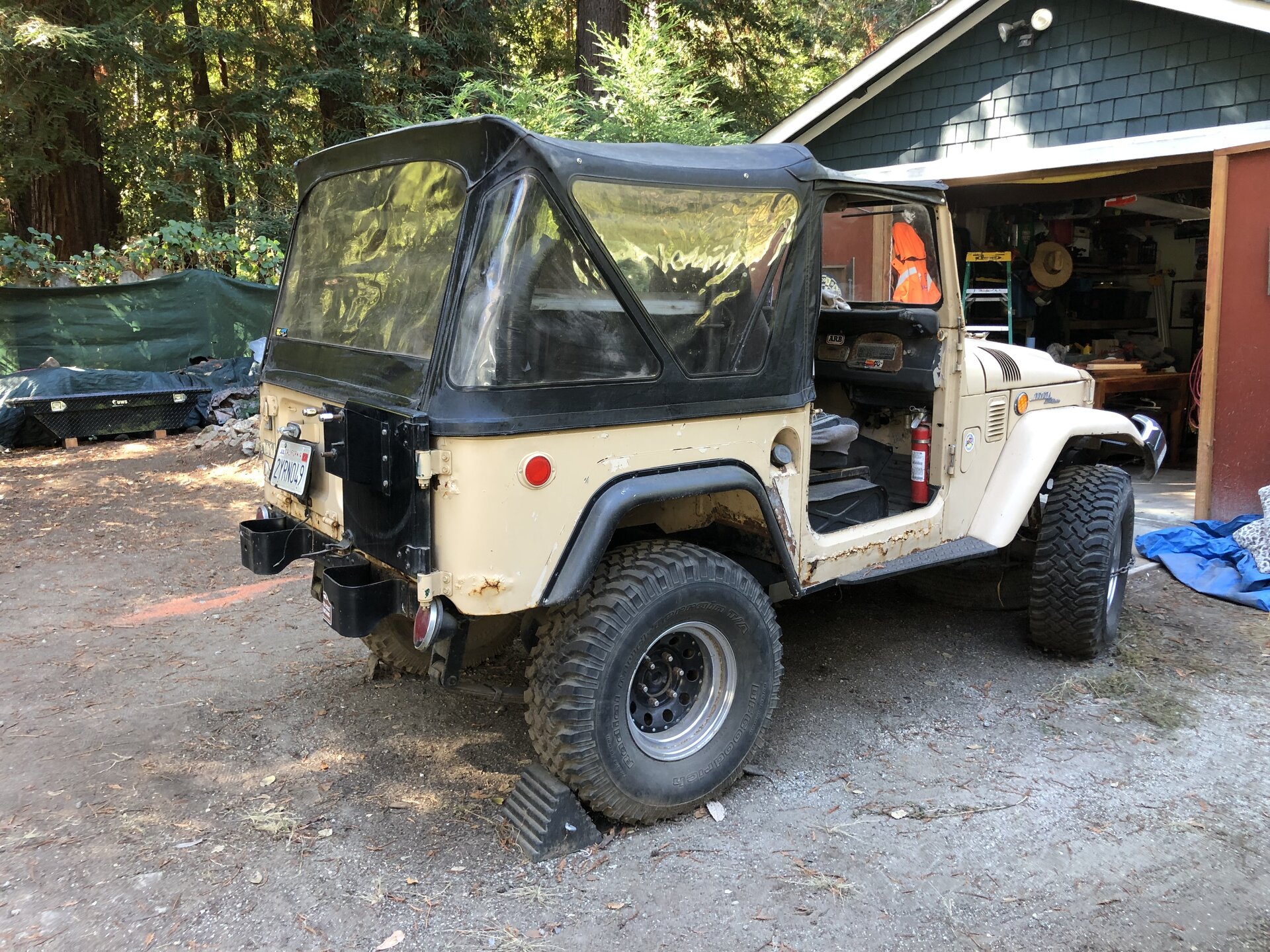

Got my soft top installed today! Been a long time since I’ve had it on. Pretty straight forward trying to remember the steps. I laid it out in the sun wile I screwed the frames on. Going to mess w the doors tomorrow.
Really need to get my 40 running again everything’s there but it’s been outside for a long time covered but rust monster is closing in! Be better once I can get it in the garage. Just trying to document if it helps anybody out.

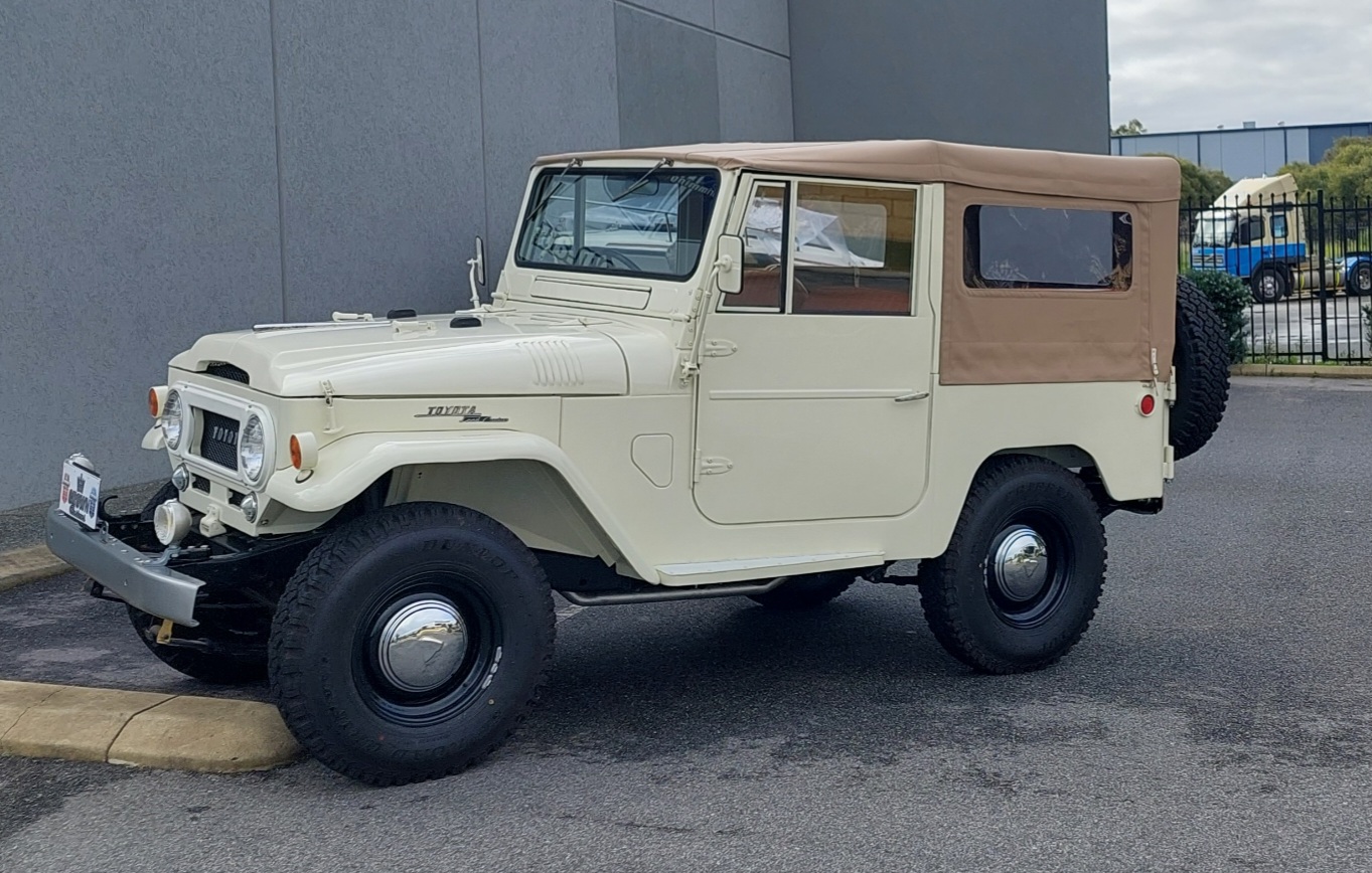

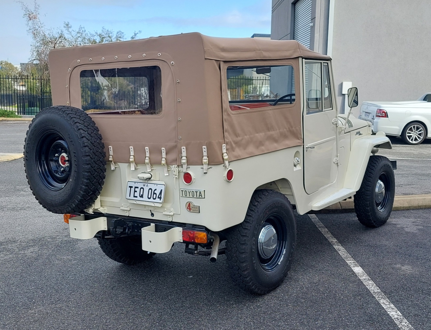

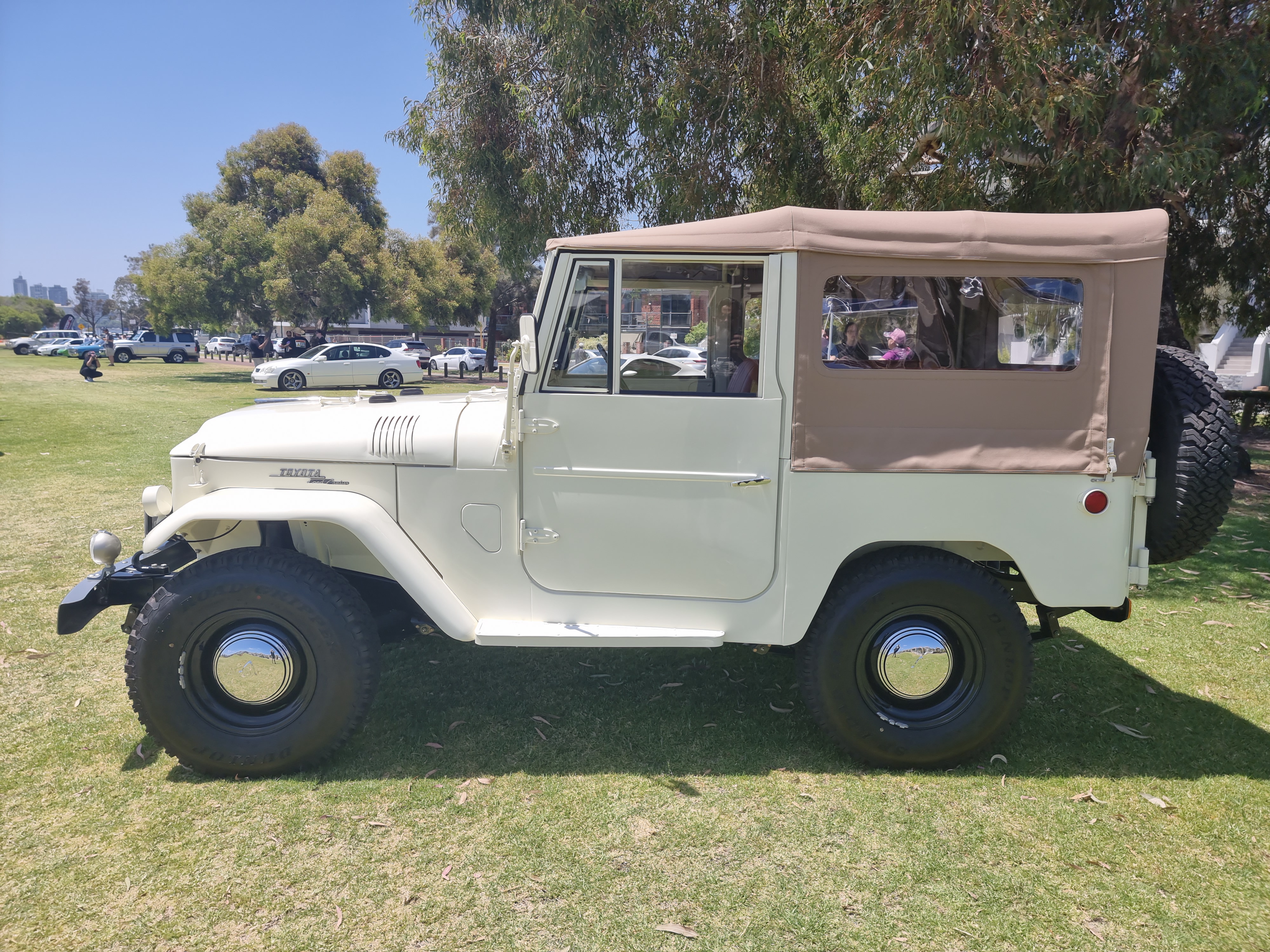

I was fortunate to have the original Top to use as a Template. Used it to copy stitching type, fittings placement, sizings and all fittings types. I managed to source a high resolution copy of the Makers Mark and had this etched on to the Vinyl ( Strataglass) Windows. Canvas is Haartz Stayfast. ( Tan / Tan)
That looks really nice! thanks for sharing.
