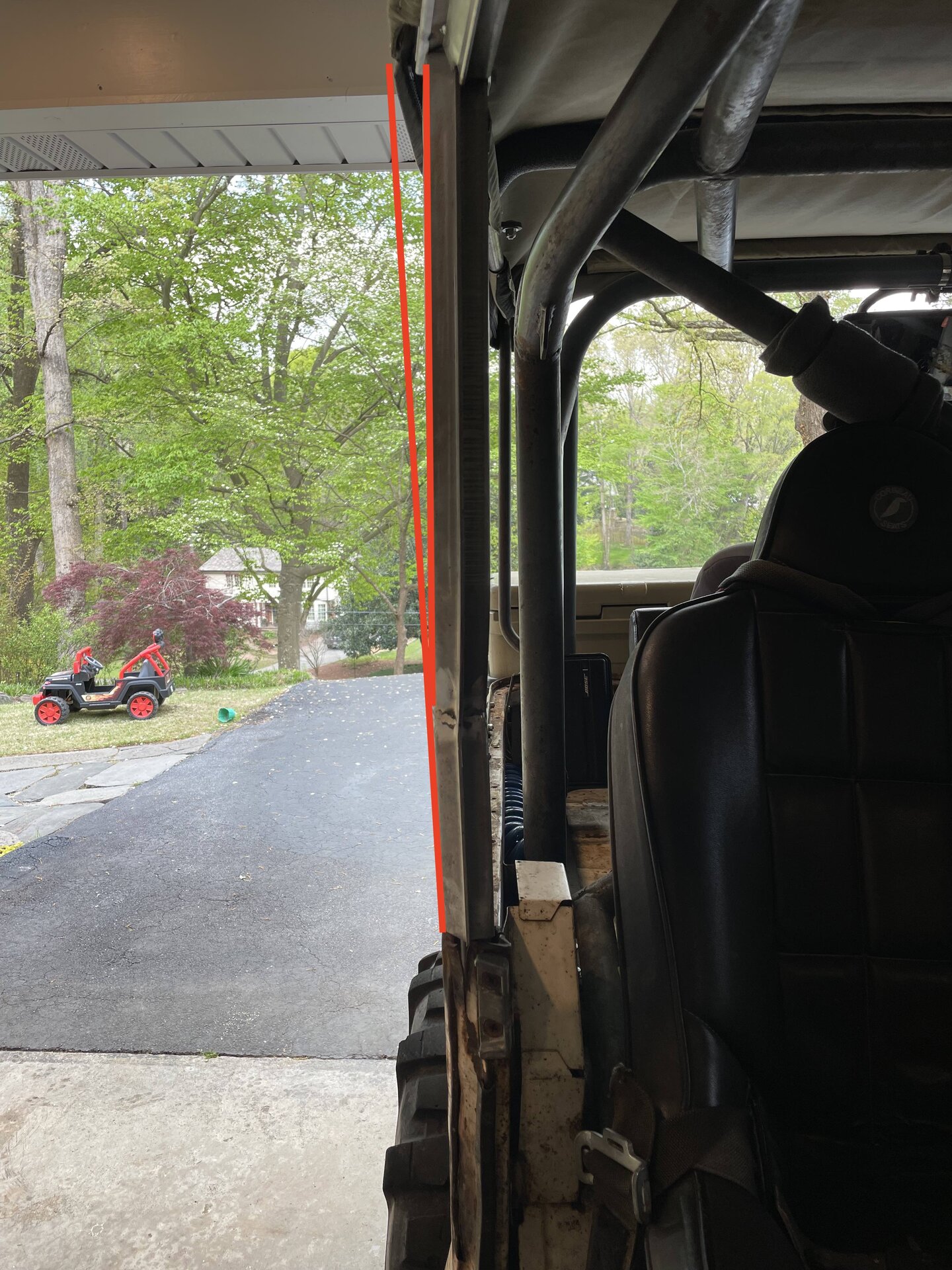

Sorry to breathe life into a thread a little over a month old. But what modification did you need to make to the Real Steel B pillar to make them work with your doors? I see in your signature you've got a '74 - - - which I do as well.....wondering what you had to do to get them to mate up?
Any pictures would be awesome - as I am going to be going through this process right now as well.
Thanks!

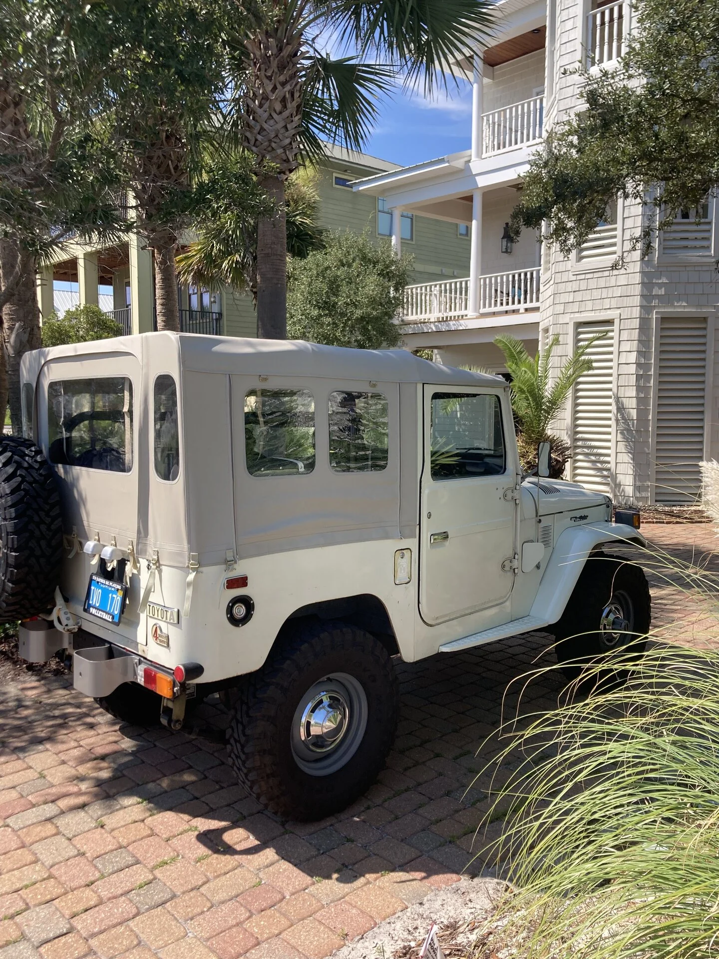

@231Designs There are a few threads on it, essentially need to bend the b pillar in to match up to the "hard top" doors and take out about 1.5" where the left and right side of the bows meet in middle (roof). Only FST doors are straight the whole way up and the real steel bows are made to match the FST bows. Kinda silly since 9.8/10 people that buy a real steel bow set having "hard top" doors.

Thanks for the information - I've been reading through a bunch of threads and honestly the more I read the more confused I was getting. There seemed to be some thought in the threads that 'early doors' vs. 'late doors' were the issue. But from what you're saying its FST doors vs. hard top doors.....and then likely compounded with early and late hard top doors.

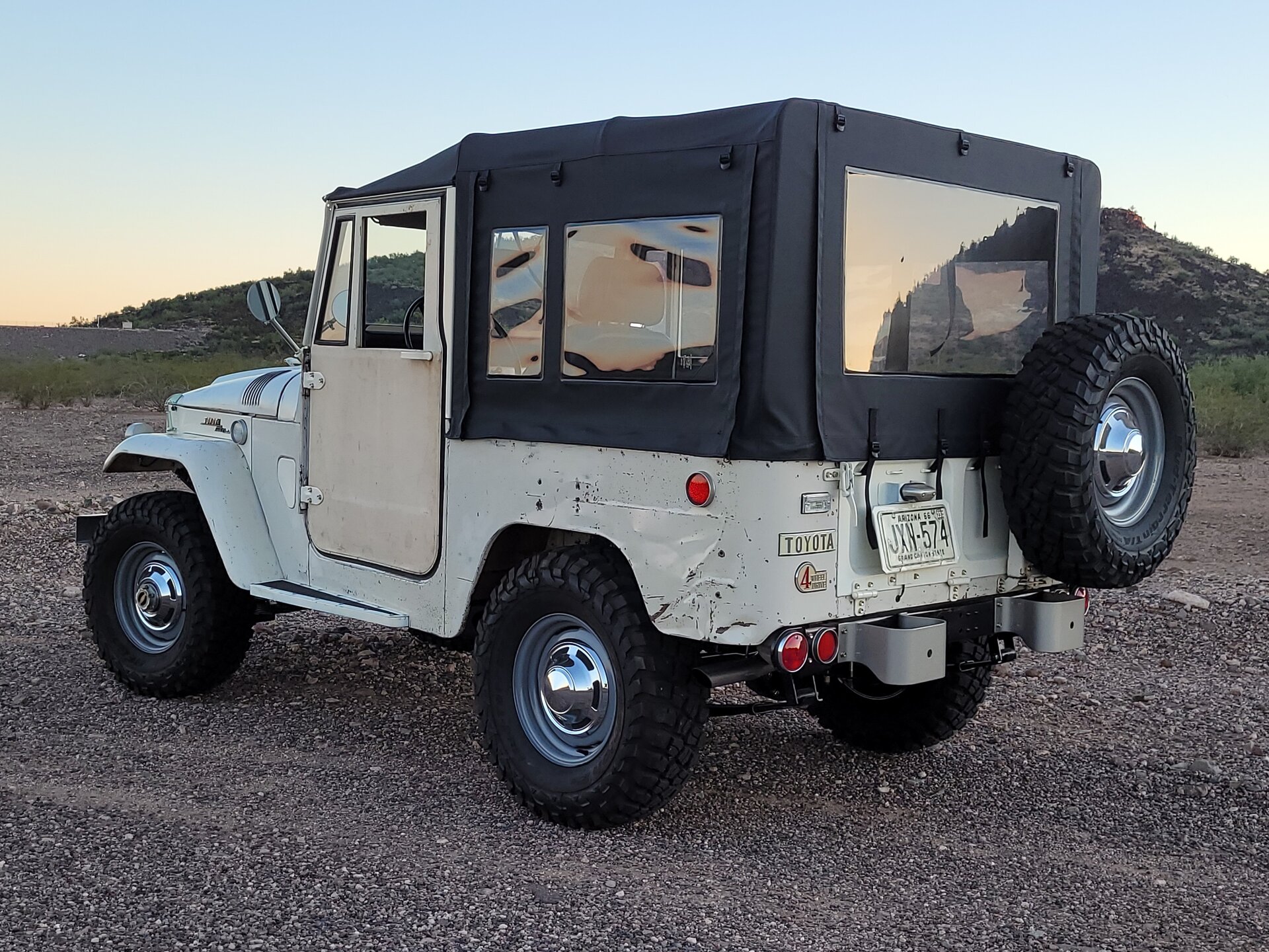

My hardtop doors appear to be 'straight' - - and are the pre-75 version.....but they're at the shop right now and I can't put a straight edge on them to confirm....and its highly likely that they have a few degree tilt to them....considering your picture looks an awful lot like my FJ40 ;-)
