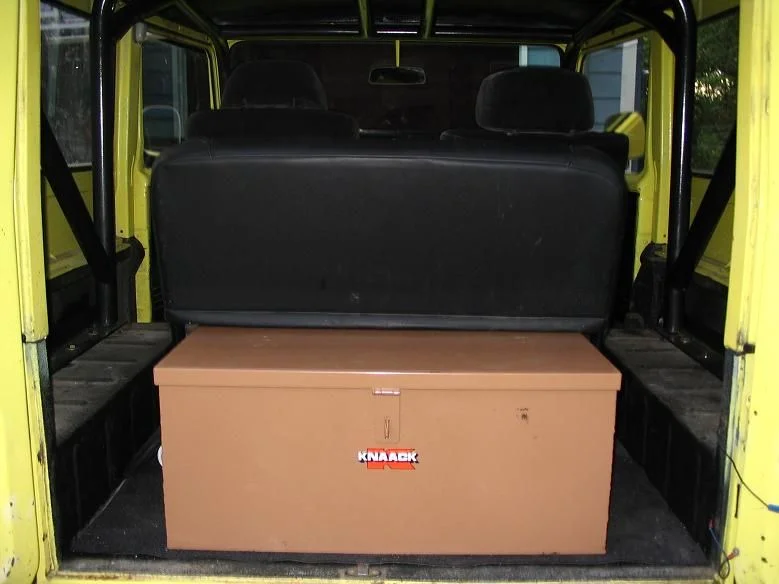

this is what i used, www.knaackbox.com they have different lenghts and hieghts but it was about $105.00 with tax. fairly thick steel will keep the ohnest people out and slow down others :D

I'm looking for lockable storage for the rear of my 40 that is ~7 inches tall by ~41 inches wide that extends from just inside the rear doors to near the body to frame bolts in the rear floor (6/77 FJ40). That would be floor to fender height. Planning on mounting my Geo Tracker/Zuki Samuri rear seat on top of said storage box. Cruiser only has a full length bikini top, so I'd prefer metal over wood if possible. I'm getting a Tuffy console for Christmas (luv my wife!), but Tuffy has nothing that is FJ40 specific for rear storage.

This is exactly what I am looking for. a box to go under a platform that will hold my geo rear seats. Anyone have pictures of the end result?

I've seen pictures of these tool boxes mounted to the wheel wells either on Mud or Expedition Portal, they appear to fit well, and I think would make decent arms rests, had there been a bench in the back.
