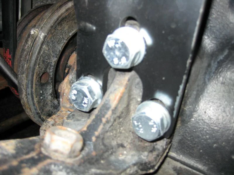

I had to grind the top right portion down because the exhaust manifold would not allow it to go down on the motor mount bolts. I mounted the adjusting arm on a bottom water house bolt instead of the water pump because the bolts are much easier to get to and adjust. Works like a champ
hmmm, the grinding has me puzzled. are you sure you slid the mounting bracket down far enough on the three engine mount bolts?
i like the adjuster arm idea. might have to do some more mock-up work when i have a minute. a modified adjuster arm would be required but that's not a big deal.
thanks a bunch!
georg
There is still some room on the slots of the bracket but it is as far down as it can go on the motor mount. Would have been easier to put it on a chop saw and cut the bottom down but i didn't think of that:bang::)
I see. Well that would certainly explain why it didn't fit..lol....i read through a bunch of post on this but didn't notice that. Maybe this will help others. The next time i do some work on it i"ll move it but it works great for now. Thanks for all your help

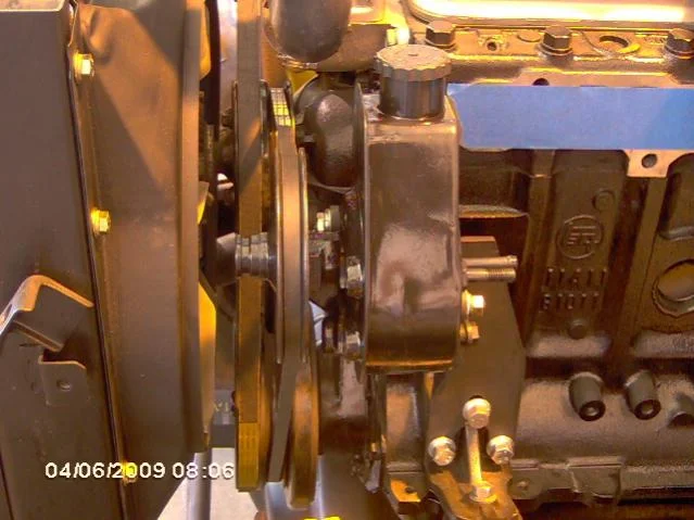

orangefj45,
Now I'm really confused. I went back and searched some threads and this picture was from one of your responses:
attachment.php
Just wondering if the bracket goes on the outside or the inside of the motor mount or is it different for various 40 years ? Or am I just being anal about this ? Thanks !
orangefj45,
attachment.php
haha, you caught me. realistically the ps bracket can be mounted on either side of the engine mount bracket. in the pic i posted, we had installed the ps for mock-up.
either way, i've never had to trim anything off the bracket to allow room to clear the exhaust. the ps bracket should be mounted as low as possible, that's why the three engine mount bolt holes are slotted.
hth
