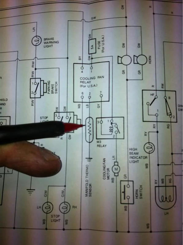

Which wire (if known) tells the motor to "NOT" turn on. I just realized there has to be something that tells it not to? I understand the circuit completes itself when the key is off..... But there has to be a wire involved in that switching process....??
It's a fairly complicated circuit. Don't try to simplify it in your head. One of the pins at the connector will be +12v when the ignition is on and one is +12v all the time through the fuse in the fuse holder. The other two connections are the sensor input and the +12v fan output.

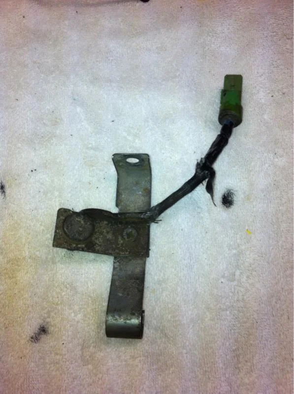

I remember seeing a post where the resistance cold is close to 25-30 Ohms but when heated the resistance drops to almost zero.
25k-35k ohms when cold is what I read. It's a thermistor if you want to google it.

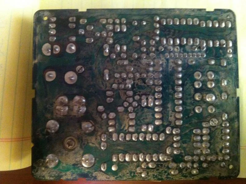

in pict 3 it looks like your electroltic cap has puked itself. If it has it will be at best weak if not open and will need replaced.Lastly in pict 4 - top right solder joint like it might a ring indicating a crack.
Good eye.
I saw the same "puking" except that it defies gravity?? The puke heads due west, so I considered that possibly a glue/adhesive. Do you know what that "thing" does??
If you know an electronics shop they could remove the cap and test it. If it 'popped', it could easily defy gravity, and they are known to pop. It's a $0.05 part if it's bad and it would be labeled with it's capacitance value. A cap can be thought of as a little rechargeable battery.
Is it ok to gently clean with simple green and a gentle toothbrush?? Or even a solvent like rubbing alcohol?? What would you suggest?
Rubbing alcohol and a toothbrush would be safe. A wire brush could damage traces if you weren't very careful.

That thing is an electroltic capacitor. All capacitors are like batteries, store and give up electricity. I know from doing my 79's, the circuit will work if the capacitor is weak but would guess it won't if it is open. It looks like from your picture it has puked and is common as they have a limited number of cycles (charge/discharge).
I'm not familiar with "simply green" and would want something more aggressive than a toothbrush. I like to use a fine brass brush to loosen the corrosion,then blow off with compressed air.
Capacitors are cheap and easy to replace and I can give more detail if needed.

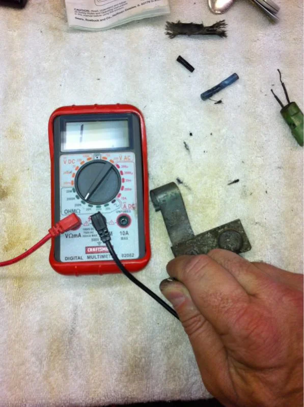

Broke out the wiring diagram this afternoon
Wire colors match the book to what I think is my sensor
Tried to get a resistance reading at the terminal connector for the wiring harness, infinite, this isnt good. Pulled the old casing off the wires and snipped off some old connectors to get to bare wire.
Same issue on the bare wire, no ohm reading at all so something must be open in the circuit that i cant see, so I know it's not an old wiring connection. Popping her in the oven on 200 F to see if I can get a reading hot. May be heading to radio shack or the used parts bins if this doesn't work.

Ok 10 minutes in the iron skillet and viola, got an initial reading of 6.4 and watched it drop to 5.9 over a minute so I'm going to clean the connections and try again to get a reading at the connection to the wiring harness.

Spent another couple hours today on it. It has to be (for me) either a bad sensor. Started the truck did a temp reading all around the Sensor at +200 or more. So I did the heat test. Still no luck :(. For me, it has to be in the circuit board.
I was told that if that round 16V black thing had puked it would have spilled oil and have a busted seal around it. Is it either of the two square "coiled" boxes that open/close control the kick on/off.

DO not I repeat do not clean the circuit board with anything but "MAYBE" water.
It is my guess that there is a clear coat already on there..... it has mad mine look like it is very dirty. No longer visible to the naked eye are clear clean lines. It was mentioned that the corrosion look around the edges is the clear coat from the factory getting old. Mine is now hardly visible... will edit with pic if you want to see the outcome.... :((
I don't think it is damaged, but it is not easily visible anymore.... I used rubbing alcohol (as recommended) and a sponge bob tooth brush... NOT happy with the outcome....

Spent the day checking resistors and continuity on the board itself..... All seems good. Then I realized… the wiring schematic in Haynes and on here has 5 legs. My board has 7?
Is this board in combination with something else??

Here is a pic of my diagram from a 77 FSM but the top of the page says 79. Go figure. I never got to mine this weekend.

Yes same diagram I have.... But if you look back at my board (post 134) it should have 7 legs?? Shouldn't it??

Edit: when I look at the 79 it has an "M3" relay. The 80 has a "cooling fan" relay.… makes me wonder if the 5/78 doesn't have them integrated on one circuit board?
Sent from my iPhone using IH8MUD
That is the same one I have for a 79. My 78 shows no M3 relay.
