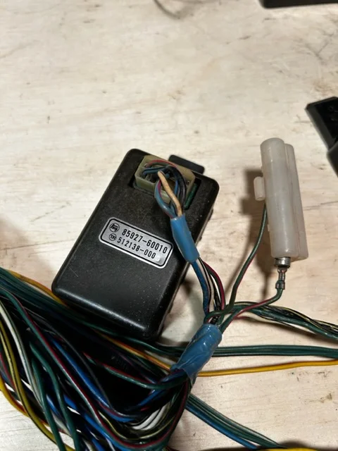

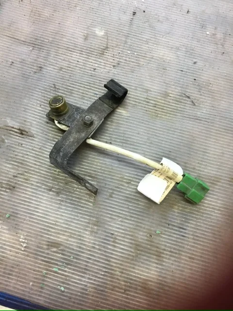

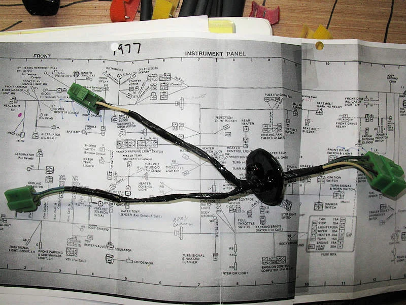

I’ve read through this entire thread and have not found the specs for an aftermarket thermo switch that will work with the 1976 &1977 California Spec carb cooling fan relay 85927-60010. The CA spec relay and switch is different than later models. The later models are a resistance sensor vs. snap switch. Below is an image of the OEM switch with two wires LB and GR from harness out to the sub harness then out to switch.

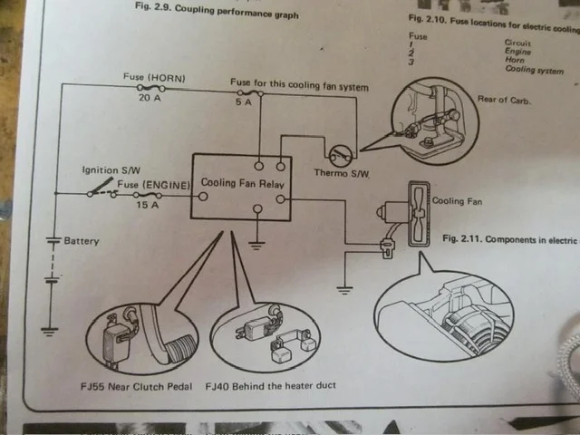

As shown in the below diagram, there is a thermo “snap switch” that closes the switch to send 12v to the relay. The relay then sends 12v to the carb fan and the timer runs for approx 20 minutes only when the ignition is off.

I am looking for the temperature spec for the switch to close the circuit. I estimate it to be 170+ degrees ON (closed) so it will not run in winter.
If anyone has a good source for an automotive snap switch that will work please post it.
Are you looking for documented numbers or tested numbers. I used a heat gun and a laser thermometer gun to verify and test mine. If I recall it was around 200f when my fan kicked on. Certainly not precise but I could do the test again with my FLIR camera. Its definitely high though. Since I switched to a Fed spec manifold my fan never kicked on.
Are you looking for documented numbers or tested numbers. I used a heat gun and a laser thermometer gun to verify and test mine. If I recall it was around 200f when my fan kicked on. Certainly not precise but I could do the test again with my FLIR camera. It’s definitely high though. Since I switched to a Fed spec manifold my fan never kicked on.
Thanks..I think documented numbers are good enough and can work from the information just posted by Engineer8000. What I’m really looking for is an aftermarket thermo snap switch that will work with the fan controller relay I have.
Thanks. Found some others overseas that I will test with variable temp for the exact OEM specs for temp On/off with either a normally open state or closed. I’ll post once tested to confirm application.
@Engineer8000 when you looked at the fan relay controller, do you know what voltage it needs to see when ignition is off to open the circuit for the cooling fan to shut it off? In my testing environment, with key ON the ignition black wire has 12.6 volts. Does it need to be over 12.6v when running (charging) to open the cooling fan circuit?
When I test the controller hooked up to my CA spec harness, the cooling fan will run even when ignition is ON. It should not run when ignition is ON. It does shut off on its own in approx 18 min when IGN is OFF. So, timer function works.
I have the thermo switch hooked up to a simple On/Off toggle switch.
I would have to test an early controller like yours to be sure but I can say on the later boxes, the ignition voltage has to dip below about 1.1 volts to reset the timer. I will check it out.
I seem to remember mine not requiring the ignition to be off for the fan to kick on. I'll see if I can verify that today.
Just checked the schematic and bench tested to confirm (85927-60010). The fan will cycle with the thermo disc switch any time the ignition is on, and for about 18 minutes after the ignition is turned off. The only function the IGN input has is to charge up the capacitor for the timer circuit that begins to count down after the IGN is turned off. As long as the IGN is hot, the timer cap stays charged and the fan runs with the temp sw. The internal relay drops out when the voltage on the GR wire falls below about 4.5 V and picks back up at about 7.5 V.
This is awesome information and very much appreciated. Thanks for taking the time to connect it up to get the information…Given that the cooling fan will stay on as long as the snap switch closes the circuit at temp, it’s important the switch has the right temp rating. I purchased a 170, 180 and 185 degree ON snap switch and will test all and report back for which one works best.

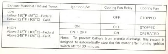

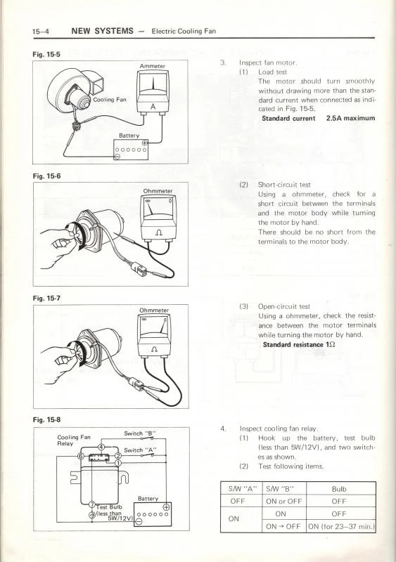

There's not much, but here's what I could find in the owners manual and the Emission Control CA Supplement.
I looked in the Chassis and Body FSM under body-electrical, but didn't find anything.
Hope this helps.
