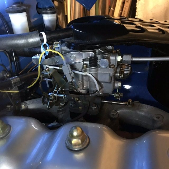

Maybe I can help a little Mark. I’ve got a CA spec ‘76 and battled this myself. Pretty sure that the 2 wire connector on that harness plugs directly into the carb fan temp switch pic below.
For the 3 wire connector: 2 wires run to two temp units under the air rail and the third looks like it connects to the fuel cut solenoid on the carb. That was purely from my own research and had to make that harness myself without example. I’ve passed smog twice but would welcome any correction. Will happily buy a 3 wire harness from you when we figure it out.

For the 2 wire connector, it’s easier than that Mark. The carb fan temp switch simply plugs into the 2 wire firewall connector on the main sub-harness of your pic.
The only thing you need to build is the 3 wire sub.
