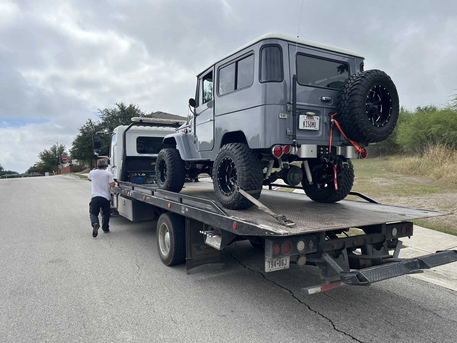

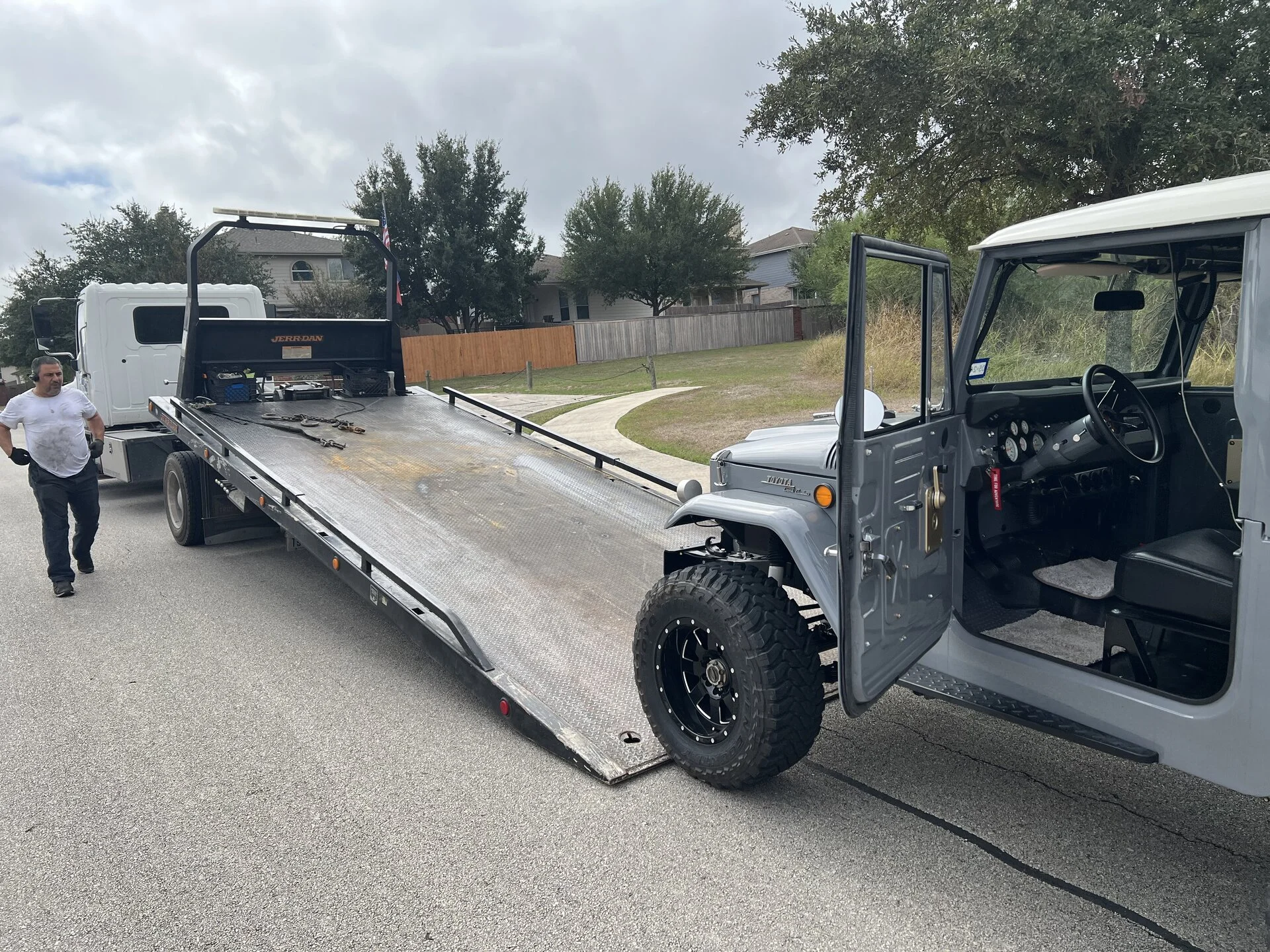

It definitely sounds like a loose nut resulting in a wobble sound. I’ll double check everything suggested before I pull the whole thing. It’s sad because I just got it on the road after an 8 year frame of restoration. Got about 500 miles on it then this. Oh well….Back to the wrenching.
