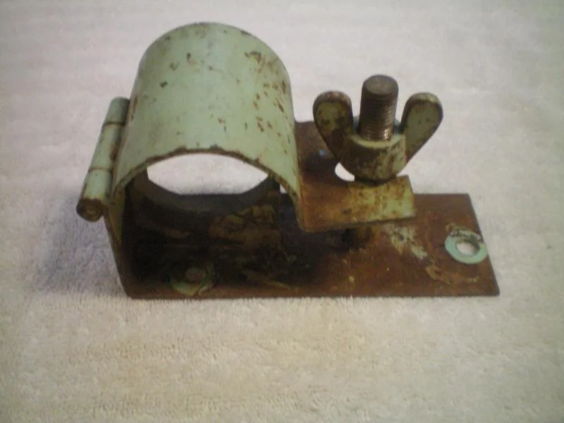

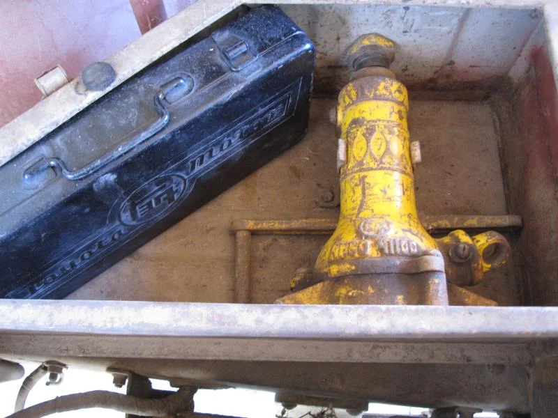

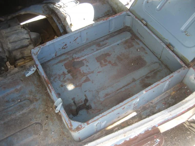

FJ25 and FJ40 through 9/72. The jack is located in the under seat tool box, held by this clamp, part number 58031-60010, CARRIER SUB-ASSY, JACK. Originally body color (FJ25 and early FJ40 with angled tool box) or black (later FJ40). (landcruiserparts)
25-jpg.1013389
1959 FJ25 - tall tool box. (67azcruizr)
25-1959-jpg.1013388

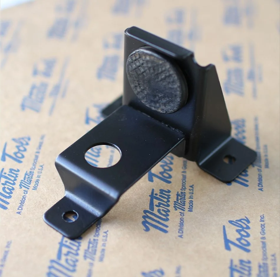

FJ40 from 9/72 through 1/79. The jack is located under the left front seat, held by this bracket, part number 58803-90300, CARRIER SUB-ASSY, JACK. Originally black.
The bracket includes a rubber bumper on the vertical side. The hole on the horizontal side is to accommodate the neck screw on the jack. (fj40toolbox)

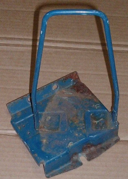

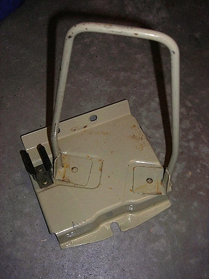

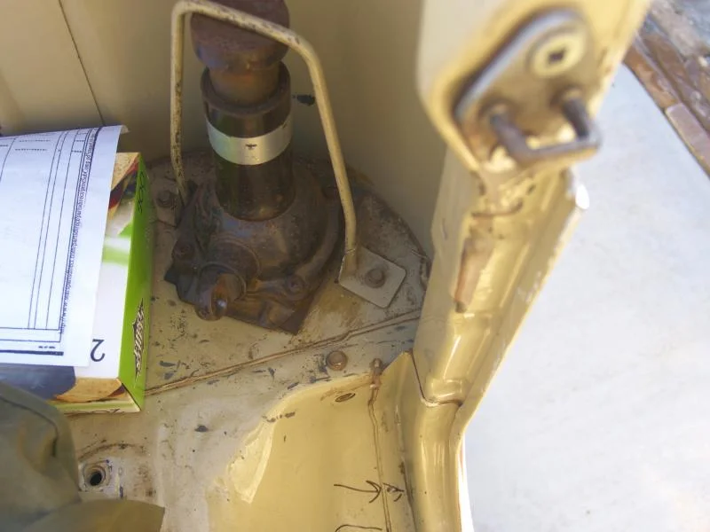

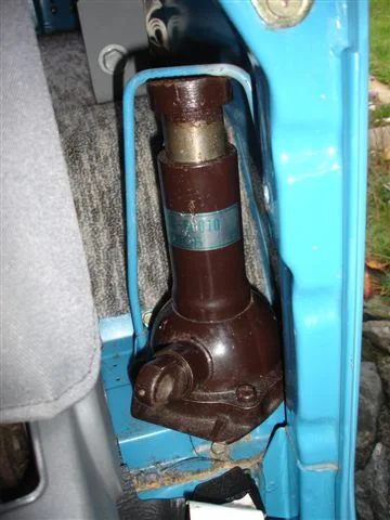

FJ40 from 1/79 on. As part of the 1979 body changes the jack was relocated behind the left front seat and held using this bracket, part number 75202-90300, REST SUB-ASSY, JACK. Originally body color. (shmukster)
40-b-jpg.1013401
Raise the jack until the top of the wire loop fits securely into the groove in the jack cap. (lostmarbles)
40-1981-jpg.1013403

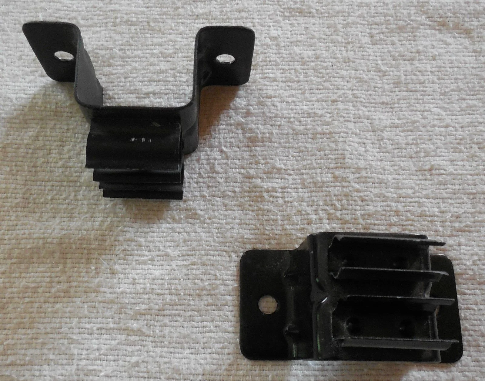

FJ45 jack bracket. The clamp is designed to fit jacks with a narrow neck flange. The jack should be clamped just below the neck flange. (DomSmith)
45-clamp-jpg.1013395

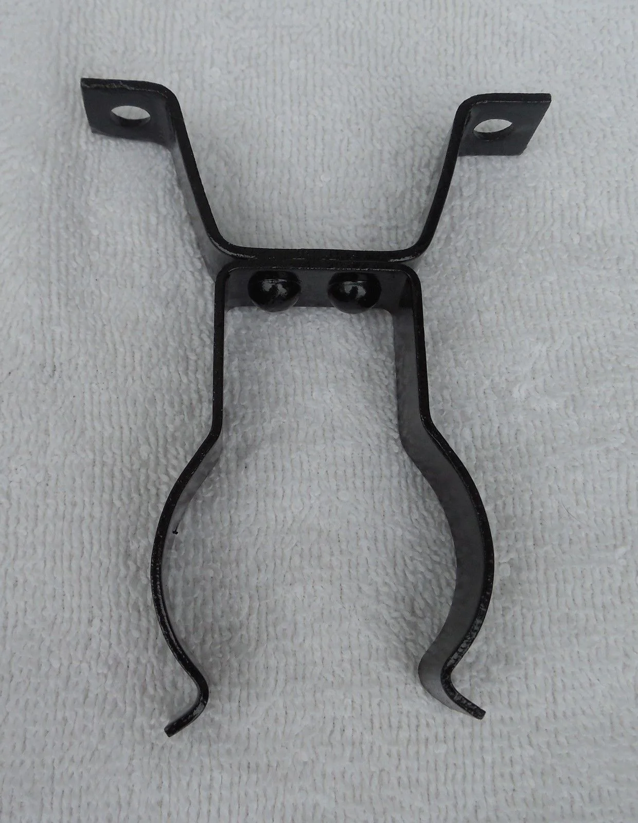

FJ55 jack bracket. The clamp is contoured to fit the neck of the jack. (nuclearlemon)
55-clamp-jpg.1013390

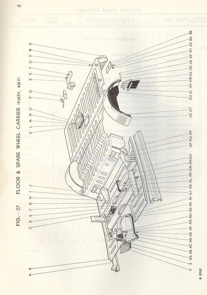

FJ45 pickup from 1/79 on. The jack was relocated behind the left seat and held using this bracket, part number 75202-90301, REST SUB-ASSY, JACK. Originally body color. (watuwantproducts)

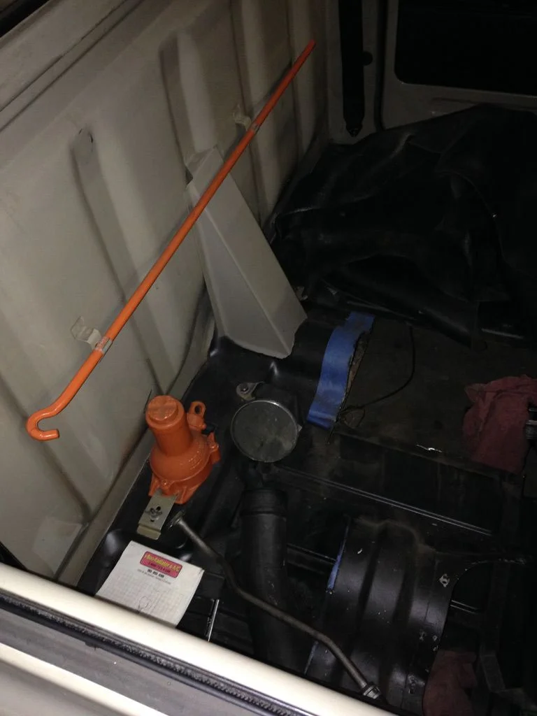

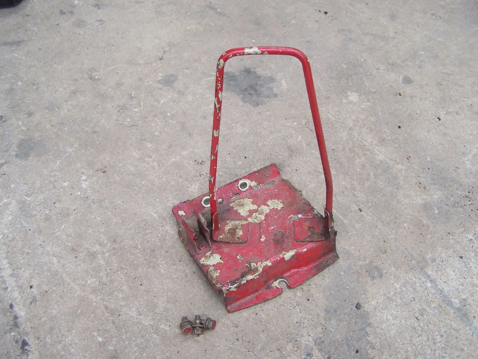

HA! :) I need to get the FJ45 jack holder out of the trash then. I have stared at that thing for years and finally decided it wasn't Cruiser related.

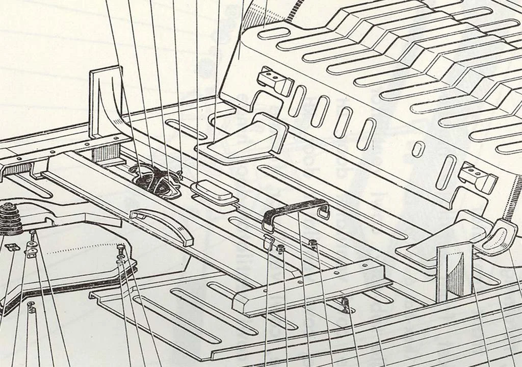

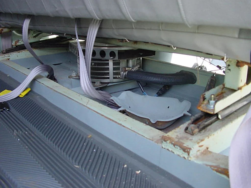

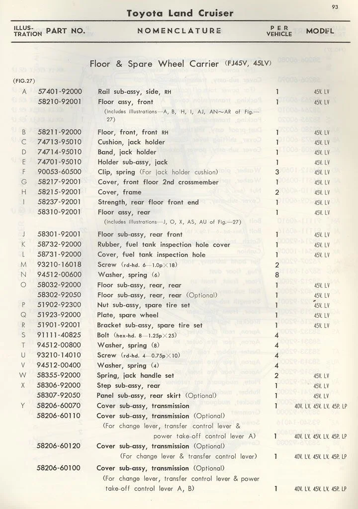

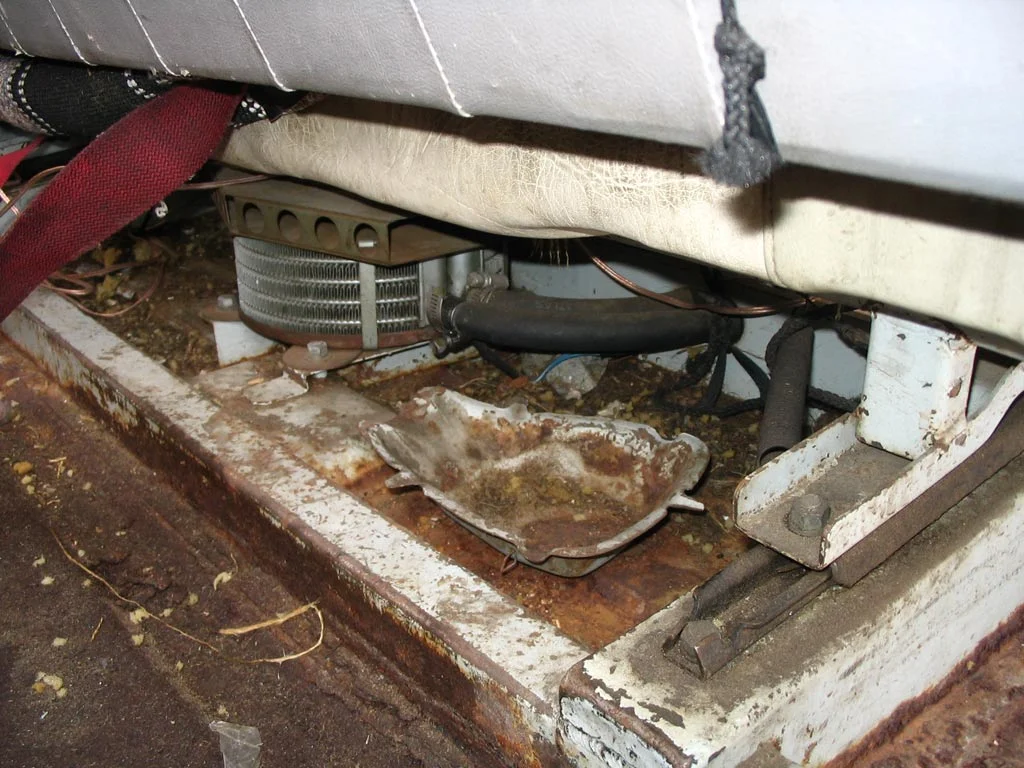

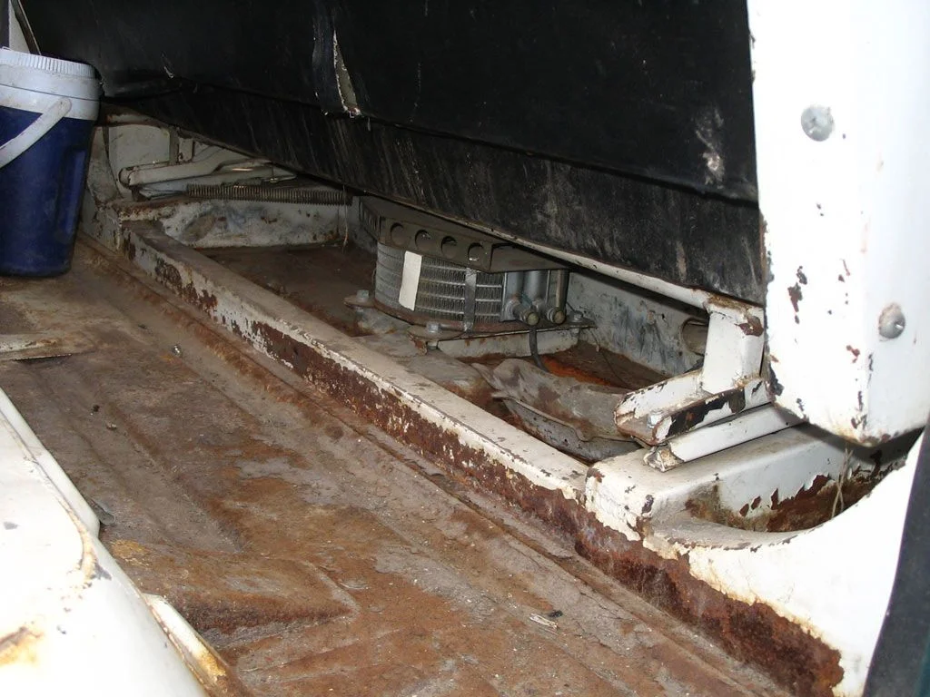

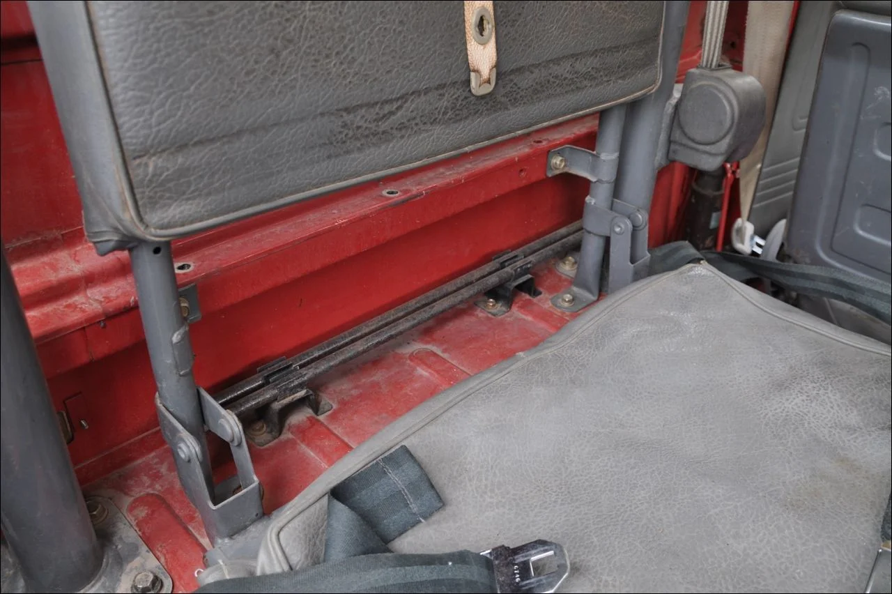

Here is the jack holder under the front seat of an FJ45LV (FJ45V)

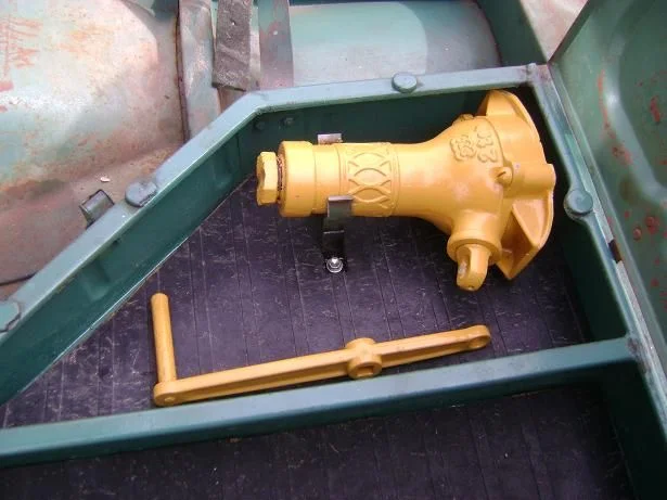

I'll have to see if I can get a picture of the rubber mat that goes in the tray. I think my 1964 still has the mat installed. I would guess an o-ring wraps around the three tabs to hold it in place. Let me look through my literature to see if I can find a factory photo...

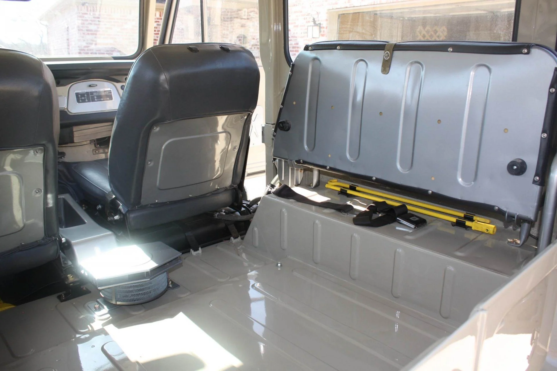

Some more data that suggests the 35040 jacks were painted a darker orange (and an excellent pic showing the mount). These are some pics Daniel sent me from a 1971 Stout.

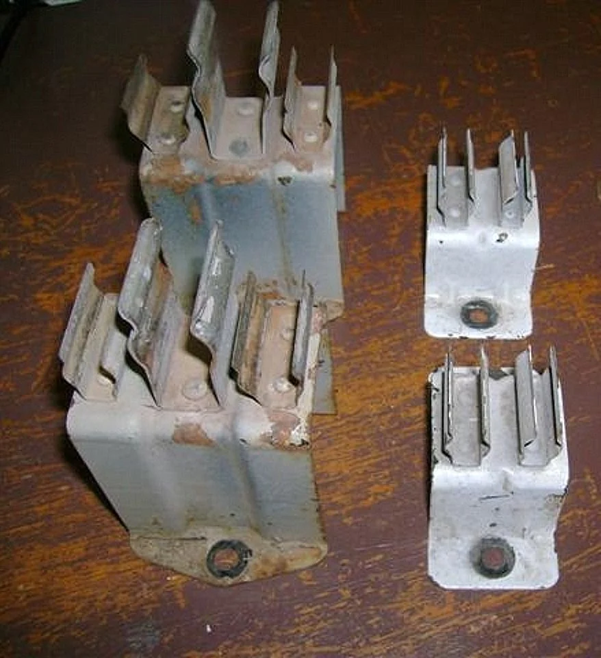

The parts catalog identifies 7 clips, part number BJ 63115, CLAMP, JACK HANDLE. Four of these clips are for the jack rods and the remaining 3 clips are for the starting handle (discussed below). Originally body color. Each clip has 2 offset holes. Located on the right rear wheel well on vehicles with jump seats, on the left rear wheel well on vehicles with the rear bench seat. (treerootCO)

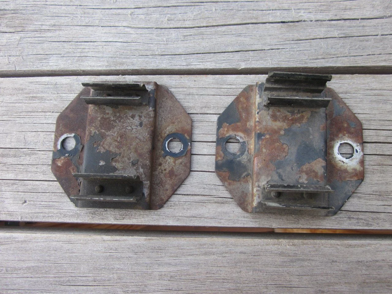

FJ40
Through 6/69 - 4 clips, part number 58363-60010, BASE SUB-ASSY, JACK HANDLE CLAMP. Originally body color. Each clip has 2 offset holes. (algeeba)
58-69-profile-l-jpg.1015763

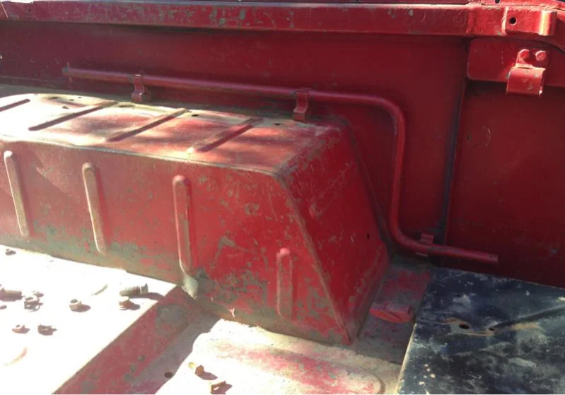

9/73-9/81 - 2 clips, part number 58305-90301, BASE SUB-ASSY, JACK HANDLE CLAMP. Originally black.
73-81-jpg.1014886
Located on right rear wheel well through 12/78. (LandCruiserNation)
fj40-78-jpg.1014885
Moved to the left side starting 1/79. (LandCruiserNation)
fj40-79-jpg.1014884

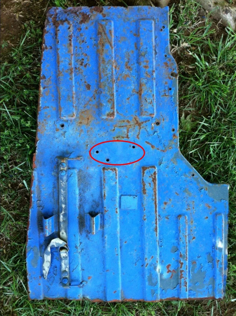

For markets where the starting handle was not provided, the starting handle clips are not installed, the small cross-head mounting screws are used to fill the holes. (Landwrecker)

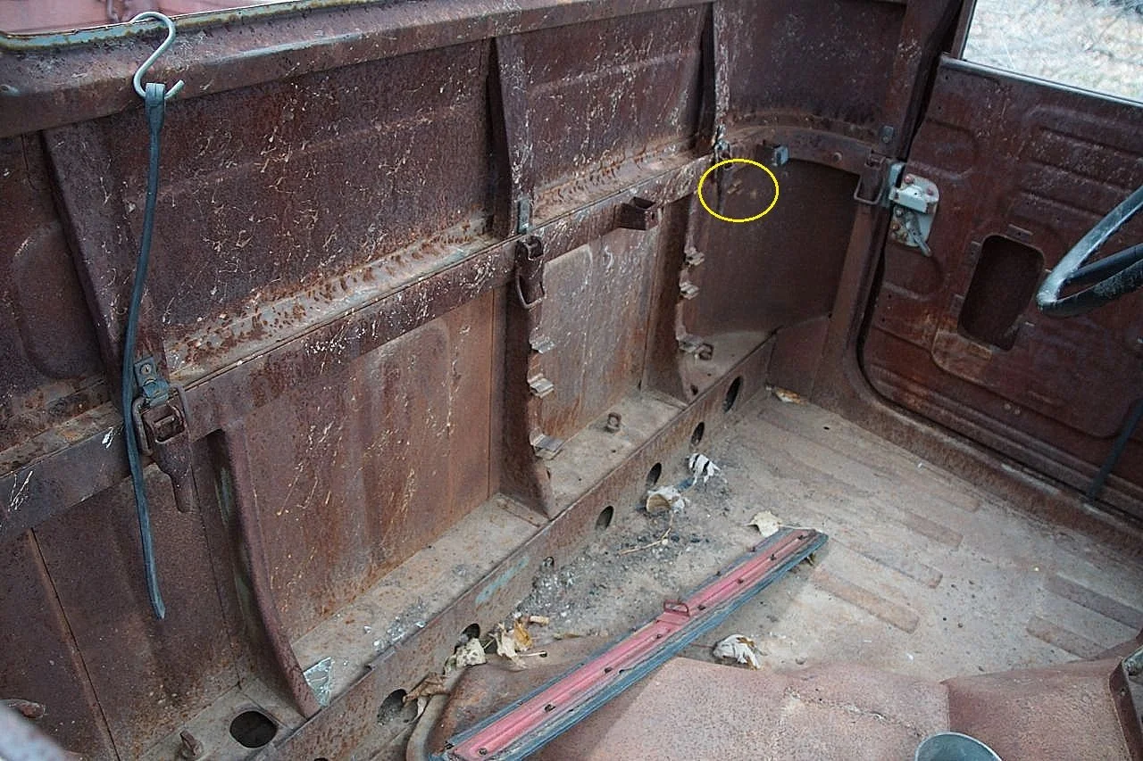

FJ45 Pickup

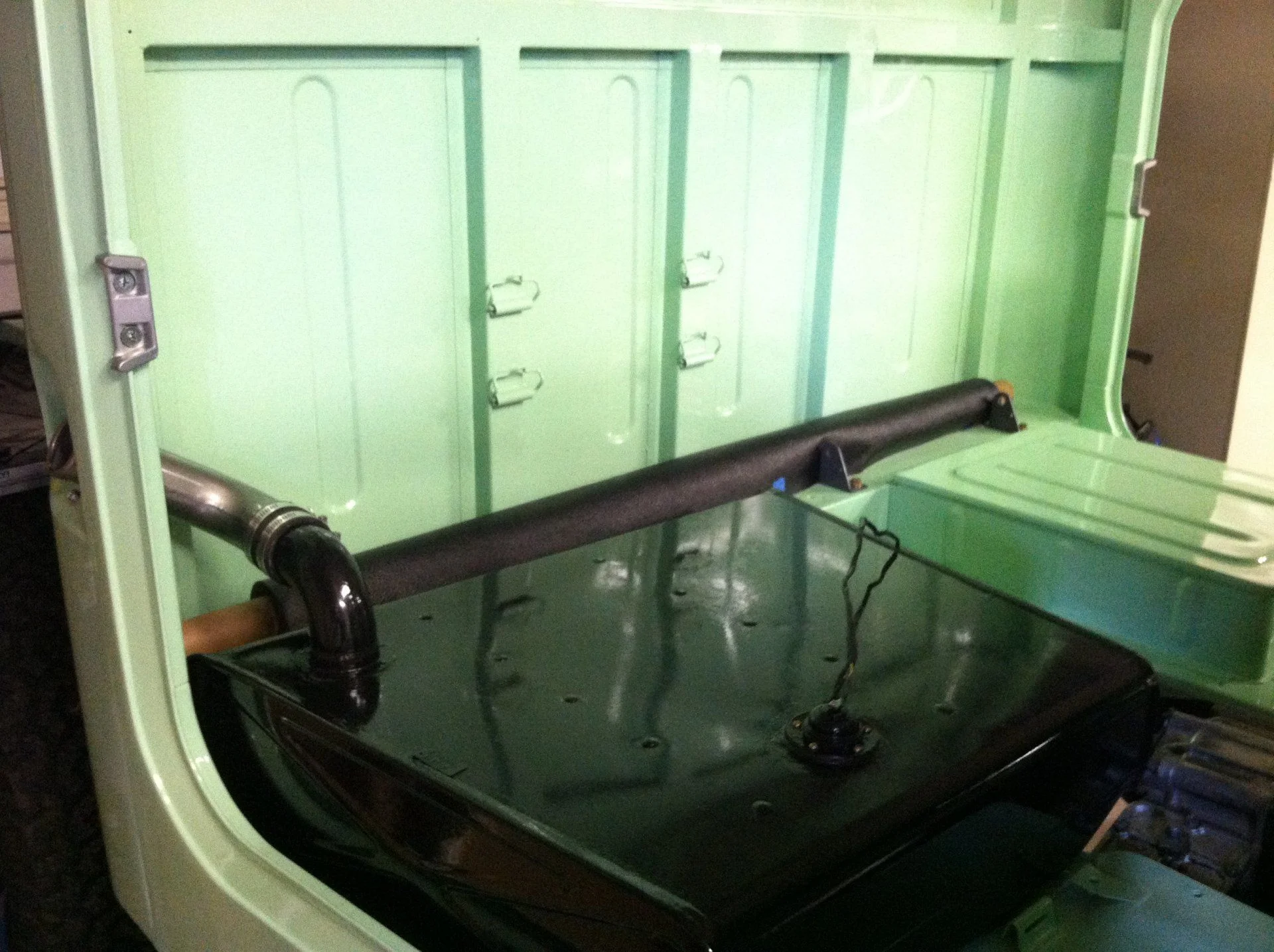

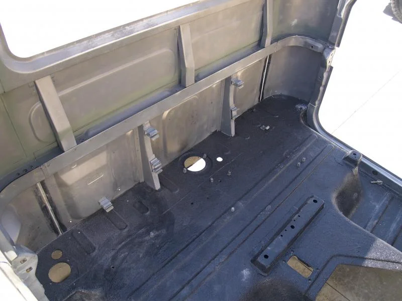

FJ45 jack rods and starting handle are stored on the cab wall behind the seats. Each jack rod is held by 2 clips, the starting handle by 3.
Early FJ45s use a wire clip, part number 58848-90202, SPRING, JACK HANDLE SHAFT CLAMP. Originally unpainted wire, the clip housing is painted the body color. This 1963 FJ45 has a pair of clips for the jack rods only. (jschmi71)
fj45-63-jpg.1014874
Spring steel clips were used starting in 1964, part number 74741-95110, SPRING, STARTING HANDLE SUPPORT. For this 1965 FJ45, the jack rods are stored in the 2 upper pair of clips. The starting handle uses the bottom clips, the 3rd clip for the starting handle is to the right and up, near the 3rd latch. (motortribe)
fj45-65-jpg.1014873
This 1978 FJ45 uses a different clip arrangement. The starting handle uses the topmost pair of clips with the jack rod clips underneath. The 3rd starting handle clip is to the right and down, closer to the floor.
fj45-78-jpg.1015766
This 1982 FJ45 uses different jack rod clips and a slightly different clip arrangement. The starting handle clips are still on top, but the 3rd clip for the starting handle is to the left and down. The jack rod clips now attach to a common base. (love2fly)
fj45-82-jpg.1014871

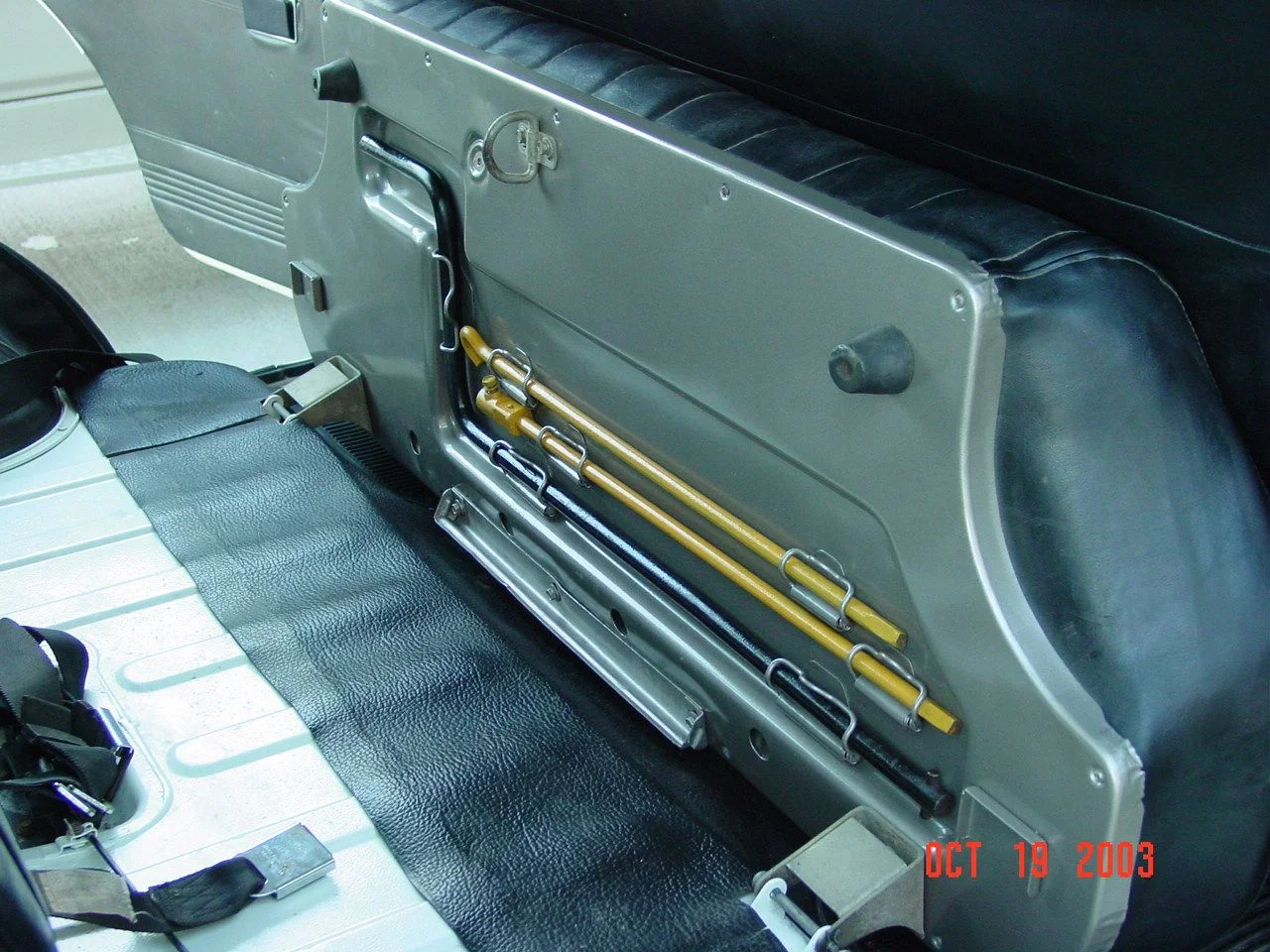

FJ55
The FJ55 jack rods and the starting handle/spare tire carrier tool are stored on the underside of the rear seat. Each jack rod is held by 2 wire clips, the starting handle by 3. Originally unpainted wire, the clip housing is painted the panel color. (LandCruiserNation)
fj55-76-jpg.1014869

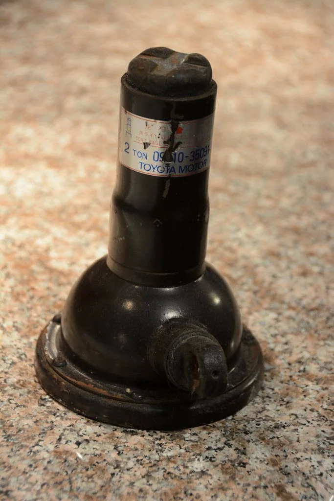

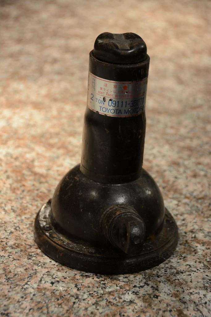

09111-35071
08/1983-02/1989 TOYOTA 4RUNNER TRUCK RN5*,6*,7*,VZN6*,LN5*,6
09110-35091
08/1978-06/1983 TOYOTA PICKUP RN3*,4*,LN40
09111-60050
08/1987-12/1989 TOYOTA LAND CRUISER FJ62
09111-60060
01/1990-12/1997 TOYOTA LAND CRUISER FJ80,FZJ80
09111-35140
11/1995-07/2002 TOYOTA 4RUNNER RZN18*,VZN18*
09111-60084
01/1998-07/2007 LEXUS LX470 UZJ100
09111-89101
08/1988-10/1995 TOYOTA 4RUNNER TRUCK RN10*,110,13*,VZN10*,110,13*
08/1988-11/2004 TOYOTA HILUX LN200,RN8*,90,125,RZN200,YN8*,9*,LN8*,90
08/1988-10/1995 TOYOTA 4RUNNER TRUCK RN8*,90,12*,VZN85,9*,VZN120
02/1992-12/1994 TOYOTA 4RUNNER TRUCK RN101,110,VZN100,110
09111-35110
08/1983-02/1989 TOYOTA 4RUNNER TRUCK RN5*,6*,7*,VZN6*,LN5*,6*
09111-89103

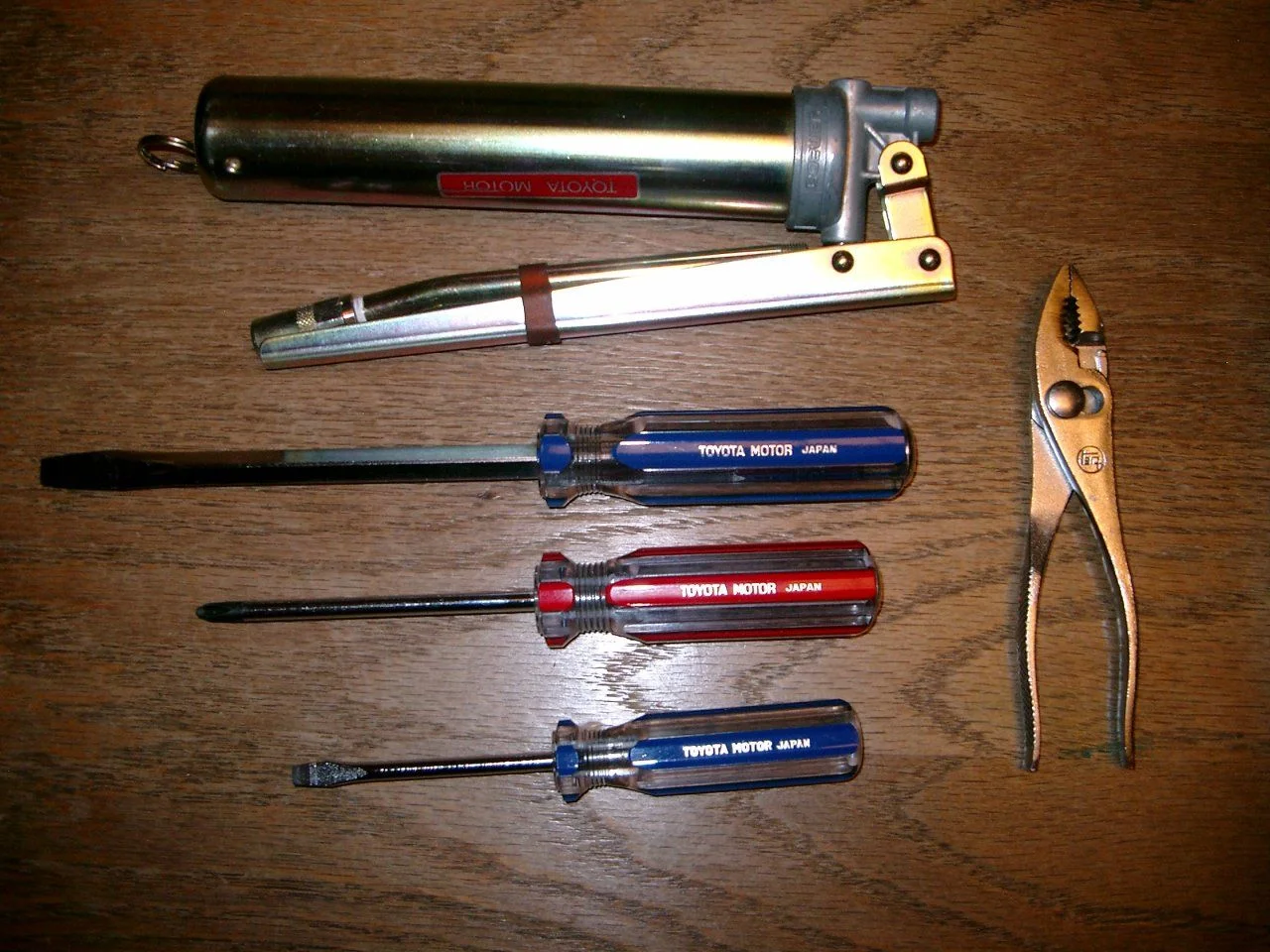

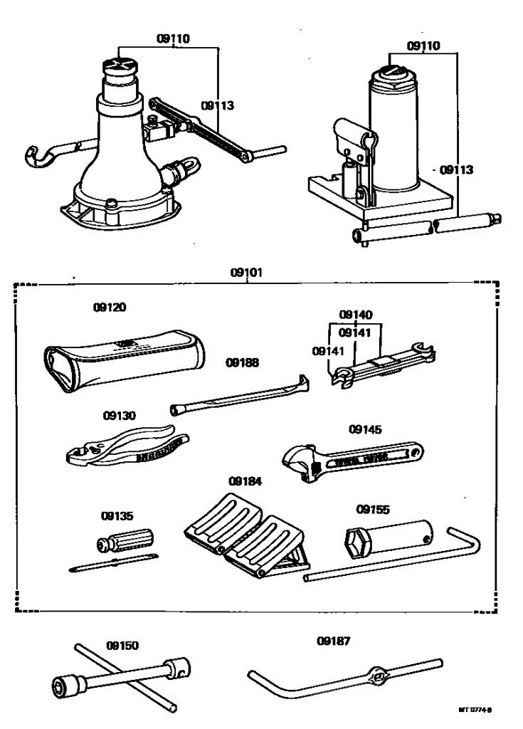

Not exactly jacks but here is an 09120-55010 box that I bought new in 1979 and some interesting cool tools.

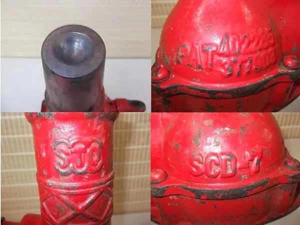

13010 outsourced to Tsuten instead of STO

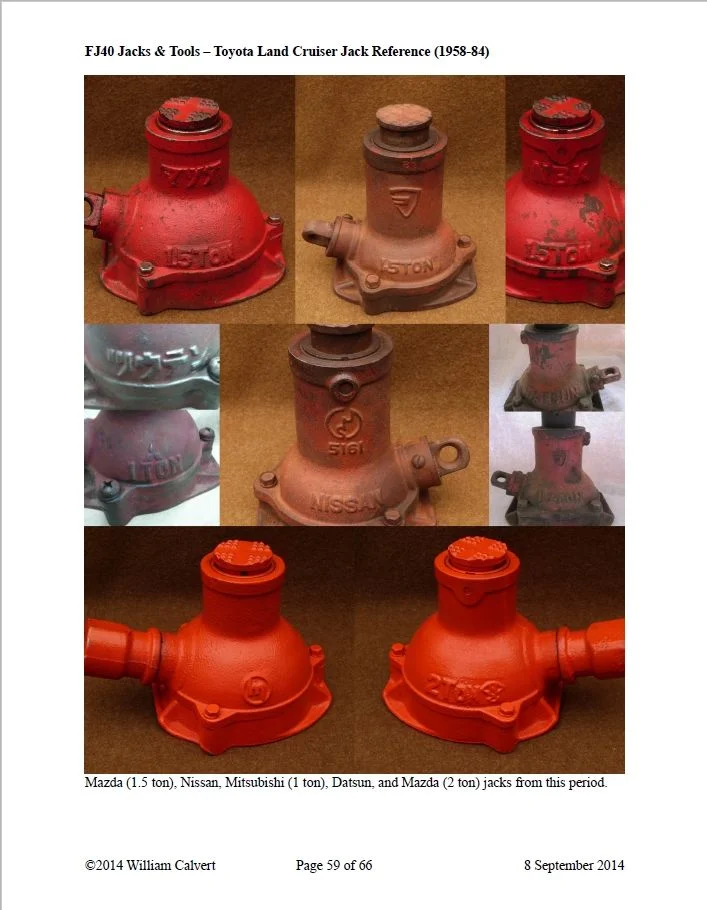

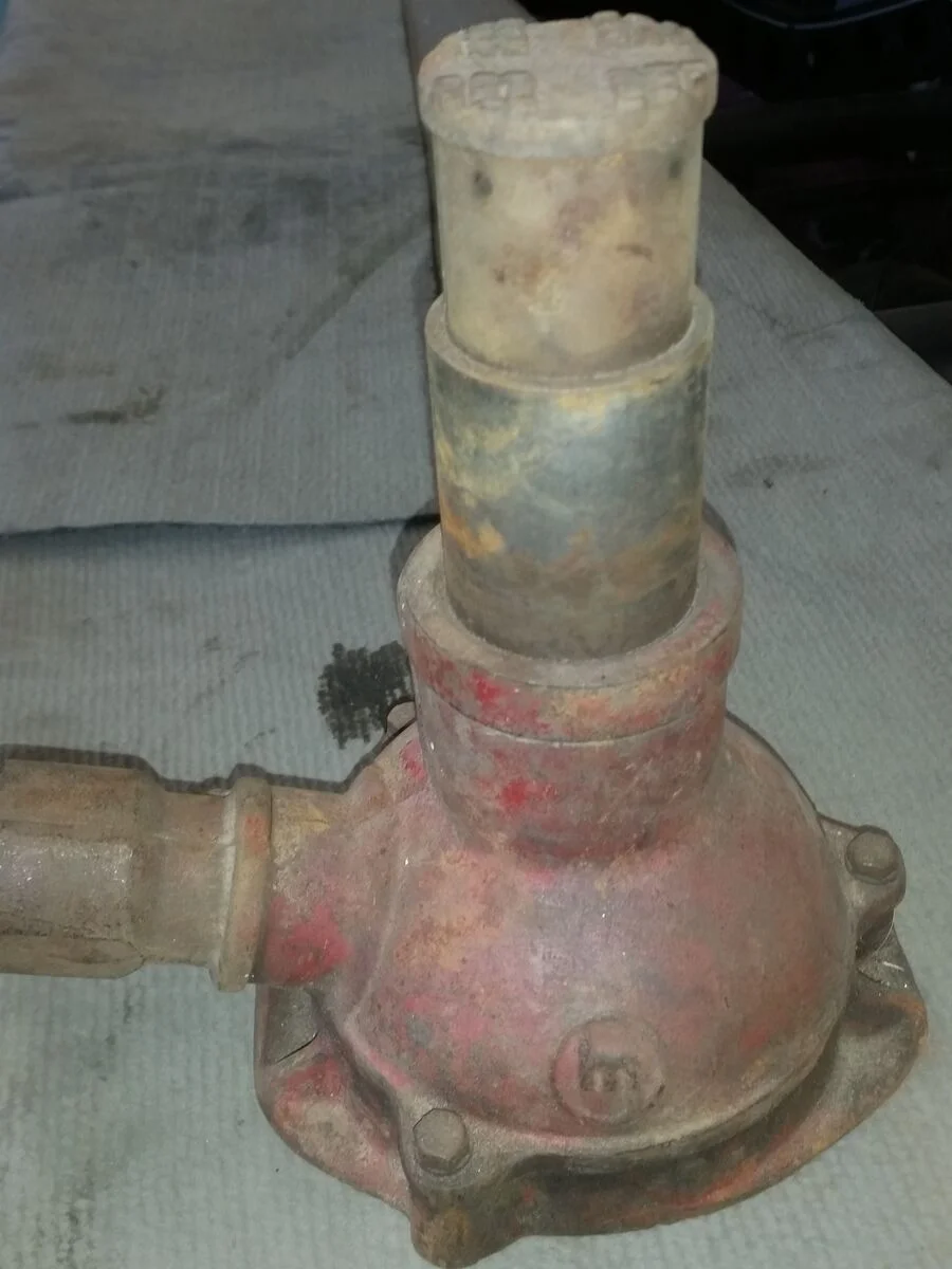

That is a Mazda jack, the lowercase "m" logo was used between 1962-75. The symbol to the right of "2 ton" is the NBK manufacturer's logo. Looks like the original red paint.
Discussed in the jack reference:
Pictured in the bottom row.

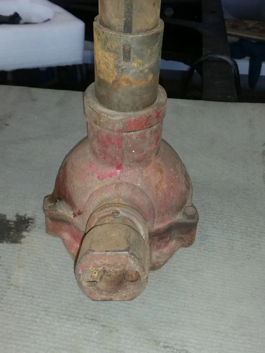

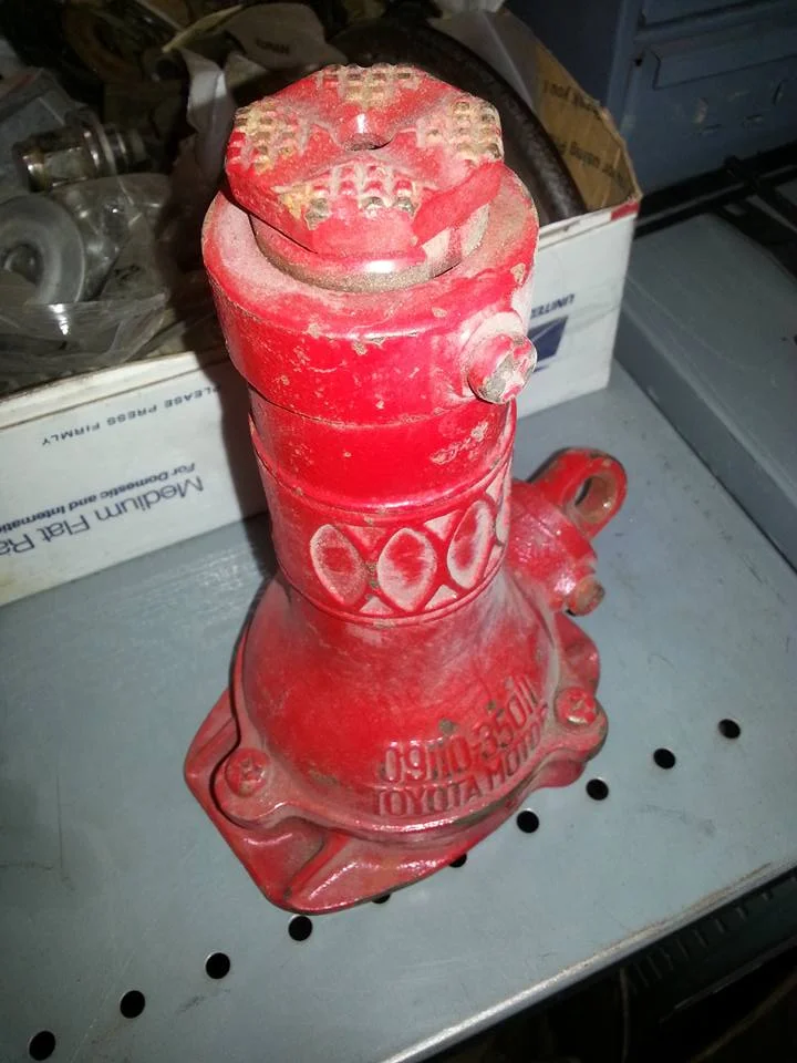

@cruiseroutfit found this jack that appears to be red with no trace of yellow. @pardion thought maybe the Toyota firetrucks came with them painted this color. @owensexport has imported a few firetrucks over the years and hasn't seen a red one. @AutoCraft Aus said they may have come in a few leaf sprung vehicles but those may not have been Toyota. Figured I would throw this out there and see if we can find another red one out there.
