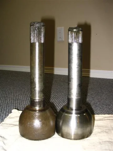

Just an FYI for the melon the older fj40 birfs are smaller as well. I had to clearance my housing to be able to slide a fj60 birf into it. I think the fj60 birf was the same as a mintruck birf but someone will have to confirm that. Not a big deal just an fyi as I guy tries to dig up spares. The older fj40 birfs obviously would surely work as a spare but you wouldnt want to pay top dollar for them and you can not visually tell the difference

Since Pappy confirmed the FJ60 birfs are the same as the minitruck then yes sir the early fj40 birfs are slightly smaller than the minitruck birfs but will work. Again it isnt a huge difference but it does exist
So the early 75-79 FJ40 Birfs will fit, but are smaller?
As I recall there is another issue with them. I seem to recall the stub is either longer or shorter.
I know the fj60 work perfectly in an early fj40 so pappy I am guessing that if the fj60 and the minis are the same which I thought they were and you confirmed we should be good to go. But I dont like guessing either. Maybe your thinking of the axles. As they are definately different. I was able to save the short side of the fj60 axle for my fj40 but the long side is longer as the axle is obviously wider. Something of the sort may apply to the minis but the outers or in this case birfs should be fine other than the strength difference

75-79 birfs are oddballs that have a longer stub.
I knew with it being two against one I had to have forgotten a step. You guys are right. I stole this info off of some of my saved data from the FJ40 forum
You can put the later birf (the shorter 79'+ birf) in the earlier axles that have the "long" hub, the birf will not come through the hub body enough to use the snap ring, so you can run a fender washer and bolt (with loctite) in the end of the birf to keep it from walking inward, of course a martack would do about the same thing.
But, you cannot put the 76'-79' birf in a later axle using the "short" hub as it will protrude too much...
Hope that is clear?
So in conclusion the older fj40 birfs are weaker and longer. It looks and sounds as though they could be modified to work as a spare to get you off the trail but I have not confirmed.
