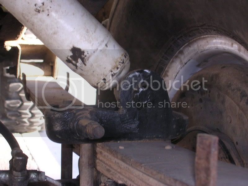

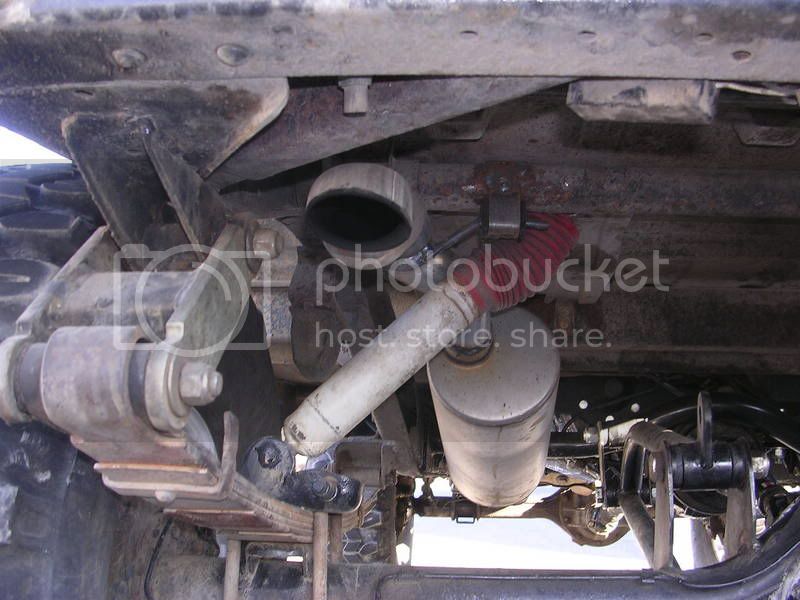

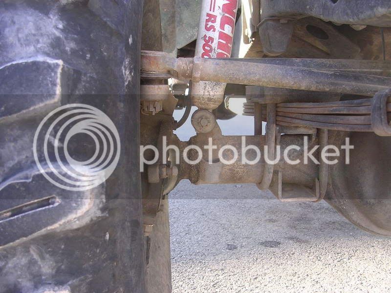

Hey Keith, here is a picture of what I was trying to explaine the other night. This is my rear axel shock mount.
The shocks using the stock rear uppper mount and the modified bottom mount.
The stock FJ40 front axel shock bottom mount tab locaion.
Hope this helps.
I dont like those rear shock angles at all, but I am no expert? And the distance just looks really short?

I was worried about the angle too. A guy who specilizes in offroad suspensions suggested I run with them "as is" to see how they work.
They seem to be doing okay so far.

Thanks for the pics Dan,
The rear you were explaining, was the one I was having a hard time understanding...That helps a great deal!
I was reading a post in the search threads, and someone mentioned, that as long as you have 4-5 in. exposed on the shaft at ride height, you should be good to go...Your set up i the rear looks like it fits that bill...and you cant much argue with the pic posted!
