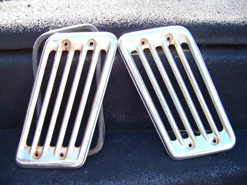

Found some vents on eBay that appear to have come off a FJ-55 (the seller was non specific, only stating they were from the early 70's).
I had been looking for some Land Rover vents, but the price was right on these and they had a buy it now option. Plus the whole Land Cruiser vs Land Rover argument. Sold.

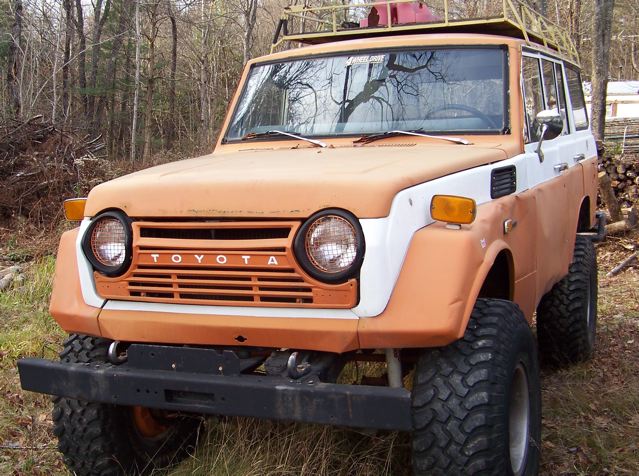

Land Cruiser FJ55
I was unsure if I'd actually like the way they looked, so the first step was to mock them up.
Hard to see how they'd look with the magnets holding them up (thanks Mot for the one on the left!), so a quick photochop gave me this:
Okay, I can live with that. Some quick taping, outlining, and cutting later, and I had a nice hole in my fender.
Drilled a couple of holes, pulled the tape, and ended up with this.
Currently only two of the four holes have screws in them, need to go pick up some additional ones that are the right size. Also need to bend the vent slightly as the fender is slightly curved, for a tighter fit. Plan on repainting it, I think I'll probably spray it with Duplicolor bedliner to match my body cladding/flares.
All in all quite easy. For anyone else considering doing this, there's really nothing behind the sheet metal there, so you can use whatever as long as you're not using a 10" blade. No need to worry about hitting wiring/motors/etc. The closest object is the motor for the antenna, and you can see where it's located from inside the engine bay.
It doesn't move nearly as much air as I'd hoped, but it certainly lets hot air out. You can feel the hot air moving when idling, and it seems that the engine bay cools quicker when moving. It doesn't seem to help much if any when idling, but in the next day or two I'll hopefully see if the max idling temp drops any.
I actually got both sides, but one side is a fake vent, so I'll need to manually cut it out if I want to use it. Fortunately it's steel, so I can easily do so if I so desire a vent on the DS at some point.

I think you need the chrome 55 vents...
I think I do too. Maybe I shoulda swiped them off your piggie when I had the chance. Wait, someone beat me to it......they just took the whole thing! :hillbilly:
In all seriousness, I actually prefer the blacked out look. Just my personal preference.
