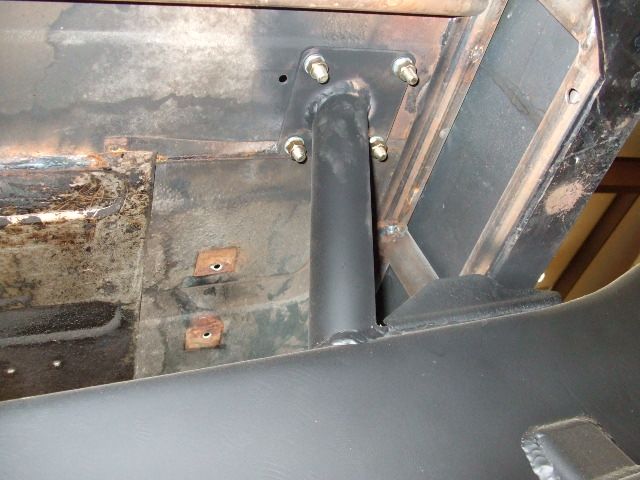

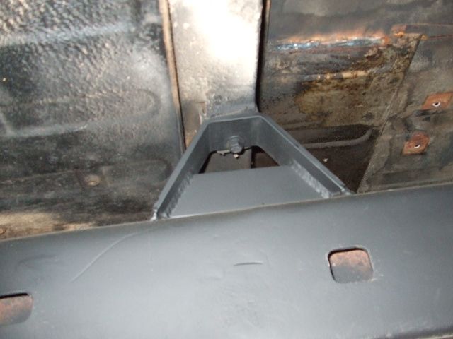

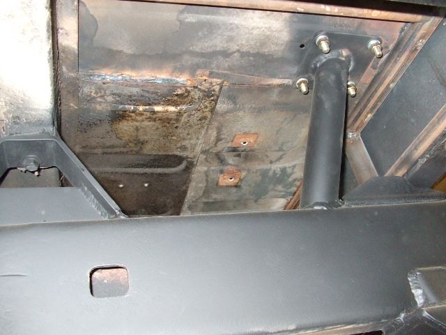

Great build. I am in the process of doing the same with a BJ60 frame and BJ40. Can you get me a shot of your rear body mounts? I am struggling a bit with what to do back there.
Thanks.
Thanks.
Here are the pics I promised.

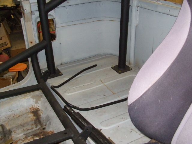

The top one is the inside rear area of the passenger floor. It does not have a hump since the wheel well has been removed.
But that is exactly what I'm building!
It looks like he took the extra inches off the front of the bed.
