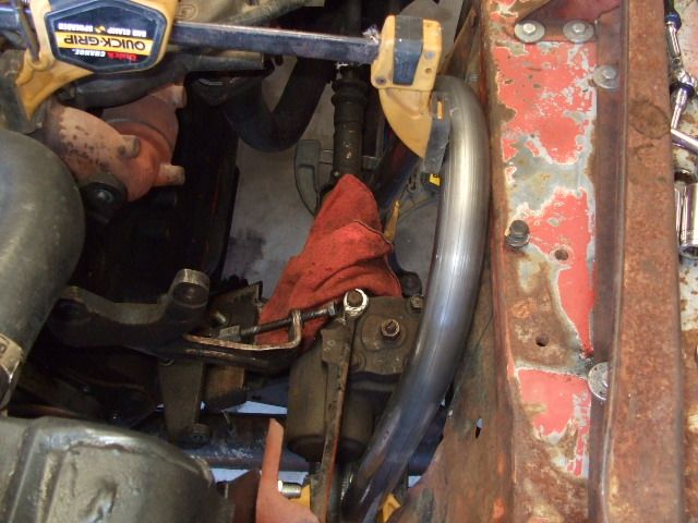

Here is how they mate to the frame.
Don't laugh but I could not find my C Clamps that I use for welding.
The top inner edge of the fender will attach to the hoop.
Please cut those off and plate the frame in those locations. The load will rip them square through the frame rail like this:
Cruiser frames are a bit more robust than that..
notching the tube to saddle down the side of the frame spreads the load and distibutes it across two planes. I have done litterally dozens and dozens of tube towers this way without incedent.
.... now welded on a single plane? specially on the top with less than 4 inches of weld? definate can opener!
bottom line, more suface area the better! more planes to a joint, the better!
