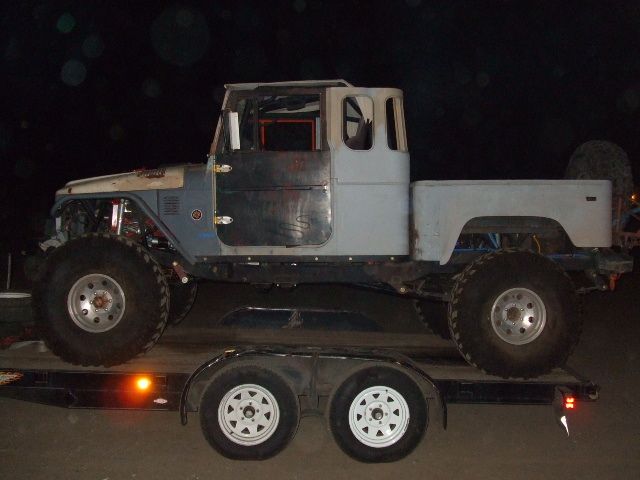

I picked up my rig tonight.
You don't really notice how quiter it is until you stand behind it and listen to the exhaust.
The alignment shop is the best in the Central Valley. My rear axle is .00813" out of square from my front axle if that gives you any indication of how they measure things. :eek:
The rig needs a Cut n Turn to get everything dead on as it should be.

Get out the masking tape and rattle cans, then you can change your thread title!
Glad to see it finally coming together. I know, I know your white board's probably still full ;)
