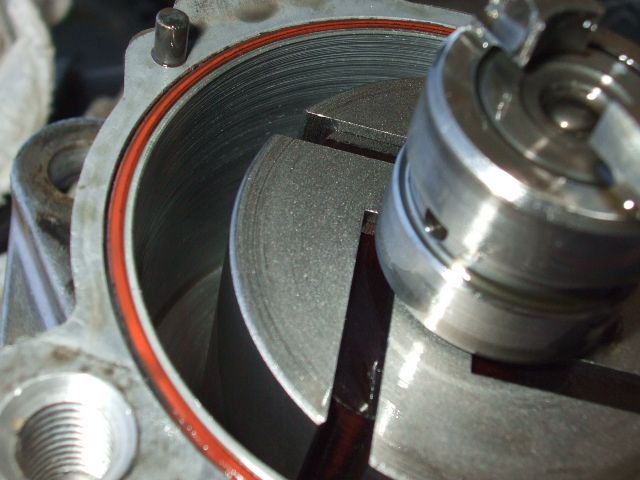

Started on the steering and had a bit of a set back.
I had a slight oil leak from the pump area. I thought I did not tightten the oil feed line to Wabco or something. Nope!
I pulled the assy and found the seal was cocked in the housing causing the oil leak.
I also noticed the drive gears were really worn.
Lots of life left there! Its only 1/3 worn through :hillbilly:
