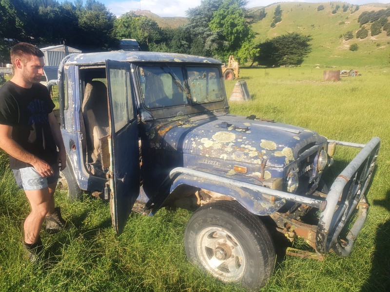

My mate is selling this in new zealand. Its split window, might be quite rare by the sounds not sure what year or model it is, does anyone on here have any idea?
1886 would be very rare :p
