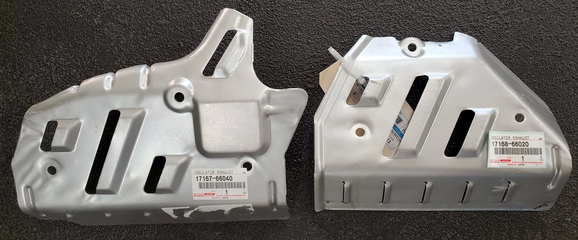

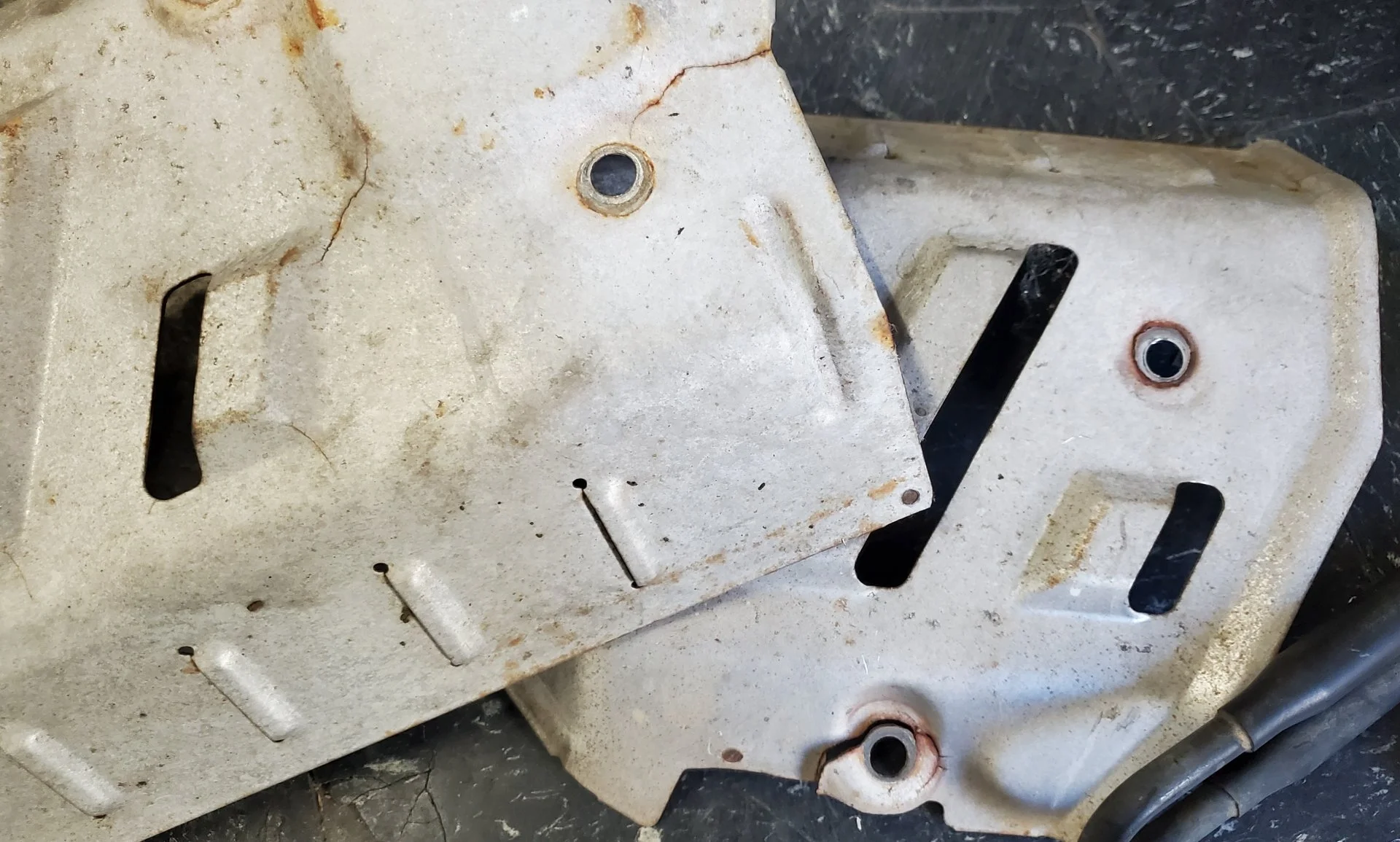

New exhaust manifold insulators, as mine were starting to fall apart.

Hood getting a refresh. Seam sealer where needed to repair separated hood ribs. Tattered insulator will get replaced and new clips as well.

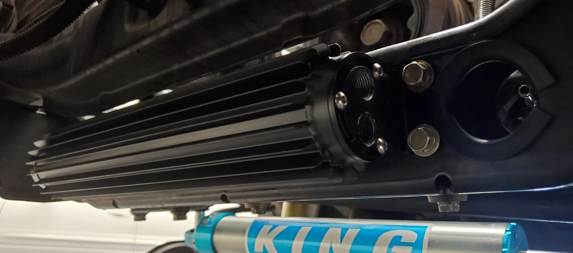

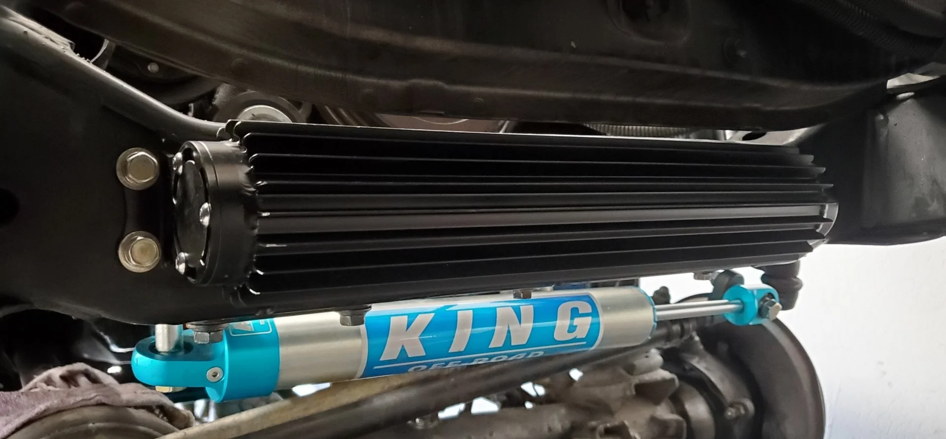

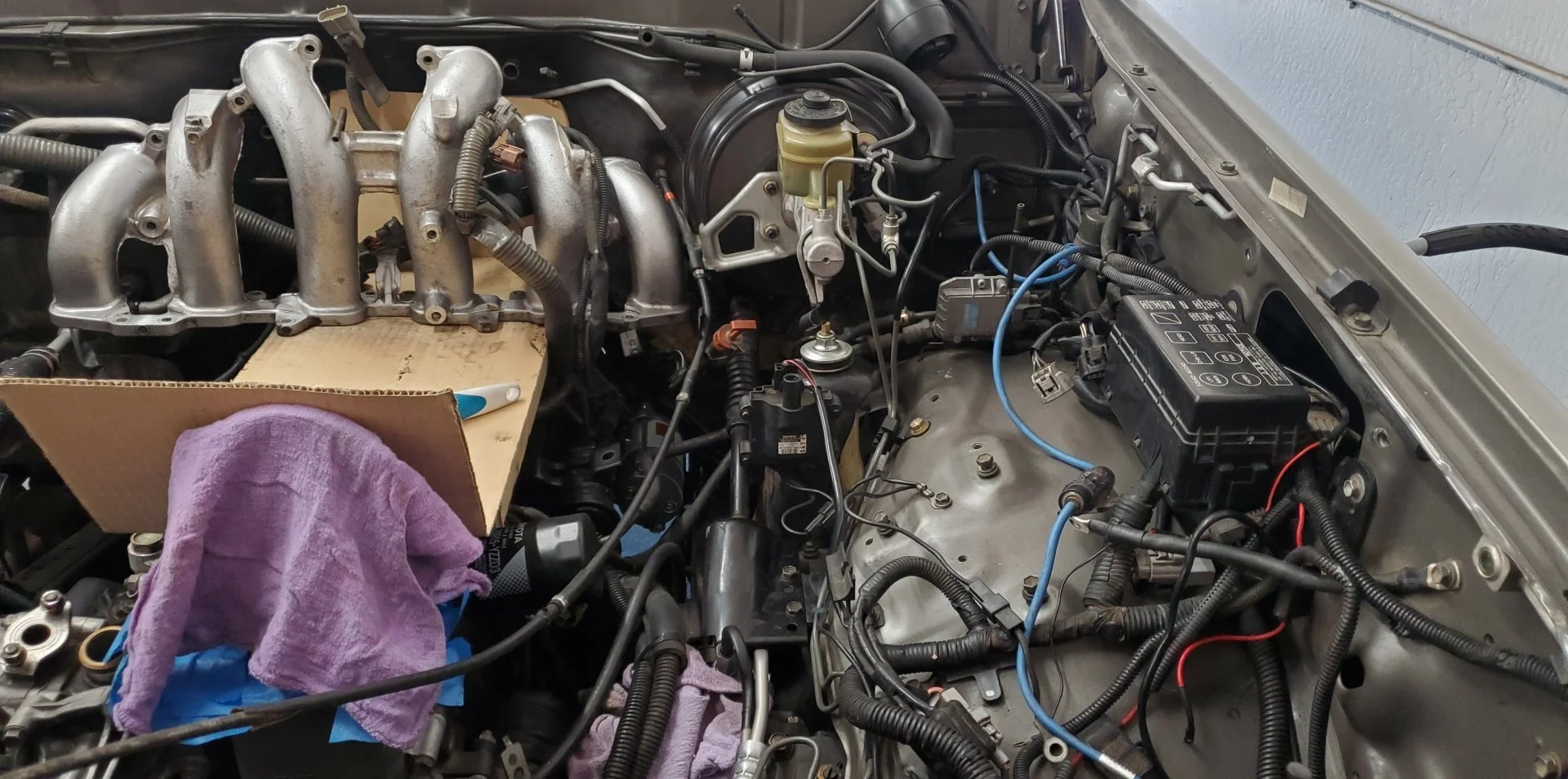

I've used that cooler in other applications, and I found it to frequently trap air.
I'm not saying it's not good.. it definitely is, but it may be beneficial to plan some sort of bleeding near the cooler in your plumbing.
Let it dangle fitting side up while you add fluid and burp the system.
This is a good idea. Didn’t do that on mine years ago. I think connecting the hose from the steering box to the lower port of the cooler does the bleeding process.

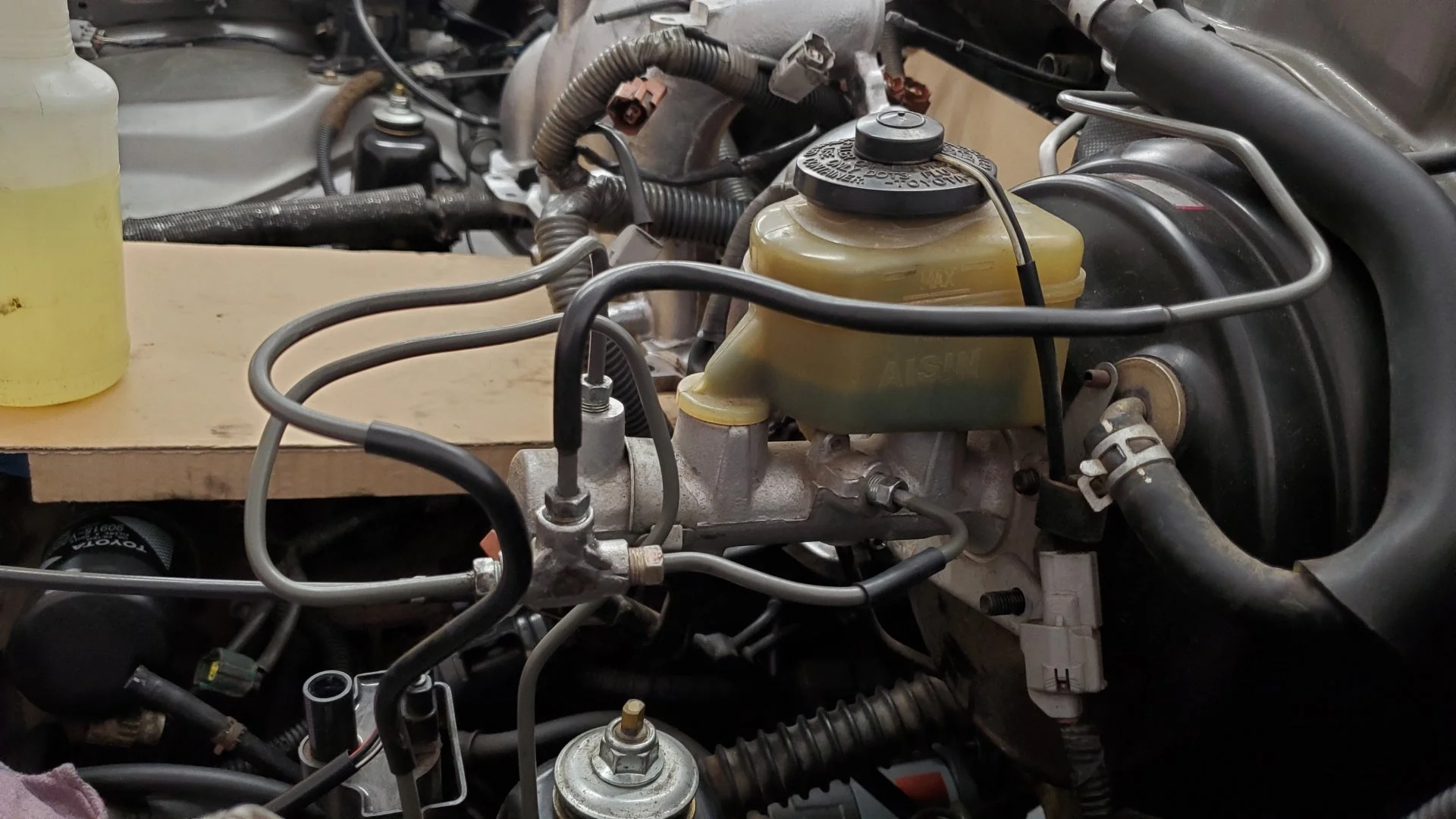

You aren’t messing around with this round of work! Unfortunately simply removing the Abs pump and the LSPV didn’t render the improvements I was hoping for ,hence the hydro booster install with larger MC.

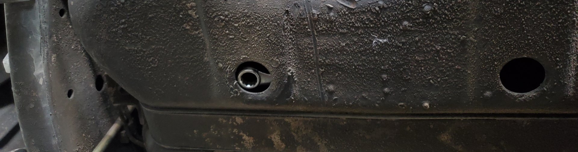

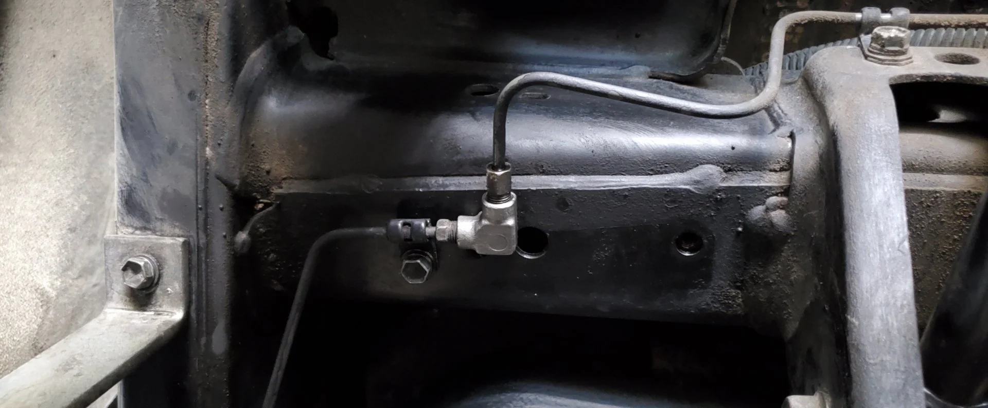

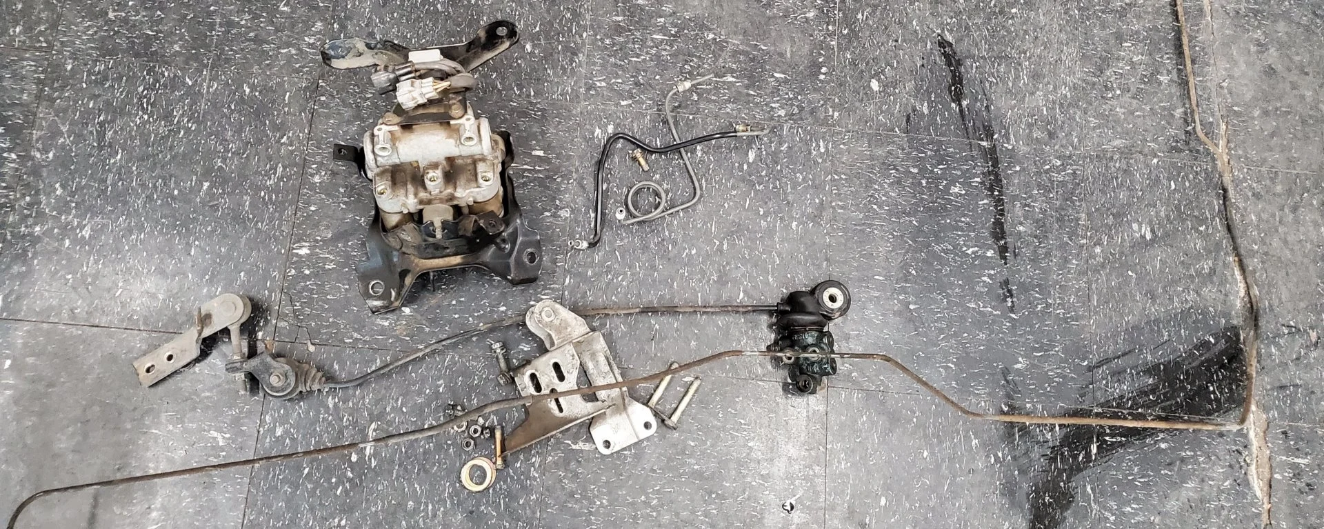

Now that it was fished out, I finished removing the LSPV assembly and the whole brake line. I also used the single line anchor from the L/F frame rail, attached to the LSPV line, to secure this new union. Man, removing the 2 bolts facing the fuel tank that hold the LSPV bracket was a pain.

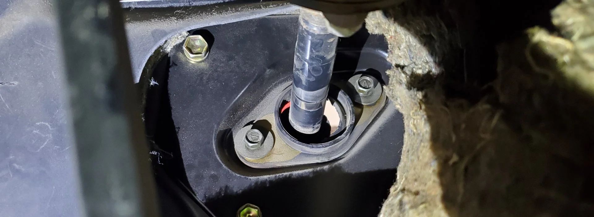

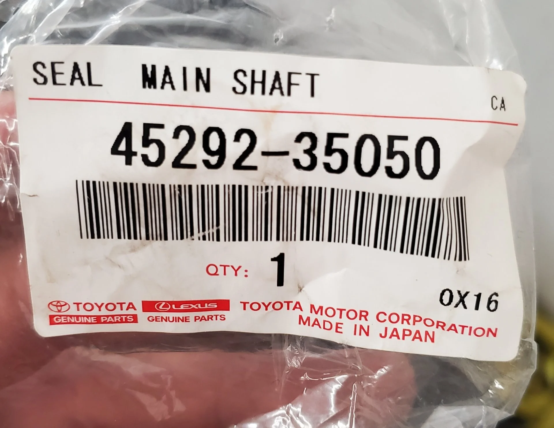

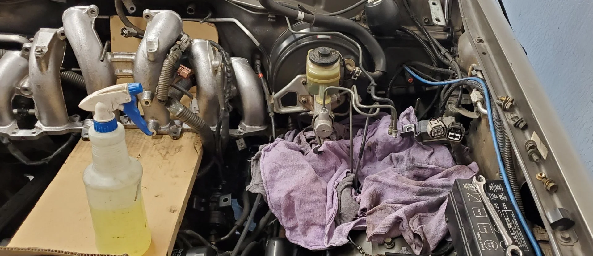

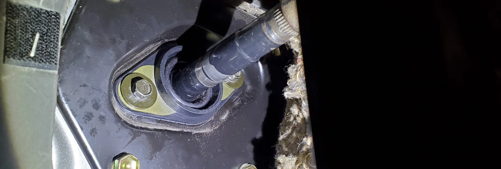

Replaced steering shaft seal and cleaning up drivers bay.....

Nice work on all the upgrades. I just did the steering shaft seal a few days ago. And definitely wish I did my motor mounts when I was doing the HG. They've since gone bad which I believe is causing my fan to hit the shroud :/
Nice Paul!...I need to get this done, I've had the main shaft seal laying around for way to long..

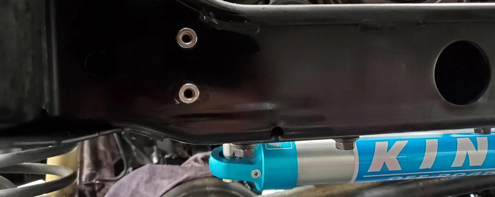

On installing the Derale cooler I drilled and tapped the frame. I started thinking about future bleeding of the system and I would want to remove the bolts every time. This would give the cooler a good angle of the dangle for bleeding. I came to the conclusion the thread engagement might not be reliable enough for this. Maybe I am wrong, who knows... So I installed rivet nuts instead.
Dude, it took 25 min including looking for where I put the part and gathering the tools.
