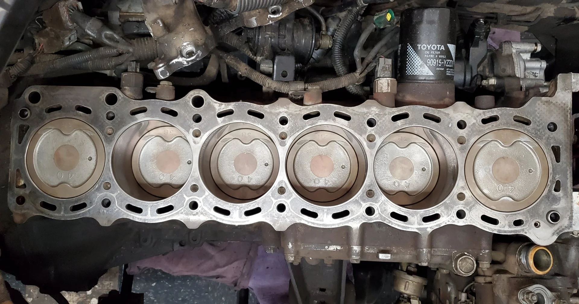

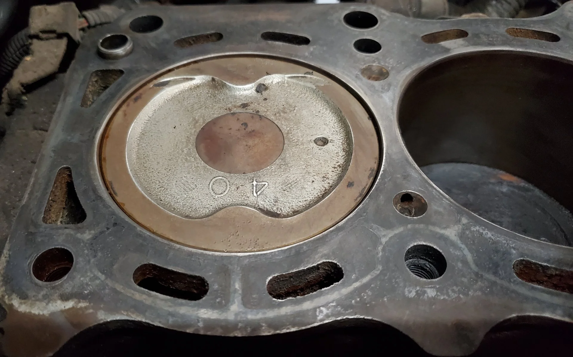

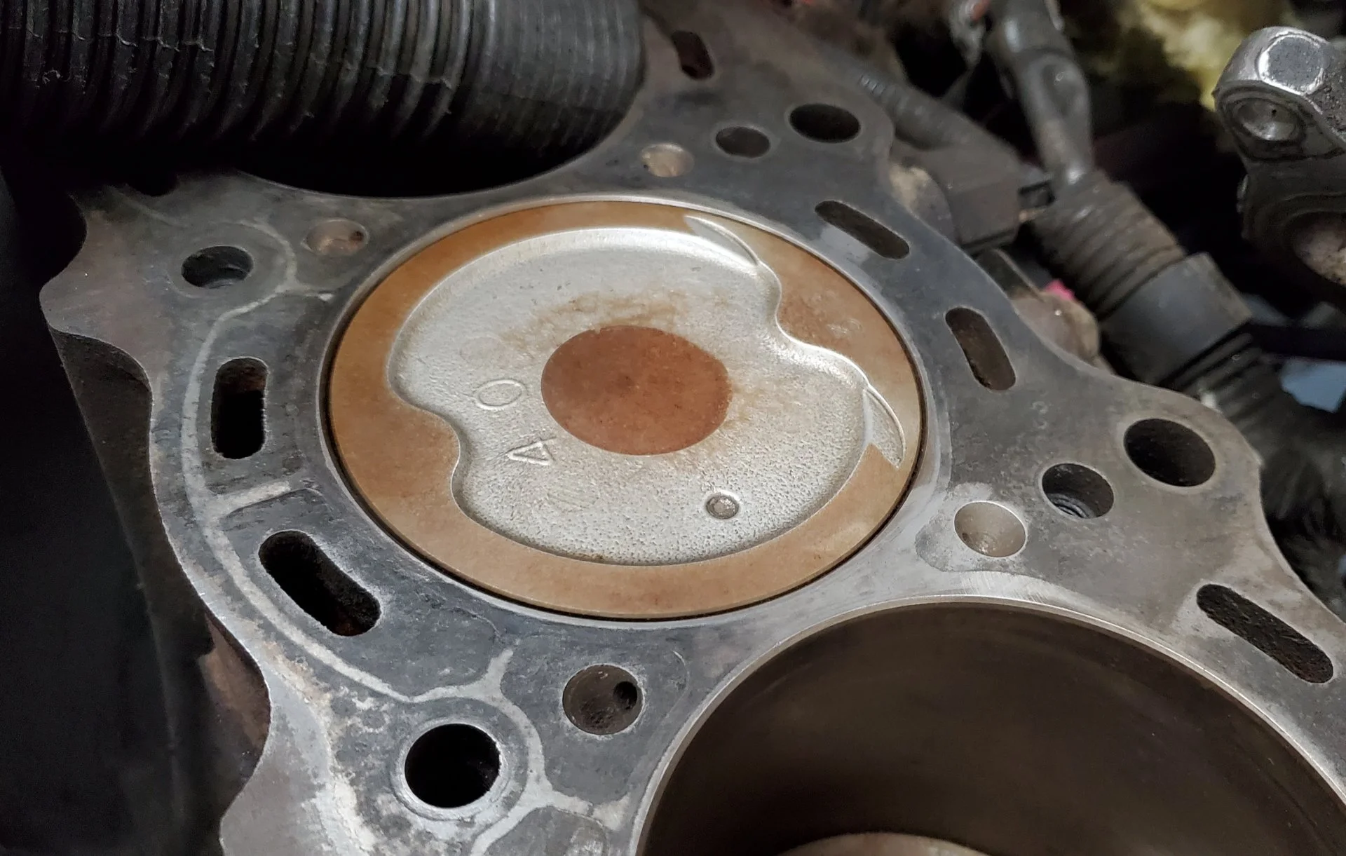

Last piston done. Was surprised the amount of elbow grease this takes to get them all to this point below. Pistons all look to be in decent shape.

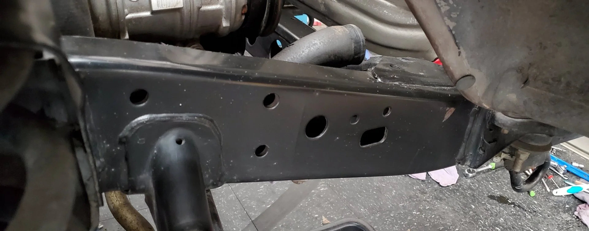

Time for some other cleaning.

What did you use to clean? Looks fantastic!
Thank you.
~Forney brass hand brush, small and large
~PJ1 Super Cleaner
~Shop Vac
~Razor blade scraper for gasket on block
~Hours and hours of patiently scrubbing and a few cuss words
I will clean again when tape comes off and scrub the block Iron to a final state. I had a handful of extremely dense carbon spots that I took a VERY dull flat blade screwdriver to. I would gently apply pressure to fracture those areas, then follow up with the vacuum, brush and cleaner again. There was no way they would have come off, had I not done so.

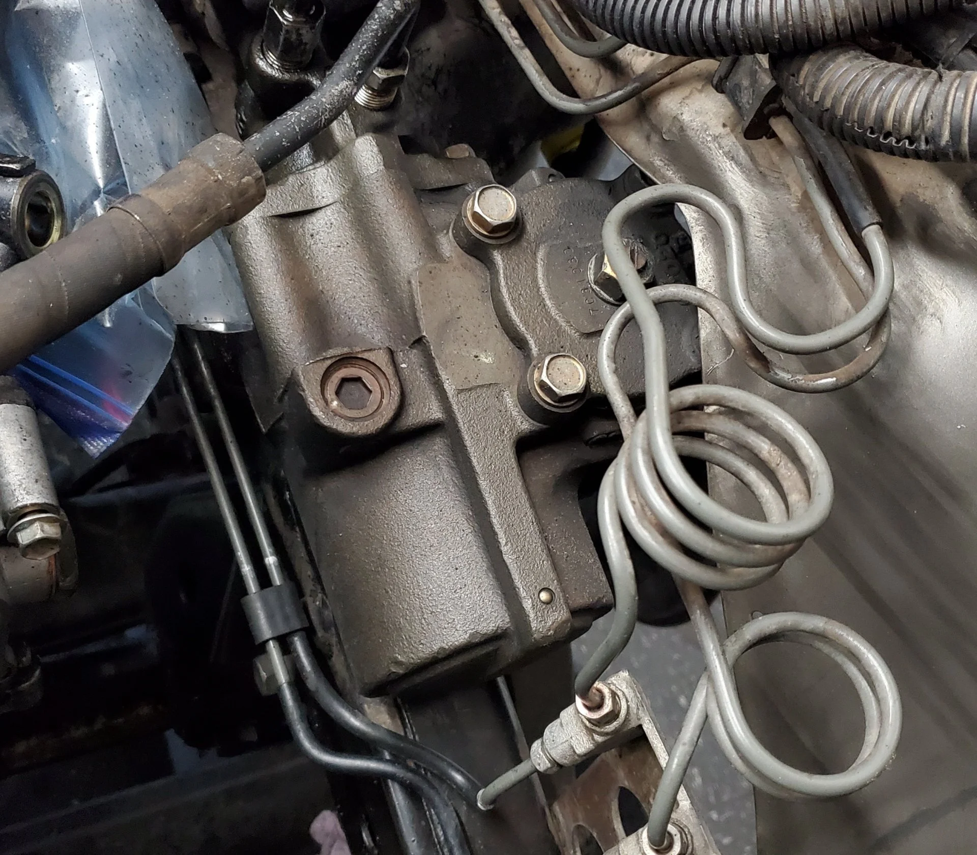

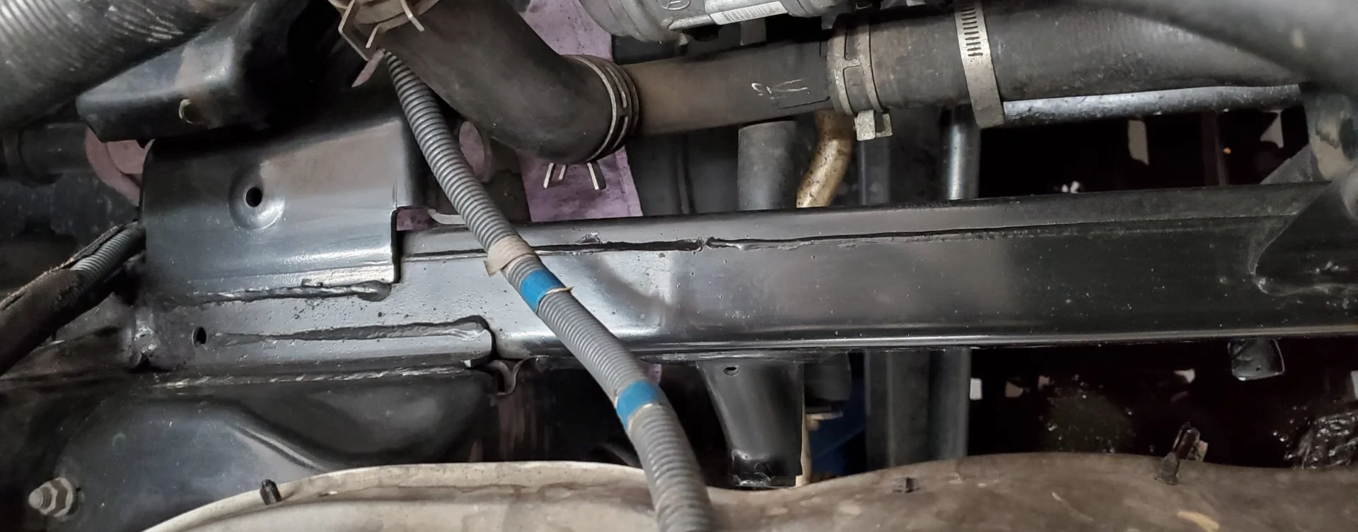

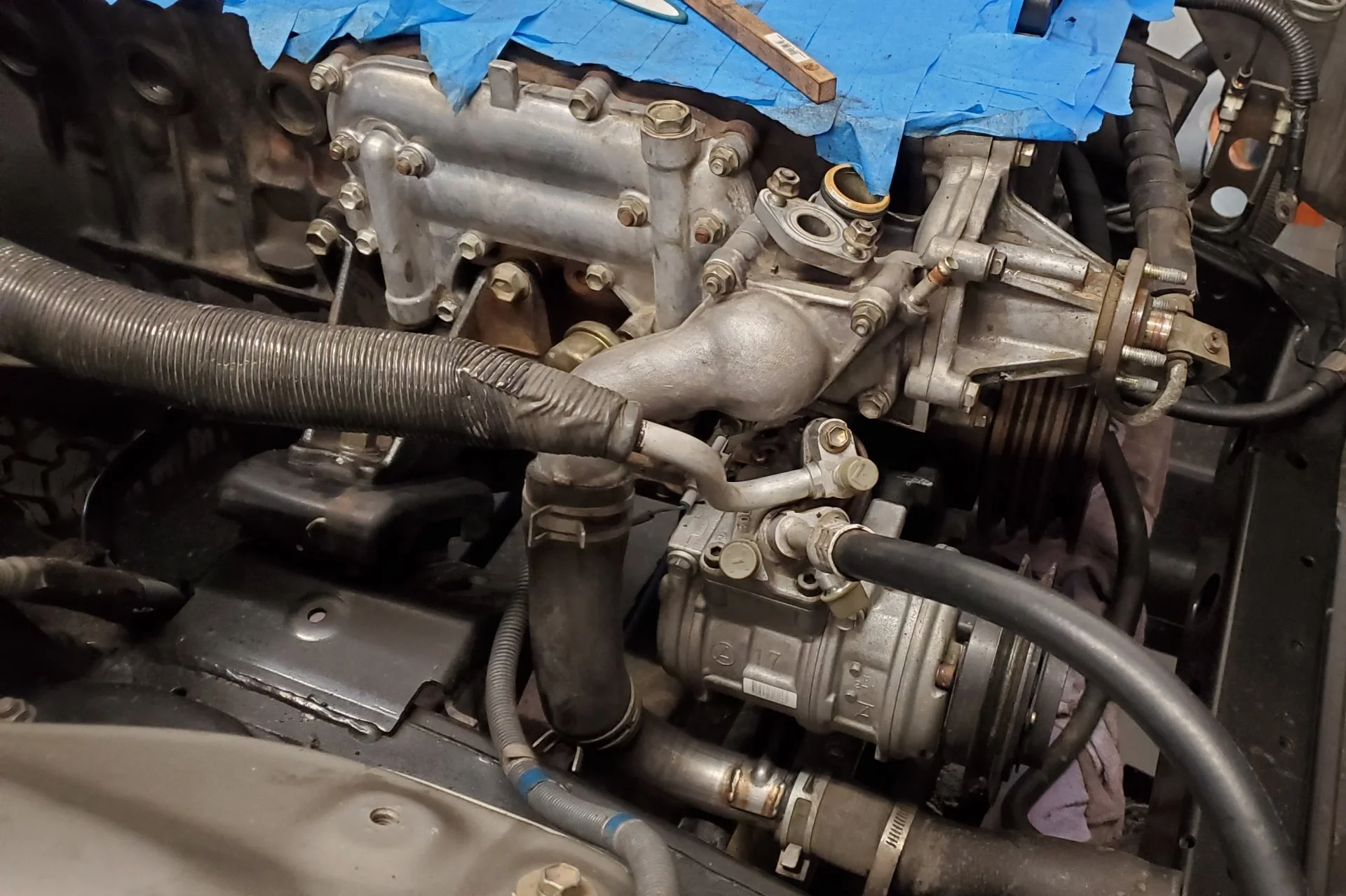

More tooth brush work. Lower manifold, steering box and cooling side:

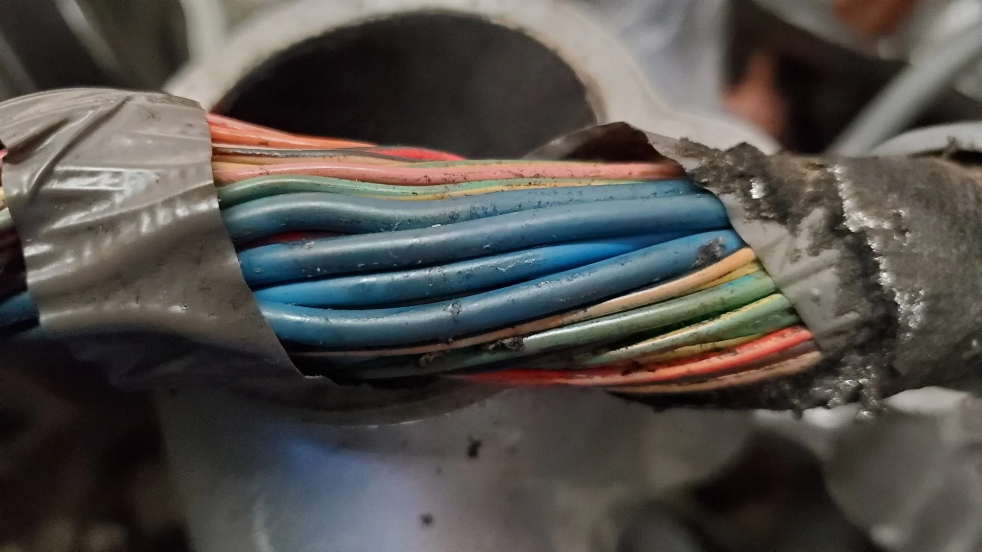

Wire harness looks good to go.

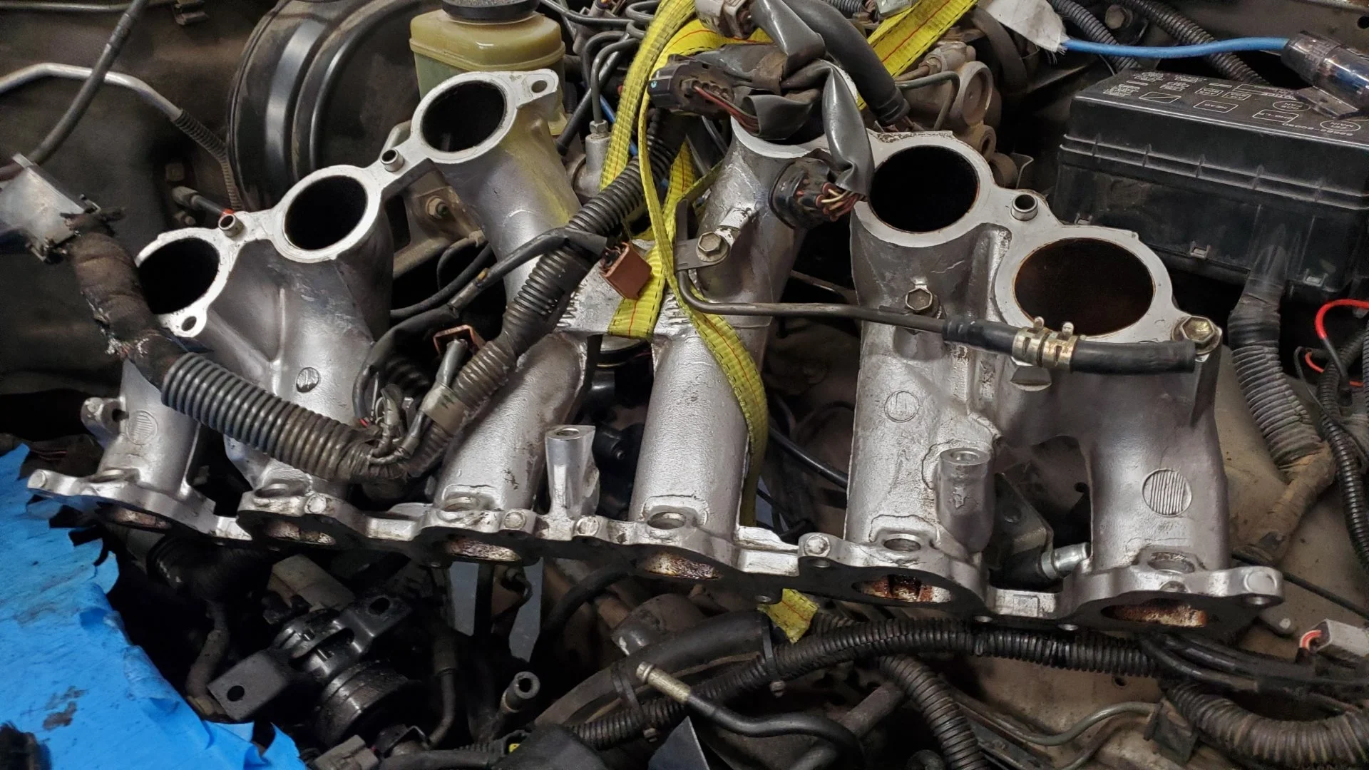

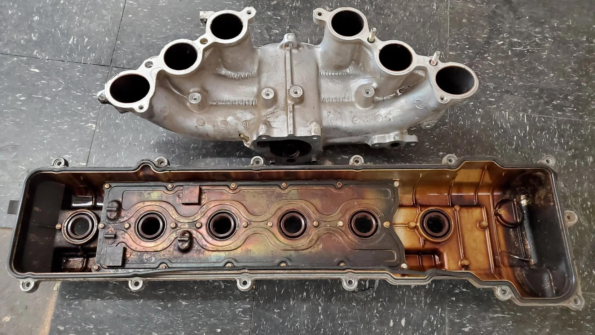

Valve cover and upper intake will take a bath when the head goes out.

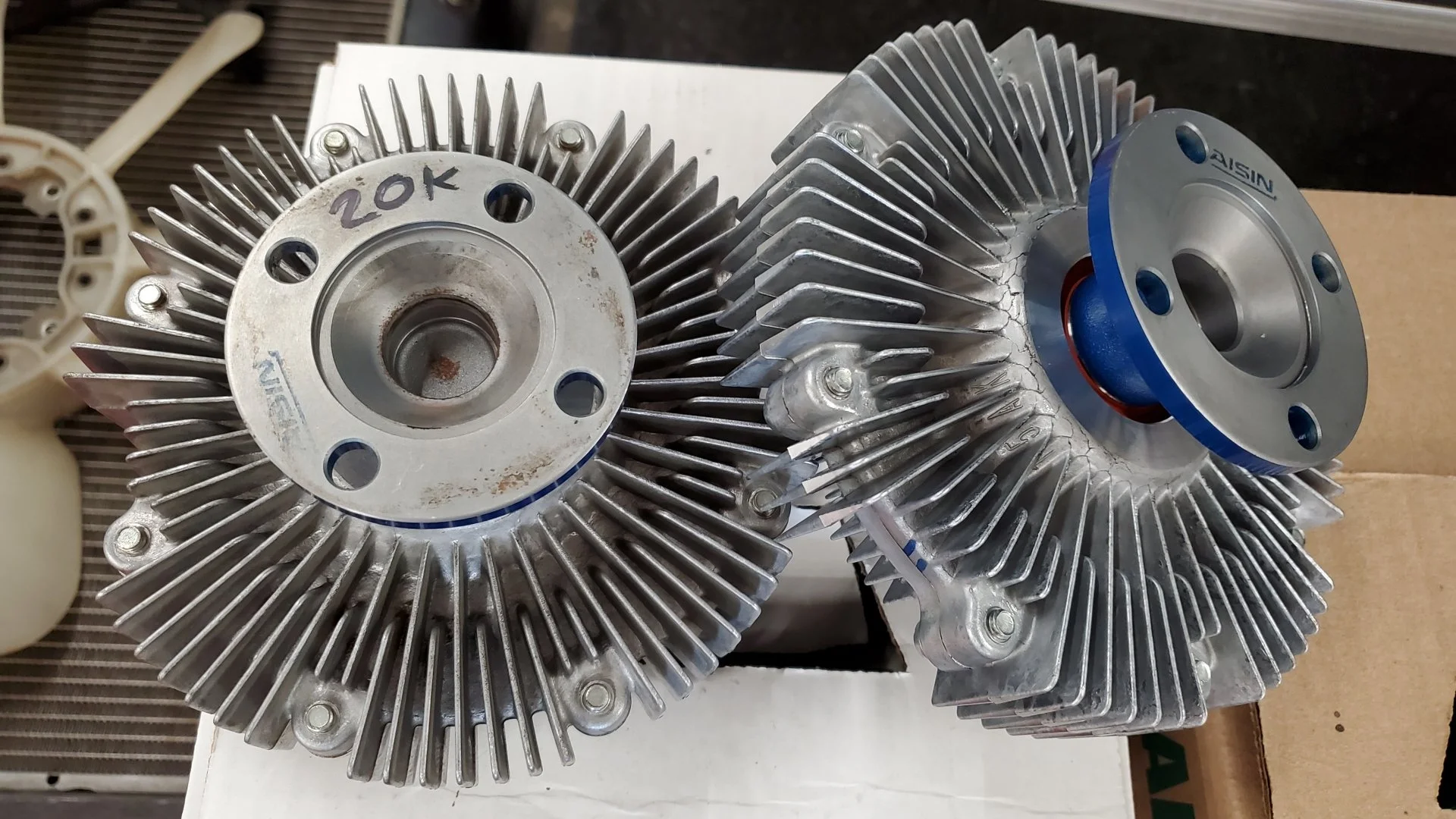

New blue fan clutch with 30k fluid. Take off had 20k and worked great. It will go in the spare parts bag.

I have been pondering this. The list of projects keeps growing while I am in here lol. Never thought I would be replacing all the steering hoses, but when you are cleaning and see how empty the bay is, it just makes sense.
Do the High PS hose. I replaced mine with Gates. I heard Rein is good to. Otherwise OEM if you loaded $$$. I'm all for OEM everything 99% of the time. But I opted for cheaper and its been working good so far with my hydro assist setup.
Do all PS hoses while its easy now! See my Crawler80 build thread for my PS cooler set up with the derale and PSC resv. I wish I did that for my Turbo80. Thats the only thing I neglected to do on my Turbo80. High pressure and Derale and PSC resv. I will one day.
Otherwise def do the engine isolator. It's much easier right now with no head in the way.
Yup! Already have low and high hoses in the parts pile and a Derale cooler. Mounts already ordered also.....
