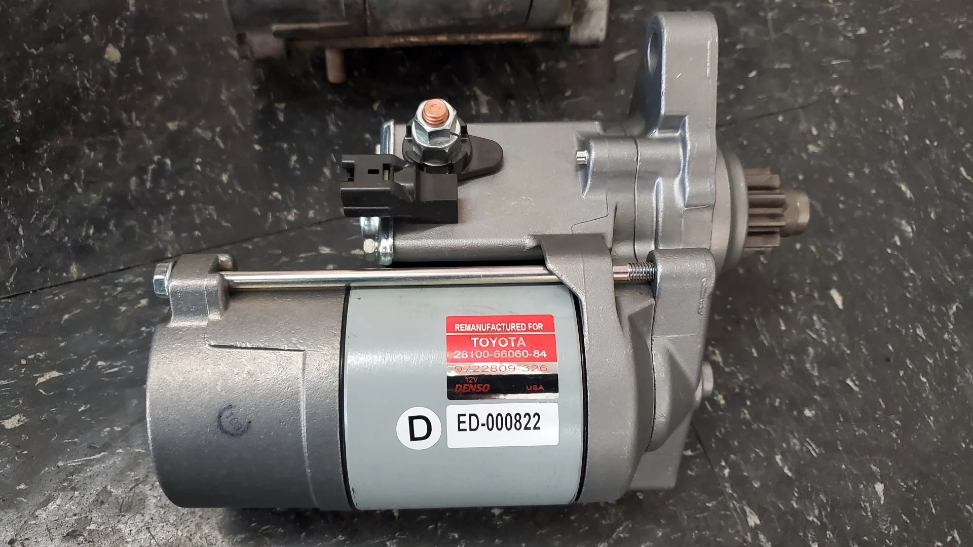

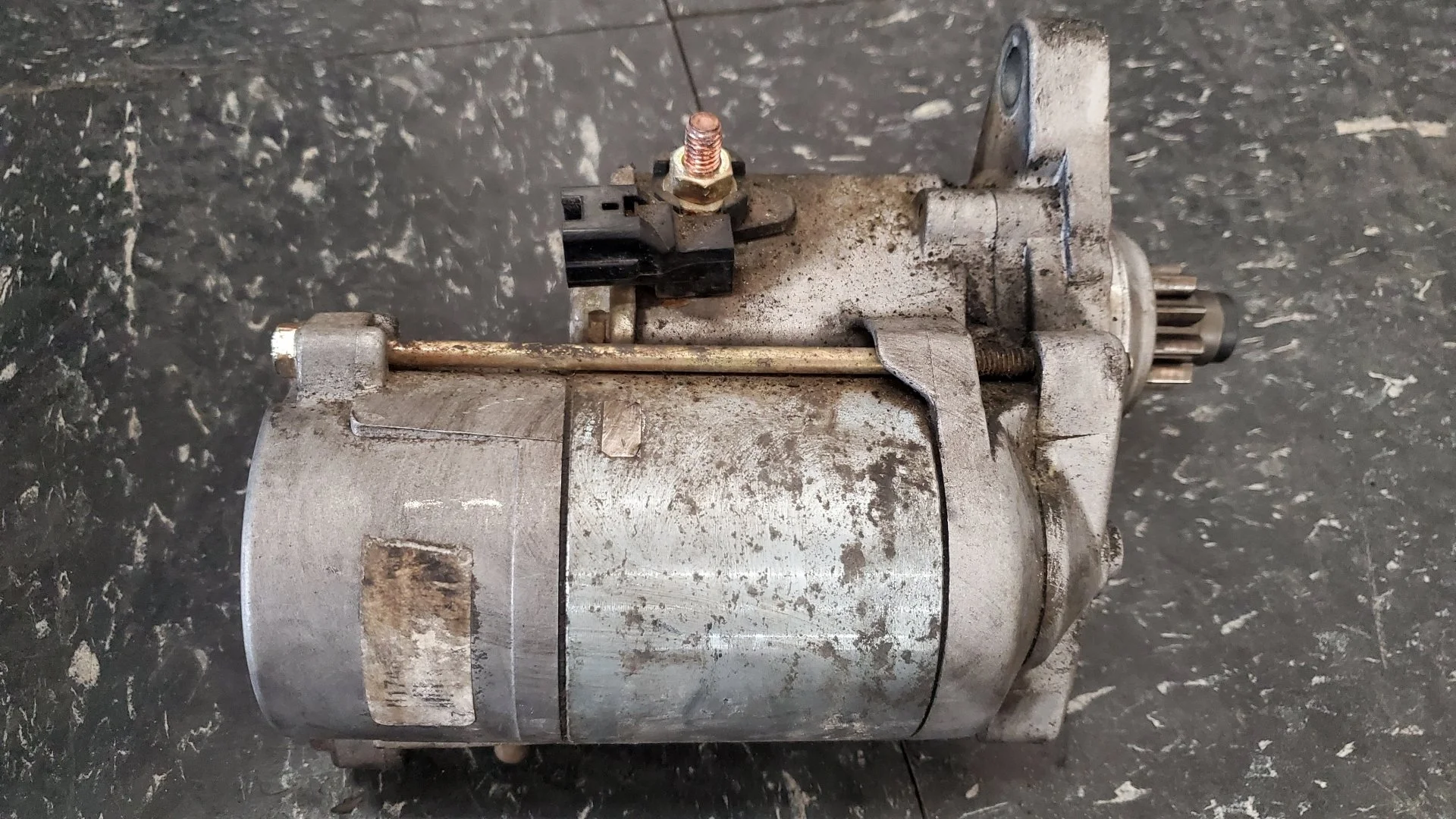

New starter going in:

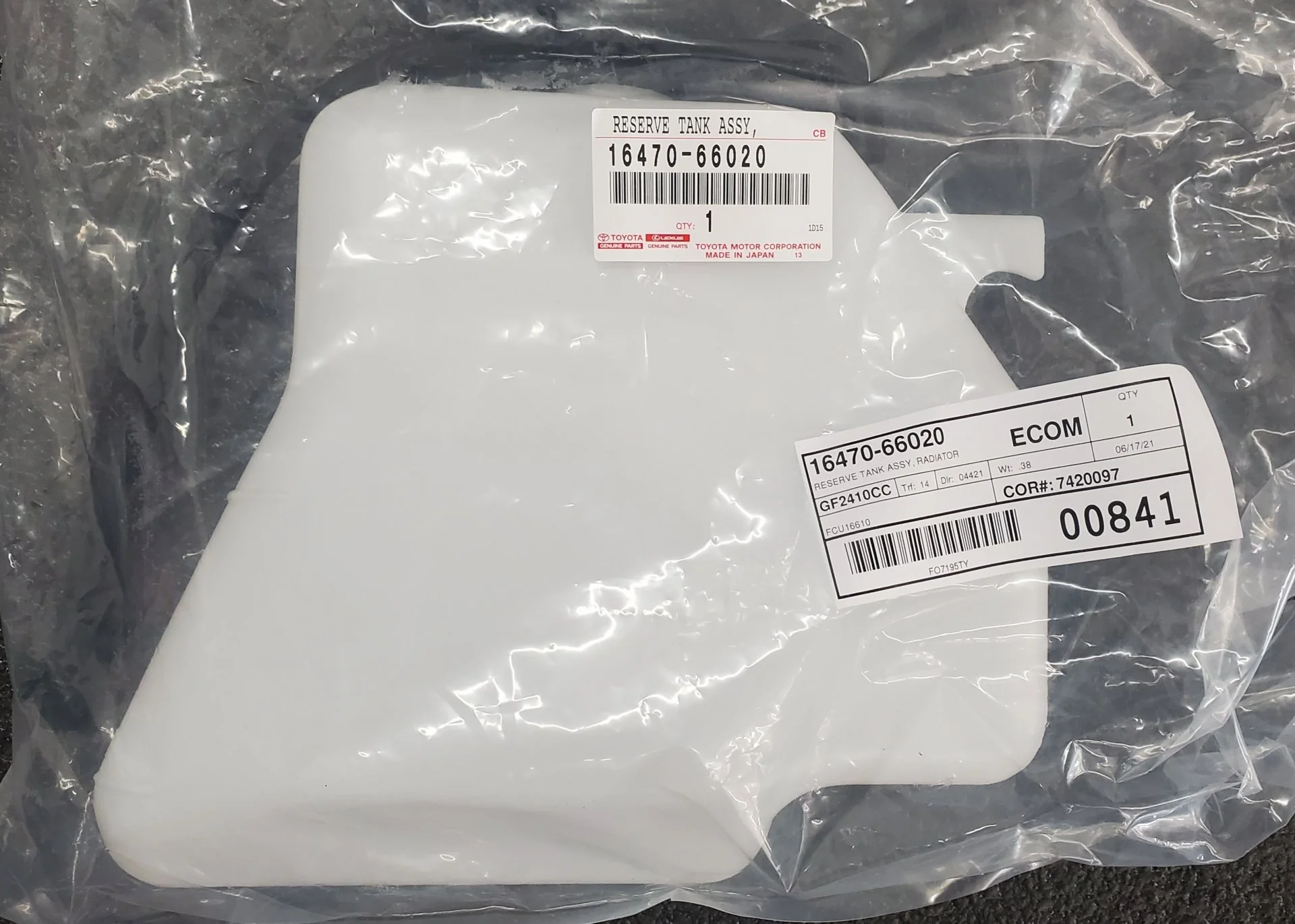

Today I finally have all the peices for a full cooling system overhaul.

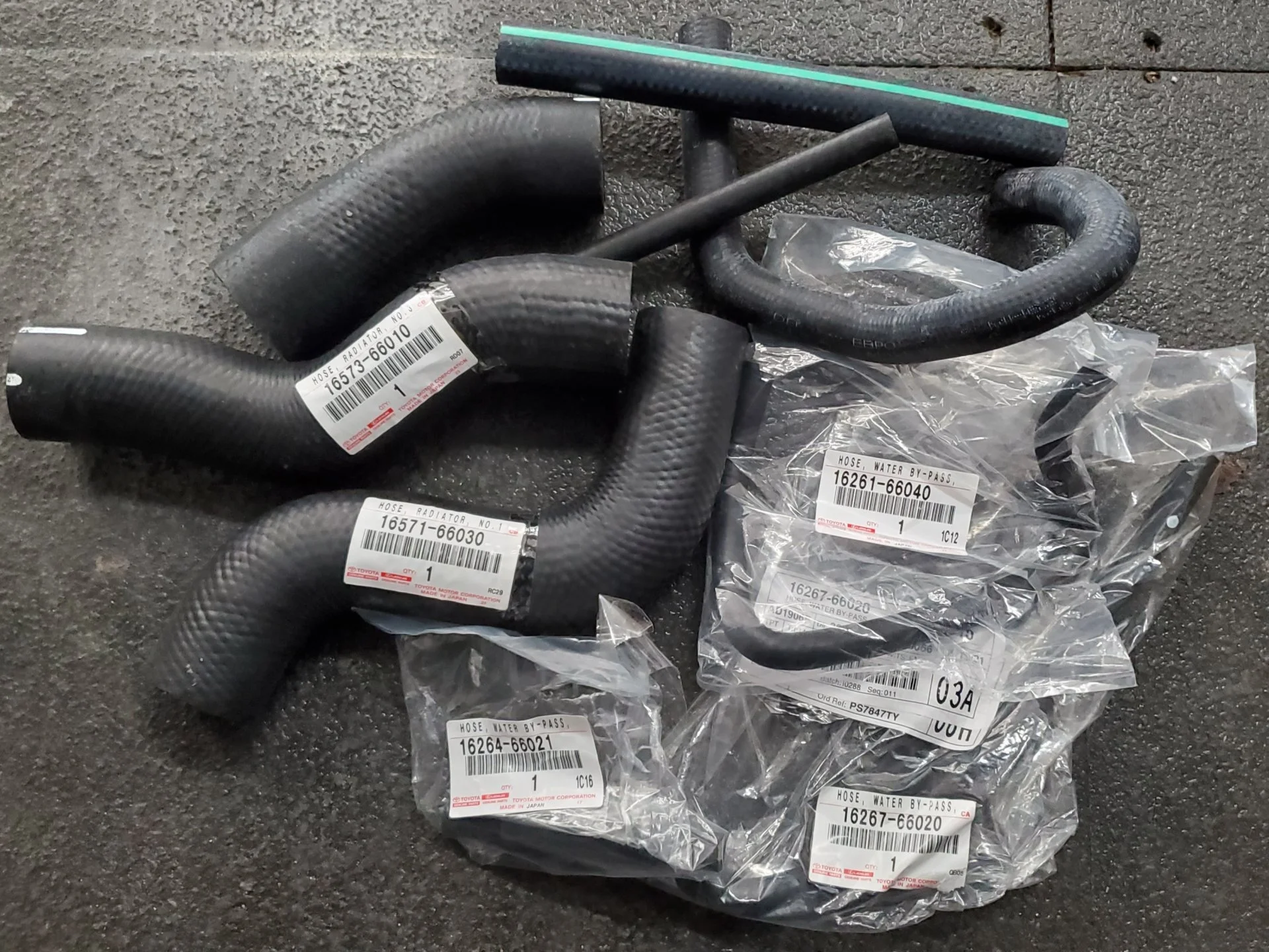

All hoses and rear heater delete:

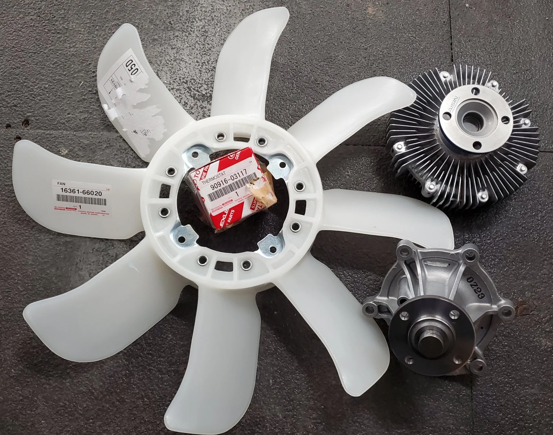

Fan, fan clutch as mentioned with 30k, thermostat and water pump:
Reserve tank assembly:

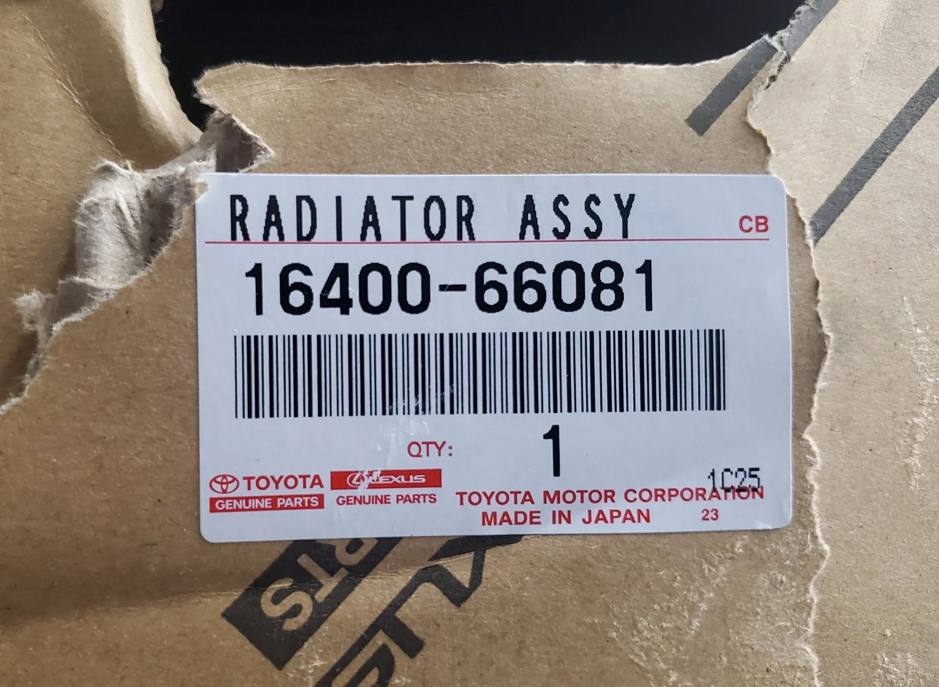

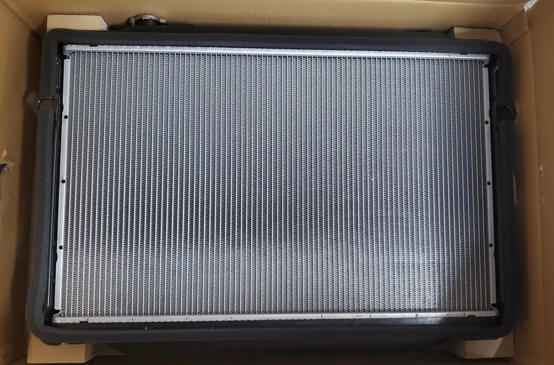

Radiator:
Dang, you broke the piggy bank a couple months ago? Gett’n it done “while you’re in there”. Makes sense to me. I should have replaced my fan I suppose as it has around 300k on it. It didn’t seem brittle and isn’t cracked so…. back on it went.
One of the blades has a nick. While it has always been there, I figured it will be getting taxed more with the heavier weight oil in the clutch. To add to that, parts availability keeps slipping away and getting more expensive, so I see it as a good investment. Plastics fail.
Love seeing these new OEM parts. Your truck is going to love it all. What I don’t love? Peeling the friggin stickers off the rad hoses.
Goof Off...
Thought, the stock rad was not available. Is it a 2 or 3 row? Is there any manufacturing name or markings on it? I just started during research on this & trying to learn. I see the foam, I need to do that to mine.
Yes, still available.

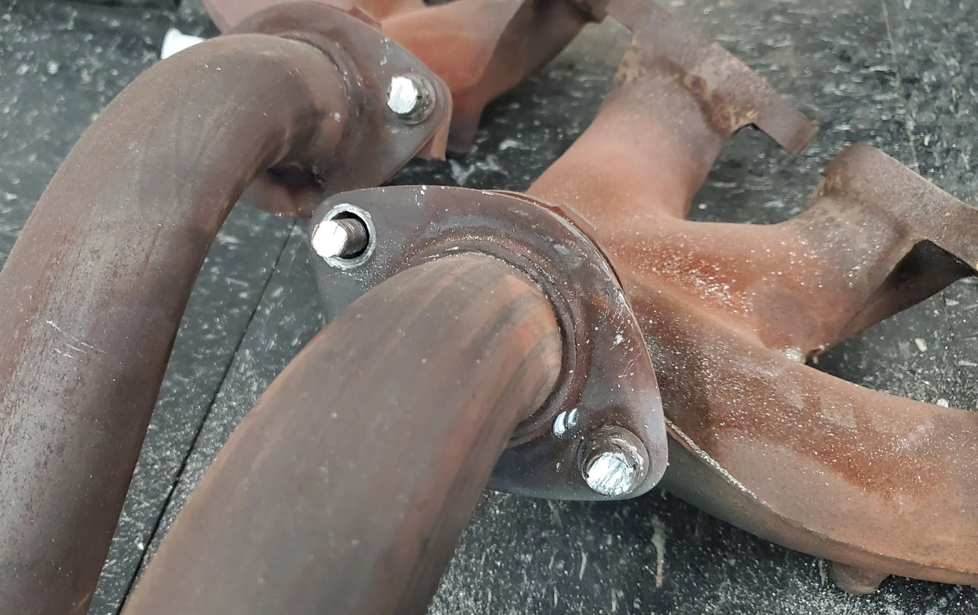

Extraction sockets came in and I finally liberated the exhaust manifolds. Cut the studs to fit the sockets.

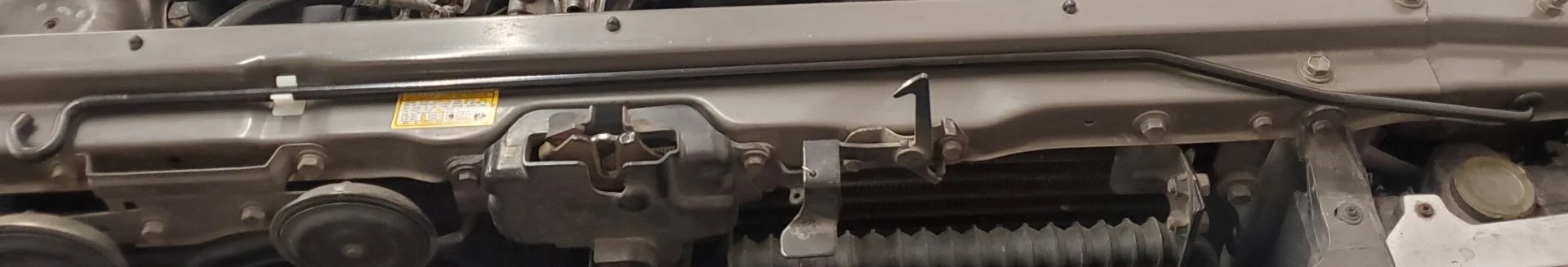

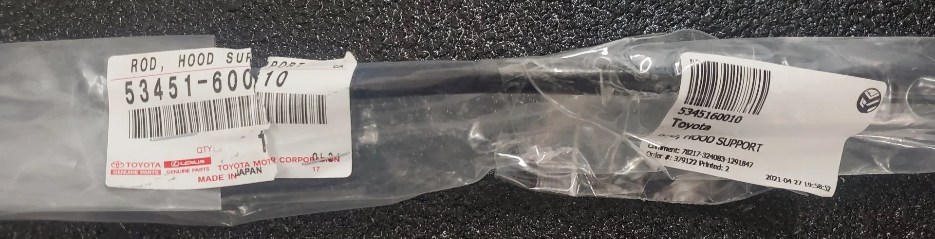

Added some old-school support.

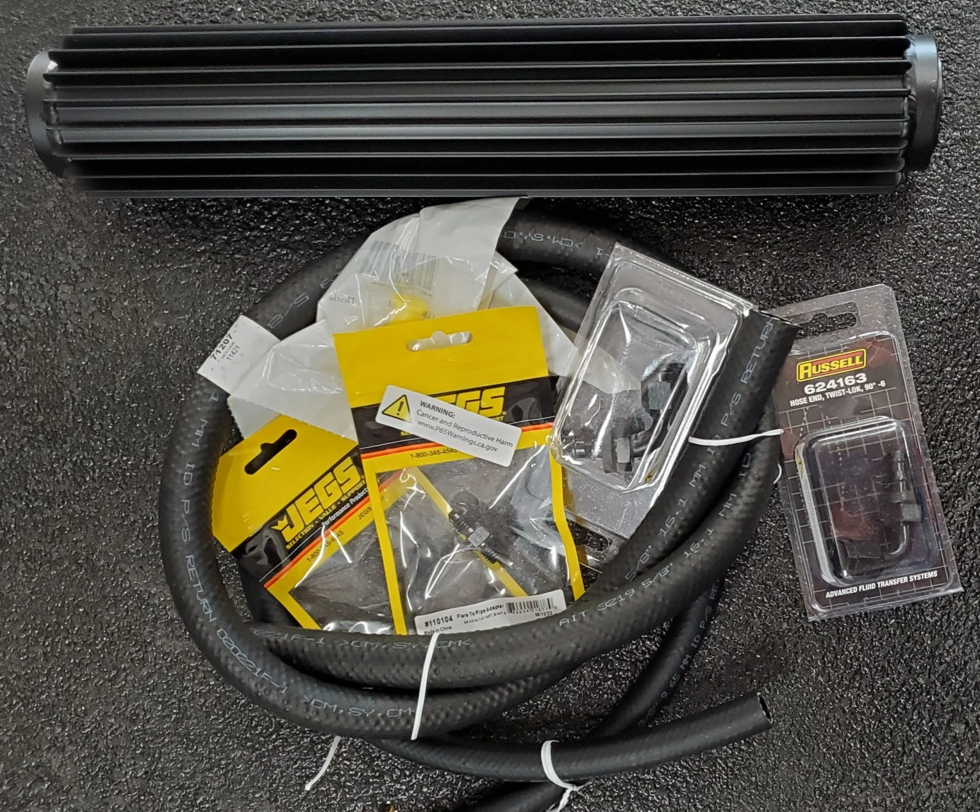

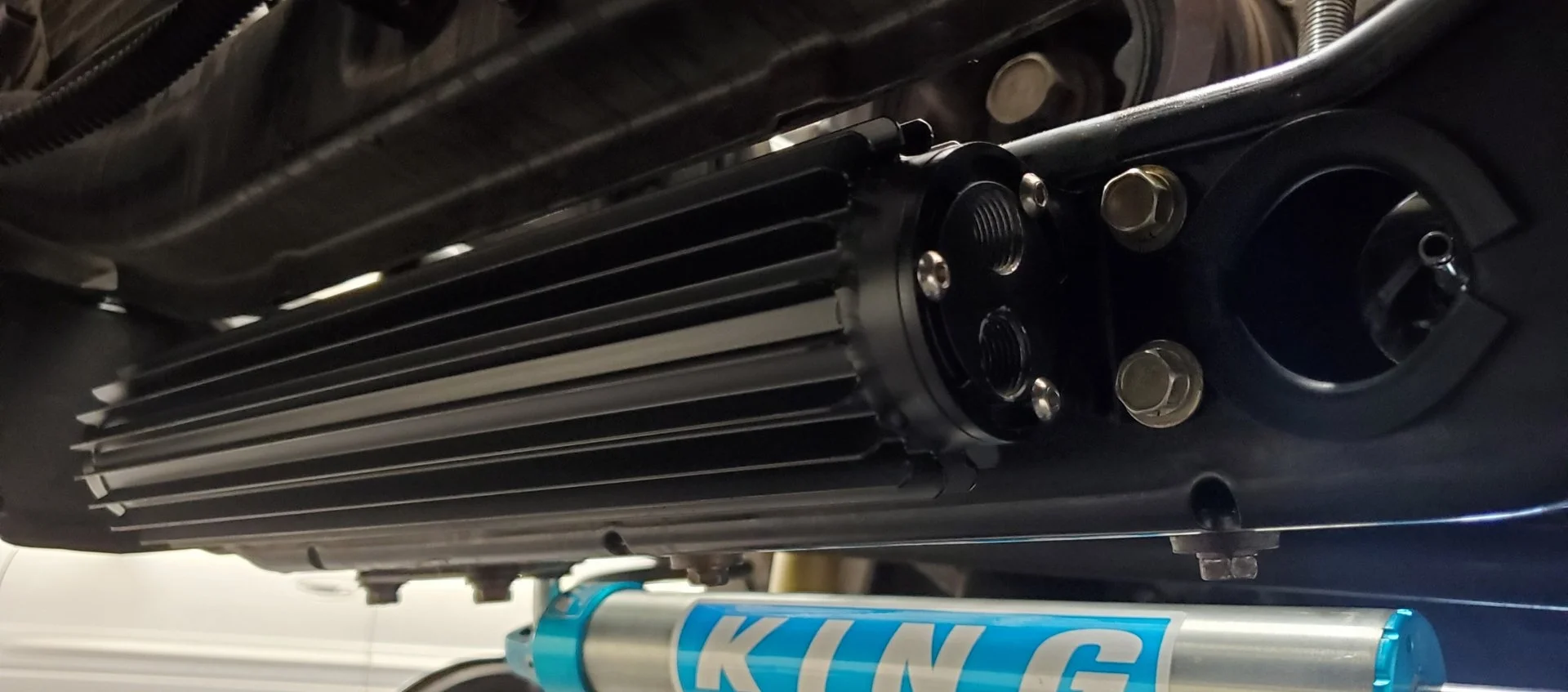

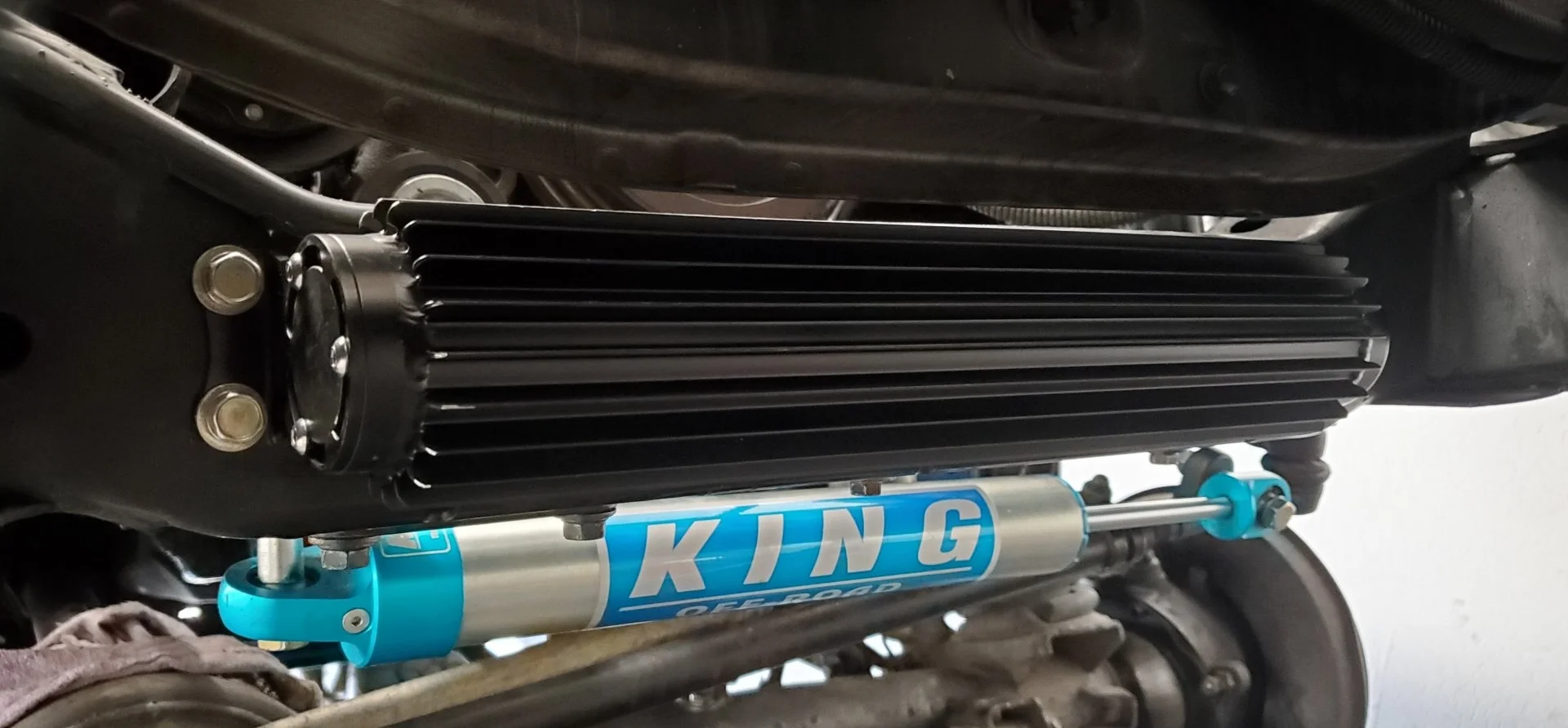

Derale power steering cooler upgrade. I painted the cooler, used Gates power steering hose for LP side and the Rein HP hose. Once I get the head back on I will finish running the LP lines. Hoses will have braided and spiral abrasion sleeving added to them. *Note: Derale cooler comes with 3/8" NPT inlets NOT 1/4" NPT as advertised online.
