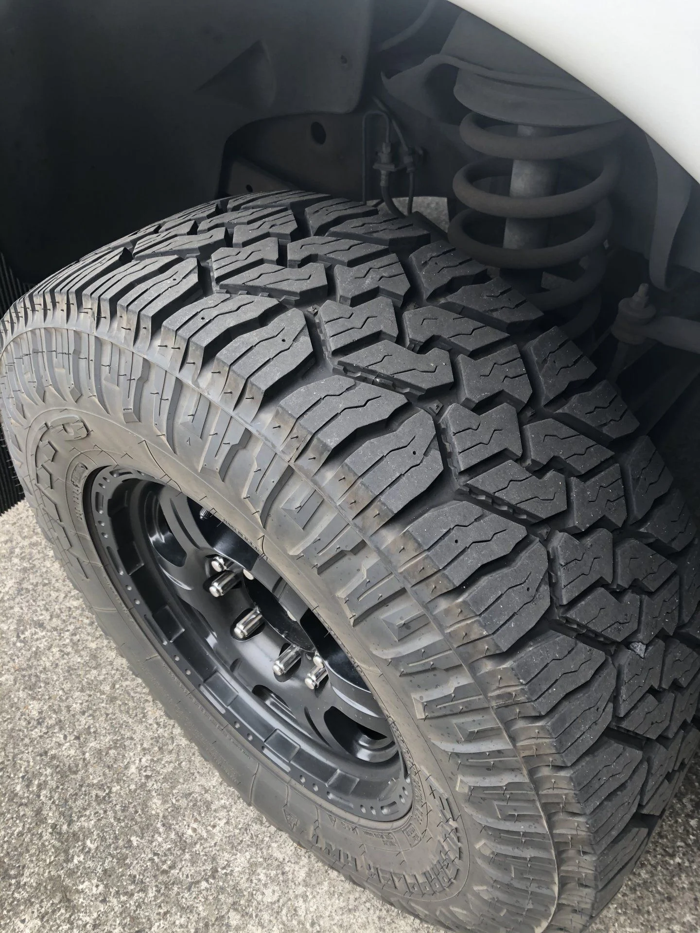

13k miles on a heavy truck. If you want full depth Siping your gonna have to pony up for Michilen’s like I did for my wife’s Hyundai. Actual wear is quite minimal.
I run the Super Swamper trXus in size 37 on my 80. These tires are sleepers. They are unbelievable on snow and ice, grip rocks very well and are quiet on the road for what they are.

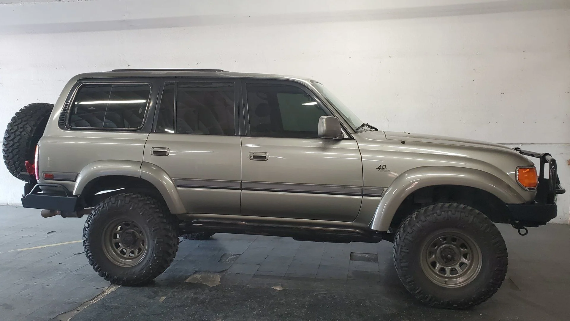

Btw, where can I see pics of your rig itself?
How she sits:
The paint is beautiful. I can fix that for you ..... haha
Haha it's a 20 footer. I seriously wish I had a second one to Hail Mary with. I'm getting priced out of the market....
I figure that once the smoke settles dents will be back in vogue.
Turns out it was just a tire from the back causing the death wobble. Re-rotated the tires and it drives just fine. Driver side hub pre-load is ok and all joints check out fine as well still.
Looks like a trip to the tire shop at sunrise!
Ok all is great again! 4.5OZ on the culprit tire took care of it. Rotated back to the troublesome arrangement and no problems. Maybe tire rotations and a balance more often than 36+k miles at a time is a better idea lol.

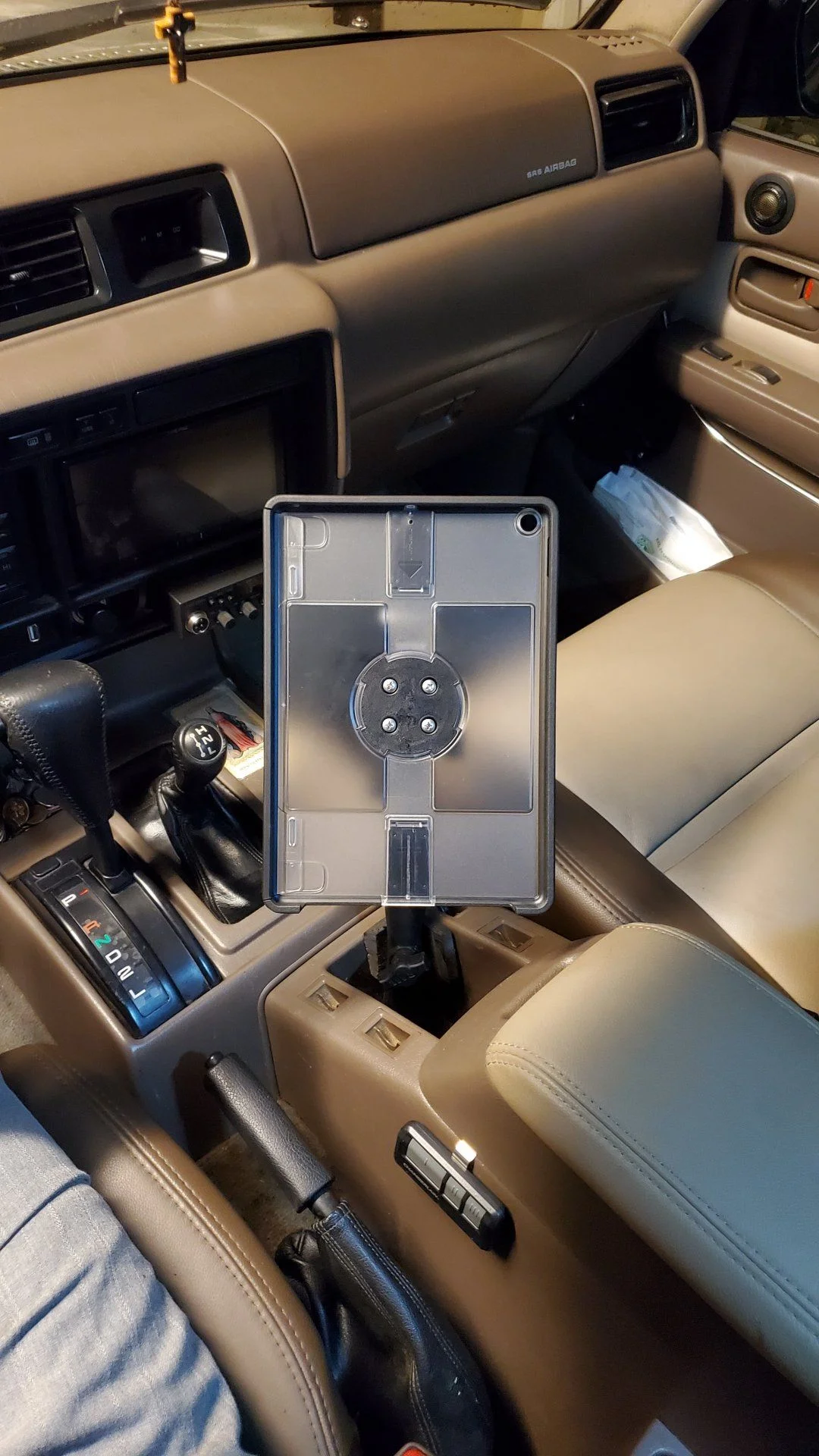

Updating the iPad mount. My last iPad was demolished, so it will be replaced with the new 8th Gen. I will use a new bracket and now a case for the tablet.
Lot's of positives from this: protective case (naked before), smaller profile for the mount when the iPad is removed and much easier to choose between portrait or landscape viewing with the new 2-part quick release.
RAM Mount: RAM-B-238-OT3U
Case: Otterbox iPad uniVERSE
As you can see, it still leaves access to all controls and does not impede on the passenger area just like before.

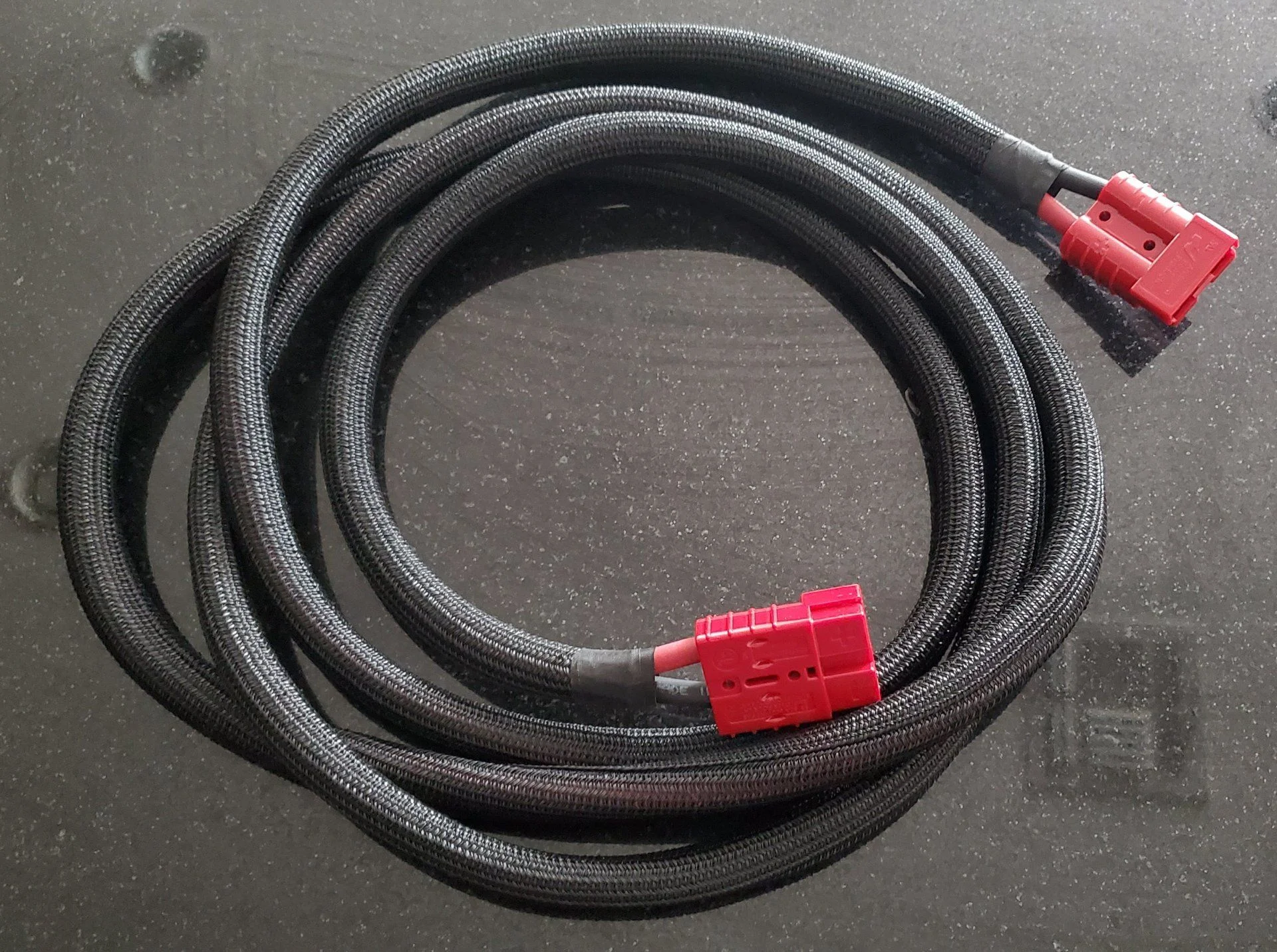

Made a 10ft-8awg Anderson extension to have in the truck. I have finally decided to build some storage in the back after my son convinced me we do not need the 3rd row seat.
This allows me some flexibility on moving the fridge outside to make a full size sleep platform, move the subwoofer to different locations or power anything else needed.
I currently have two Anderson power supplies in the rear that are independent of eachother, available for any accessory I use.

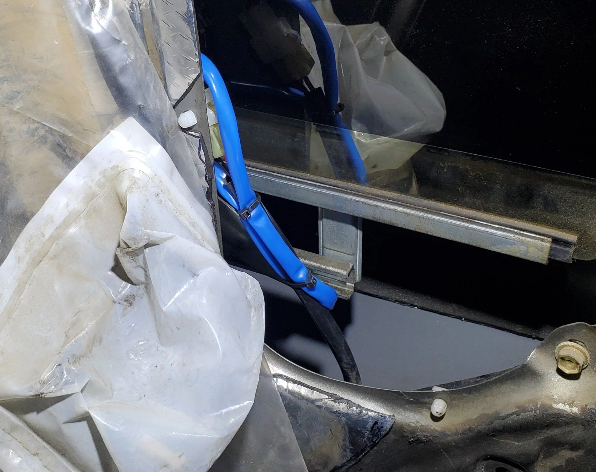

Started replacing window motors. L/R I replaced a long time ago, as it got to aiding the window by hand. Now it is time to do the others. They work, but like they are vacation.
TWO things I ran into setting me back this time around, that did not happen on the last install.
1. Check polarity on the motor by hooking the window switch up and testing. I tested for operating but did not pay attention to correct up-down command. Sooo, I had to take the door panel off all over again and switch the pins at the motor side.
2. The Doorman motors also no longer have threads in the mounting holes. I spent at least 15 min trying to start a screw before I realized this issue. ( edit*** 😂 😂 apparently I already knew this years ago when I did the first one)
Tapped the holes in all the motors.
Use a wedge to make sure the window does not fall when removing the motor. Also a towel to protect tint if you have some. You will need to move the window at times to access the screws.
The only time a selfie cam is useful. Let's you see what you normally can't.
Make sure you ziptie the harness, as it is longer than factory...
Have a beer.

Finished adding the wire loom and retainers for the backup camera.
