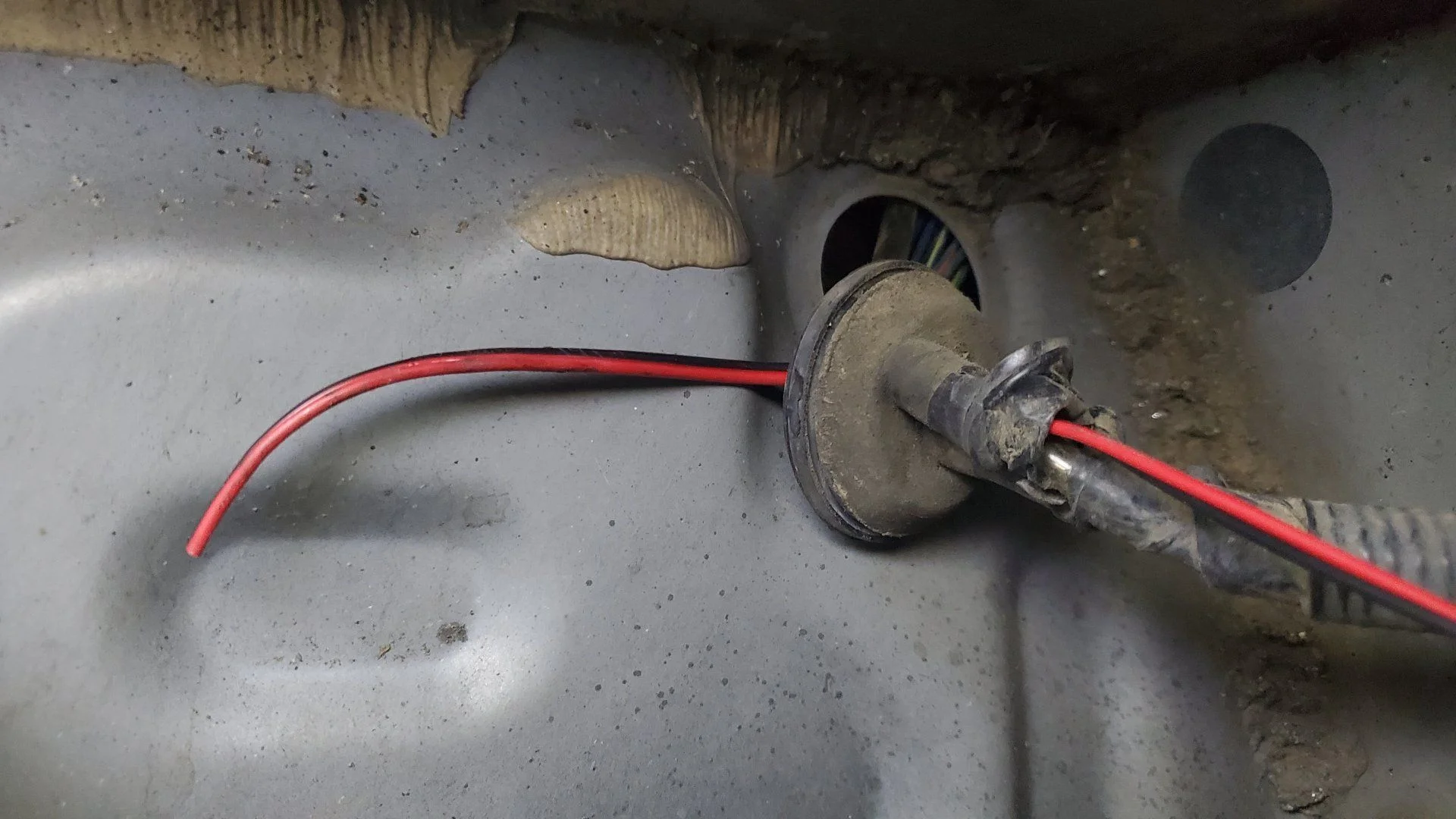

The grommet at the rear passenger, gave birth to the power, ground and video cable. Wrapped it all up and secured with some 3M clips and Tesa tape.

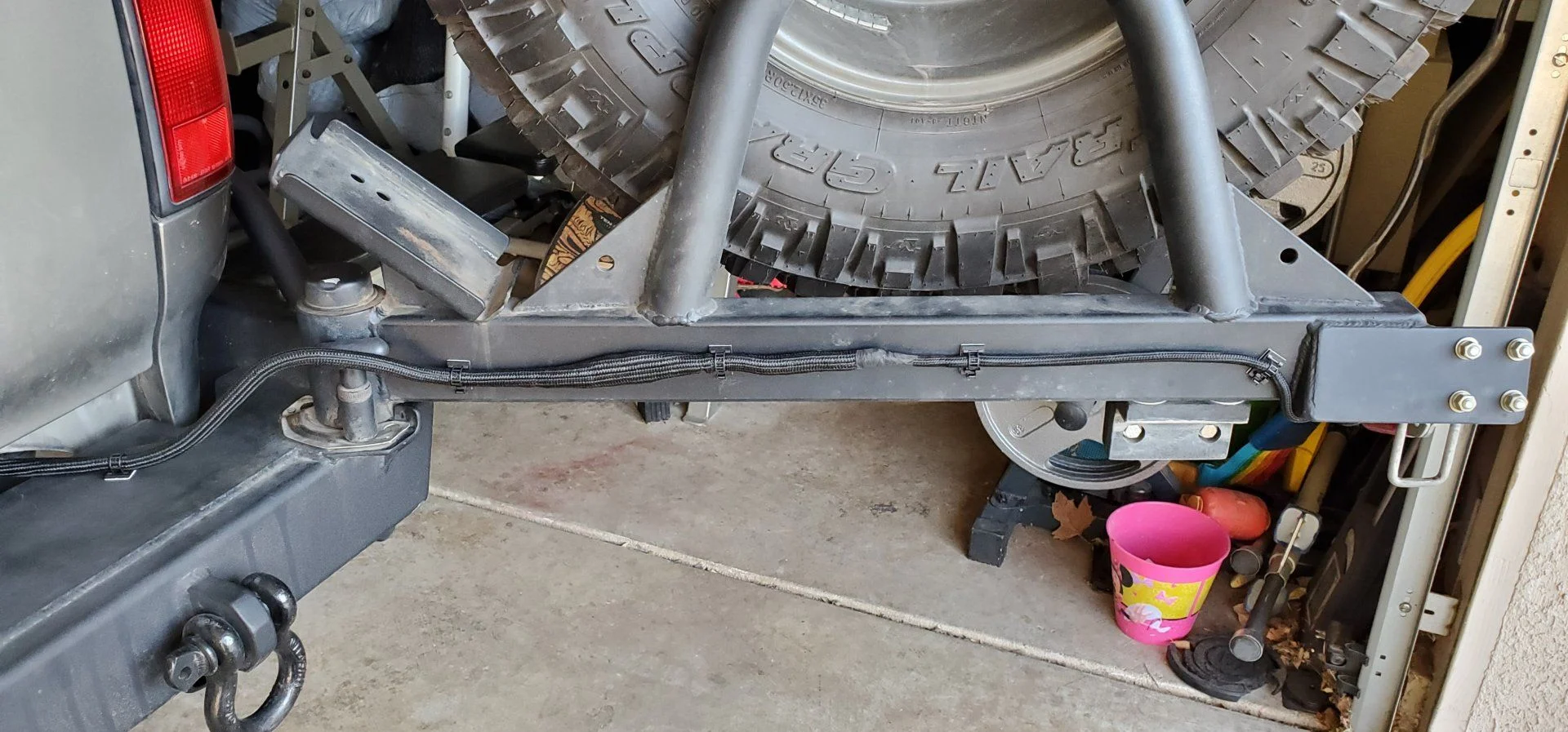

I then routed to the swing-out. I used glue lined heat shrink to make sure the RCA's are water tight and wrapped it up. I might sleeve it with some prettier loom at a later time...
Edit - new loom finished...

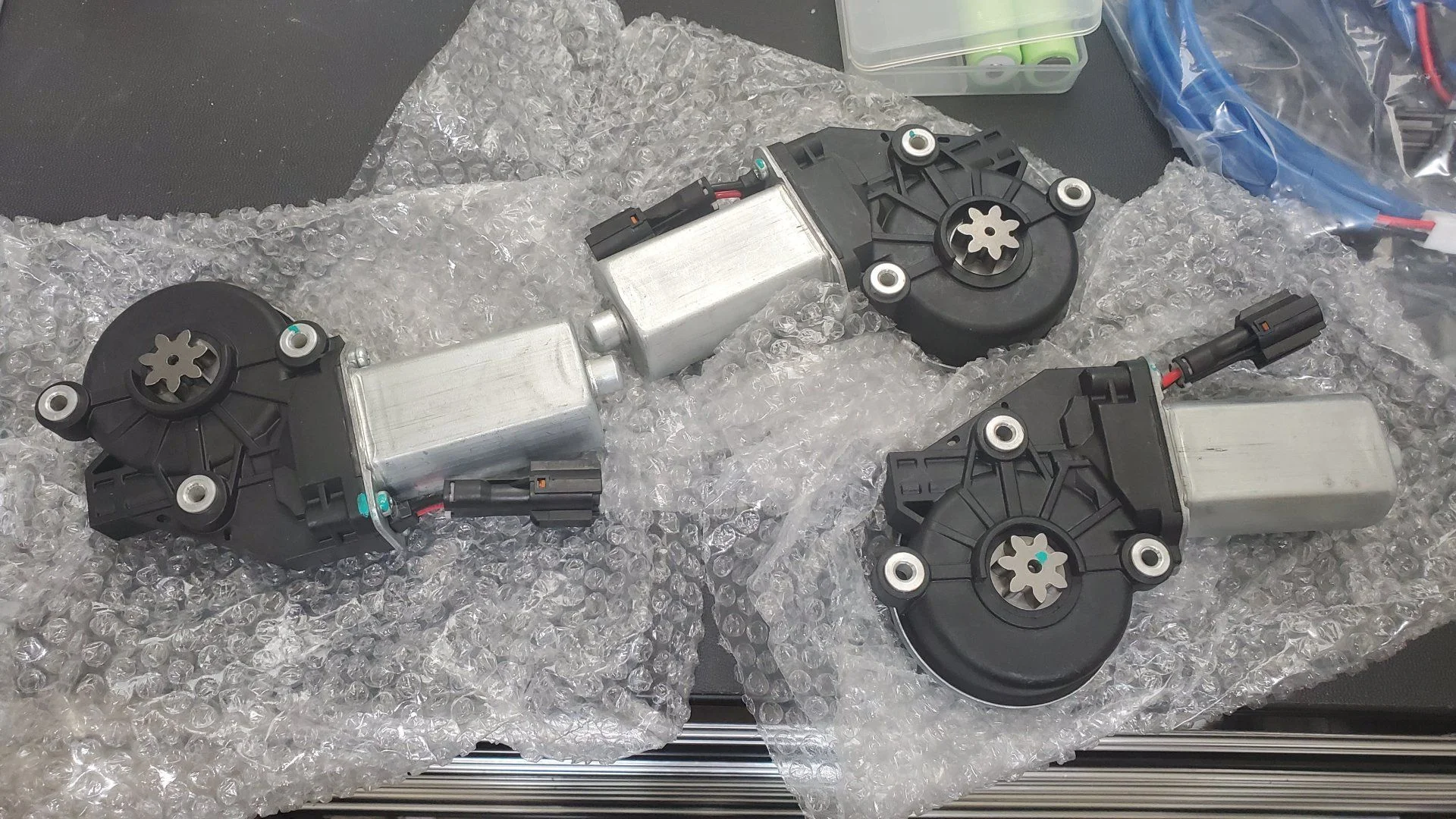

Started replacing window motors. L/R I replaced a long time ago, as it got to aiding the window by hand. Now it is time to do the others. They work, but like they are vacation.
TWO things I ran into setting me back this time around, that did not happen on the last install.
1. Check polarity on the motor by hooking the window switch up and testing. I tested for operating but did not pay attention to correct up-down command. Sooo, I had to take the door panel off all over again and switch the pins at the motor side.

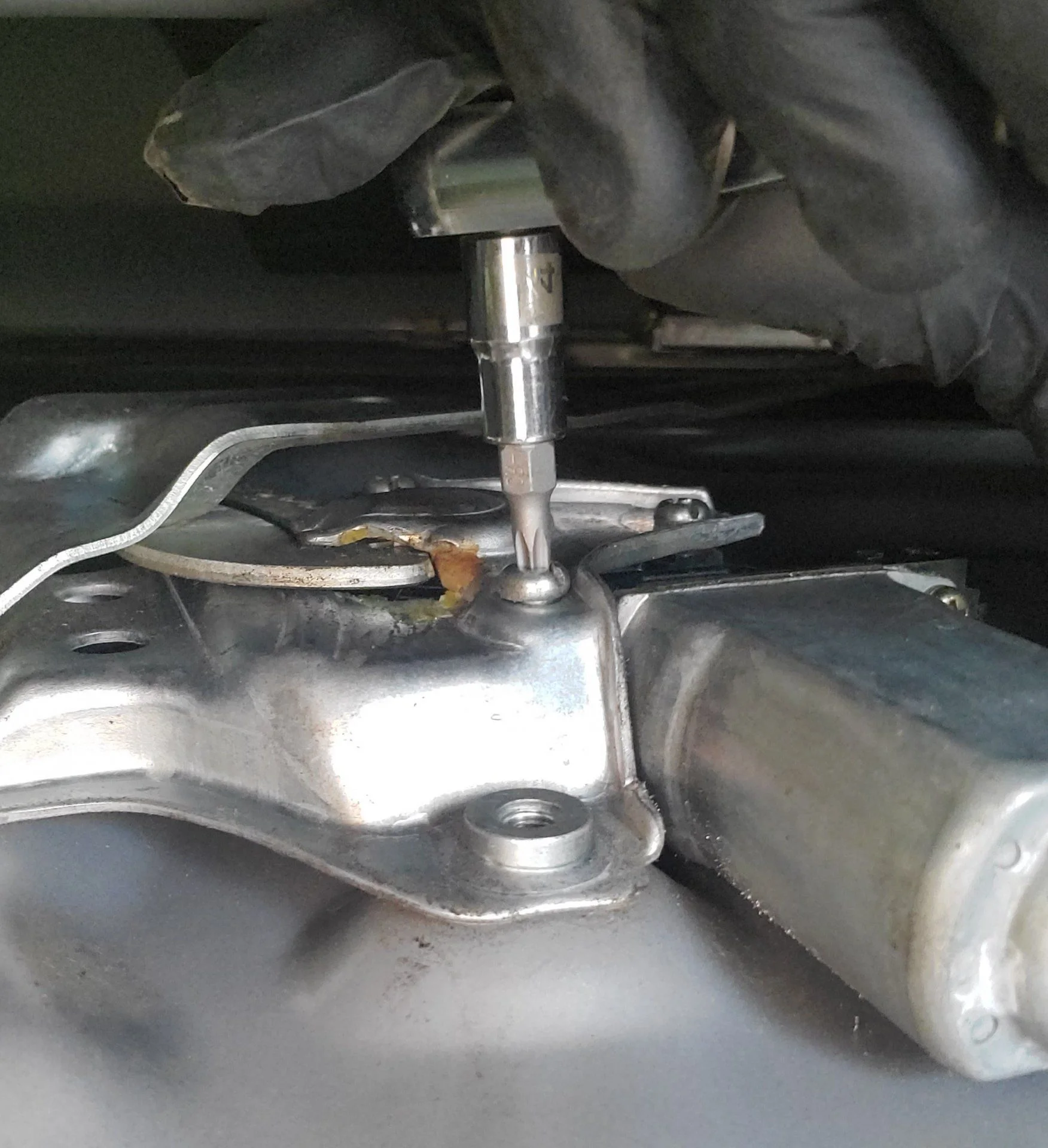

2. The Doorman motors also no longer have threads in the mounting holes. I spent at least 15 min trying to start a screw before I realized this issue. ( edit*** 😂 😂 apparently I already knew this years ago when I did the first one)
Tapped the holes in all the motors.

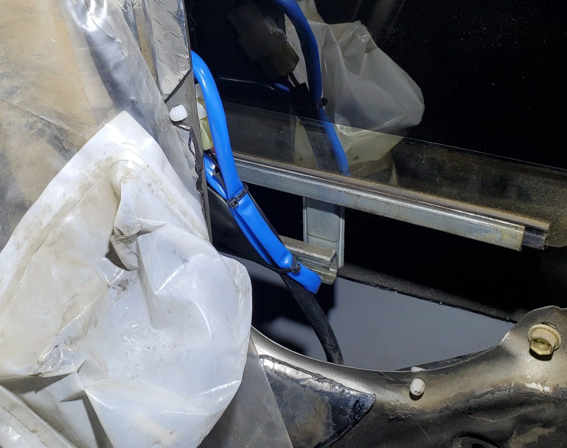

Use a wedge to make sure the window does not fall when removing the motor. Also a towel to protect tint if you have some. You will need to move the window at times to access the screws.

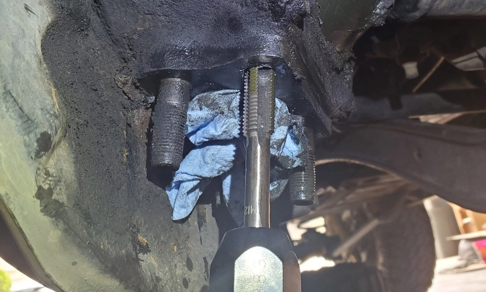

Drilling and using the extraction bits I had on hand was not working. I gave up and removed the steering arm.
I ended up having to hammer a torx bit into it and the stud came out. I removed all the studs and chased the holes with a tap. Tap size is M12×1.50
It wasn't pretty and took some finesse, but it is back together. Not now, but probably when I hit 200k, I will tear down both axles and do a proper rebuild. After all of that it turns out my sudden death wobble was from a loose wheel bearing. I am grateful that it did happen though, because I found the stud problem as well.

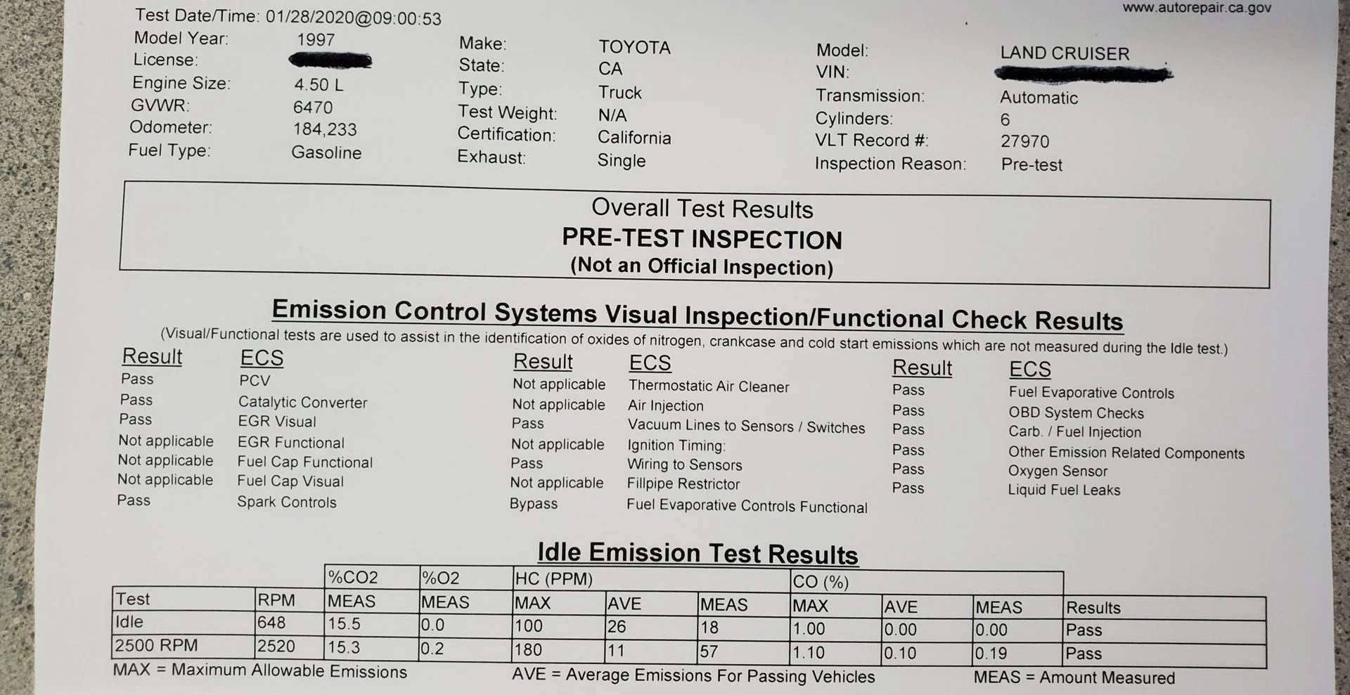

Had an inspection done to see how healthy she is this morning. I liked seeing NLXTACY's before and after and will do the same.
Looks great: (original cats)
Here's mine from a few months ago. Almost the same mileage but I have brand new Magnaflow downpipe + cats. I'm flagged as a high-emitter so I almost always have to do a smog test. If you continuously pass within range, does the smog test interval ever change?
